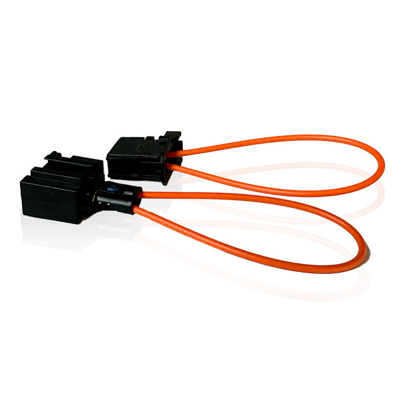

Since owning this car, i have had the "no acoustic tones" problem, so had no sound. Got my hands on a replacement amplifier and the same alarm persists. So did some digging, the TV unit aswell as the earphone unit, tucked away in the boot failed due to an earlier leak i had in the car. Because they were part of the Fibre optic network nothing worked. With some more homework , found that you get a MOST loop bypass, bought myself two of these and tunes banging again.plastic-optical-fiber-car-audio-loop-connector-gallery2.png

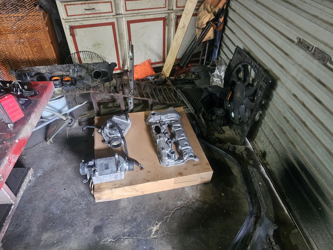

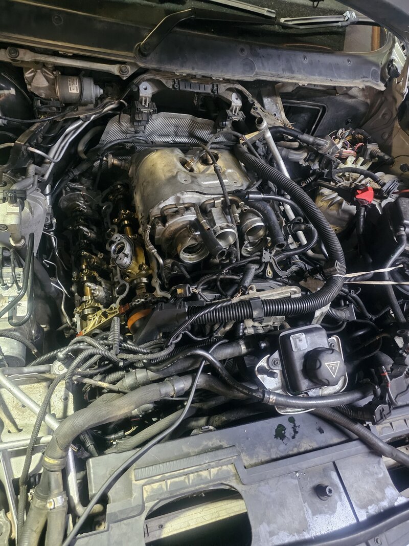

So Monday I have started with this journey, bliksem, it aint fun and games but managed to remove the RHS valve cover.

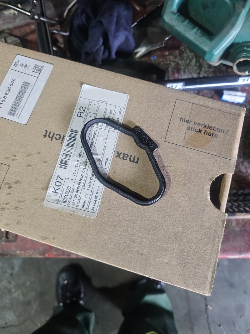

Important to note the valve cover kit with oils seperators does not come with completer valve cover seals the part that goes under the HPFP flange is not included, only saw this last night.17618038701172311214490740010823.jpg

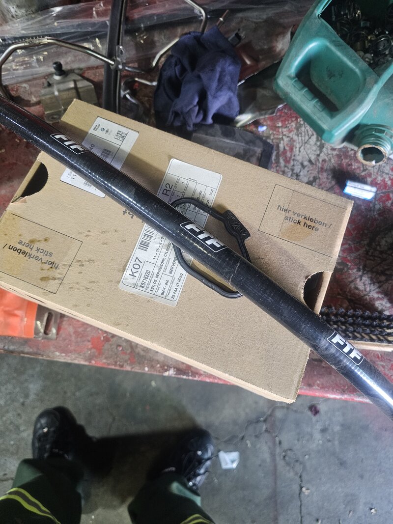

While dismantling, i broke one of the PCV lines, they become hard and brittle, Got some silicone hoses from FTF, will try them and see if it will do the job. 17618040170346852678292043876115.jpg

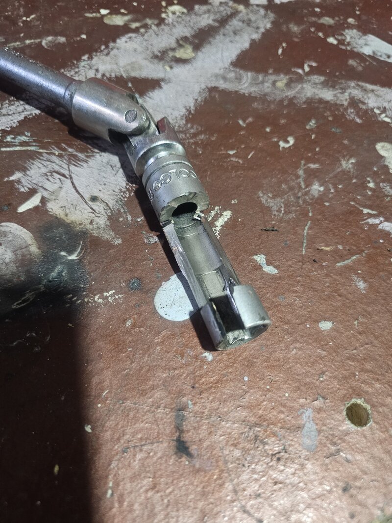

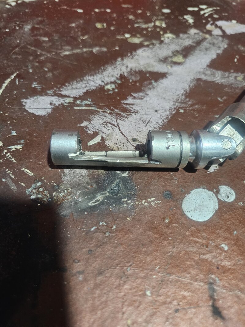

Removing or loosening the feul lines from fuel rail to injectors is also a pita, due to lack of space, finding fuel line removal sockets is also a pita so i did this.....
Used a long #14 socket and cut it to fit, it helped a few other headaches.
This job is not for the feint hearted but patience is key and more importantly, having the correct tools. Some tools i did not have, and lack of knowledge( first time doing this on this car/ engine) . There were actually a few times i wanted to abondon it and send it somewhere to get it done.

Valve cover gaskets and oil separators replaced. found a few leaks on vacuum lines, replaced all of them. car pulling lekker strong but, it is still smoking. What bogs my mind, if cold it is not smoking, when all is up to normal temps it is smoking, intermittently. So next up will do the vent lines of which this hopefully solves my issue. engine on inside is super clean for the mileage of which tells me it cannot be stem seals. Crossing fingers. Will update once i get to the vent lines.

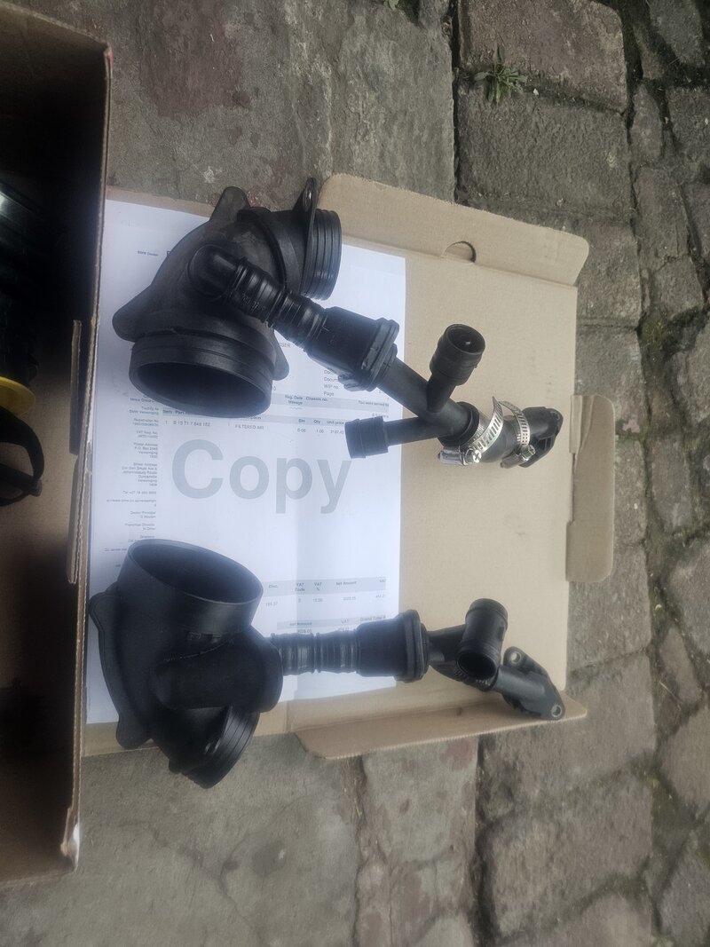

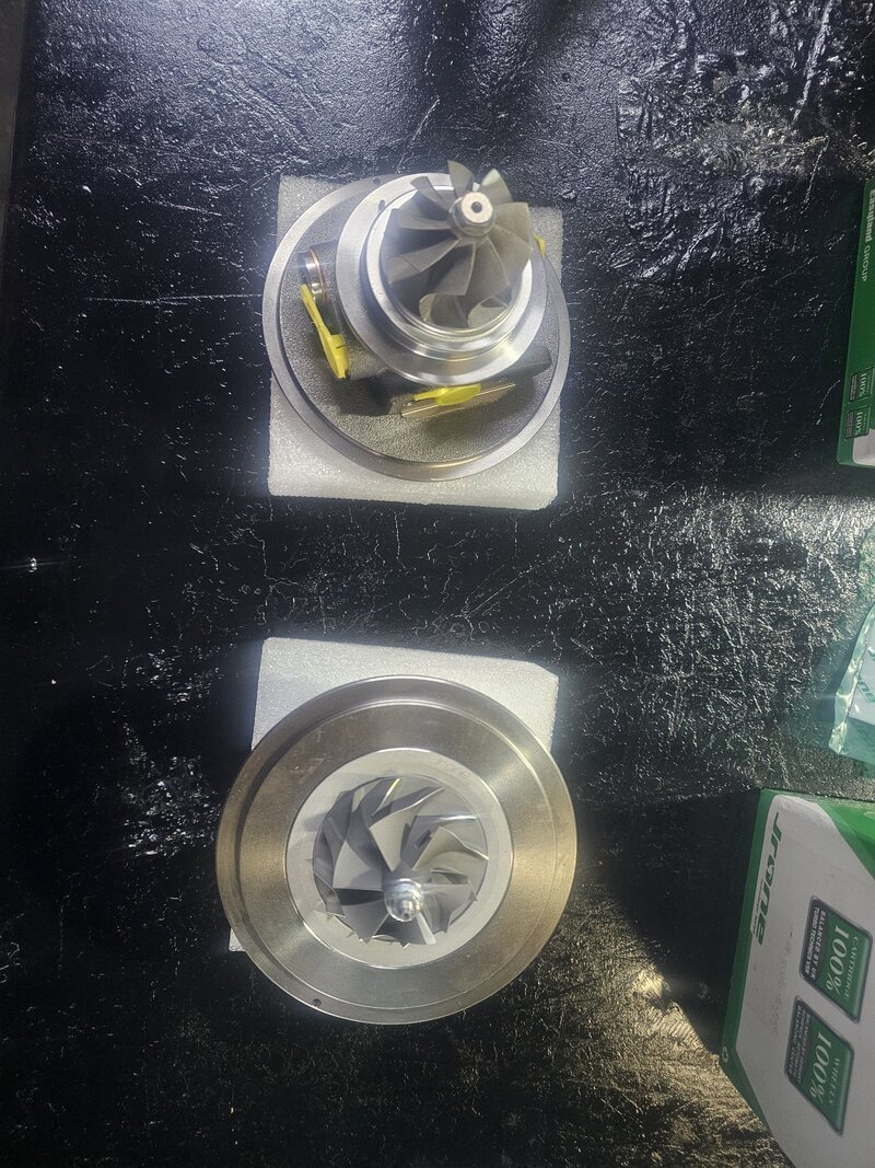

If you been following i have been hunting a smoking issue, changed the valve cover gaskets including the oil seperators. It was still smoking afyer this. Then replaced the air intakes on both inlets. These has the PCV valves installed on them. On the RHS turbo you could see oil fumes entering the turbo, which let me think that this was the smoking issue but allas, after cleaning the intake system ant the inlet turbo, after about a months driving, found that the RHS has oil residue inside it again. Looks like time to do the turbo's again. This is somewhat strange. On about 75000km the RHS was done under motorplan including the rotating assembly. BMW SA claimed pieces of the turbo entered the combustion chambers so that why the rotating assembly was replaced( the whole bottom end was renewed in 2014 at a cost of 265K) We bought the car on 155K odd km with the snails damaged, replaced with OEM cores and now smoking again at just shy of 220K km ( started smoking around 210k km).
Maybe it had to do with the oil fume entering the snail or the small turbo water pump, this was replaced twice allready and it failed again( last one was OEM one at agents )
So got a contact that sells these cores at a fairly good price, will get a set soon.
Below a pic of the air ducts that was replaced.

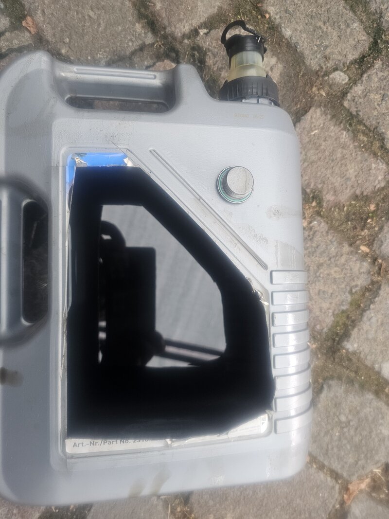

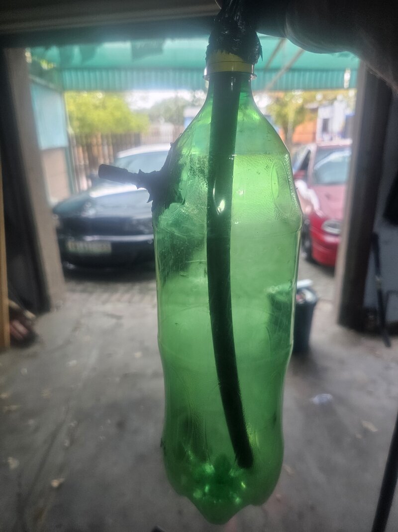

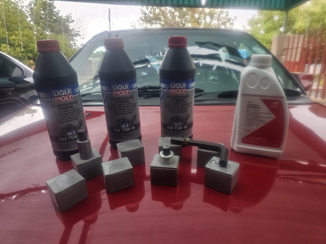

Off to do some maintanance too. Changed the transfer case oil and the front diff. On the next day off will do the rear diff. Ran short of new drain plugs so could not get to it. Modified a plastic bottle, using a bicycle pump to pump the oil into the transfercase and front diff.20260305_091005.jpg20260305_090241.jpg20260305_085412.jpg20260305_085244.jpg
