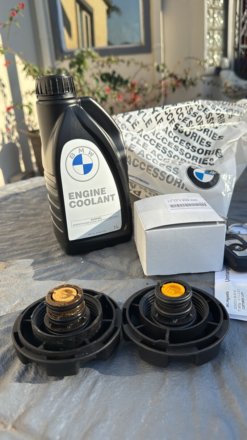

Update
I took the M140i for its usual weekend drive. To my surprise, I received a coolant low message which was very odd considering I only use this car on weekends usually.
There was no leaks or signs of coolant leaks anywhere in the engine bay nor on the floors and there was still coolant in the actual tank just below the minimum. I had changed the waterpump, oil filter housing, thermostat, hose and coolant flange last year when I bought the car which was about 6k ago mileage to be exact, so a leak at this rate was highly unlikely.
I did some research on the B58 forums and one of the things I didn’t think of was the actual expansion tank cap, as many owners reported that their caps broke, leading to loss of coolant in the form of air. I had a look at my cap and I could see that it deteriorated substantially as the O-Rings had cracks on them.
I managed get a new set for both cars at the same time from SMG. Costed me R336.
Definitely a big difference between the old one and the new one.
