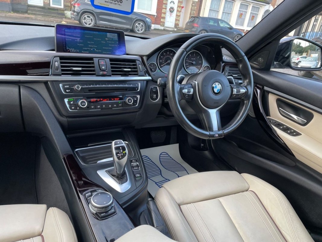

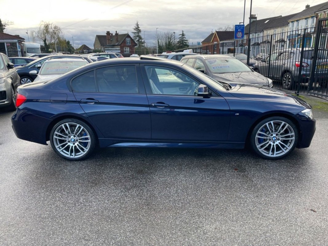

Hey guys, been a long time since I posted on here, haven't had a BMW in years.
I needed a car to run to my new place of work and home 3 days a week and my Golf V6 4motion is waaaayy too juicy to use so decided I needed another beemer in my life.
Ended up with this after searching. I really wanted an F10 530d, but missed out on a beaut. When I saw this F30, and how well the previous owner looked after it, I decided to get into an F30 again.

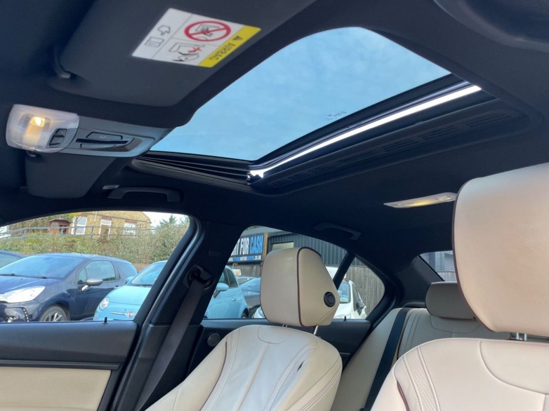

Spec list is huge with a, for the UK, rare sunroof:
Invididual Tanzanite Blue Metallic
Individual Extended Merino Leather - Kaschmir-beige
M sport
Xenons
Front & rear PDC
Heated Sport seats
Split folding seats
Heated and folding mirrors
Pro Nav
Extended cluster
Park Assist
Harman Kardon
Sport auto with paddle shift
I will be adding electric and memory seats soon.

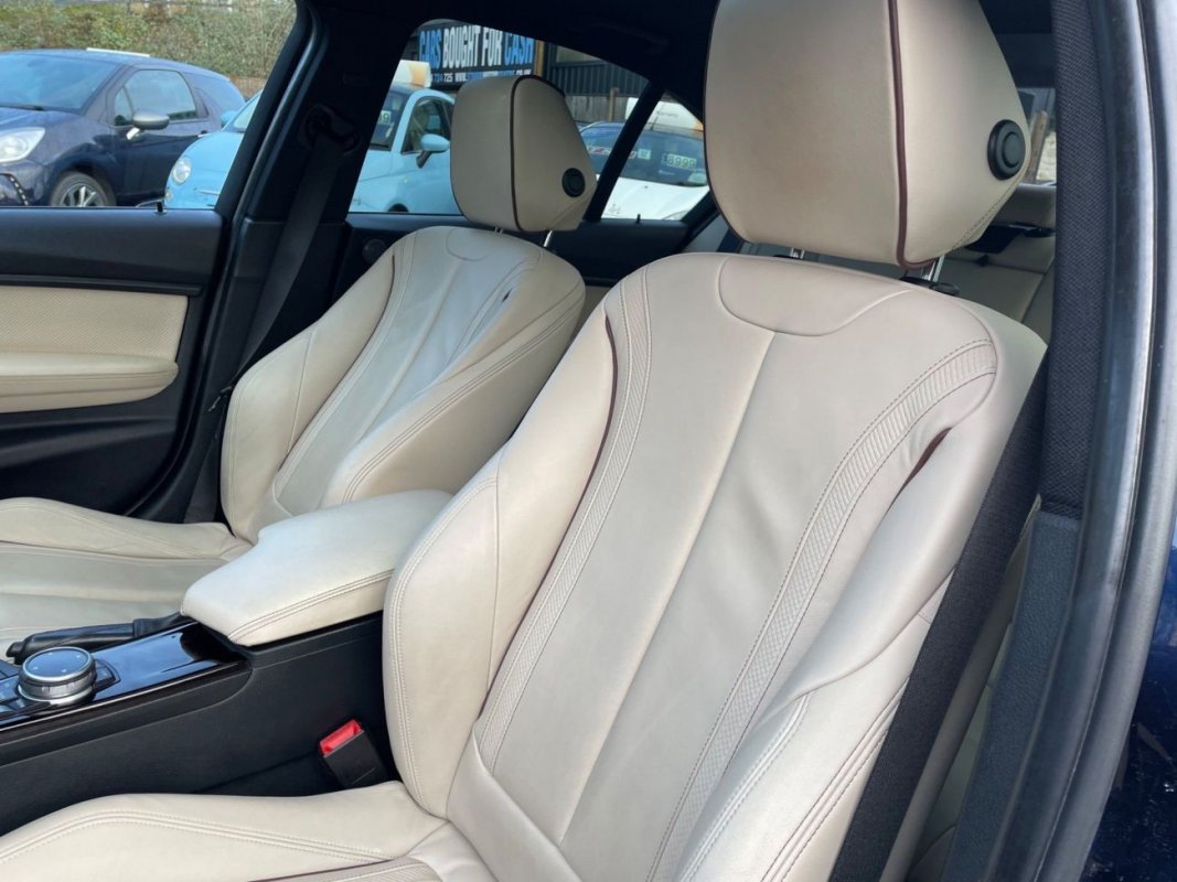

How difficult was it to add electric seats, plug and play or harness alterations required?
It wasn't difficult at all. I was really surprised that most of the wiring was already in place. I think I only had to run a twisted pair for CAN to the FEM, been a while now so a little hazy.

Did you source the seats at a scrap yard then install?any updates on the Golf for us?
I bought some plain leather seats out of an F32 and then changed the leather and foam over from my seats. I then purchased the lumbar adjustment bits and installed them. Once all that was done, I had to find the controls with lumbar support which seem to be quite thin on the ground.
