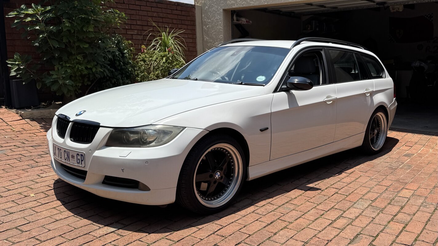

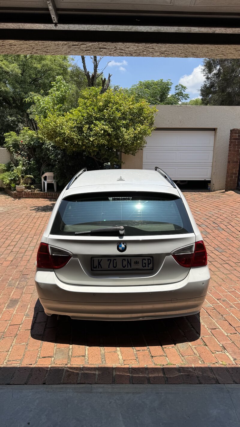

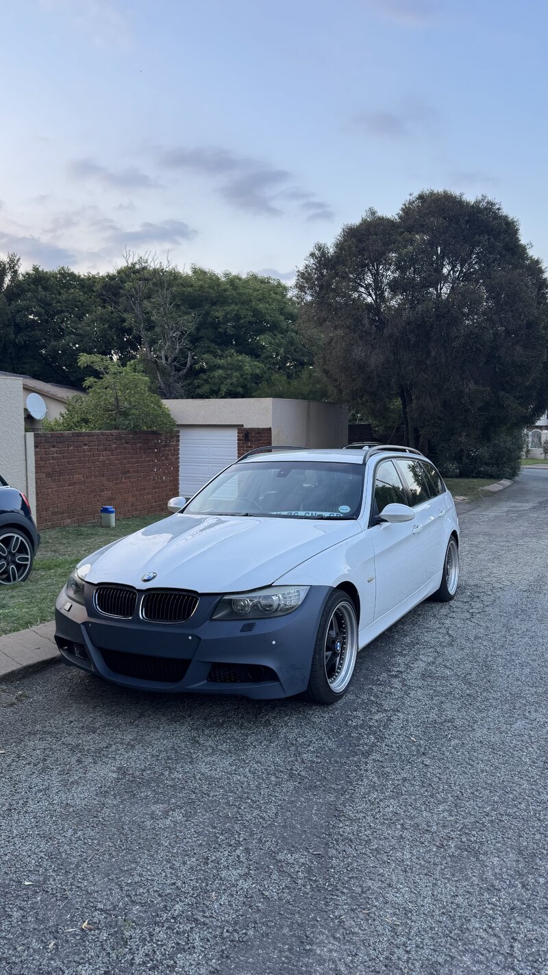

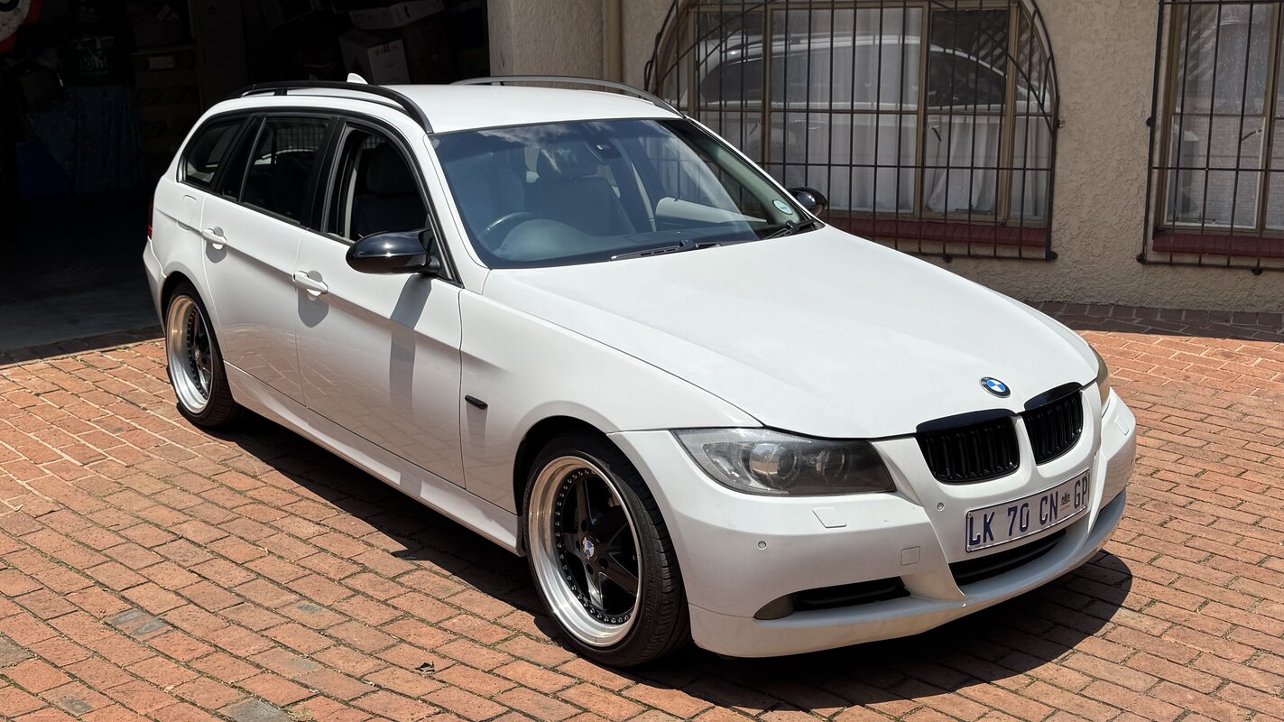

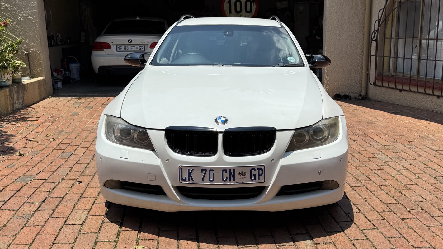

So, here she is - My Alpine White III E91 320d automatic.

What's important to note is that the images you see above were taken yesterday and not on the day I took the car (because it was night time when I got home)

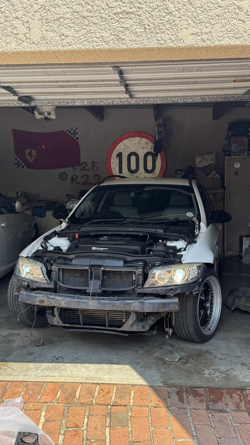

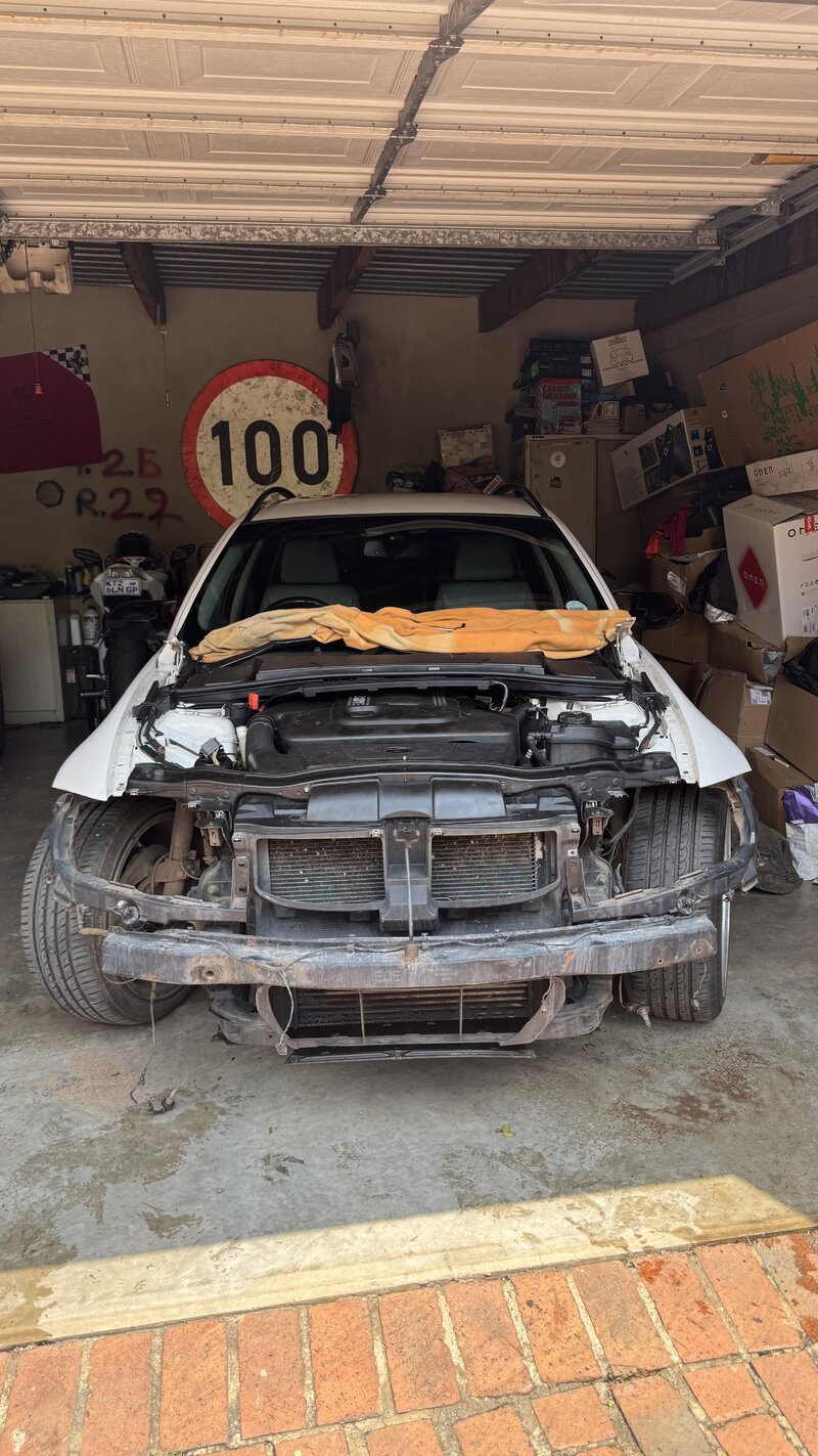

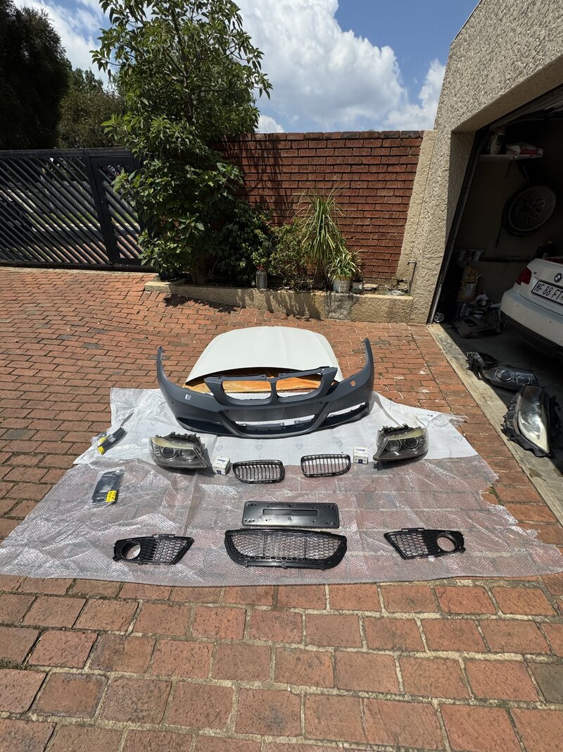

(A secret the audience doesn't know) While I had the downtime with the car in the workshop, I was working tirelessly to source a handful of parts.
Eagle eyed viewers will notice that what is missing above, happens to be the exact components that would (hypothetically) be required for an LCI conversion.
Not so hypothetically, I gathered a full array of parts to do exactly that.

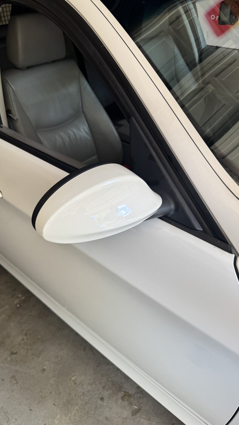

While I was busy, I couldn't stand the (for those who speak Portuguese) Tuga Special mirror caps and side markers. They sucked the life out of me the moment I laid eyes on them. I immediately restored the mirror caps back to stock along with the standard clear side markers.

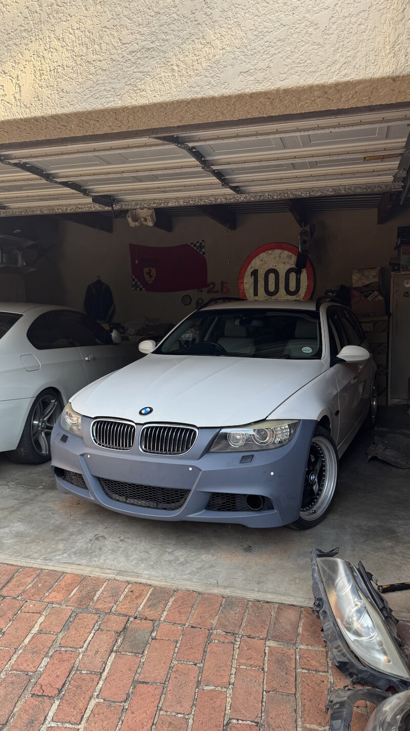

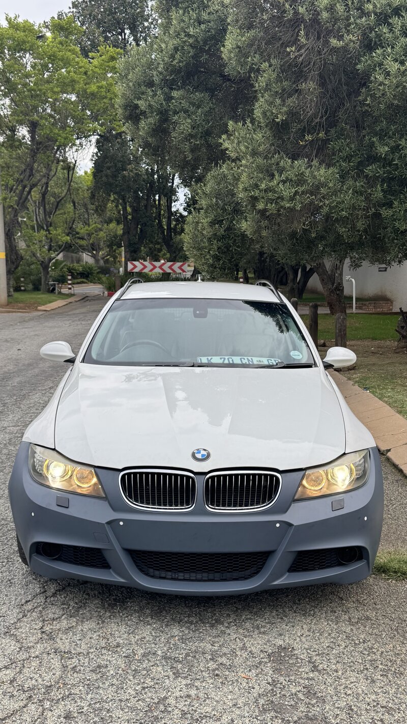

After a lot of struggling (usual theme - see my CarPlay installation fiasco) the swap was complete. Before anyone says anything, I know! I know the bonnet looks absolutely shocking. I cannot tell you how long I struggled to get the fit as good as possible and believe it or not, this is substantially better than it looked when I first mounted it. I fully intend to ask which ever panel beater that sprays my bumper to please align it correctly as that is their profession.
Disclaimer aside, here is the end result.

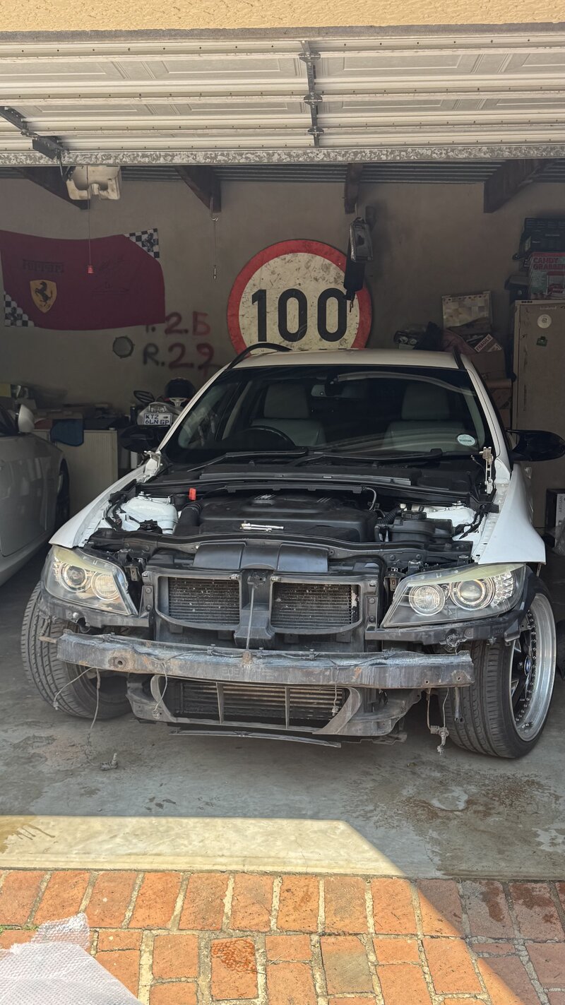

After another full day of (surprise surprise) struggling... I had quickly realised that I was not going to get away with running my FRMFA (FRM1) with these lights as the FRMFA doesn't at all support daytime running lights and above all else, the difference in wattage draw from the original h5w to the LCI H8 goes from 5w to 35w - a 7x increase! The FRM took one look at this and shut the whole operation down. I spent the whole night trying to beg and plead with my FRM to let me run my coronas but I was fighting a losing battle. Tomorrow was another day.
EATYOURVITAMIN5

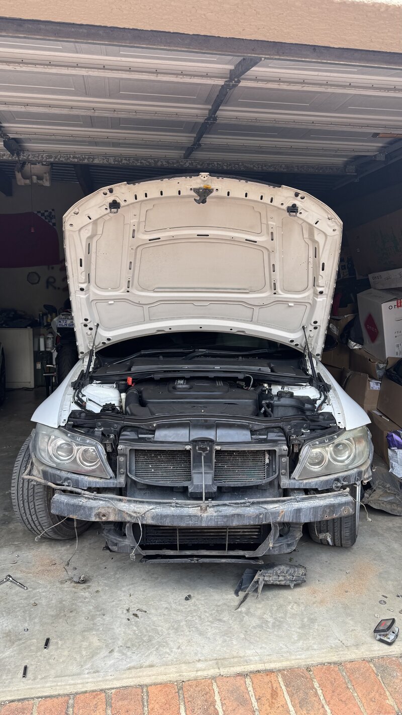

Fortunately for me - had done my research and already had an FRM2 shaped card up my sleeve. I had my morning coffee and proceeded to take more than 2 hours to try and fit this God forsaken device into the footwell. This is hands down the worst job I have ever done in a BMW and I feel like having done it today, I do not have an increased skill to do it another time if the need came around. It will be just as difficult the 5th time as it is the first... but eventually I got it done. However, my struggles didn't end there (shock horror, I know).
I proceeded to spend the rest of the day trying to get stupid WinKFP to code MY VIN to the new NFRM (FRM2) in order for it to work correctly with my car. After a long struggle, WinKFP was insisting that I had missing files even though it not only showed my exact part number for my FRM but also given that I have downloaded more than 10(!!) different SP-DATEN versions ranging from the low v20s to v74 and none ended up working.
Eventually I worked my way around it by using Tool32 which isn't the "proper" way to do it but it gets the job done.. and sometimes done is better than perfect. I think a surgeon once told me that.

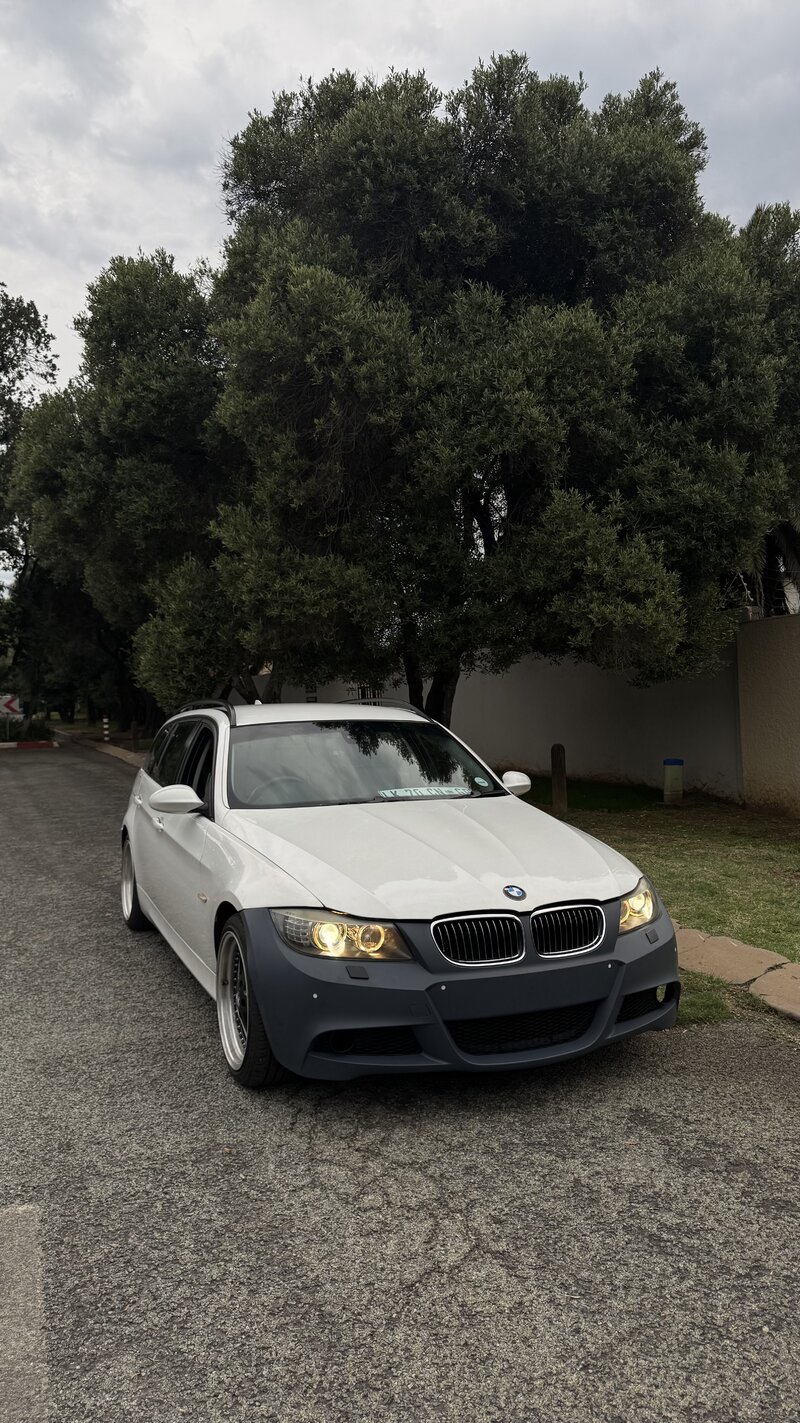

After a long day, this is how the car is sitting.. with functional welcome lights, working coronas that do not just switch off 10 seconds after they come on and countless coding options due to a now way more modern and sophisticated NFRM.
