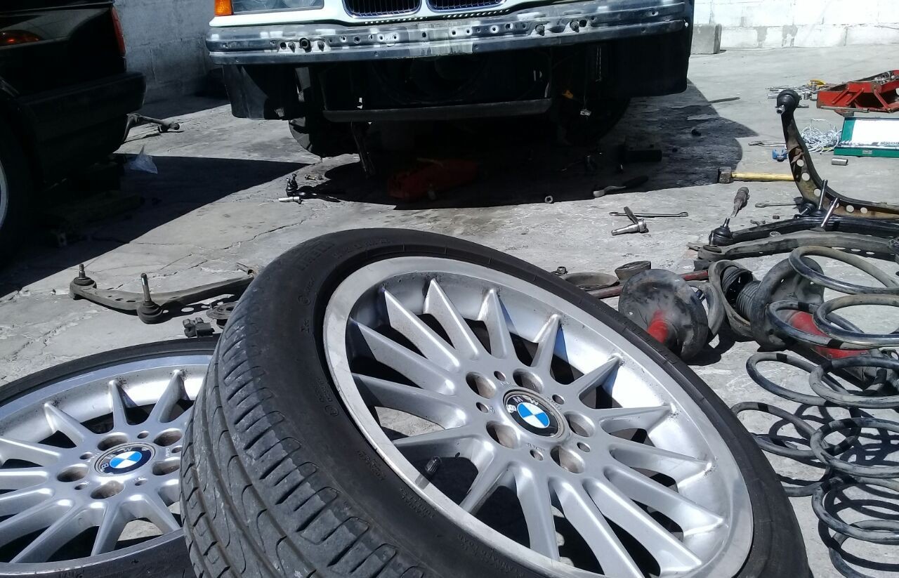

Suspension Redo

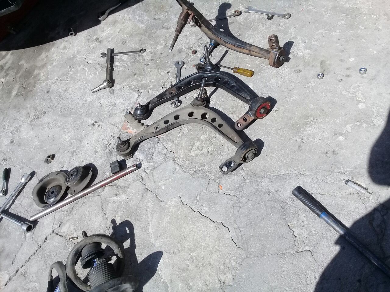

and with the car being so low and bumper taking so many knocks, shocks bottoming out, I decided to fit mystandard springs and shocks and while i was there replaced the lower control arms, lower control arm bushes, tie rods, swaybar links and front shock mounts
I used old original E30 Control arms...same as E36 just uses solid outer balljoints instead of the floating ones. E30 arm in the middle for comparison. Also got some polyurethane bushes from Andre's rubbers suitable for street so not as hard.
That along with meyle balljoints pressed in by local fitment centre. Shock mounts, tierods and droplinks were from masterparts
Got back stripped the vert and got to work :rollsmile: Yeah tools and parts everywhere :cartel:
Results
A night and day difference in the feel and drive of the car. Cruises over bumps and very easy on the ear, no harshness in the ride... no lowness or stance to report but super stoked with the weekends work:coolShake:
