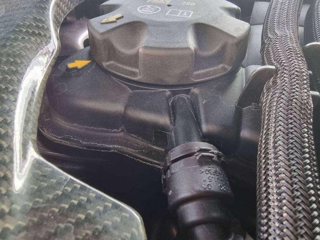

I got a low coolant warning on the F90. Fortunately, I always have coolant and oil on hand. When topping it off, it was evident that it was seeping from the seam of the reservoir. This can leak onto one of the plugs and, if not attended to when the problem first arises, can lead to corrosion/misfires. How anyone can live with that coolant smell, I don't know, but anyway from my reading it seems that initially BMW dealers in the US just topped off the coolant and told people it was "normal for high performance cars to use some coolant..." This was also followed shortly after by just replacing the bottle like for like before the revision was available.
It might be batch specific for this part since not every car is impacted but this is now a known issue and BMW fitted a revised water bottle for me. When looking into this, it seems people also fit little plastic channels/guides so that if it does happen again the coolant is not channelled onto a plug.
F9x M5 and M8 owners should look at this spot periodically just in case this develops. The bulletin/service measure that Vashan shared with me somewhat cryptically refers to a "chemical reaction with the bottle" and that a revised part number is available :ROFLMAO:, Anyway, heat and coolant coupled with that particular kind of material seemingly doesn't work well together. It is very obvious when you know what to look for (Pics below)

Looks like mine was replaced about 55k kms. Seems to be a common failure. I remember seeing this on most older M5s service history (
Expansion tank for coolant radiator leak)

Good info - most of the cars I've looked at were sub 30000km and it wasn't something I noticed 'til now. I am on 47000km now - seems to be about the time this issue arises.

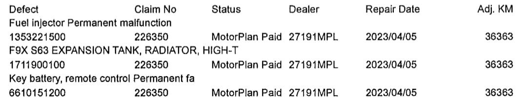

Seems to be time based more so than mileage. Most of the M5's I had looked at were also sitting around the 30k km's mark.
Here's a snippet of another 2019 I looked at with +-40k km's where the expansion tank had an issue.
None of those were uncommon unfortunately.
Another common one ive seen a lot:
'Battery in telematics control unit Permanent Failure'
