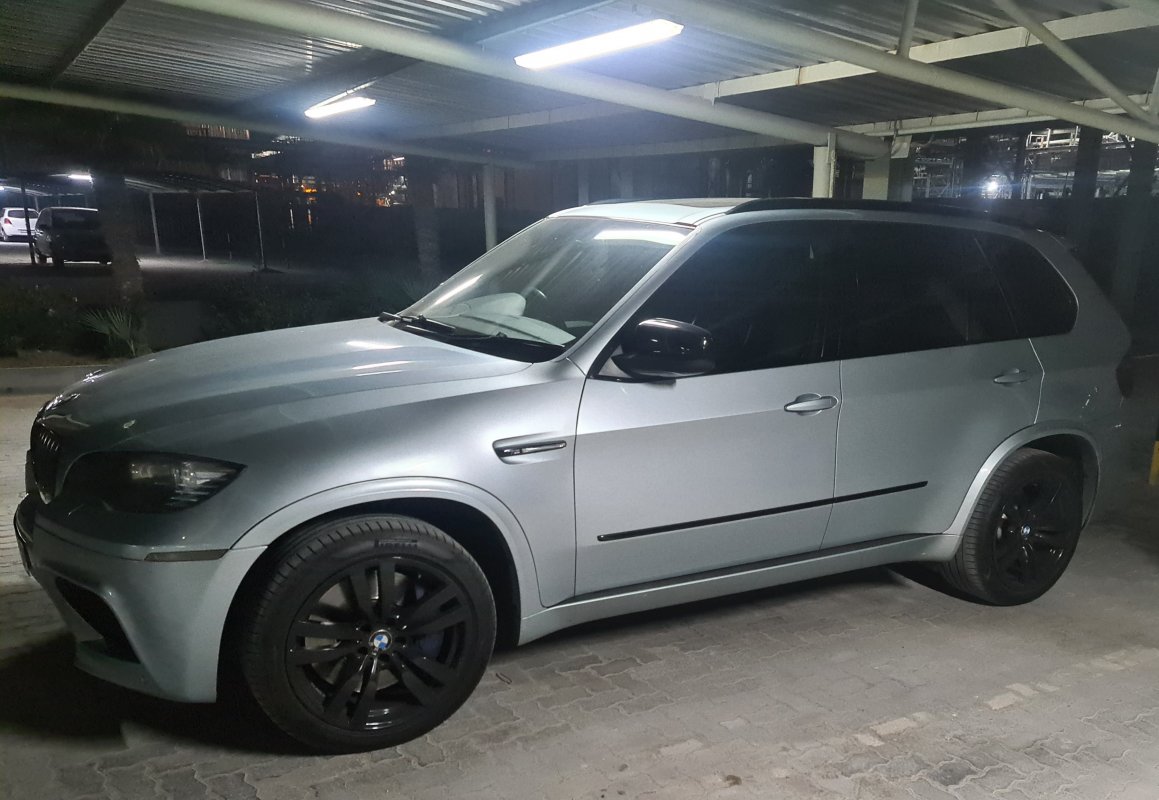

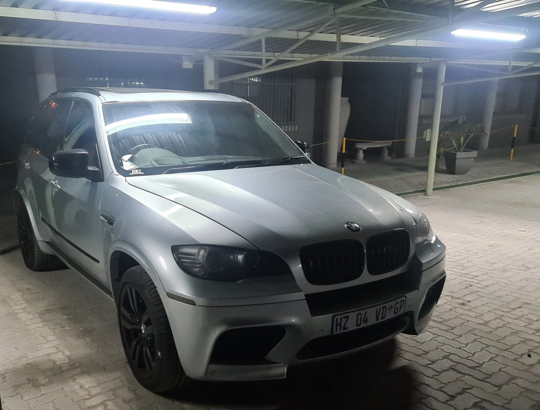

For a while now, discussed with the wife to replace her E90 330i with a X3........ Moddy night something happened and we decided on something else, for the first time , followed the heart and put the mind on the side :).

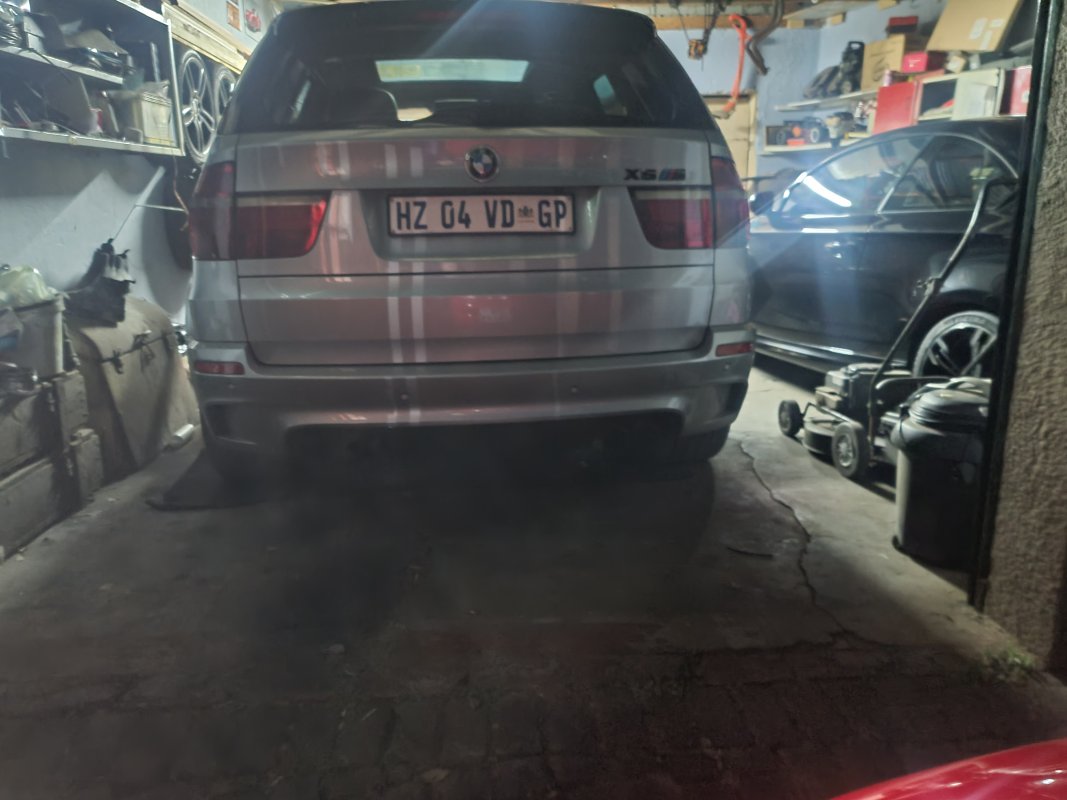

Went and fetch this lady yesterday.

Congrats on your Silverstone beast @Gordvisr. More pics would be great you know ;)
Thank you, trying to twist the SO's arm, she must take the one'r together with the 330 sell it and buy her something else :) . Will share some when i have some time, fetched it on Tuesday, ran up and down to close the deal, had a look at a blue one first , on pics that one looked better but after driving it not so much, then ran after this one, got home Tuesday late and up the next morning for work. Have an issue with the sunroof, opened it and now it wont close, it opened only on the one side. tried sorting that out last night but ran out of time. It was jumped started, so i was thinking if the car needs a reset or what as the PDC stopped working, the front roof light and no sound from the radio.

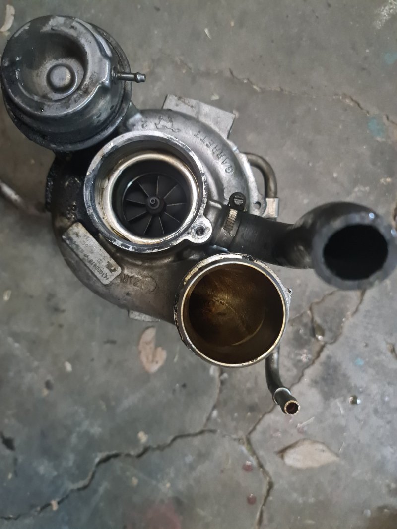

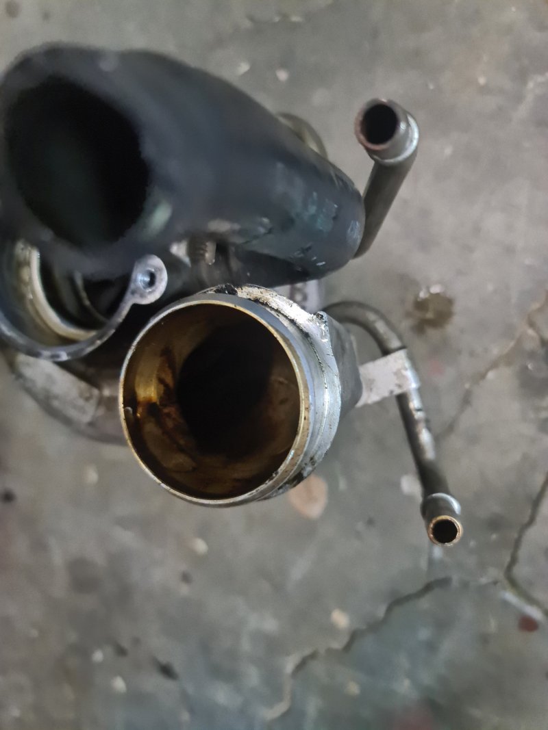

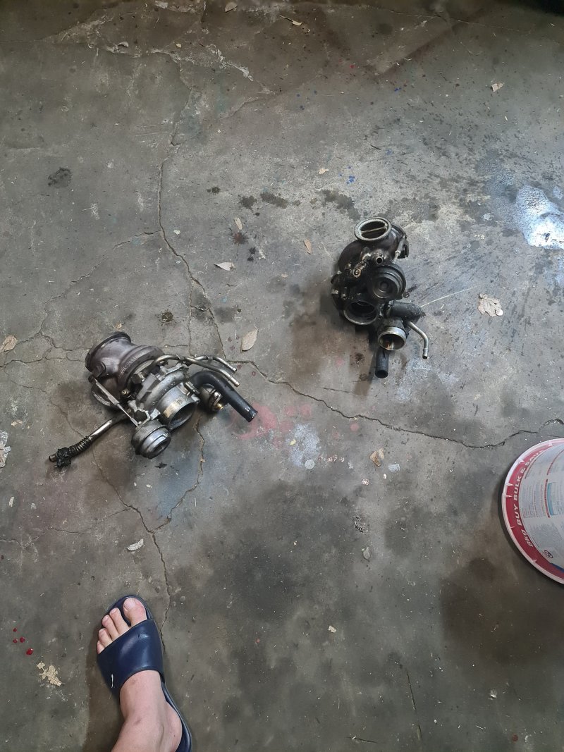

So we had a bit of a smoking issue a week after purchase. It was three thing that could have caused this, either, turbo's, valve stem seals or the vent valves on the block. The way it smoked gave me indication that it might be the turbo's, and this morning started getting a whining noise from them, for now the car is parked, will start saving up to replace them. SO want to sell, i said no 🤣

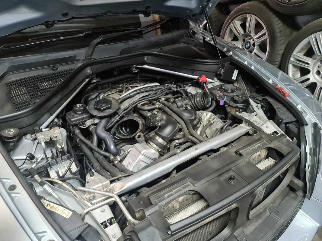

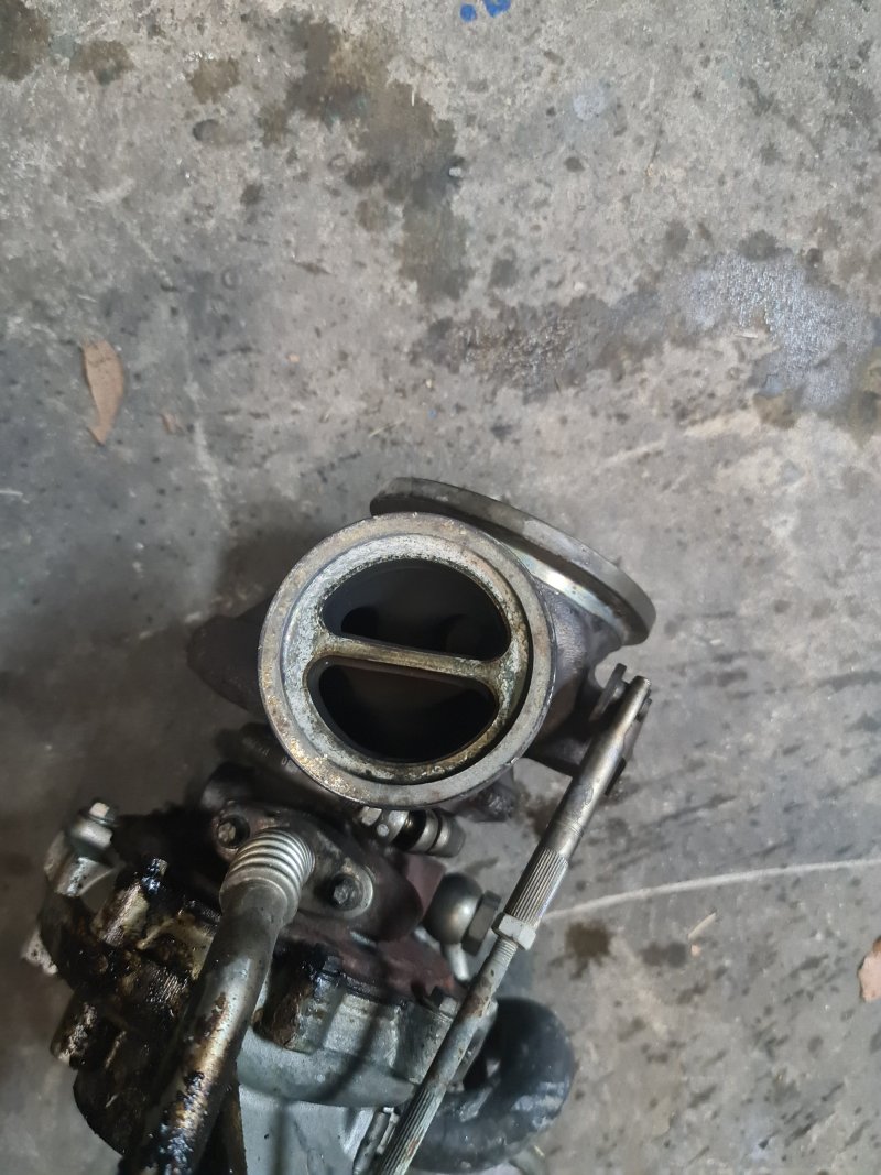

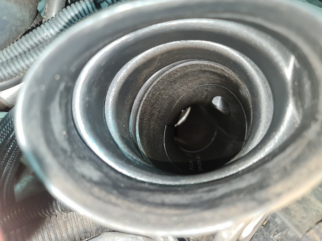

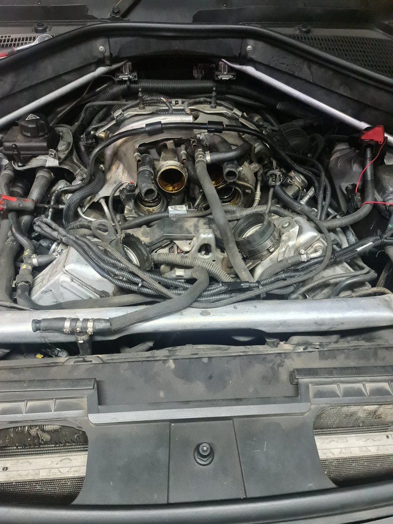

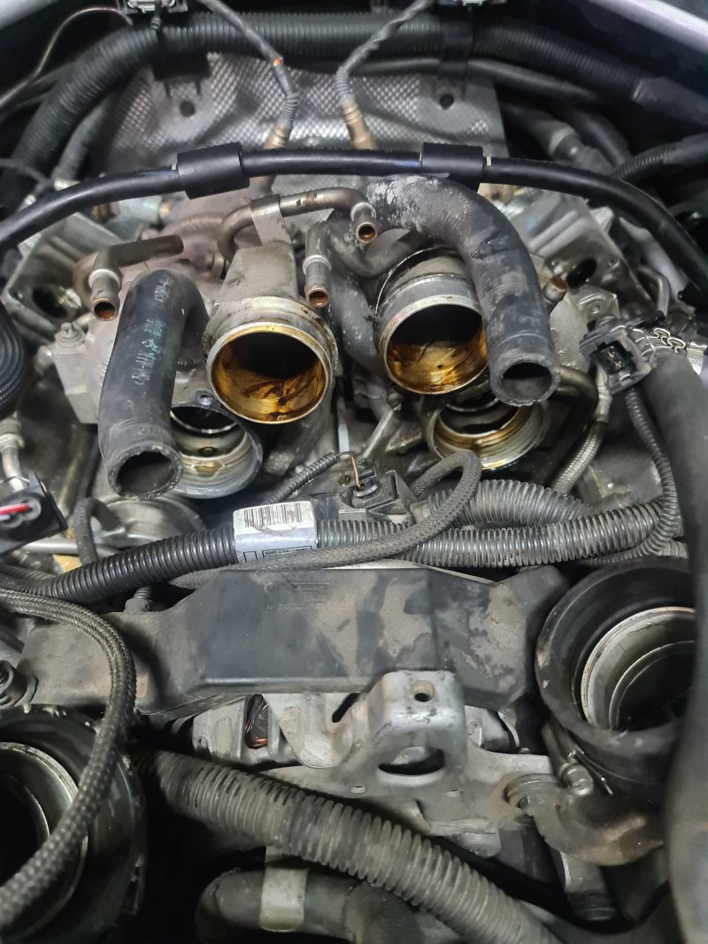

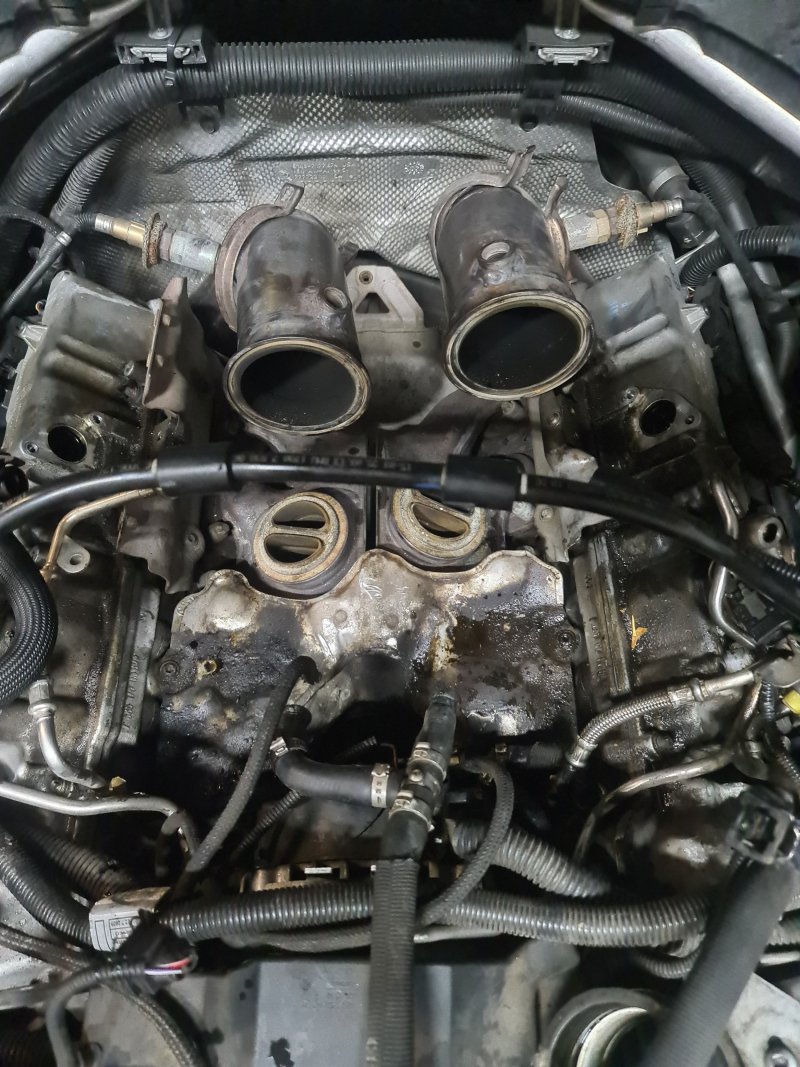

Stripped of the intake, from info i gatehered my problem was the "oil seperator" inside the valve covers, clean oil blew through the turbo's , they started to make some noise. When i have some more time on my hands will strip off completely together with the valve covers and get all the replacement parts to fix her up.20220818_103310.jpg20220818_103248.jpg

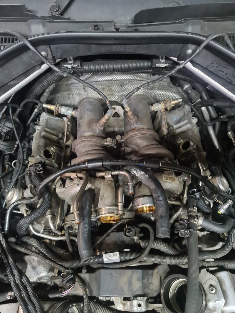

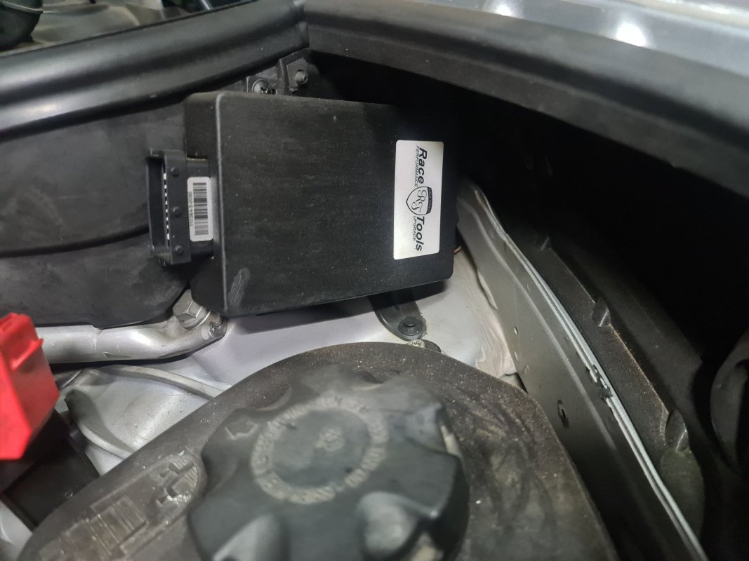

Some more progress inbetween dropping and fetching the other car for oil service. I see downpipes was done, lekker, just need to follow the harness on this "piggy"or whatever it is, want to remove it.20221003_150905.jpg20221003_150844.jpg
