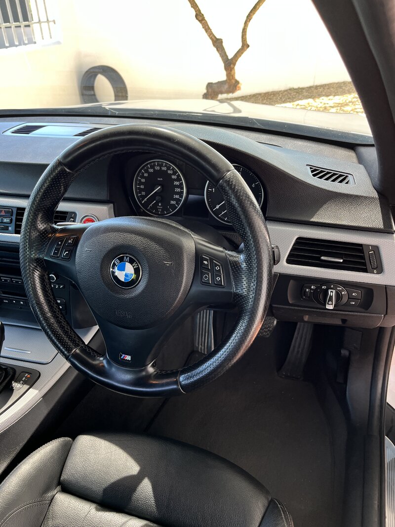

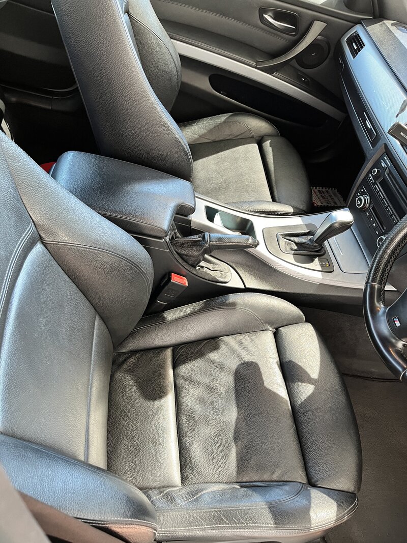

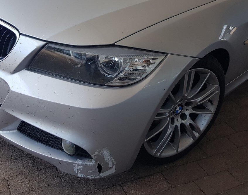

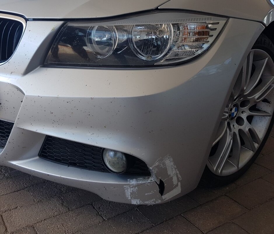

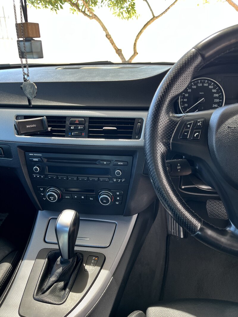

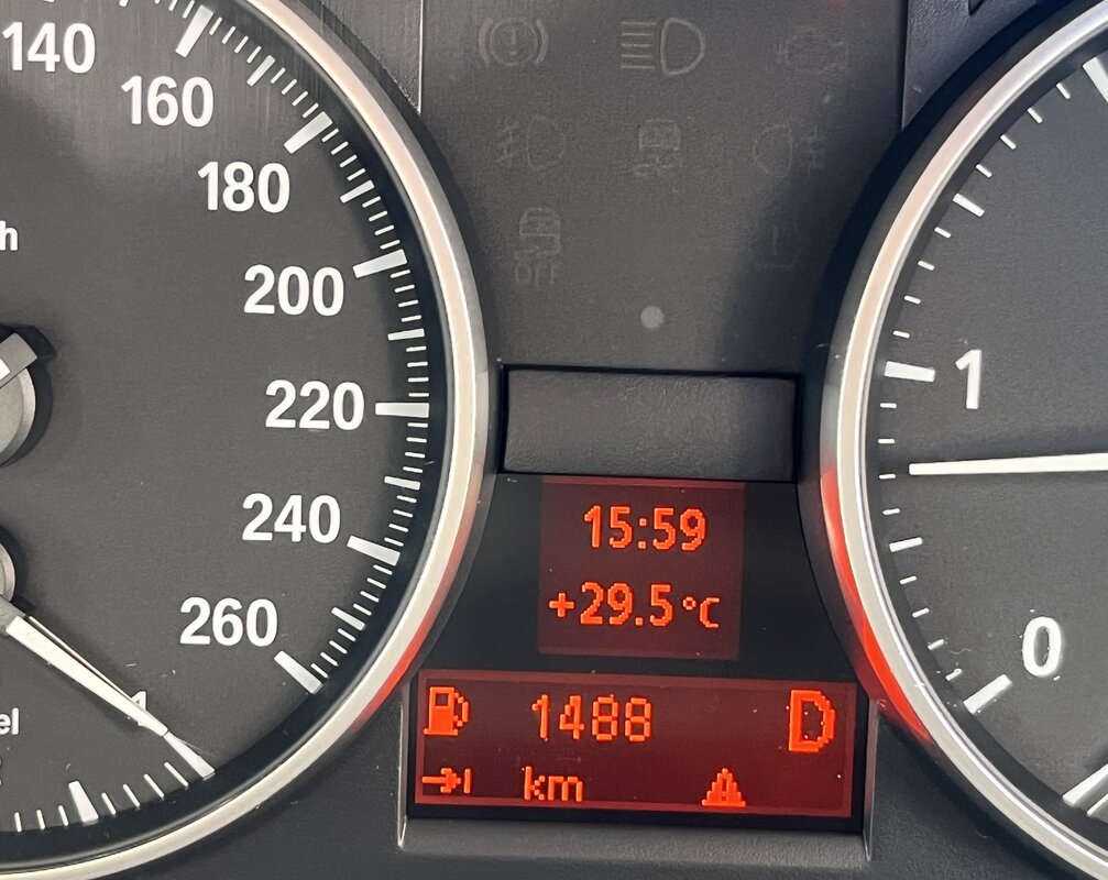

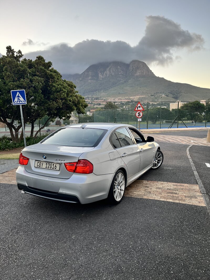

After four years of ownership, I still can’t bring myself to part ways with this car—not that I want to. She’s just ticked over 254,xxx km and is still being kept in tip-top condition for her age.
I’m still commuting 130km weekdays, and the 320d does it without breaking a sweat. There are a few cosmetic bits I’ll sort out as time goes on, like replacing the headlight lenses. Still the best affordable daily imho. No frills, no fuss it just gets the job done.

One clean 320d this one and if i looked at its neatness and you told me the mileage.
I would not believe it until i looked at the cluster.

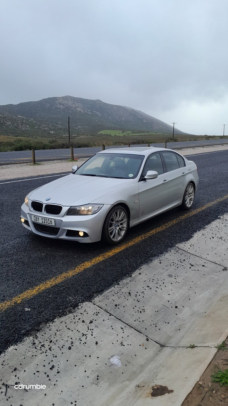

Thanks for the interest. Not much to report since my last update, but hitting a personal milestone: I’ve owned the car for over 100 000 km now, and it’s been a solid ride.
Maintenance done during my ownership (besides regular services):
  1. Vibration dampener pulley, tensioner, and drivebelt
  2. Shocks and mountings
  3. Coolant flange hose
  4. Upper radiator hose and expansion tank
  5. Battery and alternator
I’ll need some new rear tyres soon—planning to replace them after the school holidays. My Goodyear Eagle F1 AS2 have been amazing, so I’ll definitely stick with those.
The attached picture was taken on the N7, 10 km south of Clanwilliam Dam, on our way back to the West Coast after a family trip to Namakwaland in the Northern Cape.
So yeah, just enjoying the 320d for what it is.
