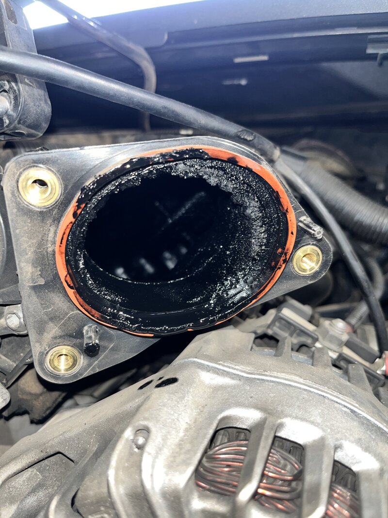

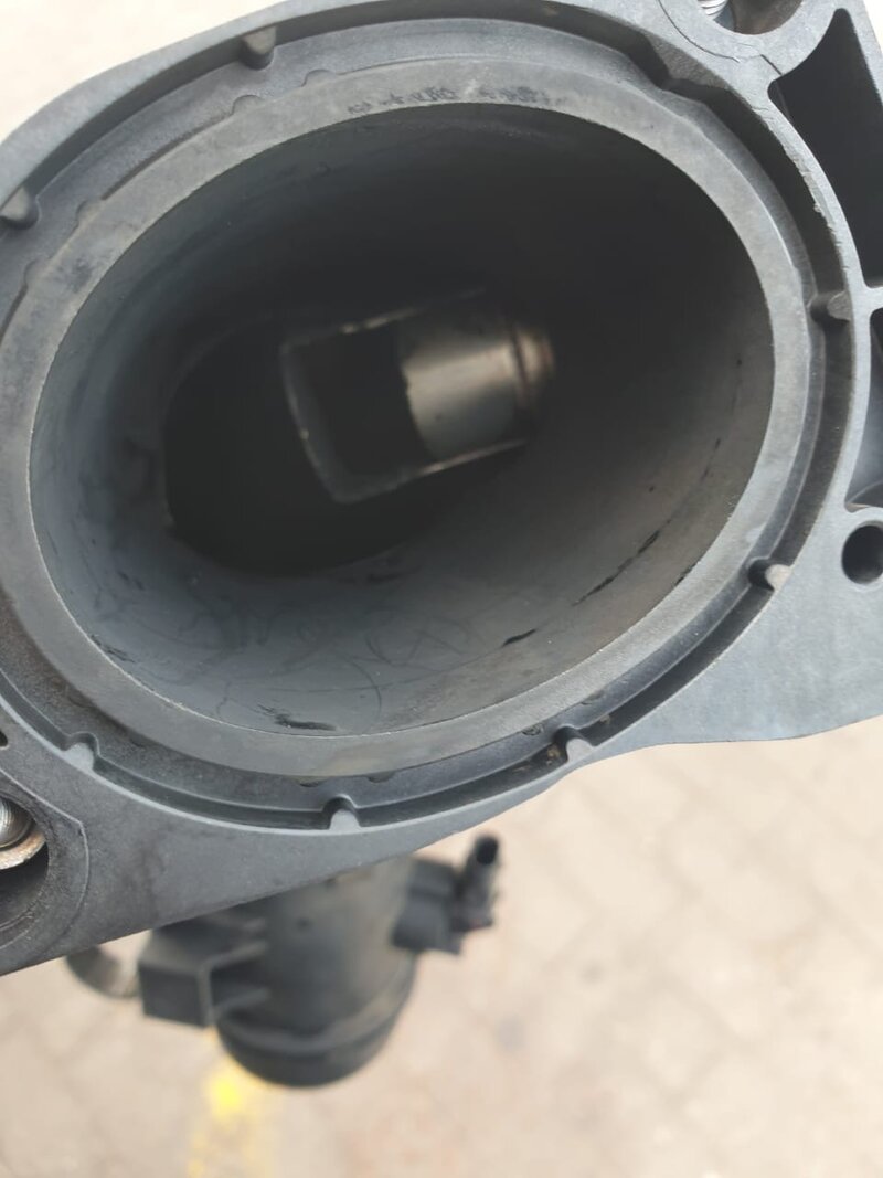

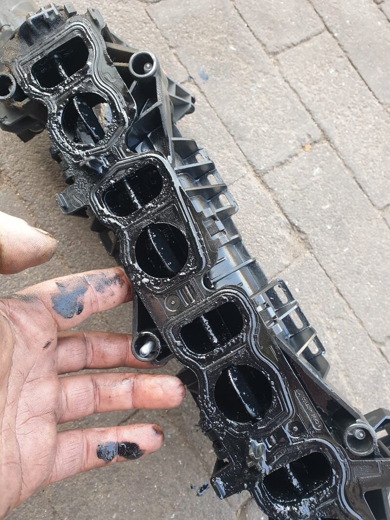

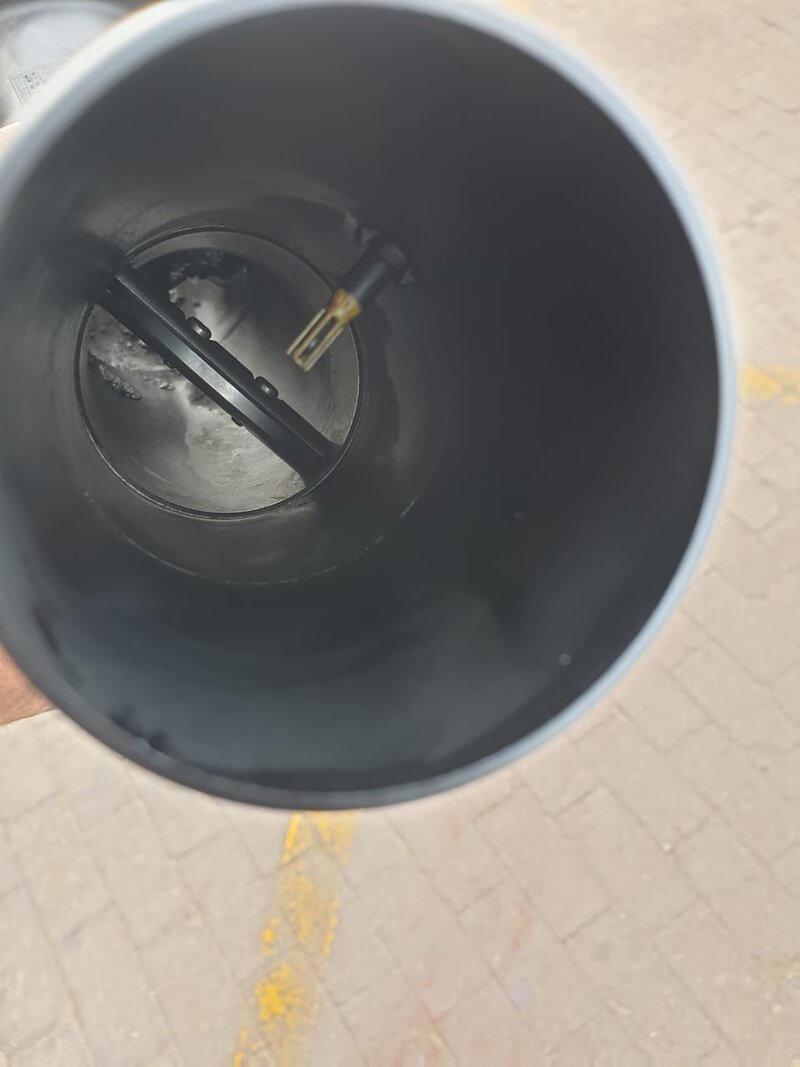

Update time

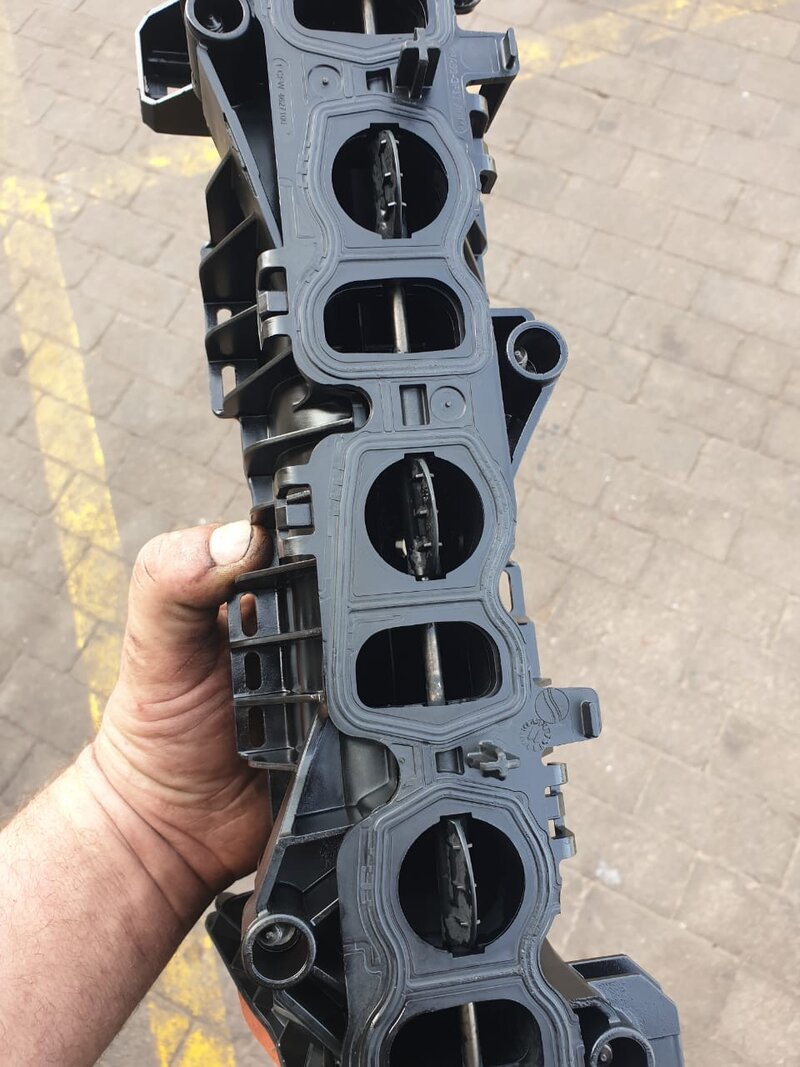

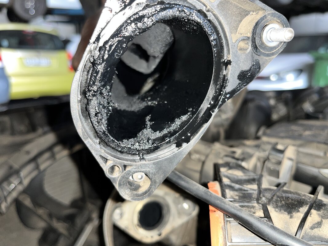

I posted about a rotten egg smell in the battery compartment a few days ago. It turned out to be hydrogen sulfide from the battery itself due to it being overcharged by the alternator.
New alternator fitted today and everything seems back to normal. Will still monitor the battery closely hoping it didn't take damage.
On another note. Whilst the alternator was removed, the technician had a chance to properly clean my intake manifold, throttle body etc. Was surprise at the amount of carbon and sludge in said parts.
The car is on 237 000km now and I deleted the egr around the 200 000km mark. So, carbon build-up most probably occured prior to that.
Other than that. No complaints, 320d all day.
Attached are some before and after pics.

Did you find any improvement in drive and consumption after the clean?
DRCraig
Ok that's interesting. I thought it would have helped with consumption a tad.
Asking for better consumption from my 320d is pushing it🙈,but I totally get you. Maybe my ECU is still adapting 150km after the clean.

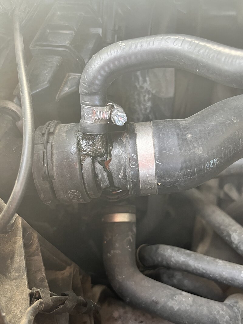

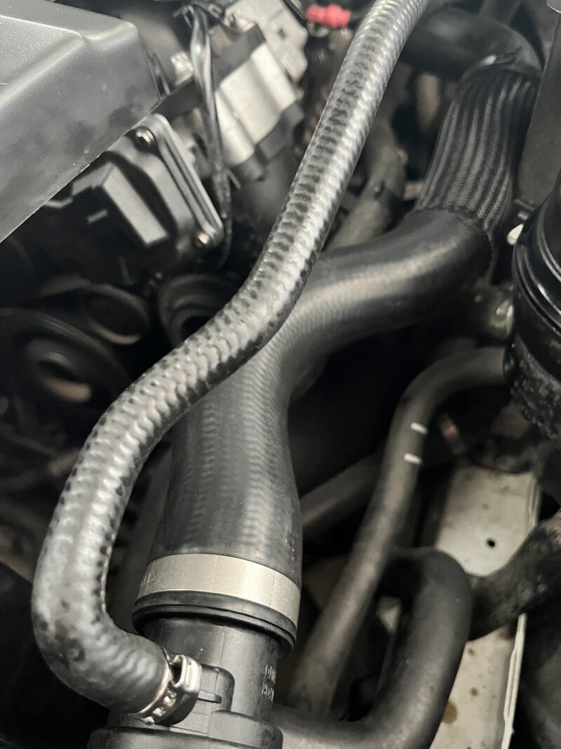

Last week, I noticed the low coolant warning light came on during my drive to work.
Fortunately, I always keep a 50:50 coolant mix in the car, so I was able to top it up—took about 1l to bring it back to the correct level.
Upon closer inspection, I found a slow coolant leak coming from the fitting where the expansion hose connects to the upper radiator hose.
I parked the car for a few days while waiting for the replacement part.
Everything sorted and will monitor closely.
