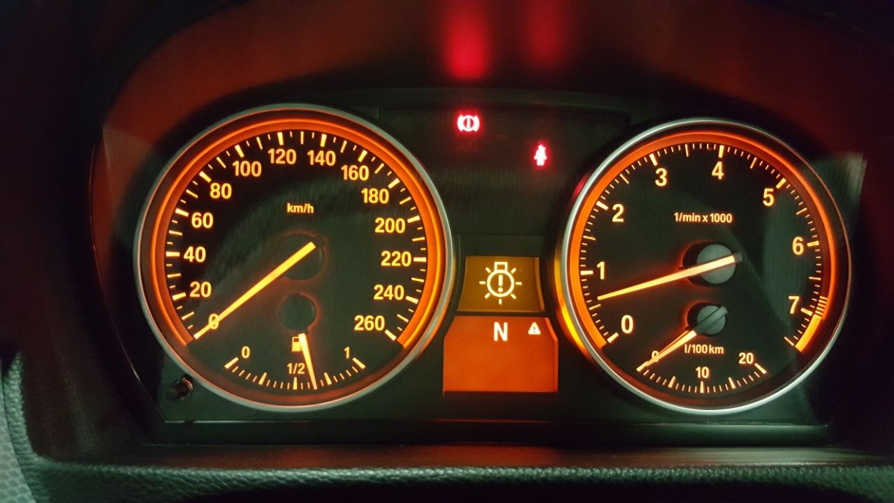

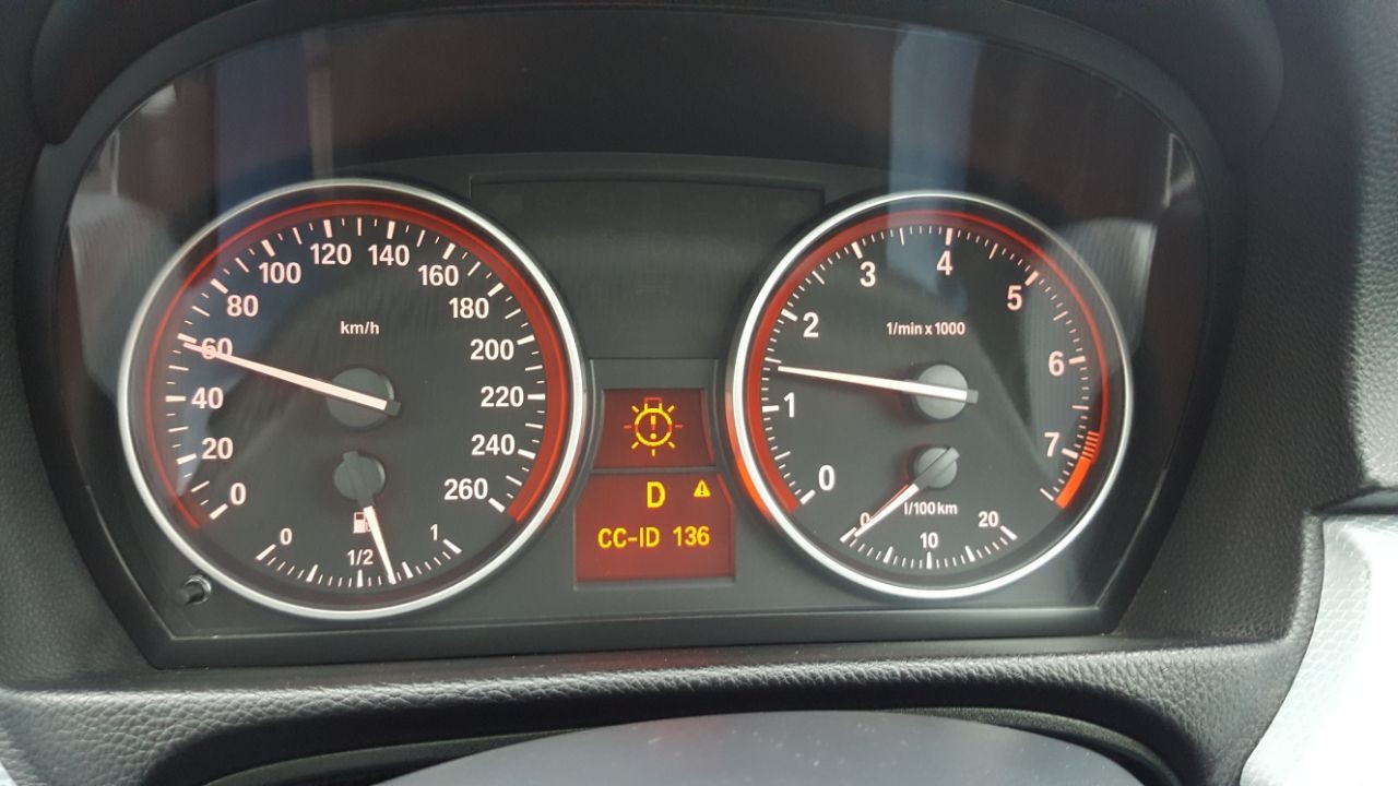

I have an error CC-ID-136 on my dash this morning and when I check all lights they appear to work properly.. head lights, rear lights, blinkers, reverse lights, fog lights, license plate lights, etc.
Any ideas what this means?

E90's have double bulbs at the back. The second bulb is a backup if one fails. So it might NOT be visible which ones have popped!
I think CC ID 136 is left brake light...
corp
It definitely is the left.
When you install the new bulbs (a very easy 1min job), ensure the connections are clean and you clip everything back in tight.
