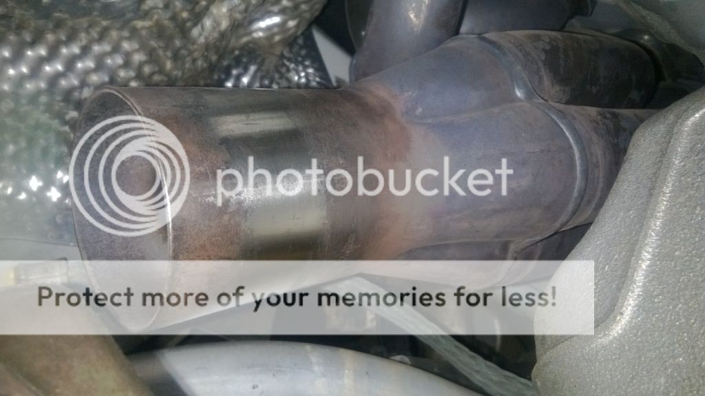

There is only 1 issue I could find, and that is the exhaust is leaking slightly on the gasket between the manifold and the front pipe.

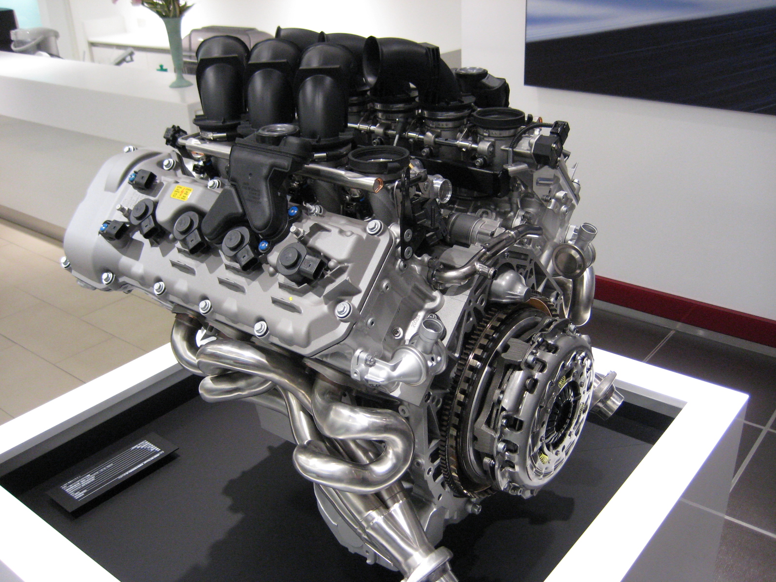

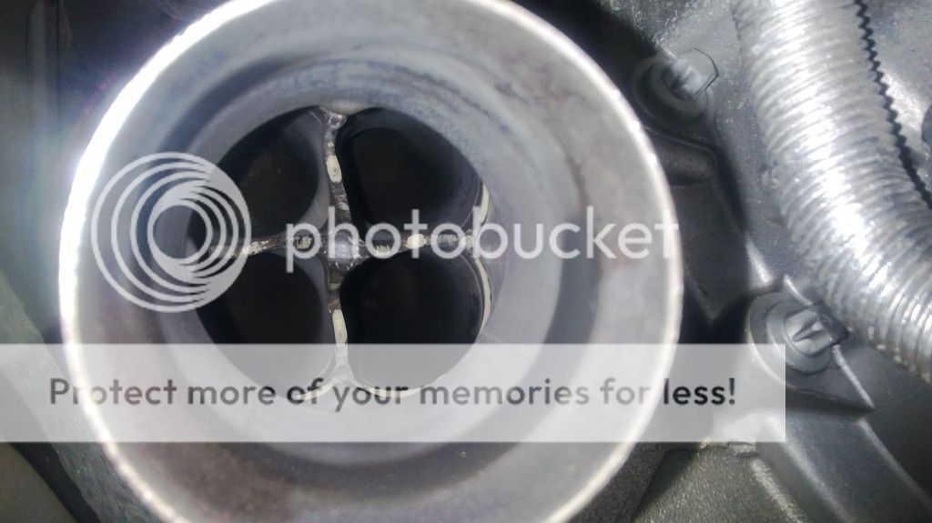

One area where they certainly still very much know what they are doing is on the headers.
I managed to fix the leak by replacing the lead taper gasket and cleaning its seal surface.
Just look how nice those collectors are “dimpled” to aid in preserving velocity.
Inside it has a little pinnacle right in the middle of the collector where the 4 pipes meet also for airspeed.
They are equal length headers (obviously borrowed from the web)

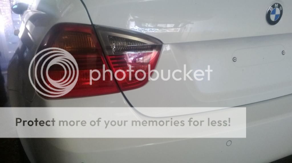

Thanks to Andy who gave me some tinted laminex, this will be the only "mod" I shall perform on this car....
before:
After:
