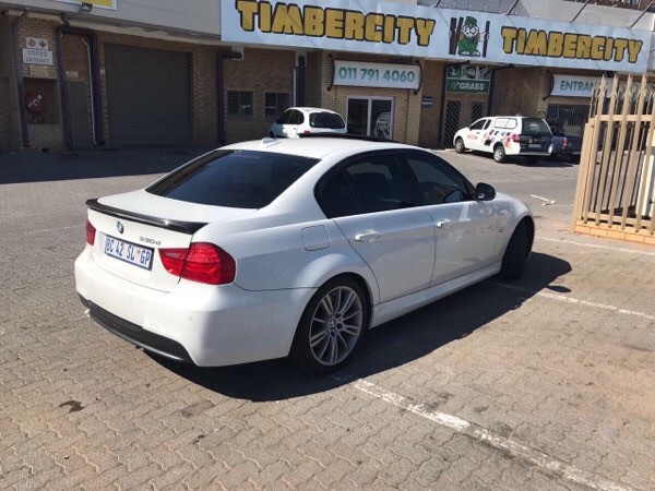

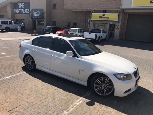

I have been tempted for a while to have smash and grab installed and finally took the plunge.
Kuvi@VPSRandburg fitted a 35% 100 micron film and I am chuffed with how it turned out.
