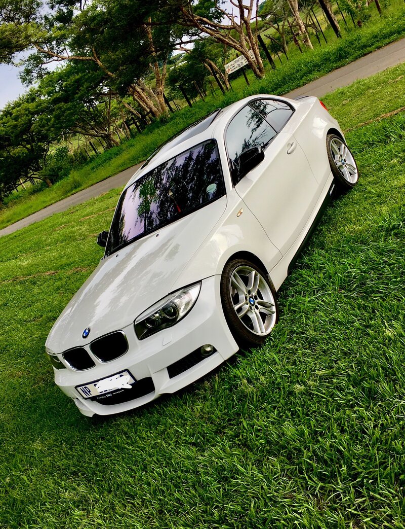

Hey everyone. Really grateful to be here. This is my 2013 120d - been an absolute joy to own and honestly, the best car I've ever driven. Its factory stock standard. I've owned it for ten years now and in that time have done the regular services and changed brake disks. I've also had to replace a sensor in the engine compartment which was causing some kind of electronic fault. And the engine drive belt - it was the rubber one. Bought her with 60k kms and now she's at 105k.
Honestly I should have joined here years ago - could have learned so much. I would like some advice please. I need to make a long journey with the car - about 1500 kms next year. What should I replace/do now as preventative maintenance so that I reduce the chances of breakdowns while on my journey? I wanted to replace all hoses and pulleys, but my mechanic advised that we just change what looks worn. Also, I want to put in an Android head unit - something with navigation and a really nice screen - any suggestions? Lastly, I have the 'chinese' make tires on - sizes 235(front) 255(rear) 40 R18. I would like to put on better tires - nothing extreme - just for really good road handling, especially in rainy weather. Any and all advice and suggestions will be really appreciated guys. Thank you so much.
