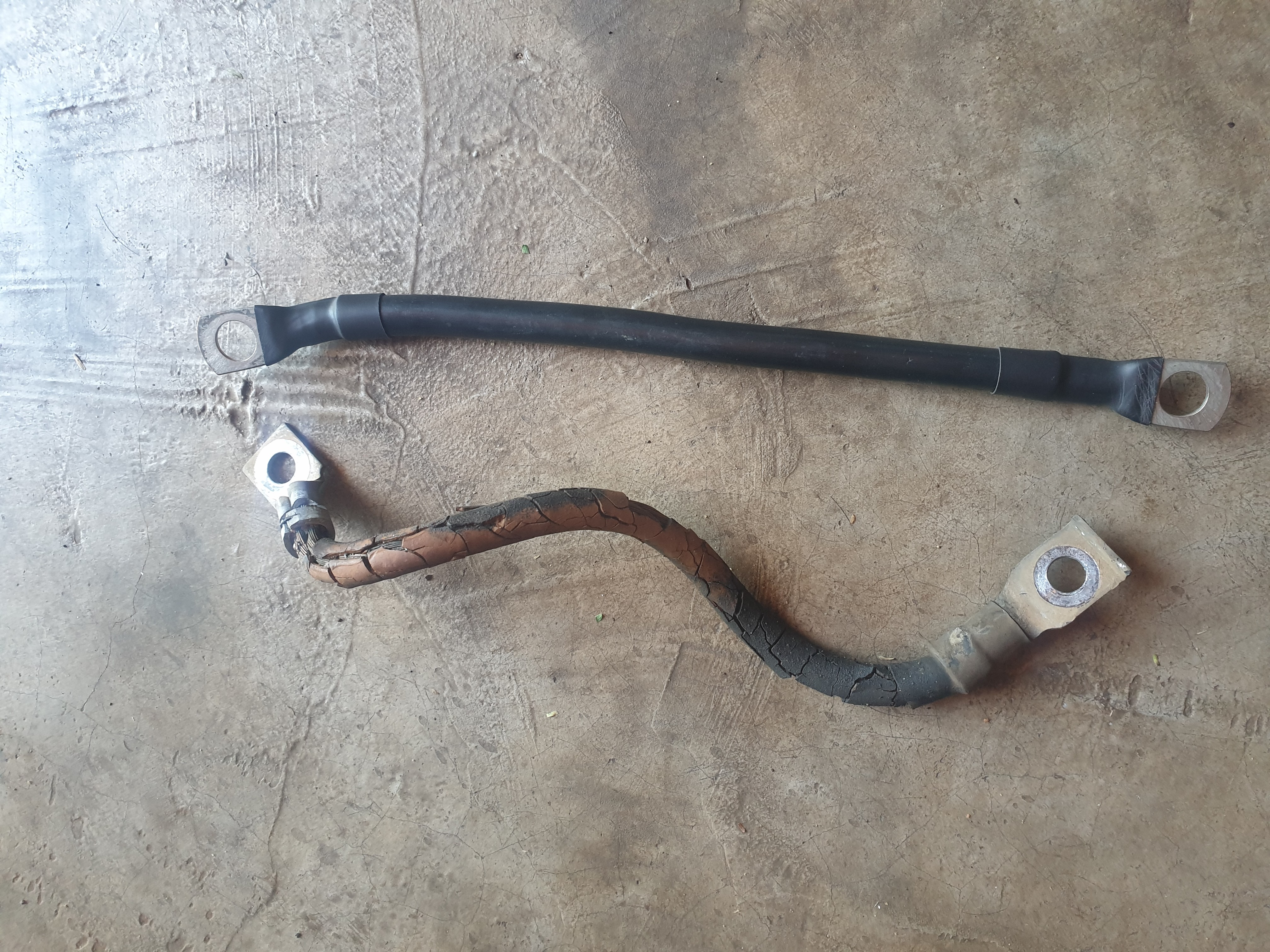

We also checked the earth cable looked terrible so we changed that as well
Old vs new

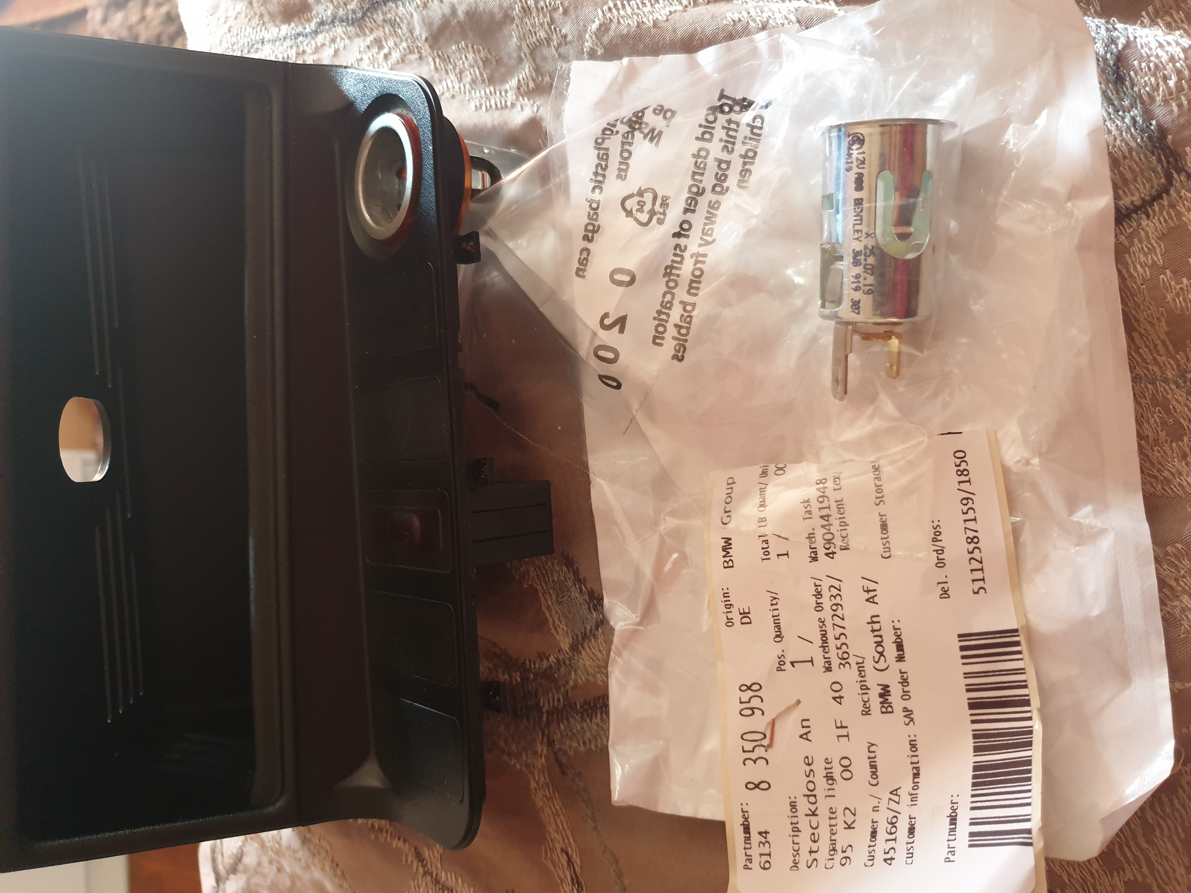

Kept having issues with the cigarette lighter not charging my phone and constantly blowing the fuse...
Of to bmw again for a new one...
All these small issues are expected and just makes you love it so much more when its fixed properly

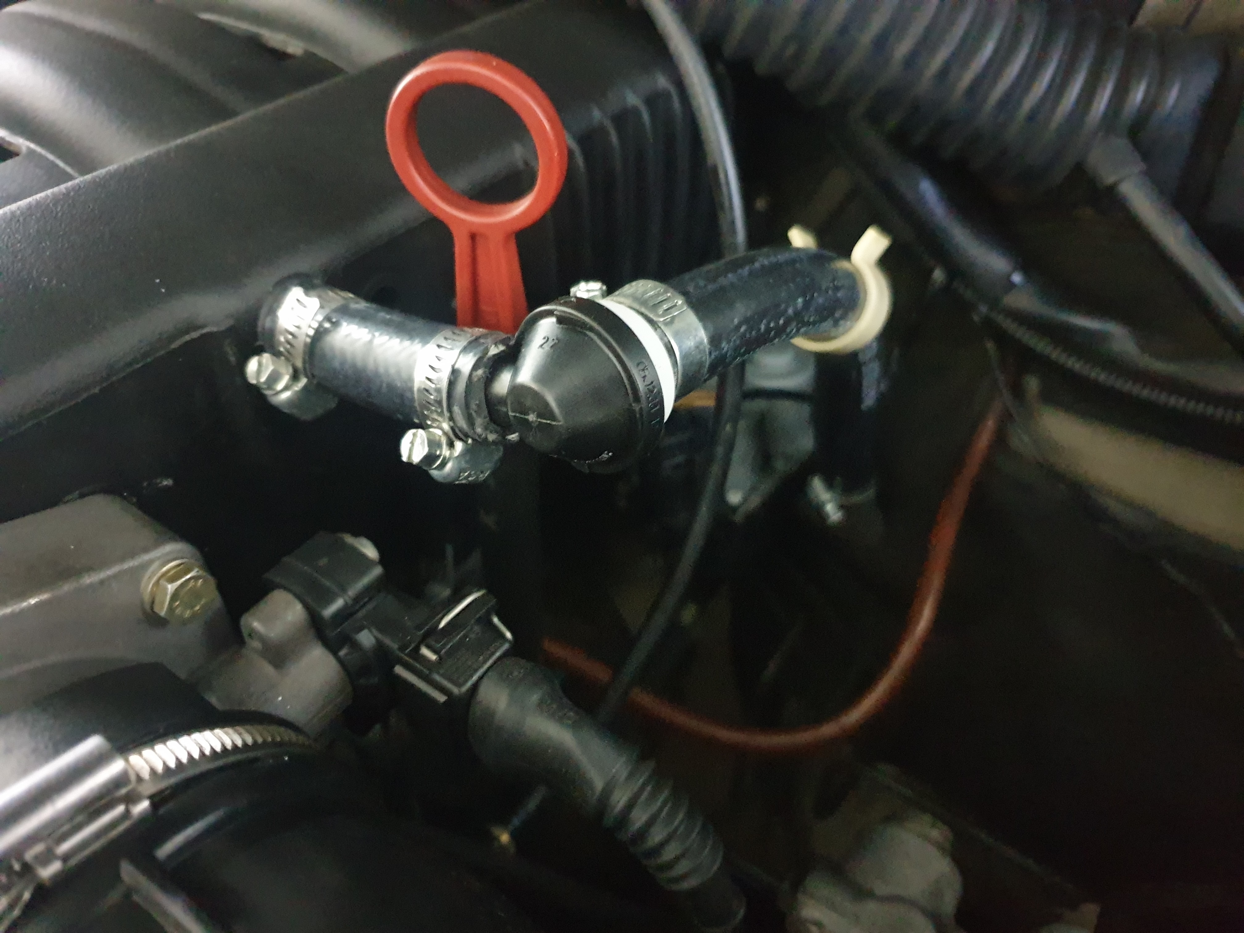

So long story short after lots of testing we found that a stupid o ring on the crank case ventilation line was worn out and wasnt providing a good seal on the tappet cover.
Bmw does not stock these anymore so i wrapped some insulation tape around the seal as a temp fix...
Drove the car for 2 months now daily and no pressure light :)

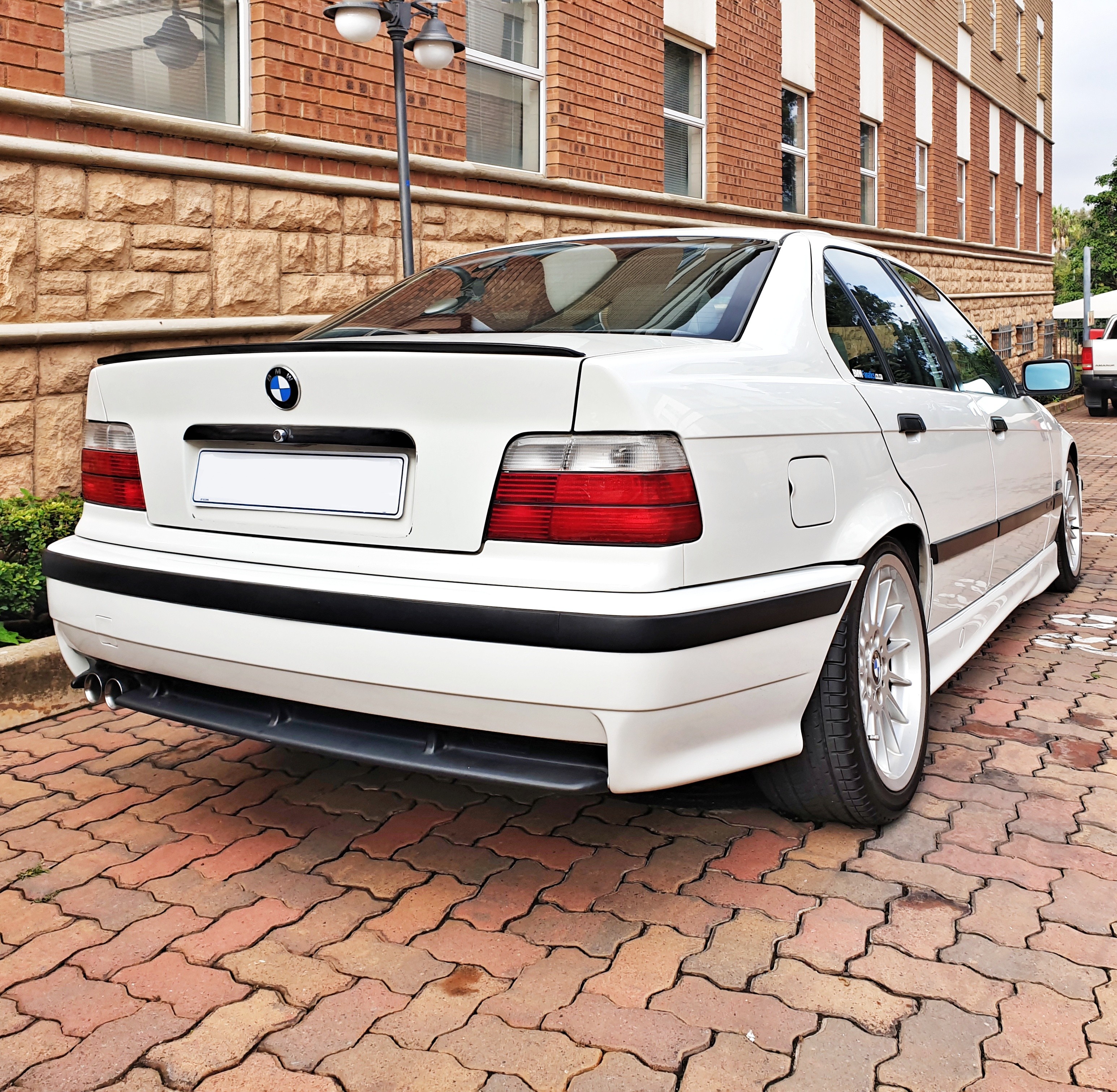

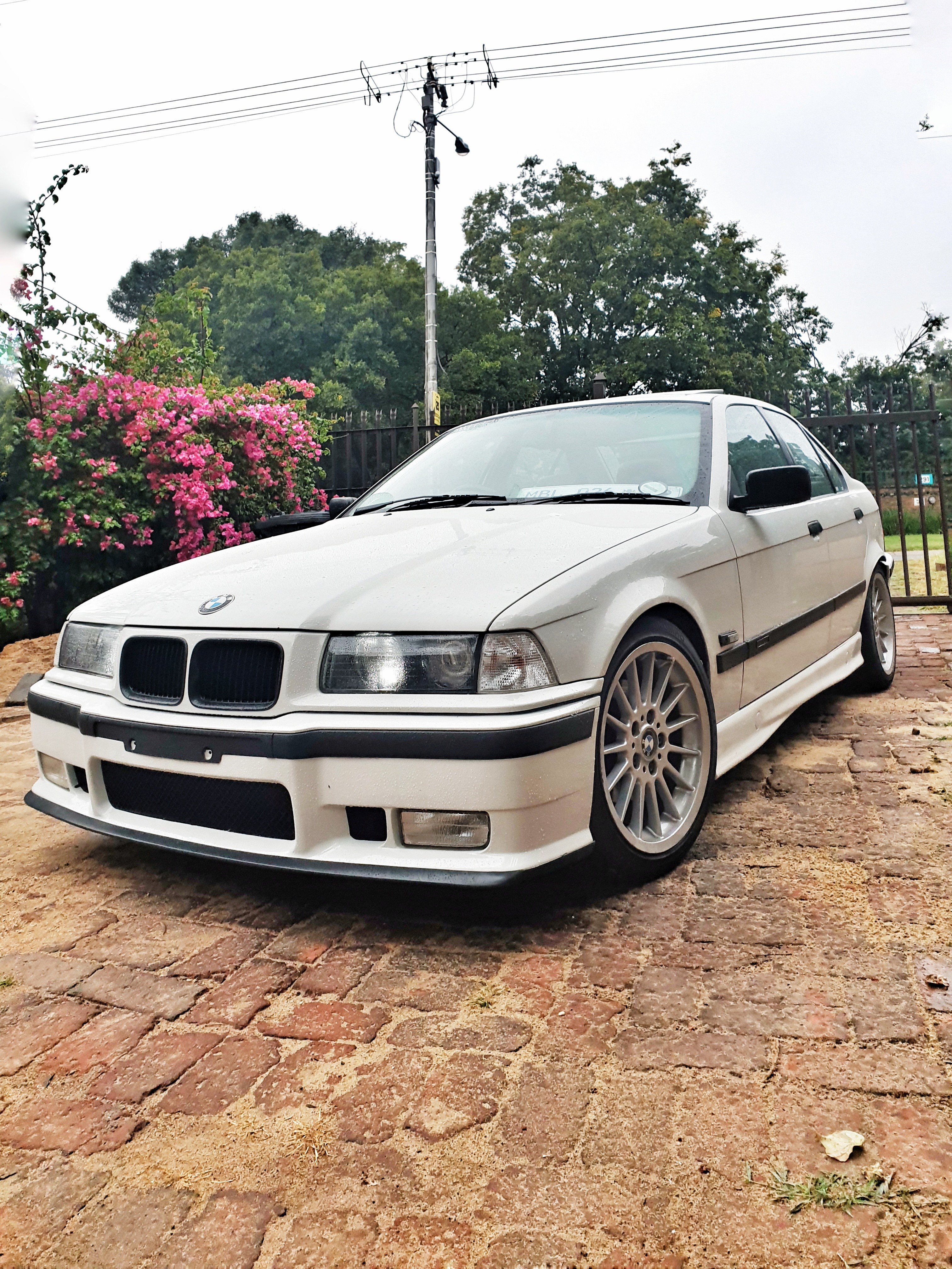

Been a while since updated.

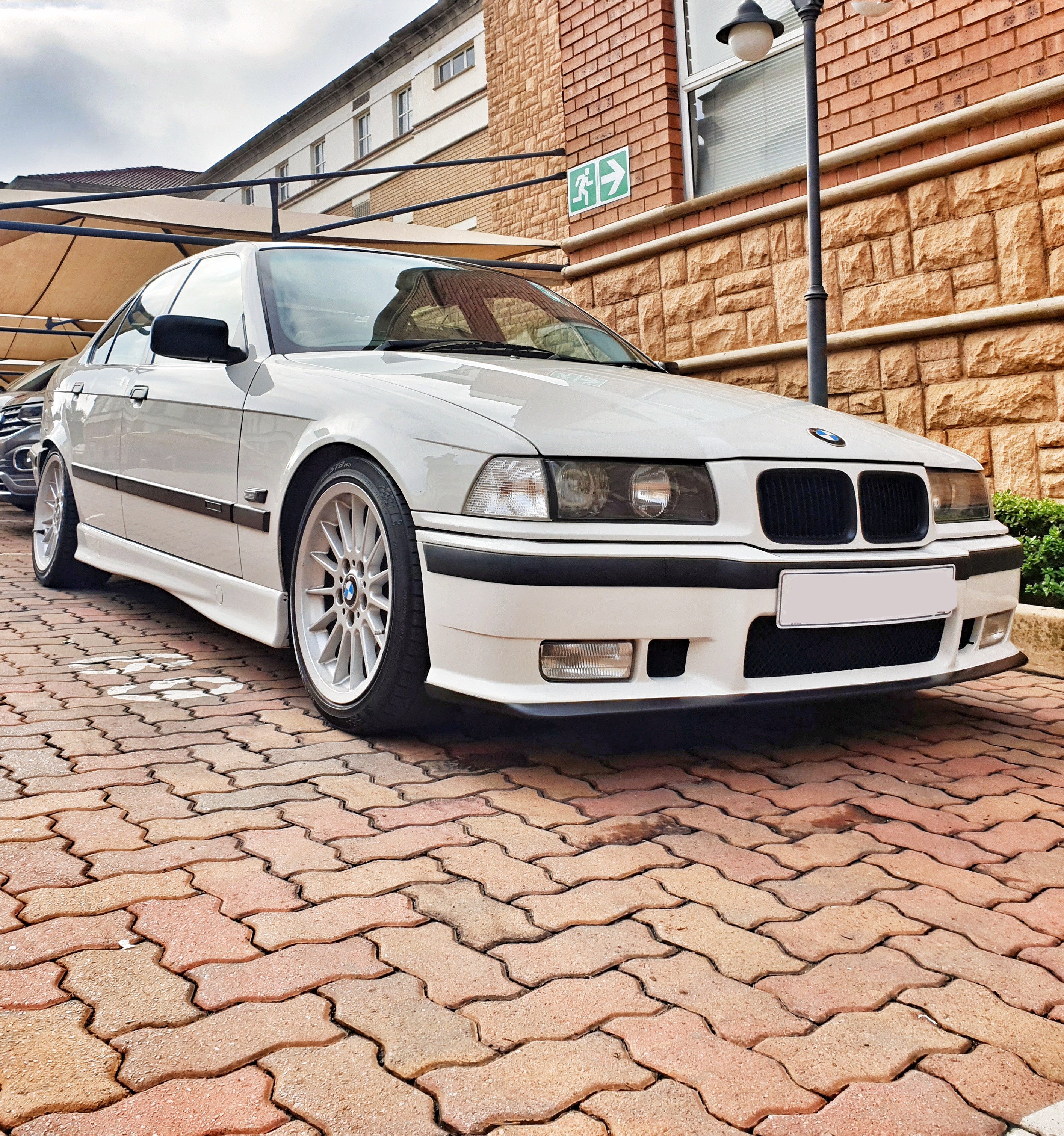

Fitted OEM rear M3 bumper and side skirts.
Got a plastic M3 front bumper from Autostyle which is actually really good quality.
Thin lip boot spoiler.
New shock mounts and set up the coilovers properly. Ride is 10x better.

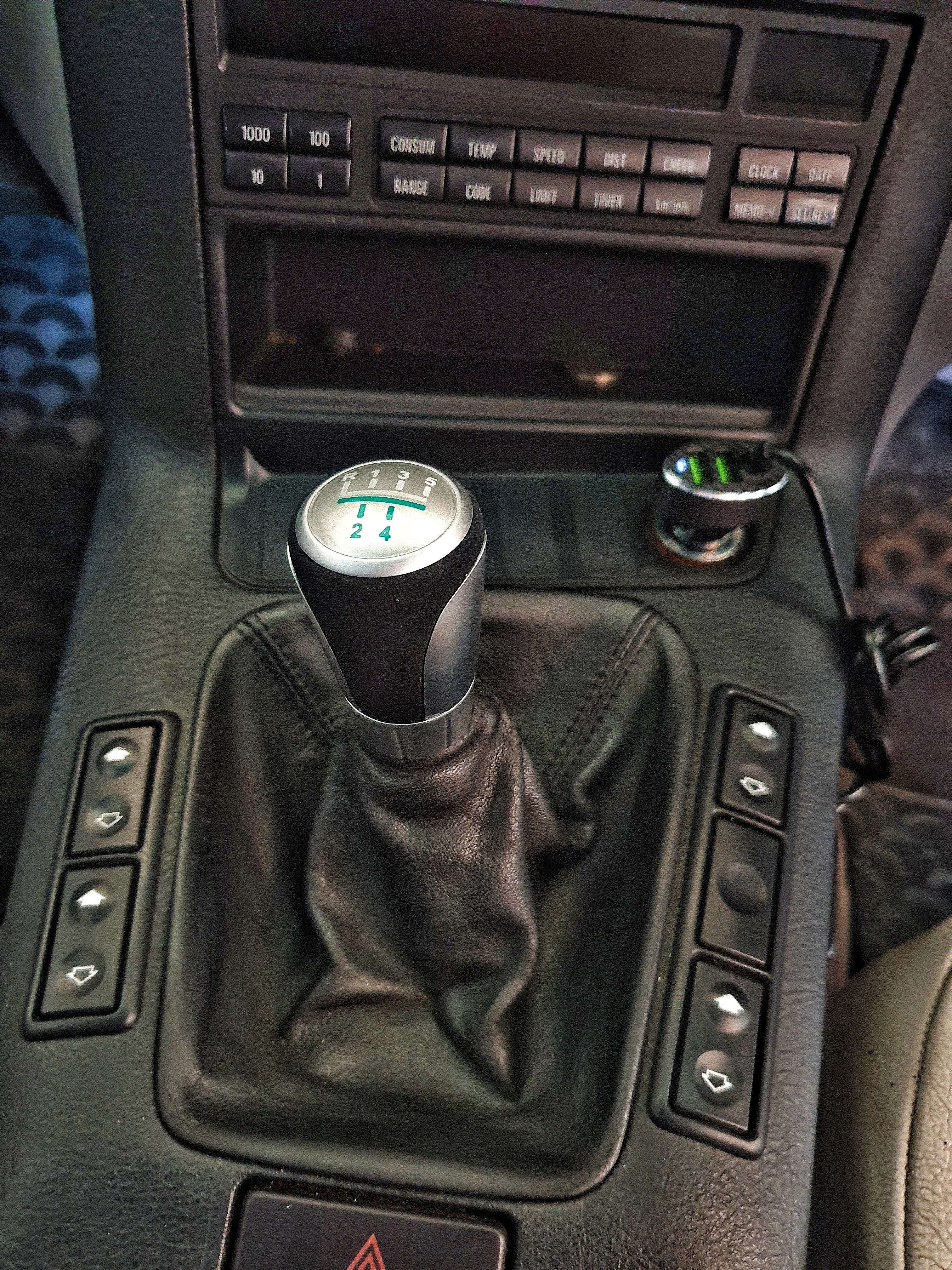

Performance style gear knob

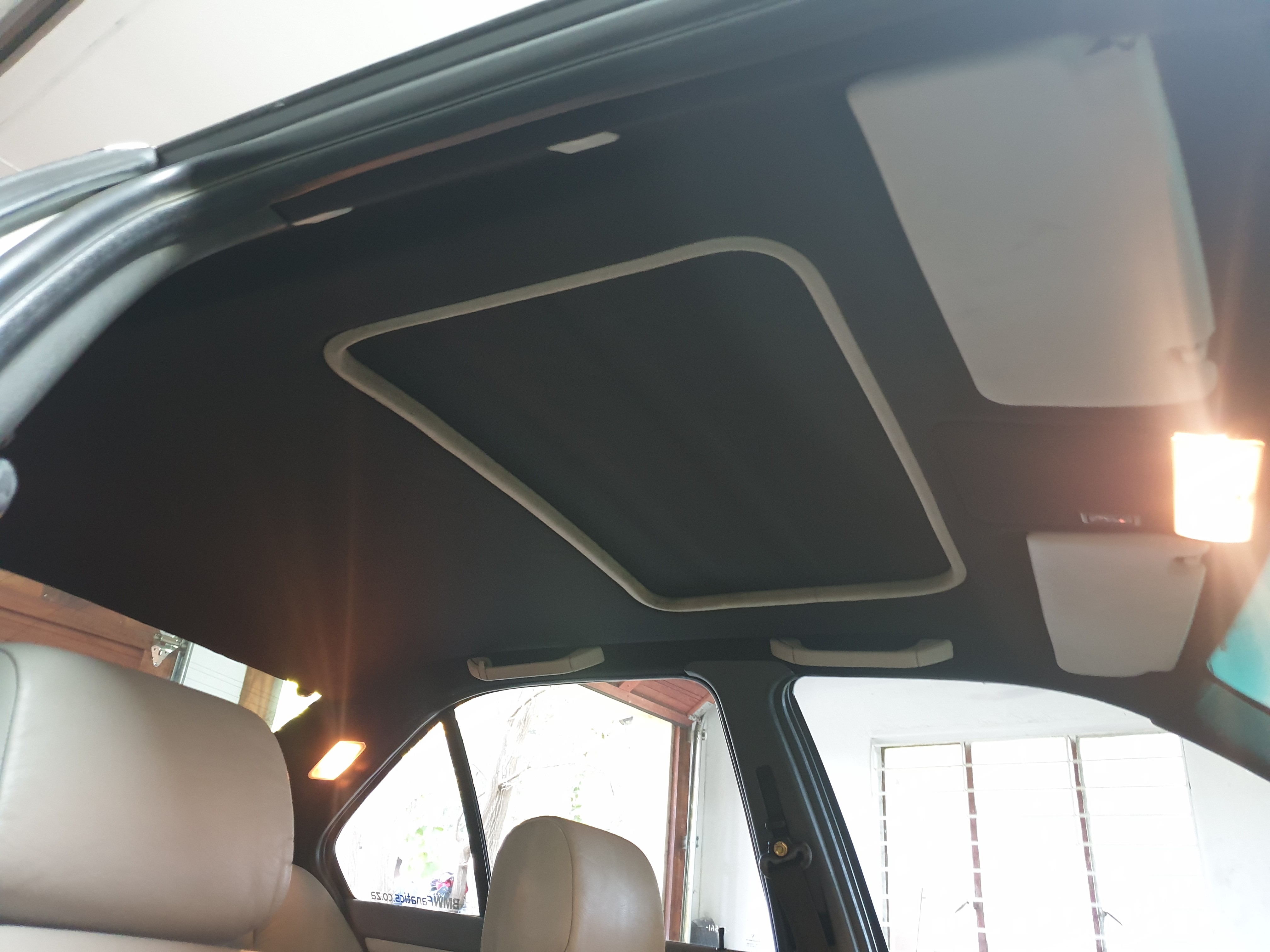

Redid the roof lining. Guy that came out did a brilliant job. Decided to go with black and keep the grey parts. Actually looks much better than i thought.
Then i fitted Smash and grab at Carbon Bros. Brilliant work from them as well.
Im thinking of changing the wheels next to polished m3 wheels. Still deciding..
Some pics:

Pls send the contact details for the guy who did your head liner..
