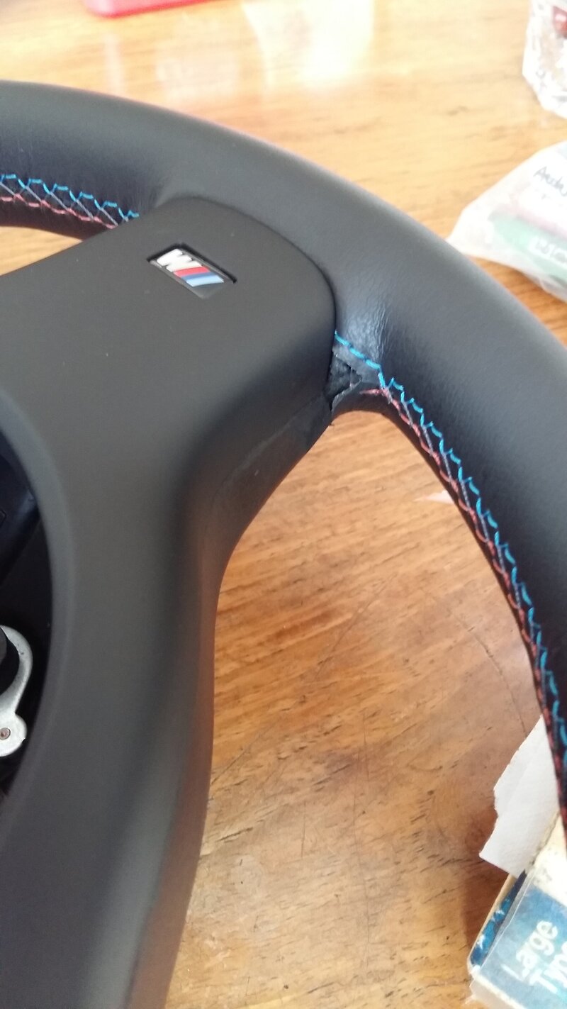

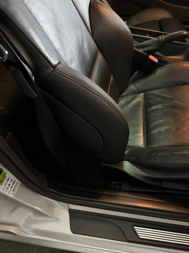

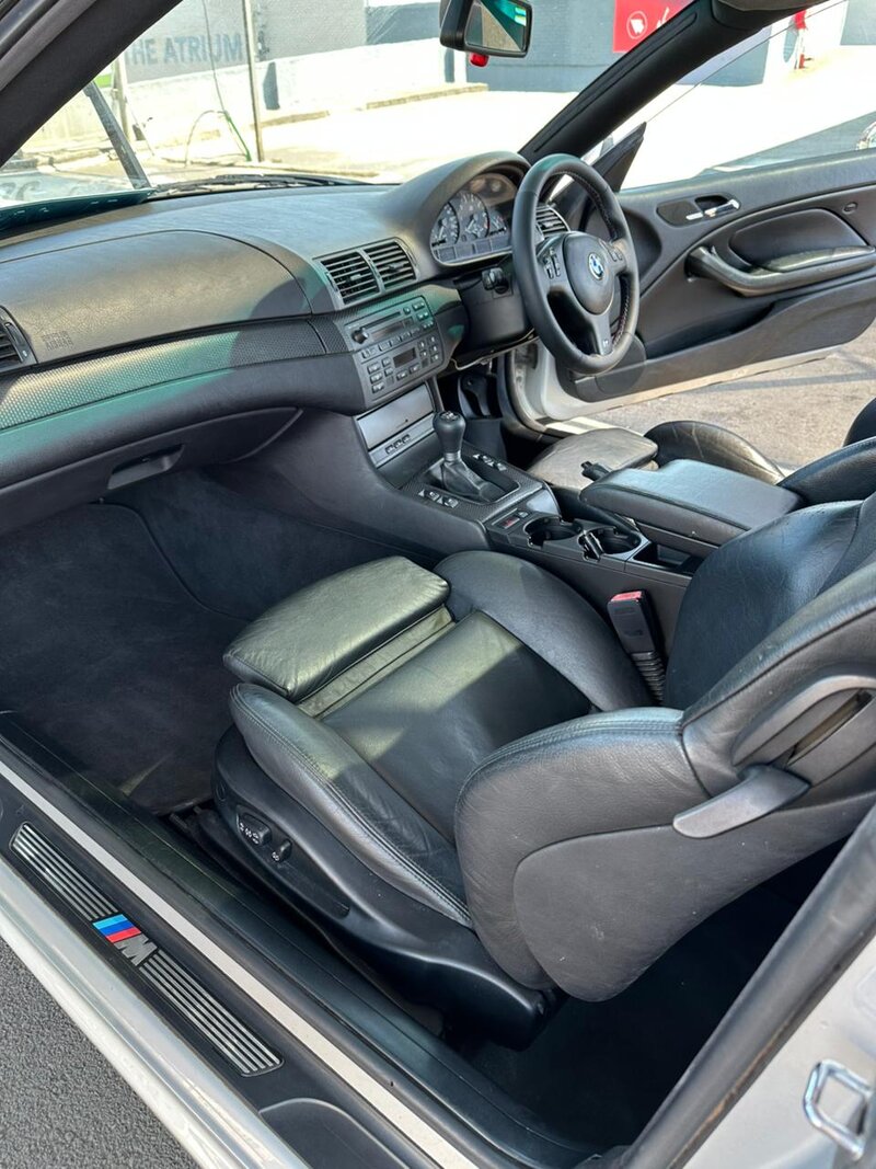

Steering wheel and seat bolster re-covered. Planning on sorting out the middle bit when it goes in for the airbag recall.
Arm rest procured!

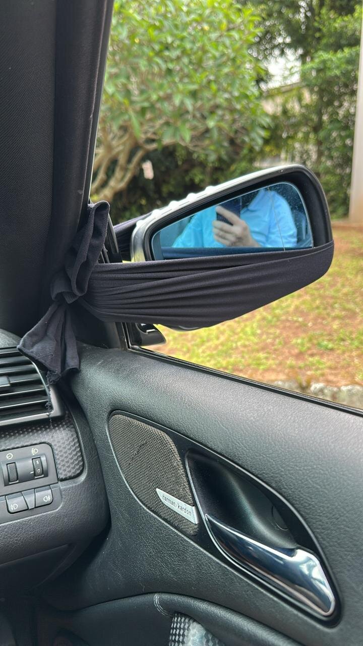

Driver's side mirror was held together with putty and finally decided it needed to retire.
Thanks @DINODENASH for coming through with a replacement.
Arm rest cleaned and fitted.

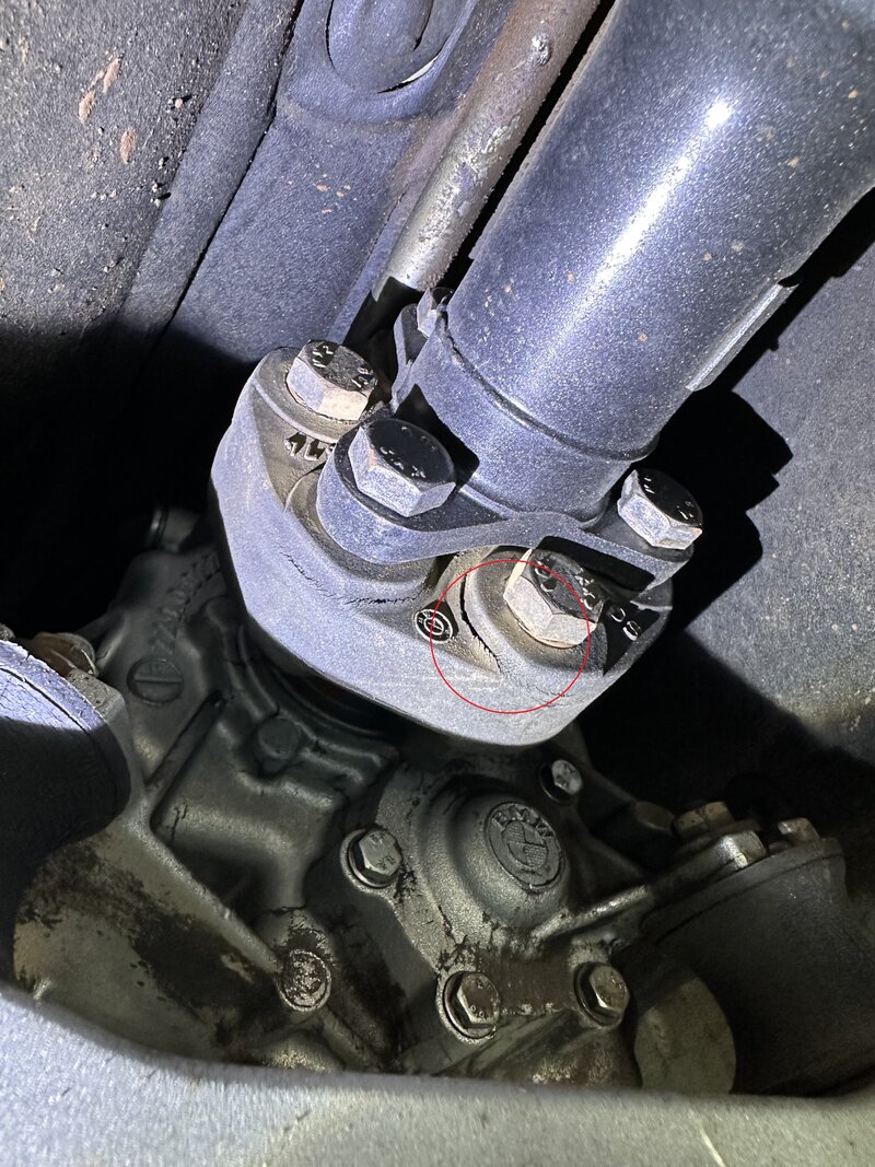

There was a slight vibration and the VD had visible cracks on it.

modocrat
Ohhh is this what you replaced? This is the flex disc/guibo that absorbs driveline vibrations which are speed related, I though you were referring to the vibration dampener on the front of the engine which are rpm related :ROFLMAO:
My bad.
