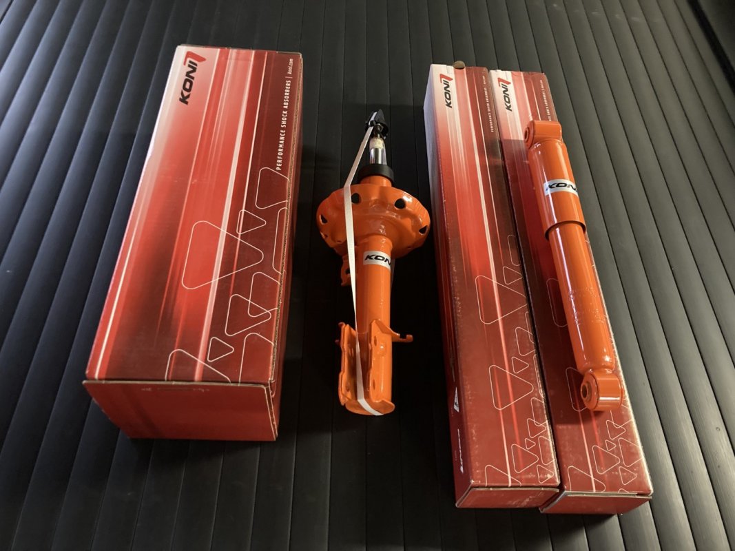

I've revived work on the cars the past couple of months, and the Ute has had some long overdue updates. It has worked particularly hard the past few months, loading carrying all sorts of stuff. The suspension refresh has been on the cards for months, and having got most of the parts together, I was just waiting for front shocks to arrive from Europe.

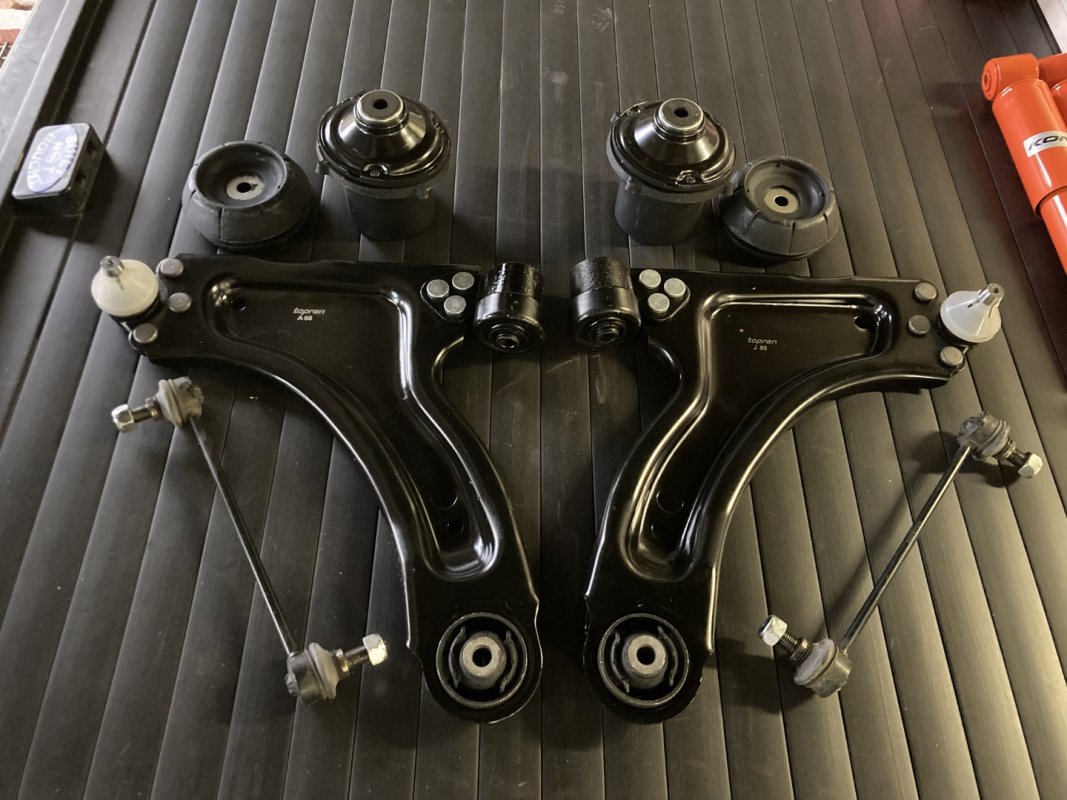

On the list of items to be replaced:
  • Front shocks (Koni)
  • Front shock mounts (Meyle)
  • Front stabiliser links (Meyle, I think)
  • Front Control Arms (Topran - all that is available close by)
  • Rear shocks (Koni)

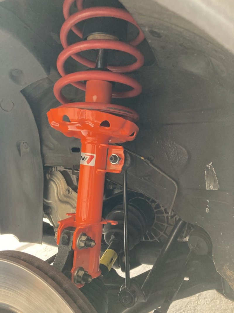

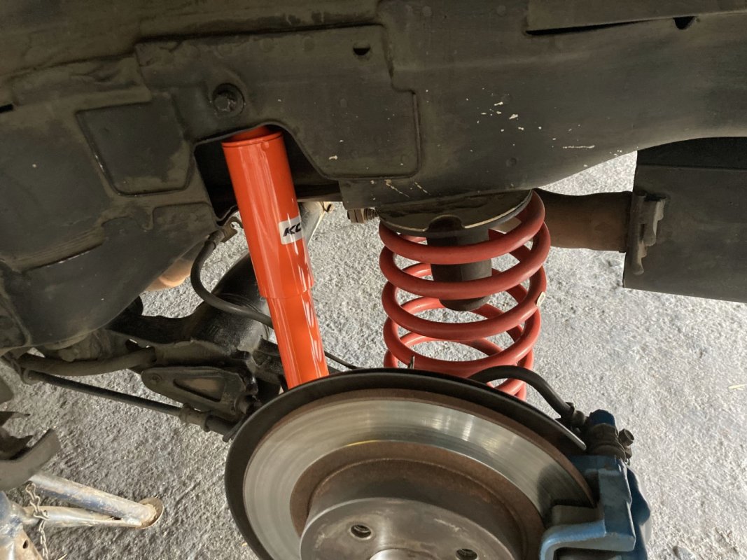

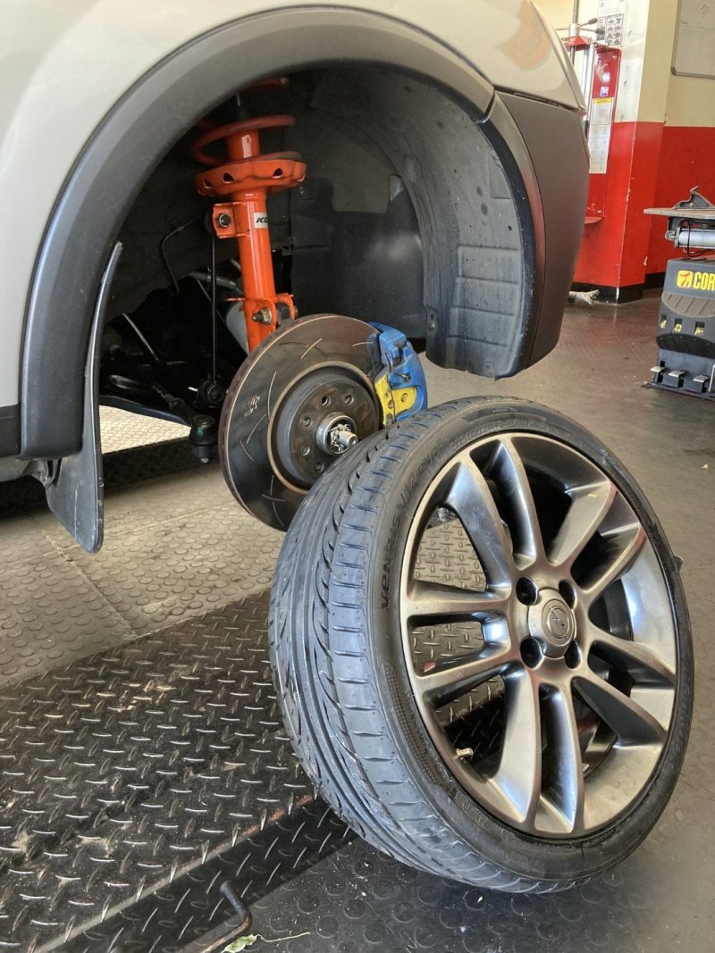

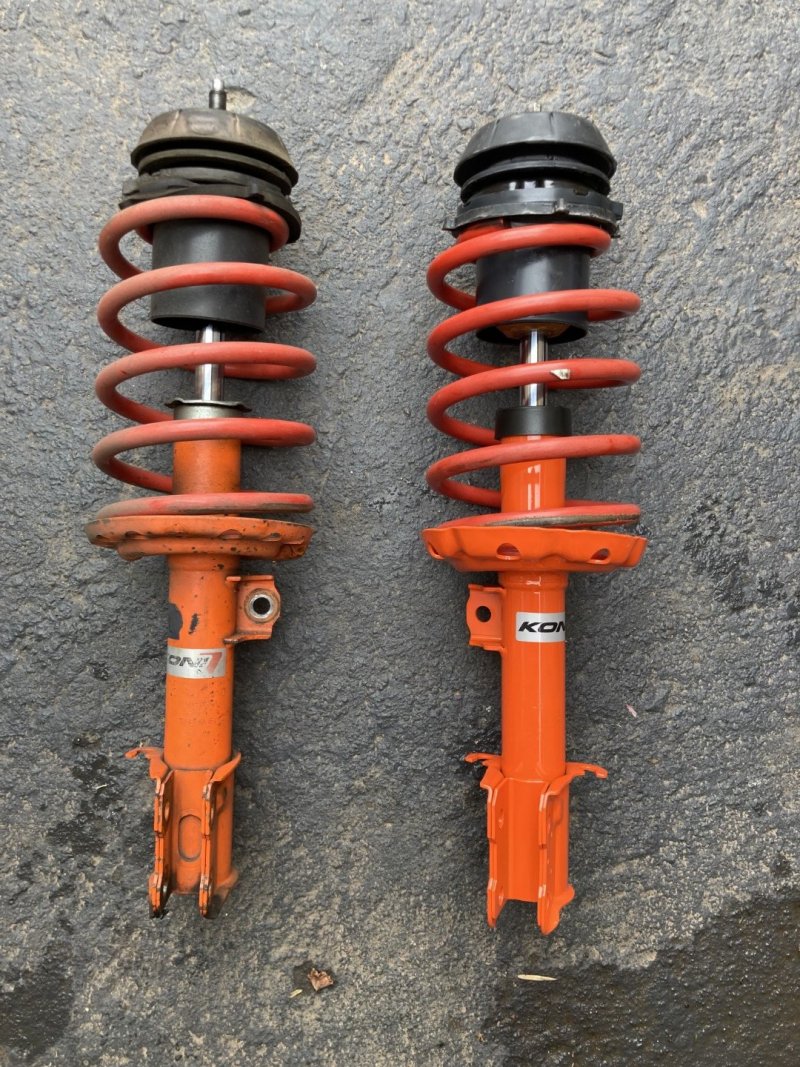

First up, the back of the Ute went up, and the old shocks removed, and replaced with new ones. Note that the old shocks were not bad, but they've been in for 10yrs/100000kms odd, so I thought it's best to change in the bigger scheme of things.

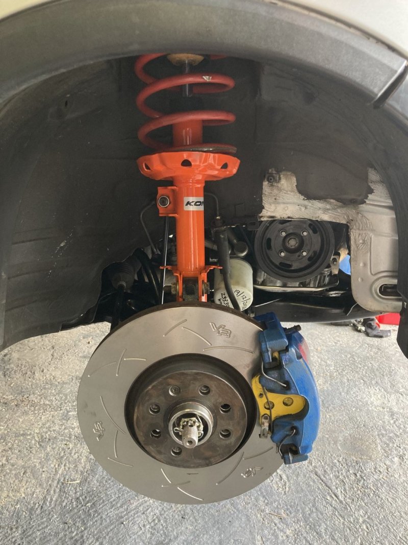

Next was to move to the front of the Ute. All bits were removed, and the springs were transferred over from the old shocks to the new shocks. New shock mounts also fitted.

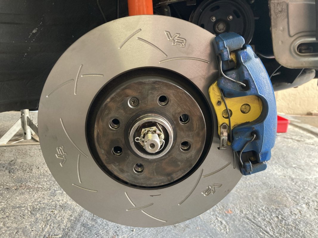

While things were off, I also arranged to have the front discs skimmed very slightly, just to make the face true and flat again, and eliminate any points of squeal from touching on the pads at the edges (there has been an annoying squeal since fitting the new pads a while back). Vari did the skim and slotted the discs again. There is still plenty of life left on these discs, I think if maybe 1mm was skimmed off, it was a lot.
All buttoned up on one side:
With the brakes done, I also did a quick seat clean using some Wynn's Brush Off, and this has revived the fabric. At some point I will look to do a deep clean with a proper machine.

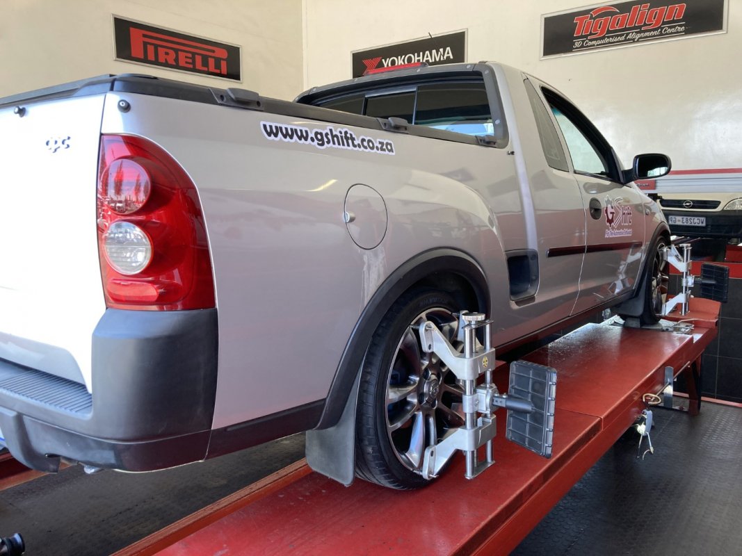

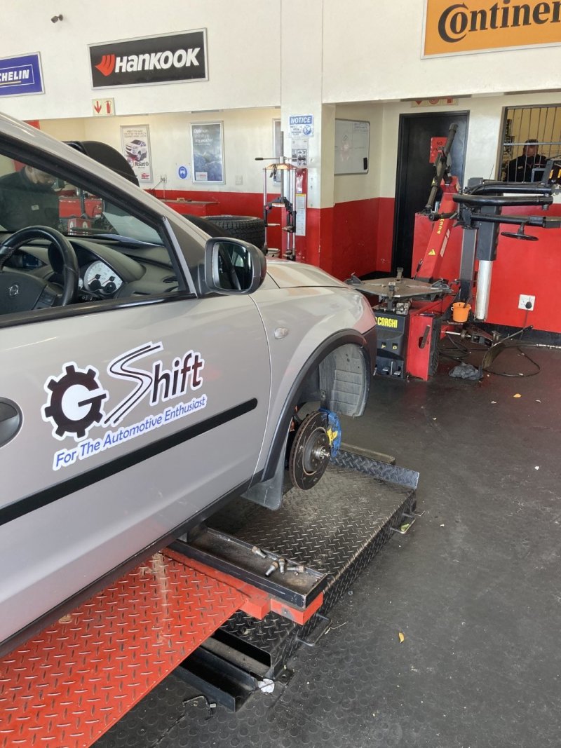

Anyway, off to my friends at TWT Meadowdale. Tyres of choice were the same as previously fitted (and still fitted on the back): Hankook Ventus V12 Evo2. They offer great performance and I've been happy with them. They stood up to lots of abuse at the track day a few years back, and have done very well in terms of wear.
After doing this, I was even more pleased with how the Ute was driving. Peace of mind that it has finally been done is also worth a lot.

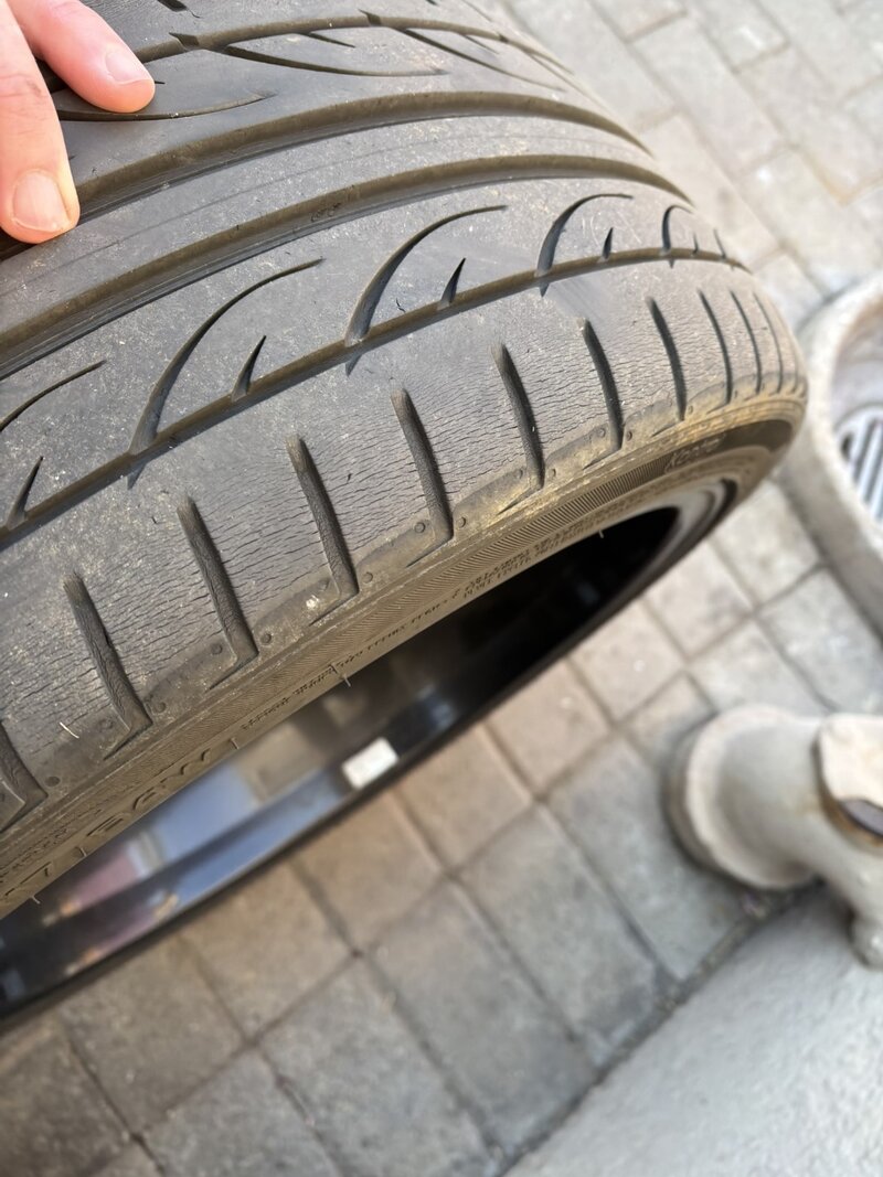

Then, just 3 days later, on the highway there was a horrible vibration through the steering wheel. I was mildly annoyed, as the balancing was done, yet it seemed worse now than with the old tyres. This required further investigation. Then a day or 2 later, the Ute sounded like a jet plane taking off as speed increased from standstill. It was not brake related, nor was it related to any particular gear.
With some more head scratching, I thought possibly that a wheel bearing was failing. We jacked up the Ute, and I guess it was no surprise that there was a lot of play on the left front wheel. So my wheel bearing fitted earlier this year, and having covered about 7000kms odd, had failed.
We jacked up the right hand side, and this also feels like it's starting to have some play. So.... back up on trestles, and the front steering knuckles and hubs had to come out. New parts have been purchased, and these are currently being pressed into the steering knuckles. I should collect this week sometime.

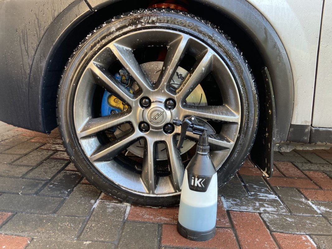

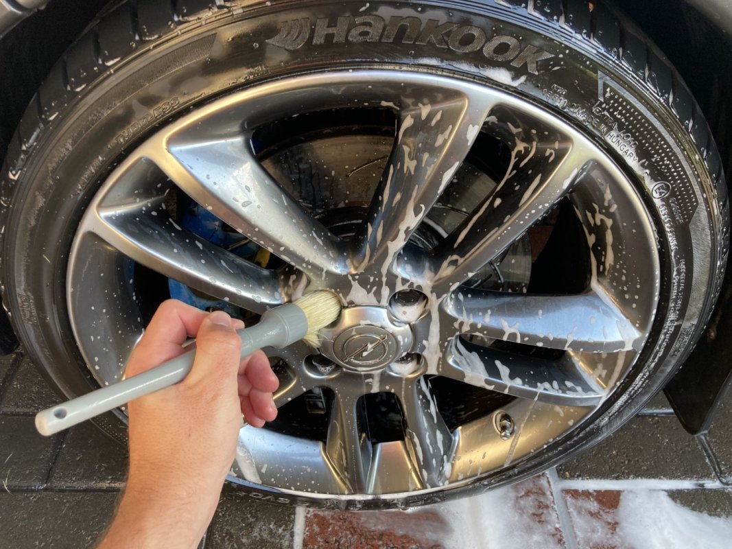

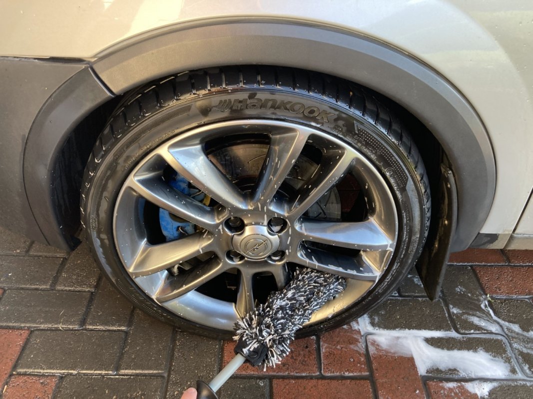

In Feb-22, I had some time to spend on a wash, so managed to snap some pics of the newer wheel and tyre brushes currently in my arsenal. These include the Wheel Brush Kit and Boars Hair brush from Detail Factory, and the Wheel and Tyre Brushes from The Rag Company these products are all available in the G Shift Online Store). My other tried and tested brushes are still in use, with plans to refresh these soon.

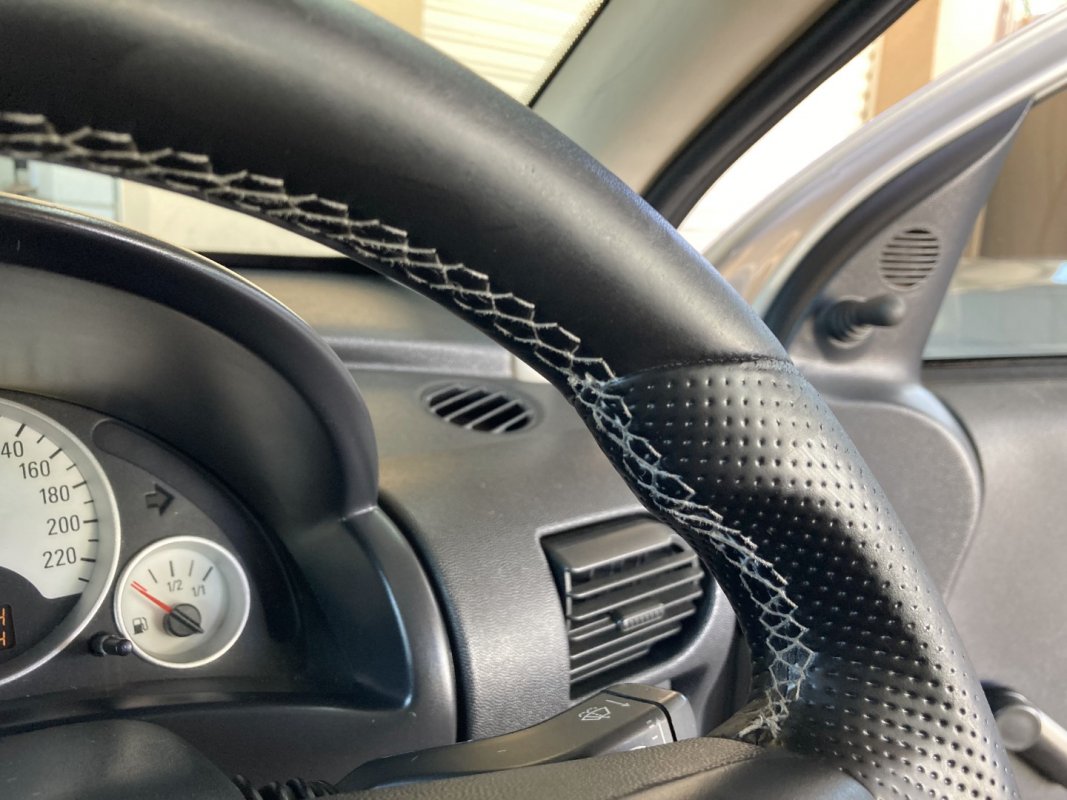

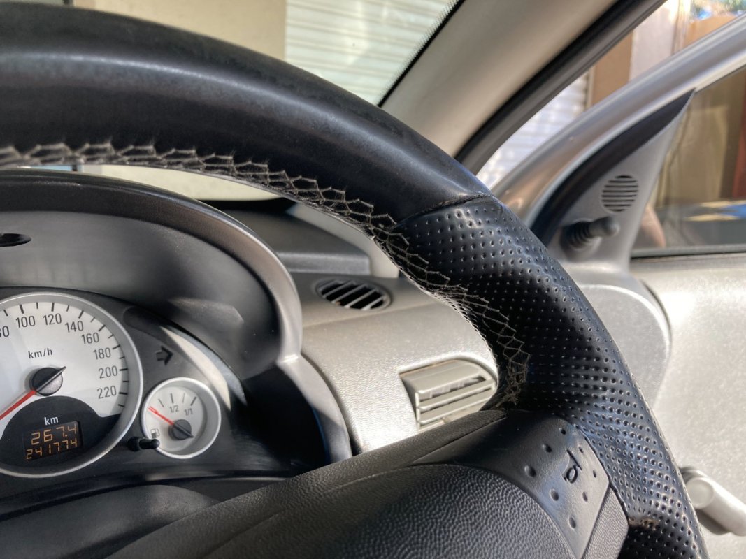

With all the use over the past few months, the steering wheel also needed to be sanitised and cleaned, so spent some time doing that as well:

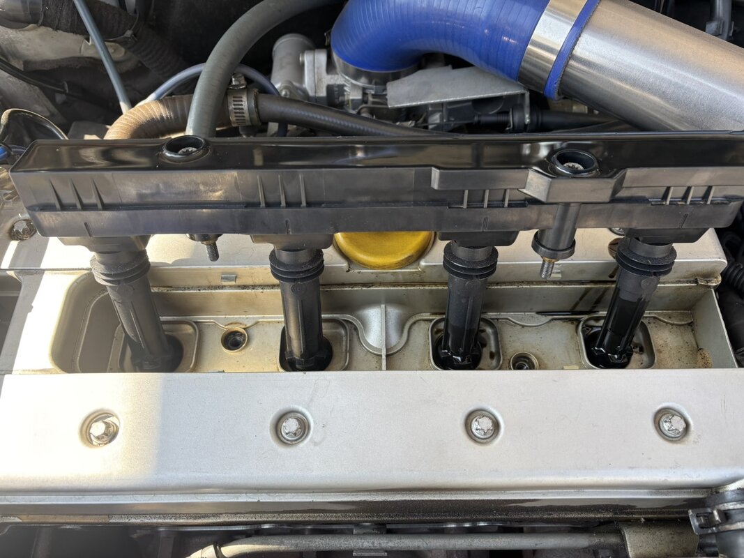

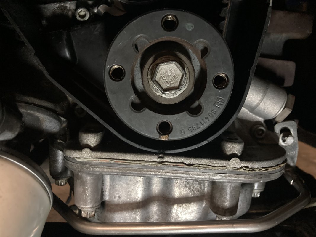

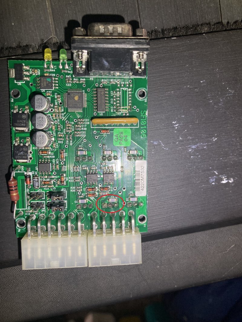

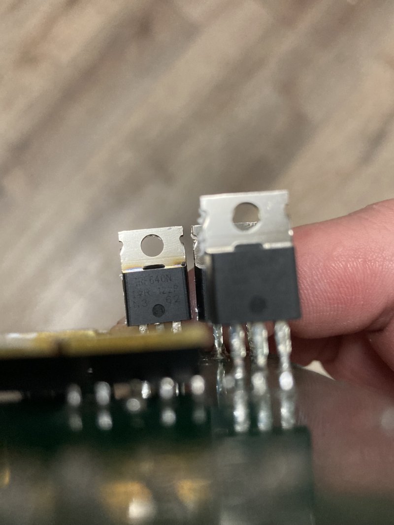

Around the middle of April, I decided to tackle one of the many overdue jobs on the Ute, that being to replace the coil pack plug on the wiring harness. I’ve done this previously. It seems to be a common issue on these, where the rubber insulating piece on the plug itself does not block out all moisture. Over time, the pins in the plug corrode, resulting in poor connection and then subsequent misfire which I was starting to experience. Fast forward a few hours later on a Saturday, and the plug was swapped out, yet the Ute was now idling constantly with a misfire.
I re-checked all my joins on the new plug, and traced and checked other wires in the harness, fuses and so on – no luck. Eventually, I traced the issue back to an issue on the ECU board itself. I contacted Spitronics and made arrangements to go visit their area agent to check and repair. It turns out that the transistor for ignition to Cyl4 had blown. In the pic below, you will see the suspicious contacts circled in red. And the blown transistor seen from the other side of the board.
About 10mins later the ECU was repaired, at no charge, and I headed back to refit and test. Big thanks to the Spitronics team, their customer service has always been great in my opinion. I refitted the ECU and the Ute started up 1st time and idled smoothly once again. We are not sure what could have caused the transistor to blow, I suspect maybe current jumping between the corroded terminals on the coil pack plug or something.

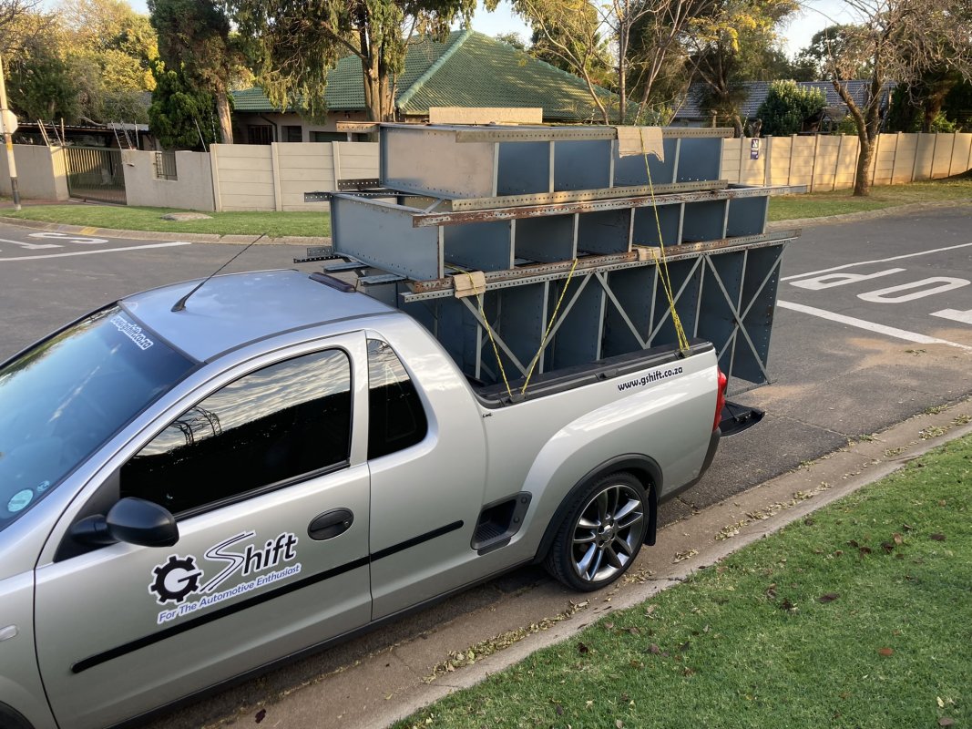

With the Ute back to driving duty, it was about to become a long and hard few months of work ahead. Starting off with clearing out a lot of stuff from my Parent’s house which had been sold. I moved everything from furniture, to boxes, to appliances, to bricks, and of course some shelving. Some pics below of workhorse duties taking place.

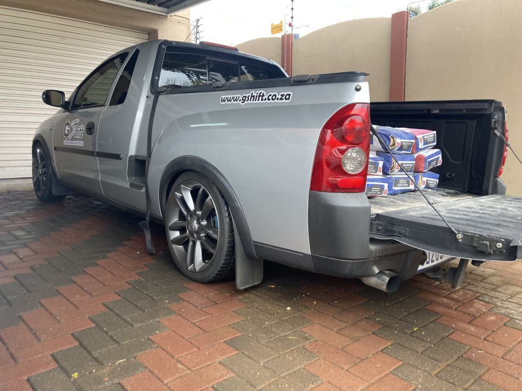

This was approx. 250 bricks on the back, and some scaffolding and other bits and pieces:
As the move from that house was winding up, we began with some renovations at our home. Once again the Ute became a runner up and down to Builder’s Warehouse countless times to get things which were overlooked / not supplied by the contractors. This included a few loads of tile adhesive:

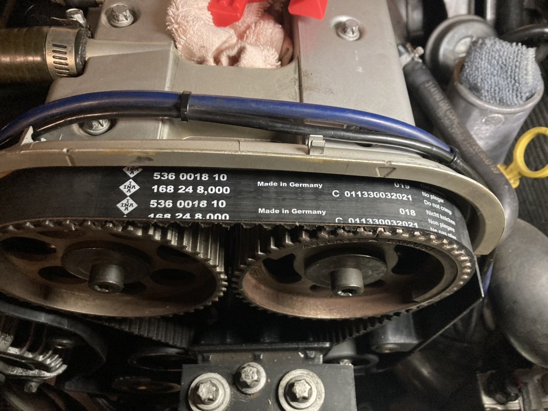

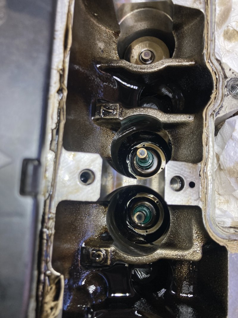

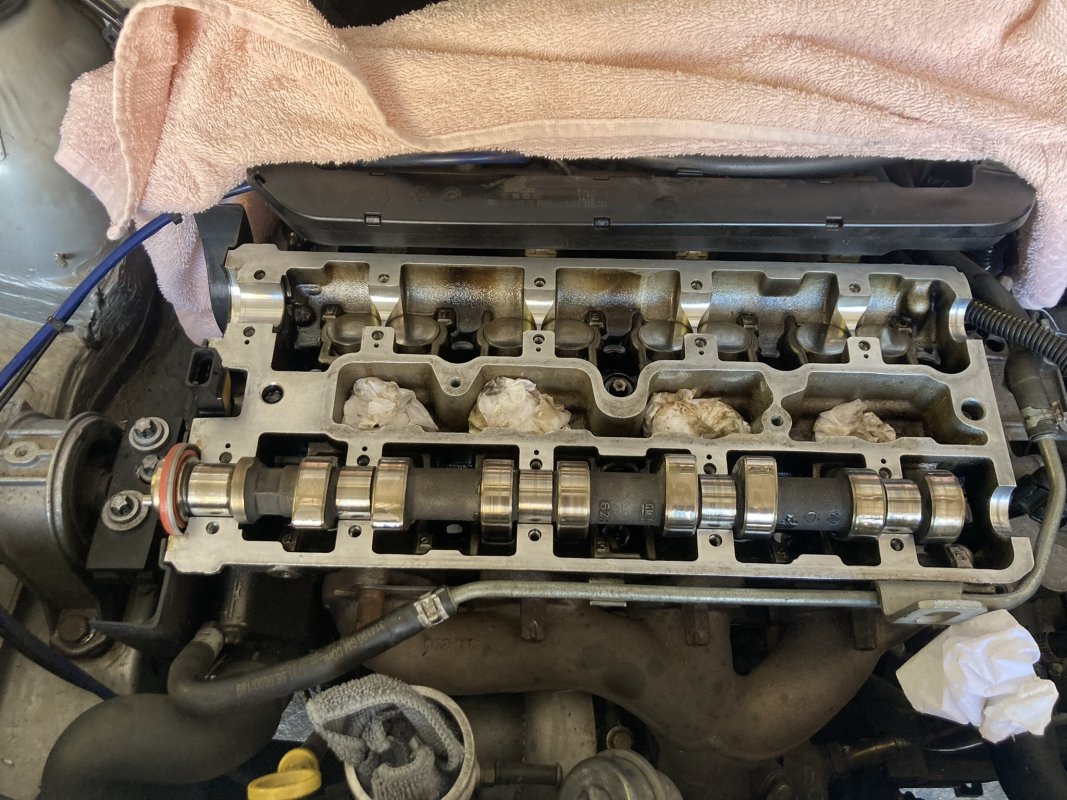

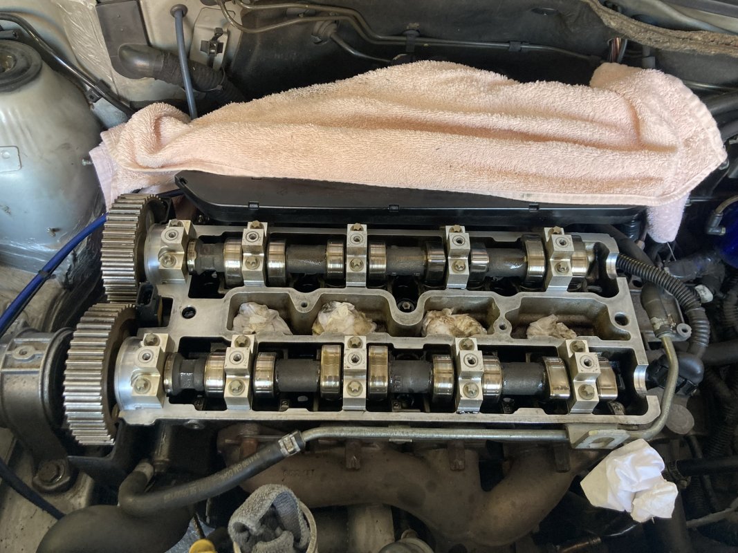

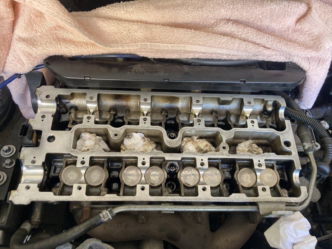

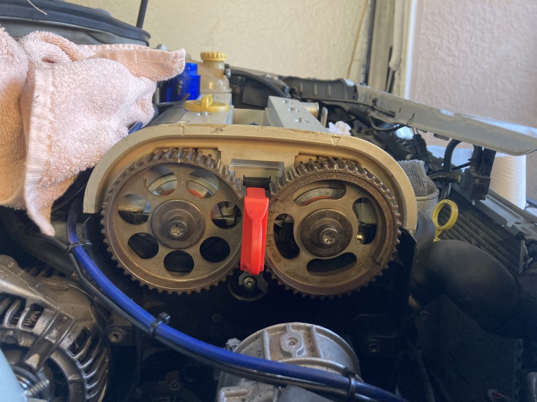

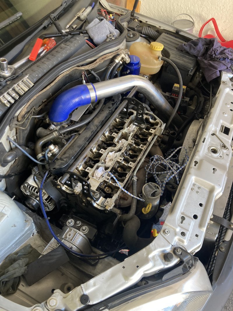

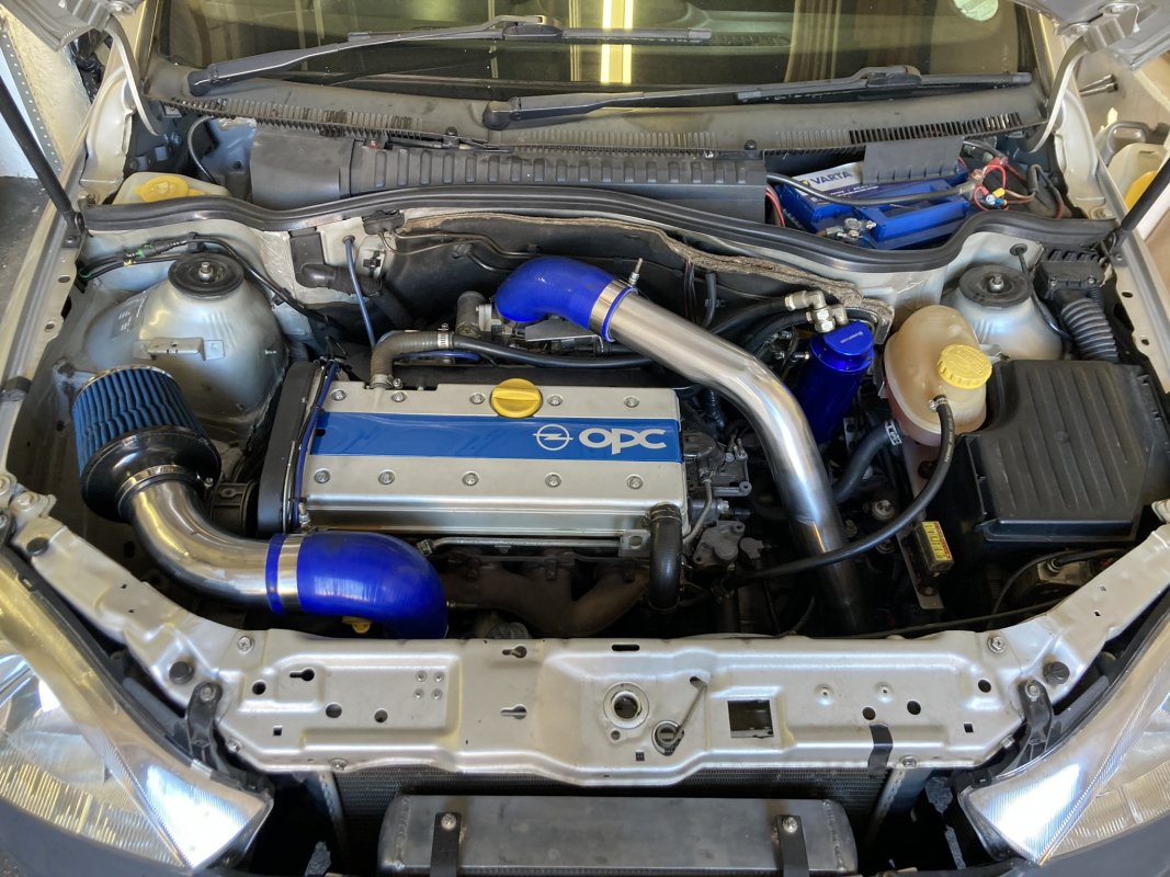

With the Ute working hard daily, the smoking issue became more apparent as the days went by. I have suspected that the valve stem seal(s) were getting a bit tired (200000kms+ on the motor), so one week when things were a bit quiet, I decided to tackle the job. In the months and weeks prior I had gathered all the parts together, so it was just a matter of finding enough time to do it properly and not rush.
The Ute went up onto trestles, and bits and pieces were removed to slowly but surely expose the inner workings of the head. There are various tools and techniques to do this job, but I was intrigued at trying a method which involved pushing nylon rope down the plug hole, and then turning the motor slowly by hand so that the piston would press the rope up against the valves. This would prevent the valves from dropping down once the retainers and springs were removed. (Another method is to fill the cylinder with compressed air). My brother-in-law came through one day to assist, and we worked through each valve, one at a time, first with the exhaust valves, and then followed by the inlet valves. I have the necessary tools to remove the retainers and springs from the top, but at the end of the day, we also had to improvise a little bit when it came to putting everything back together. There were some tense moments trying to get the cotters to seat correctly in the valves. Some pics below:
Rocker cover removed, camshafts removed, cam followers removed:
Valve Retainer and Spring removed (valve stem seals are the green bits in the pic):
Starting with reassembly, valve stem seals all replaced, springs and retainers refitted, cam followers installed on exhaust side:
Exhaust cam placed in position with new seal:
Intake and Exhaust Cams installed:
Timing marks lined up:

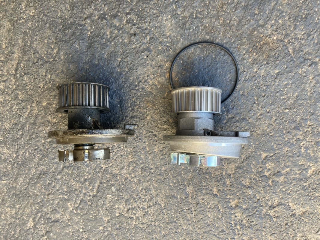

New water pump installed:

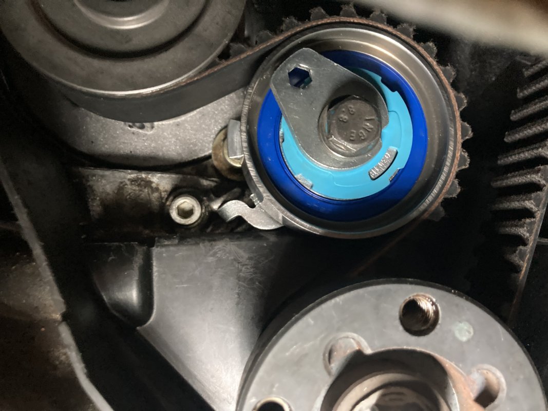

New cambelt installed (incl. all idler pulleys and tensioner):

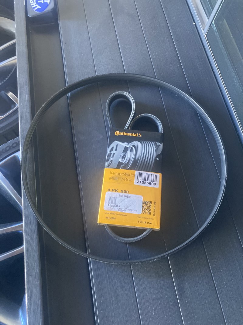

New alternator belt installed:

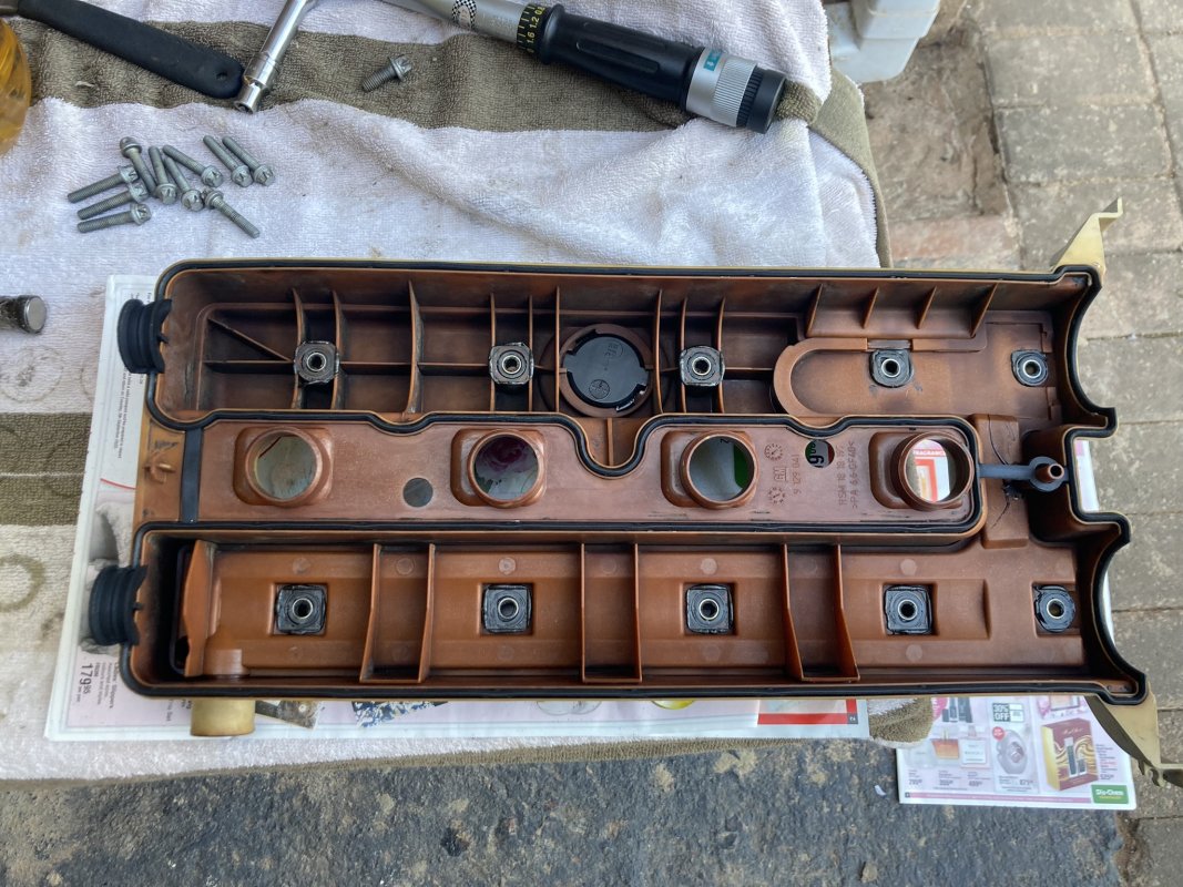

Rocker Cover cleaned up with new gasket:

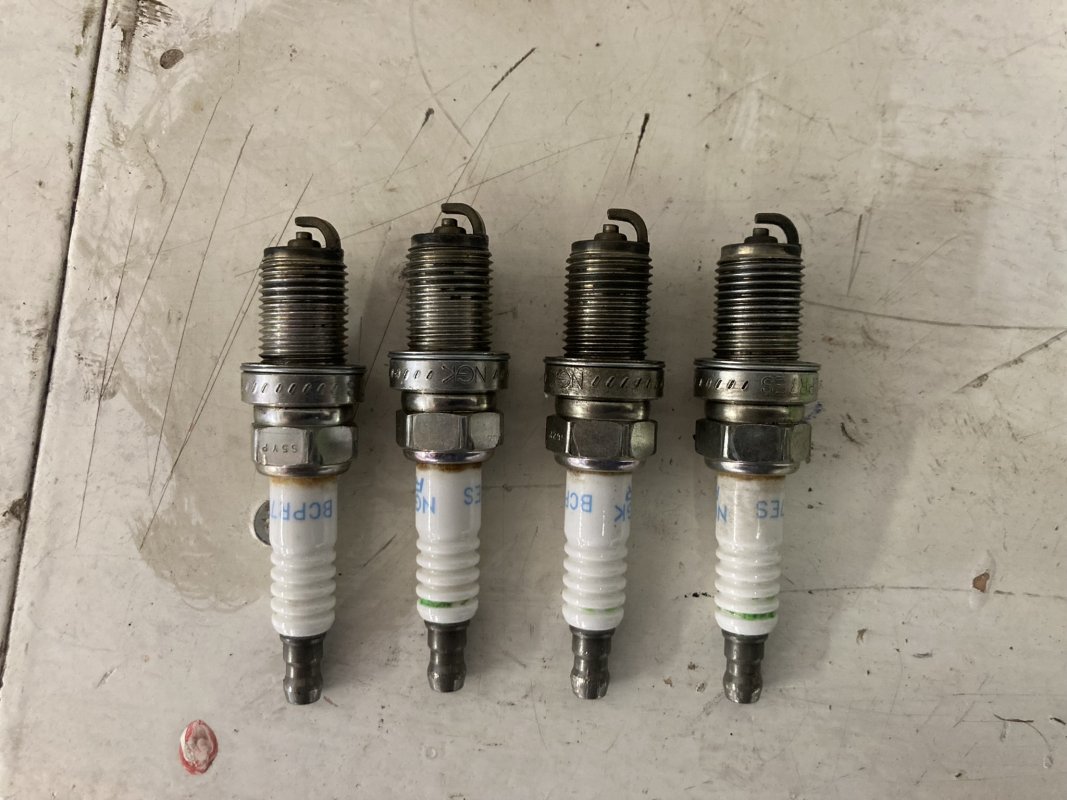

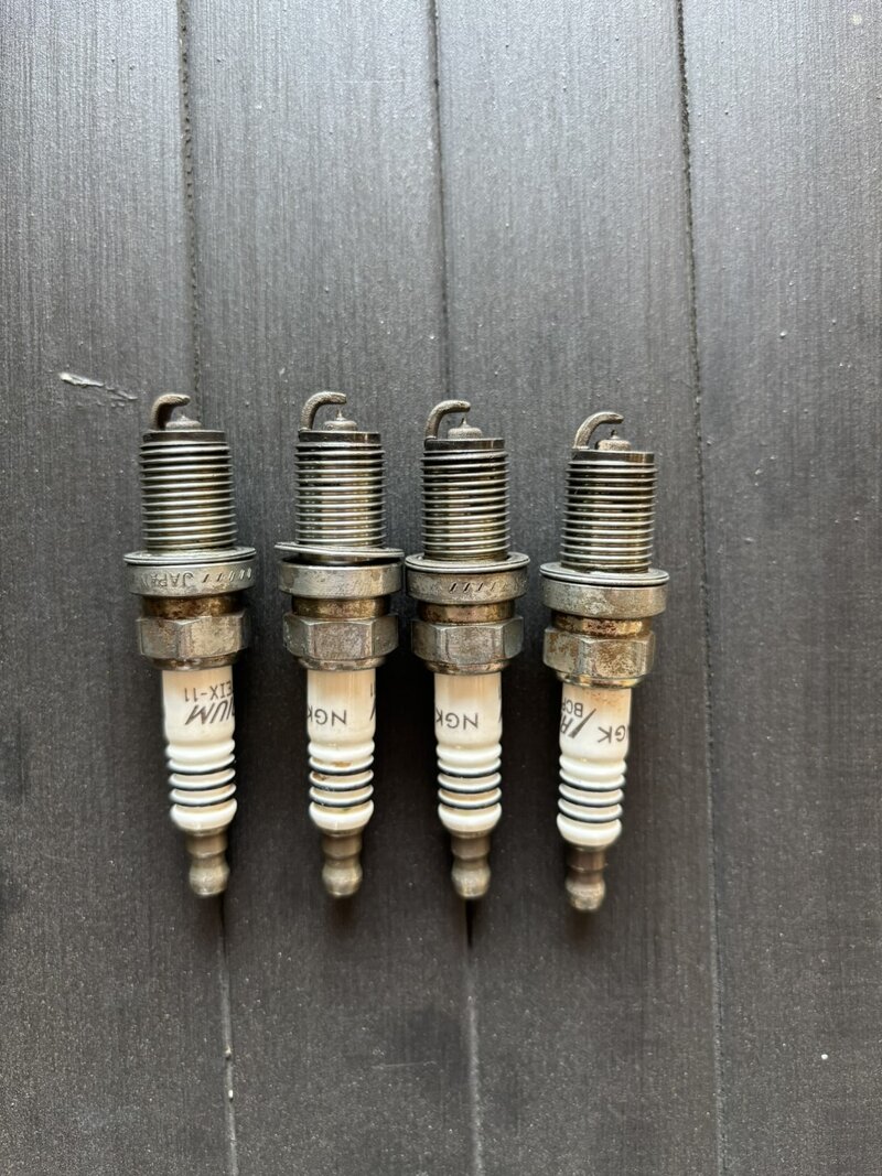

Spark plugs still burning nicely, will be reinstalled:
Closed up and ready to rock and roll again:
I must say, the first few turns by hand, as well as the first start are always a bit of a nervous time, but thankfully all was well. There was some smoke the first 10-15mins though, but this was probably greasy hands touching the surfaces which get hot and so on.

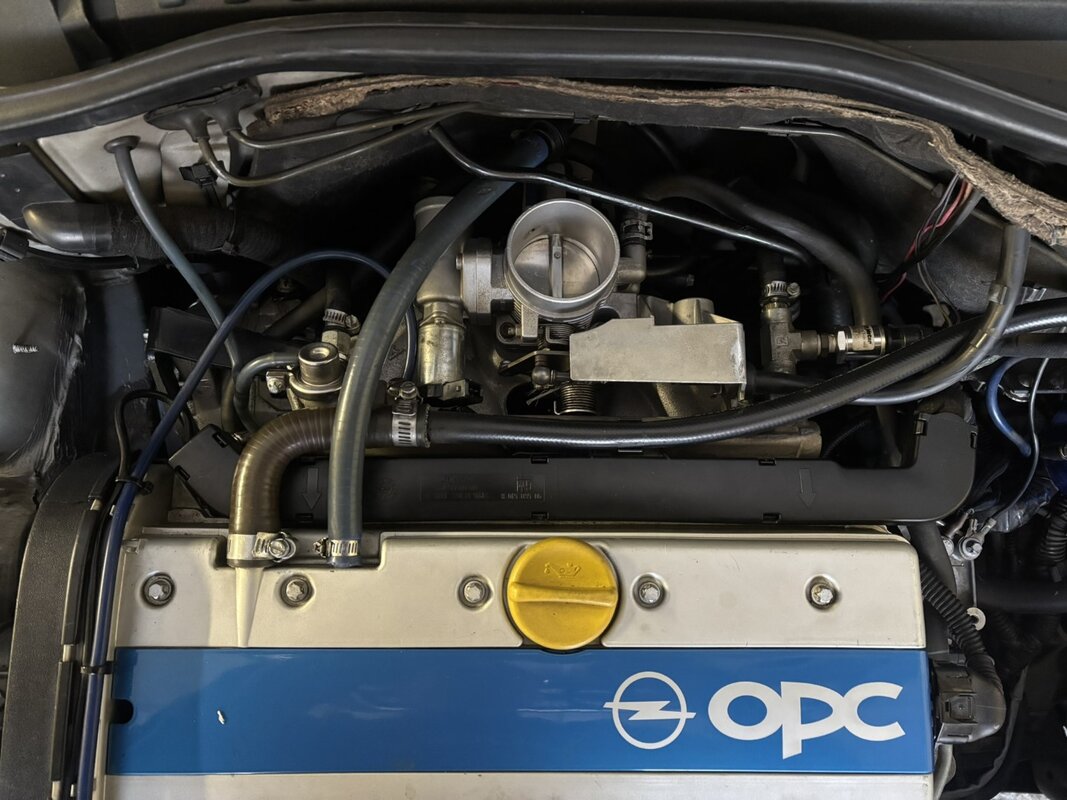

I also ended up rerouting my breather system (more aligned to OEM design now). After the first start was successful, I proceeded with an oil change and cleaned the air filter as well. The Ute was now ready to hit the road again.

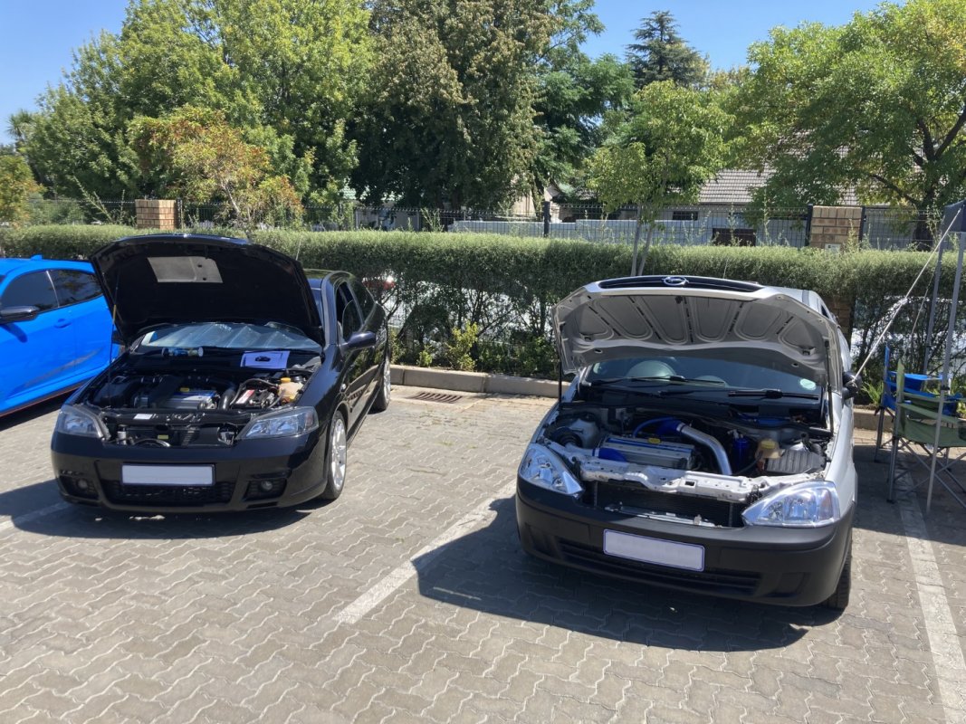

Moving forward, about a month ago, there was a motor show at the local school. So I registered for a spot and we went and put all the awesome microfiber, brushware and other detailing things on display. I also held a raffle on the day, so a box of things went off to the lucky winner as well. There was a great variety of cars on display, including a G OPC Hatch, Camaro Restomod, Chev Impala on Air, Shelby GT500, some Alfas, Ferrari 430, BMW 3.0 CS, and some newer machinery too. The food and drink stalls were also popular as it was a scorcher of a day.
Plans for the Ute in the coming months: more heavy lifting and moving as some home renovations continue. Maintenance wise all is good for now.

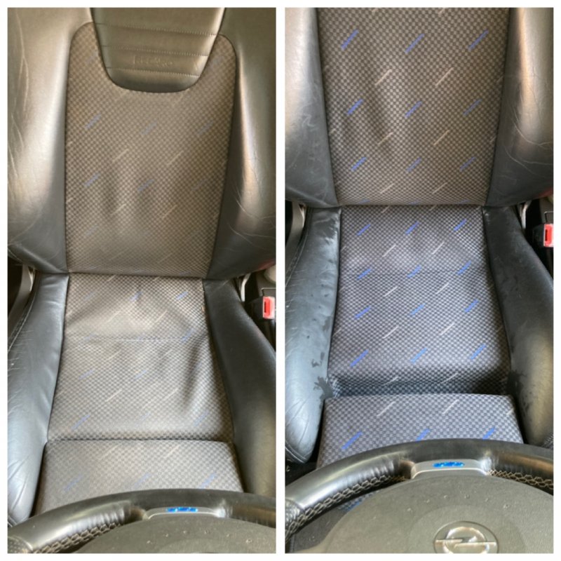

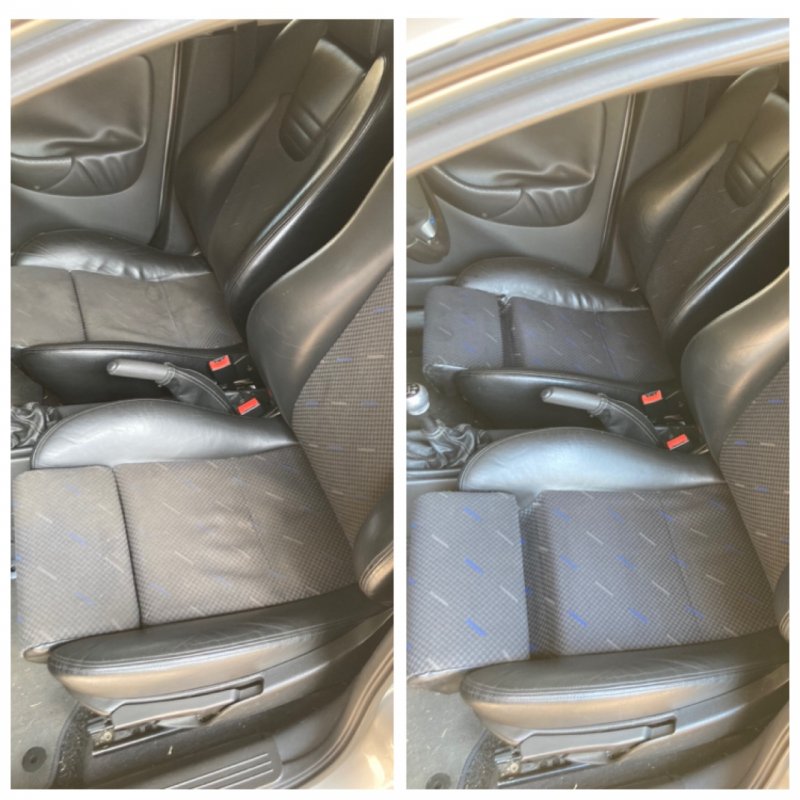

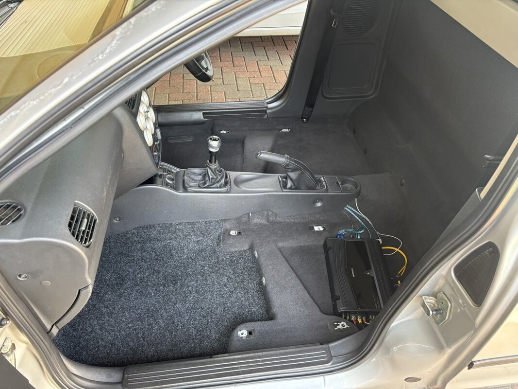

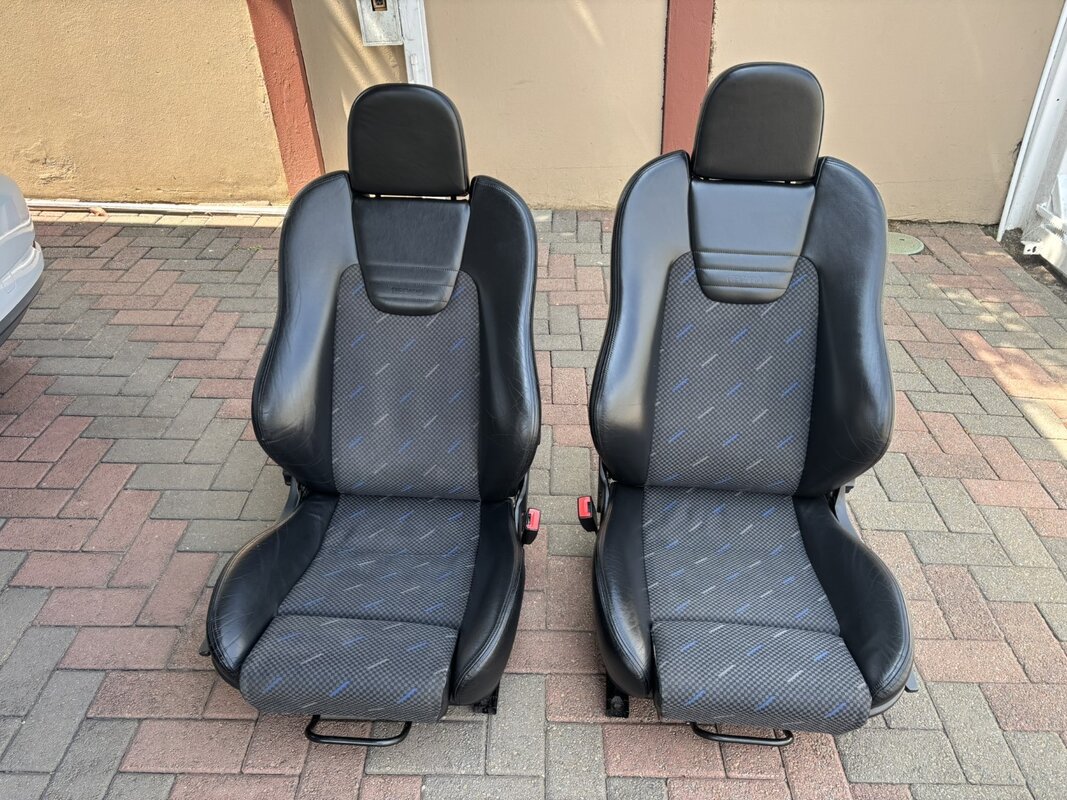

In September last year after the heavy work of moving up and down, the interior was a bit grubby (long overdue actually). So I set about tackling cleaning of the seats.
I used P&S Carpet Bomber, and this, coupled with the Karcher extraction vacuum, did a great job.
Below are some before and after pics. Once the fabric was dry, I moved ahead with the leather cleaning and conditioning, again using P&S Xpress Interior Cleaner, and P&S Leather Treatment, Conditioner and Protectant.
Current update is that the seats are still clean, haha.

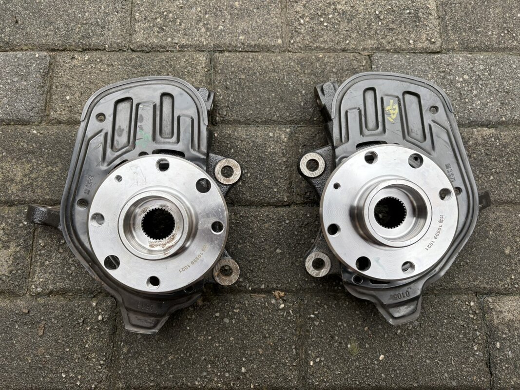

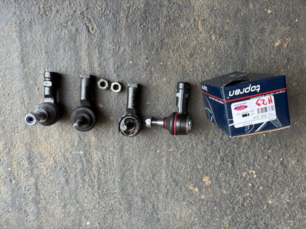

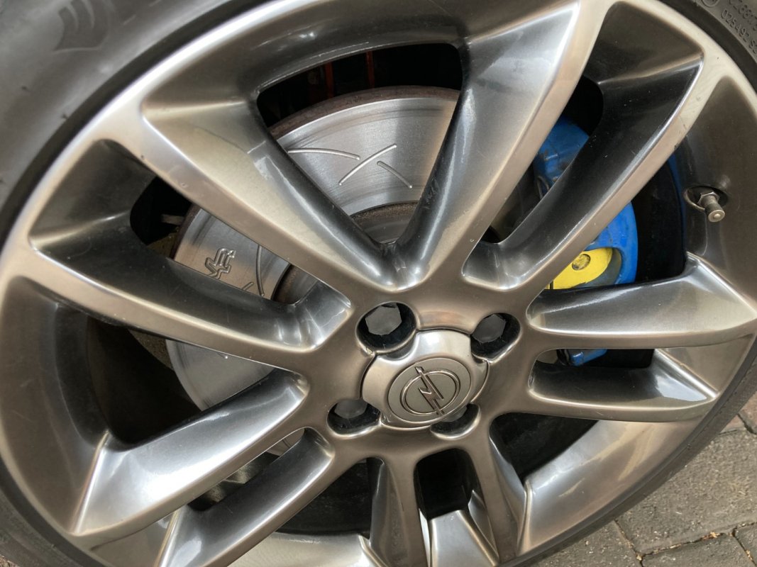

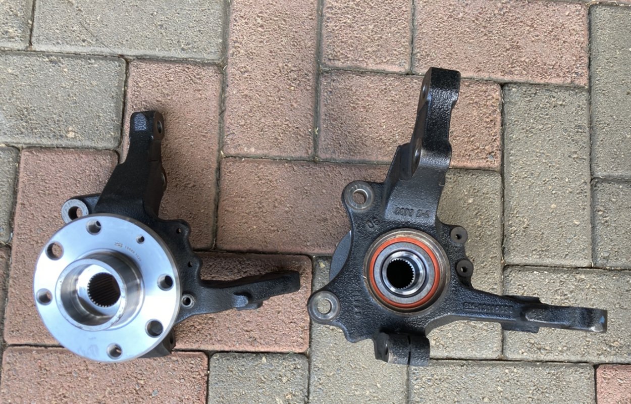

At the beginning of the year, the front-left wheel bearing decided enough was enough, and made itself known through an intermittent clicking noise which sounds like the CV joint is on its way out. Thankfully this was not the case, only the wheel bearing, so I parked the Ute and stripped everything off. The steering knuckles and hubs were sent off to Uncle Al, where they were “out of sight, out of mind” for the best part of 6 weeks. I wasn’t too concerned though, as I was thoroughly enjoying the 130i during this time.
Anyway, I eventually got the knuckles back, with new wheel bearings and hubs pressed in. At the same time, I decided to replace the tie rod ends. I reinstalled everything, and took the Ute for alignment as well. The tracking is much improved, but when doing the alignment and balancing, this also uncovered another inevitable issue: buckled wheels. Every single wheel is bent, to various levels of concern. They balanced as best as they could, and fitted the worst pair of wheels on the back. The plan would be to keep going like this for a bit, until such time as I get the wheels refurbished, and will then fit new tyres all-round as well.
New tie rod ends:
New Hubs and Wheel Bearings:

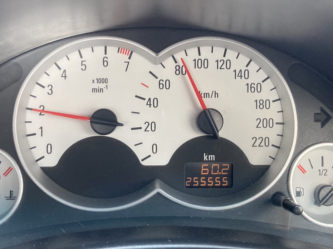

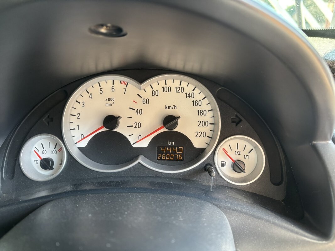

Fast forward to June-25, and I hit a new mileage milestone: 260000kms.

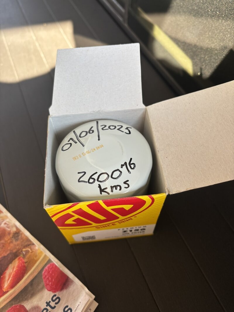

It was also service time, so got the necessary parts and spent a few hours working through things: new oil and oil filter, cleaned the air filter, new cabin filter (this is a stark reminder of the dust and pollution out there). I also decided I wanted to check the spark plugs, and switch out back to the Iridium plugs I used previously. It’s been some time since I ran these, so I wanted to see if I could notice any significant difference. Pulling the coil pack out, revealed what seems to be another common perp in the form of a leaking tappet cover gasket. The plug wells of cylinders 3 and 4 had some oil in, so this is another item added to the future to-do list.

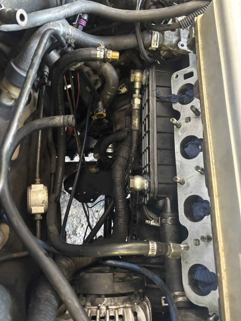

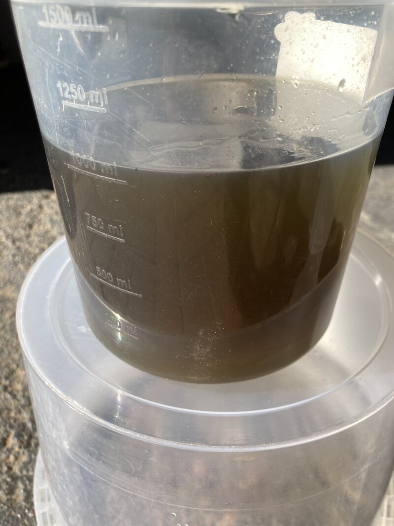

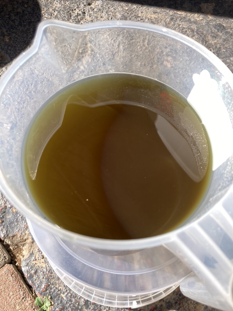

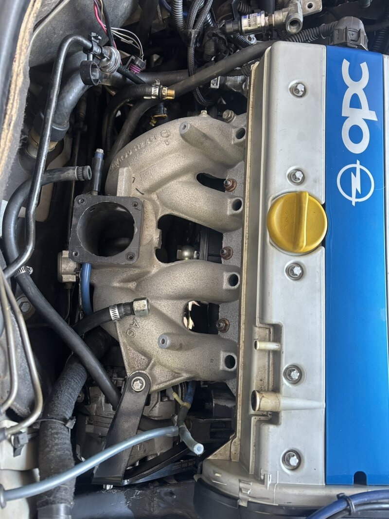

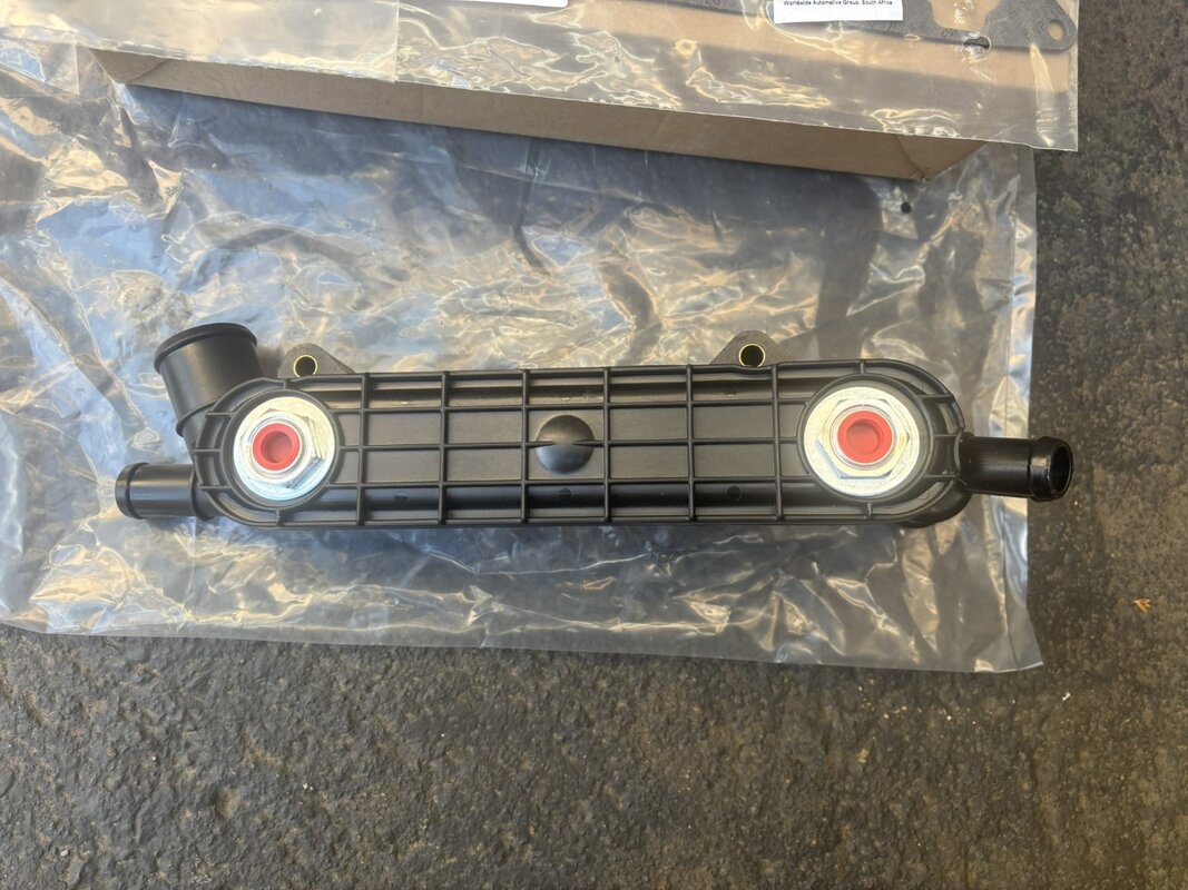

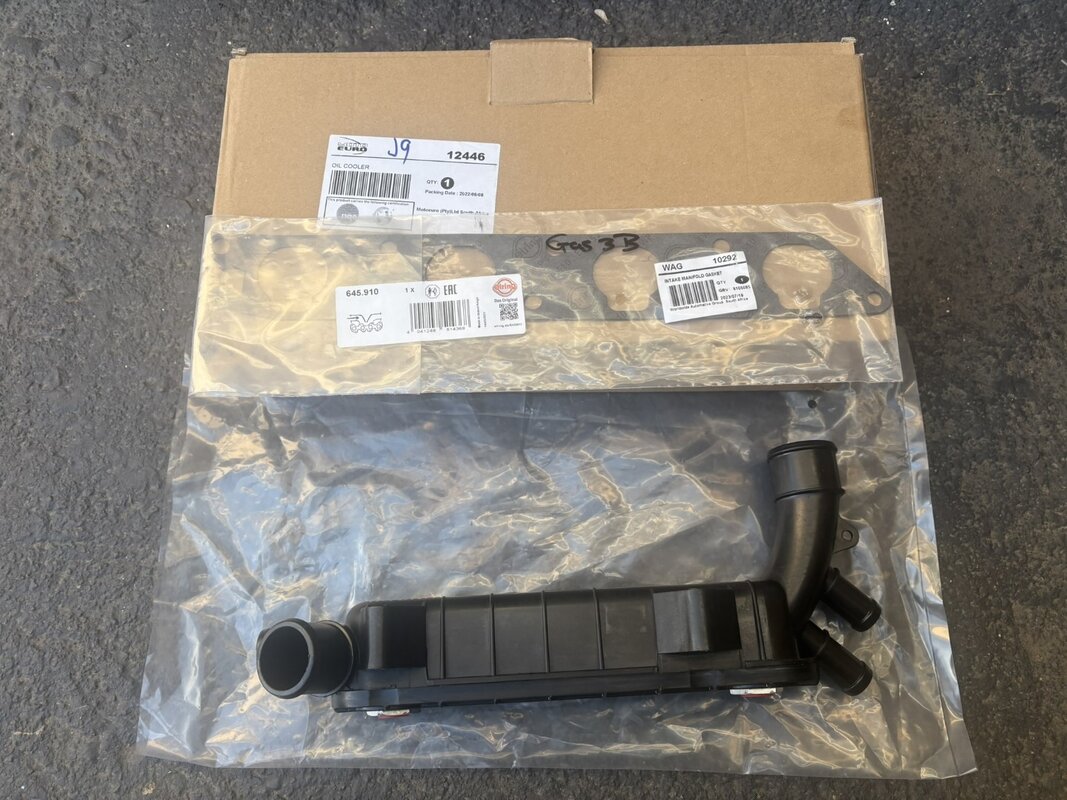

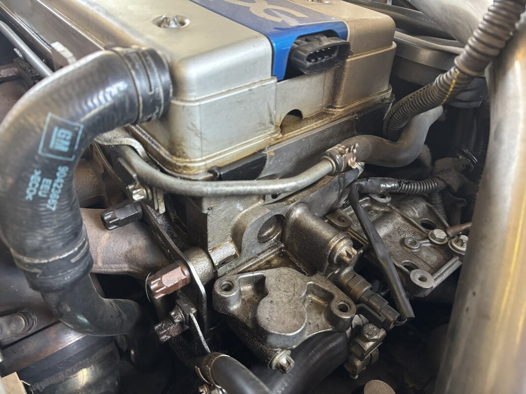

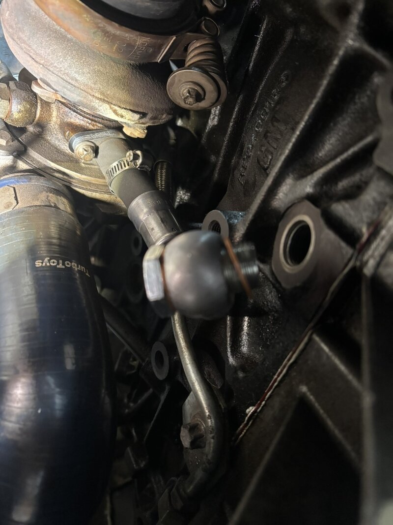

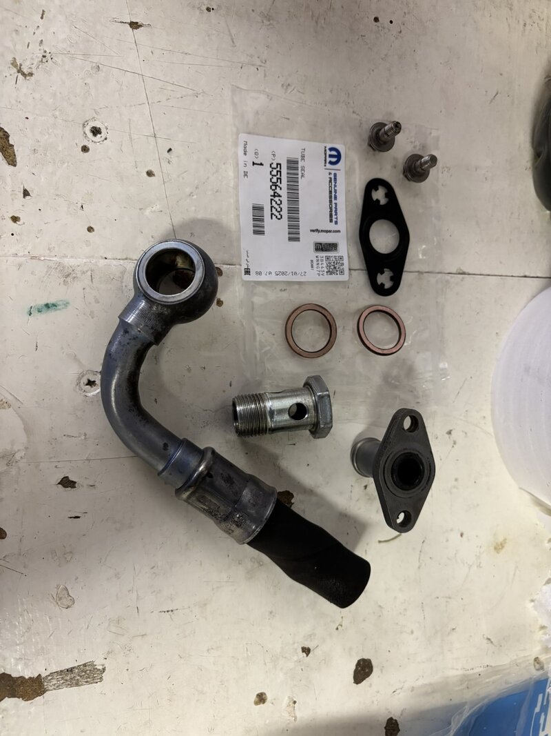

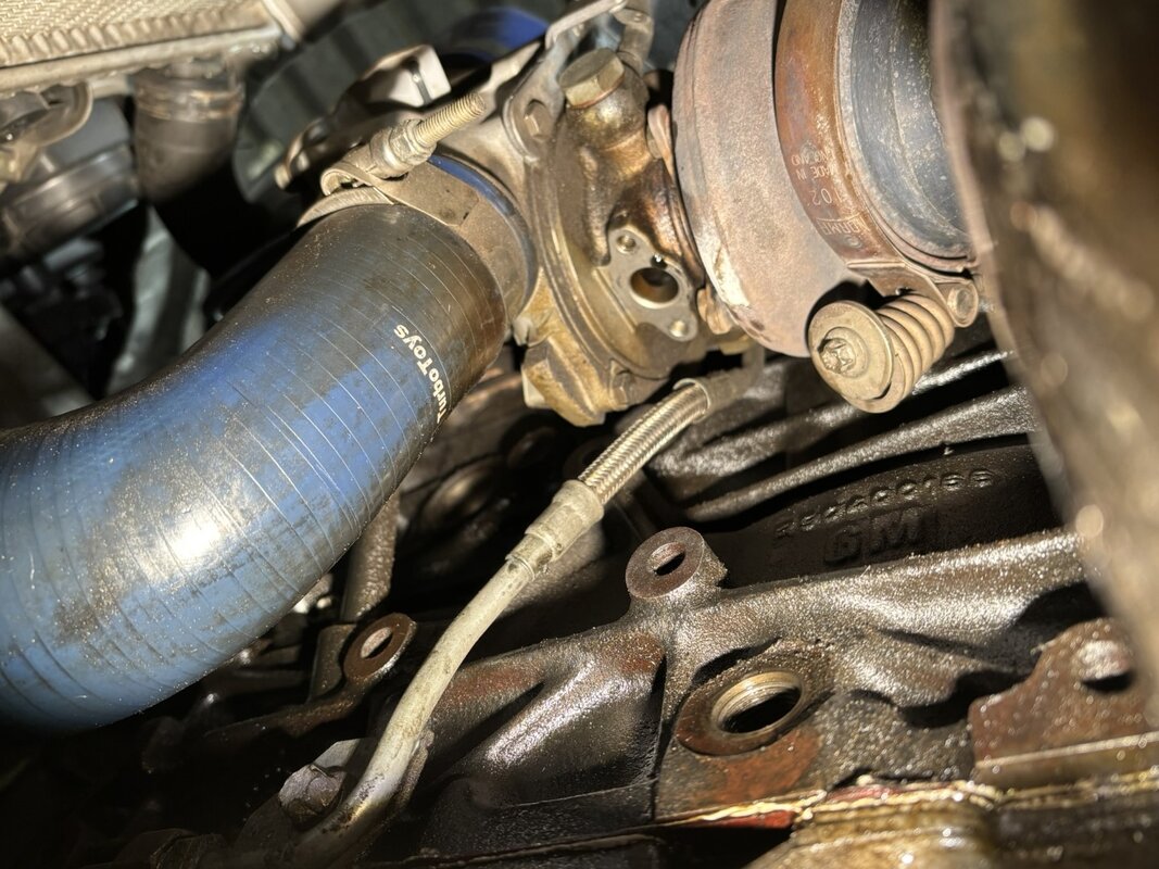

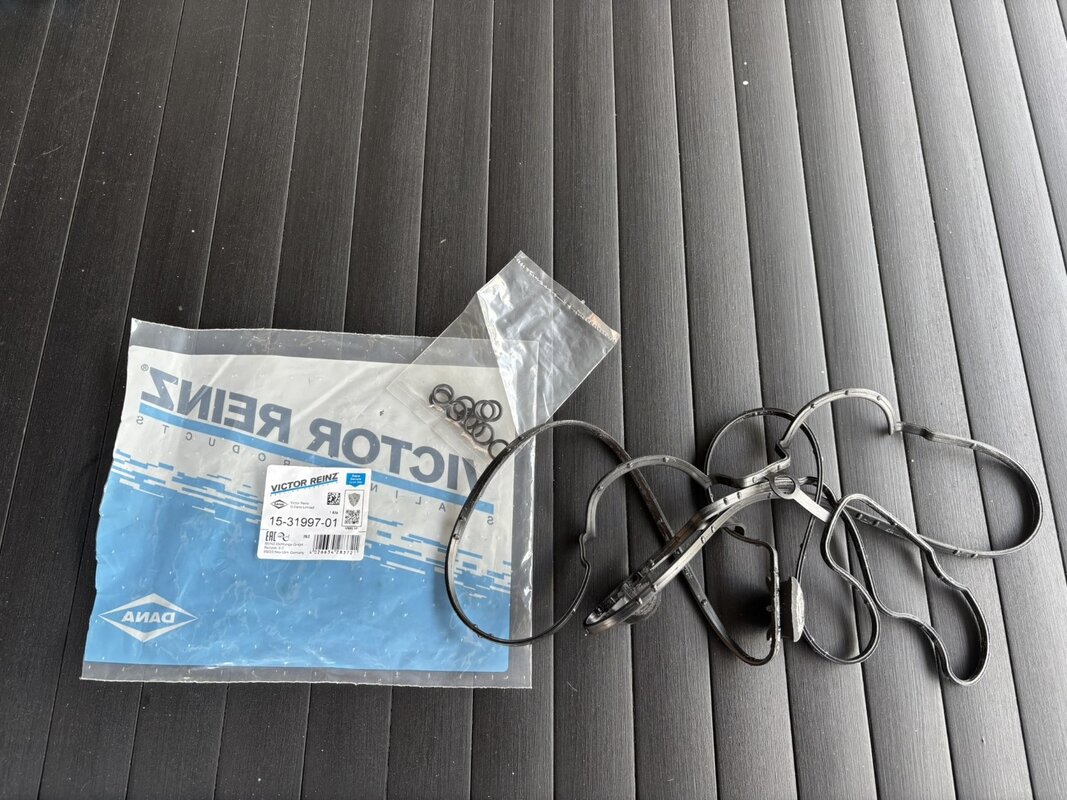

I also noticed that my coolant seemed a bit low, and 2 days before, noticed a drip in the driveway. I didn’t think too much of it, as I know sometimes one hose does perish after some time, and then cause a slow leak. I inspected the hoses but they all looked fine. Anyway, I topped up coolant, with intentions to monitor going forward.
3 days later, on the maiden voyage post-servicing, I was heading to work, but had to stop to fill up with fuel. The attendant said he saw me pulling in, and that it’s leaking under the car. Oh no. I had a look, and it looked like a hand shower was activated behind the motor. Coolant bottle empty. Damn. I did some more searching, and came to the conclusion that the oil cooler (which sits at the back of the motor, behind the intake manifold), had given notice. I waited for the motor to cool down, topped up with water and then limped back home (thankfully I wasn’t far, and no traffic in the opposite direction meant the motor didn’t even warm up enough to cause pressure build up and subsequent coolant loss.
A new oil cooler and intake manifold gasket was procured, and then over the course of the Father’s Day long weekend, I set about stripping everything off, cleaning up, installing the new parts and then closing again. Inspecting the old oil cooler, there was no obvious signs of catastrophic failure, but I suspect it was the lower joint between the 2 oil feeder pipes which had split. Under pressure this would then allow for the leak (or rather more serious shower on the day).
With everything installed again, the Ute has been running faultlessly again. It’s still a hoot to drive, and is serving me well on the highway drives to and from Fourways and Sandton a few times a week.

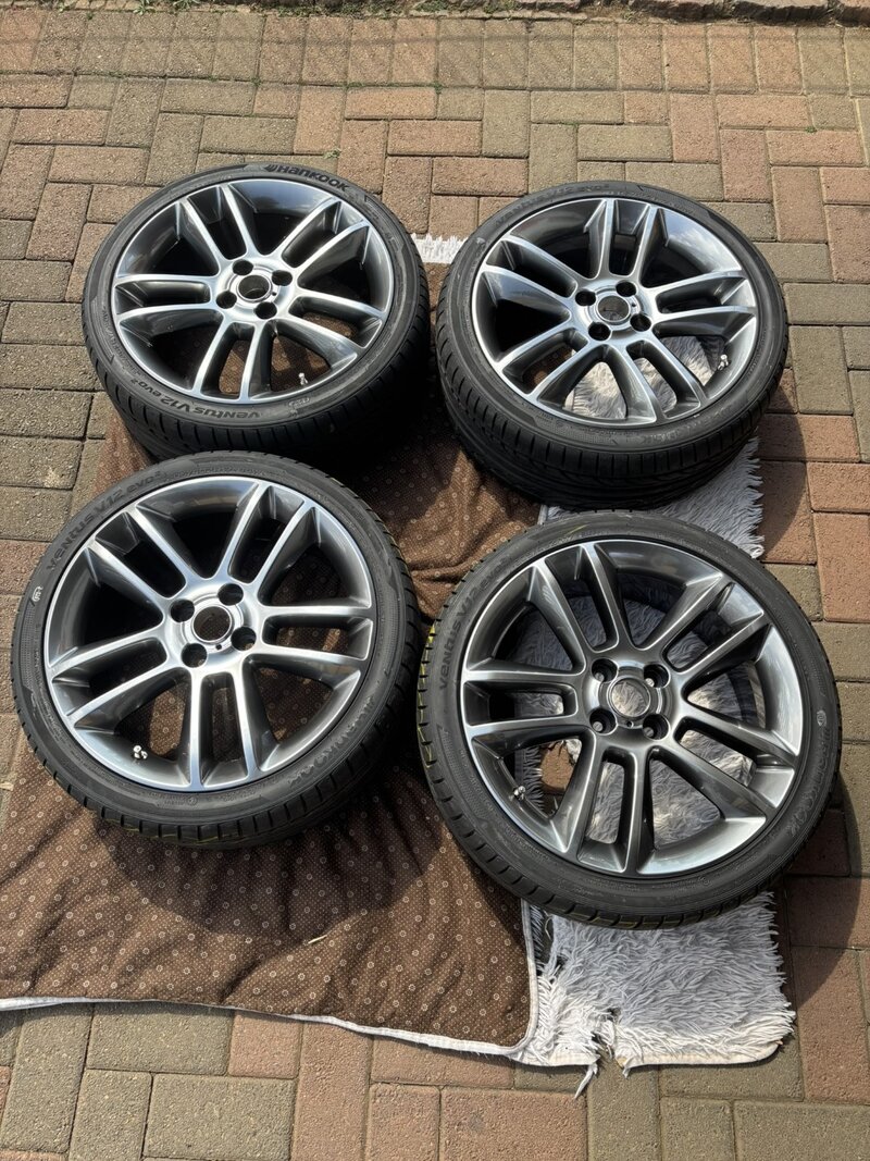

Plans for the short term are to send the wheels in for a refurb, and then fit new tyres. I just need to juggle a few other car-related matters and events at the moment, meaning the Ute is my primary mode of transport for July.
That’s all for now, thanks for reading…

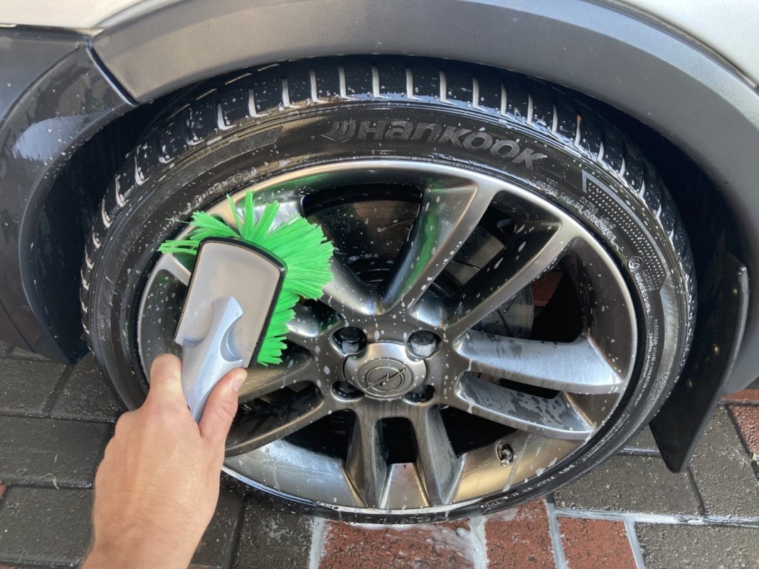

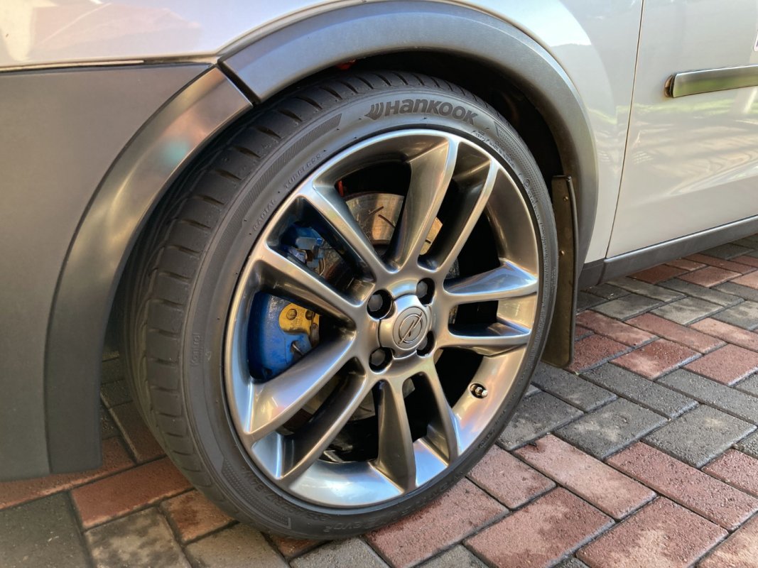

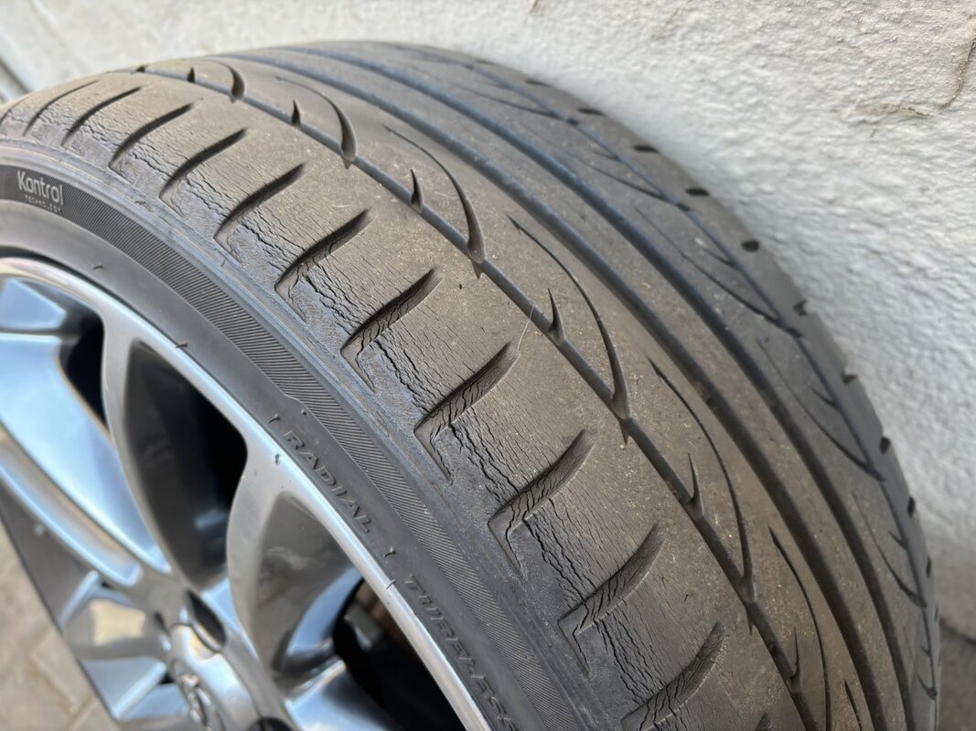

In Aug-2025, it was time to fit some new tyres. The fronts were wearing down on the inside, and both front and rear were starting with some small cracks due to sun and age. Given that it’s in almost daily use, I pulled the trigger.
But first of all, the rims were sent to Hi Tech Mag Repairs for refurbishment. There were a couple of buckles to fix, and they were repainted. In terms of tyres, I decided to stick with the Hankook Ventus V12 Evo2. These were also fitted at Hi Tech after the rims were refurbished.
Once the rims came back home, we polished and coated them, before commencing with fitment. And then disaster… My assistant, was applying tyre dressing to the inside of one of the tyres, and somehow slipped whilst moving the rim on the back of the bakkie, it fell face-down onto one of the other rims, and in-so-doing, chipped both rims. Extremely annoying, but I know it was a genuine accident, and what’s done is done. In the subsequent days, I did manage to mix up some touch-up paint, and used this to lessen the eye-sore (and heartache). It’s fine for now, probably for the next few years until I change tyres again.

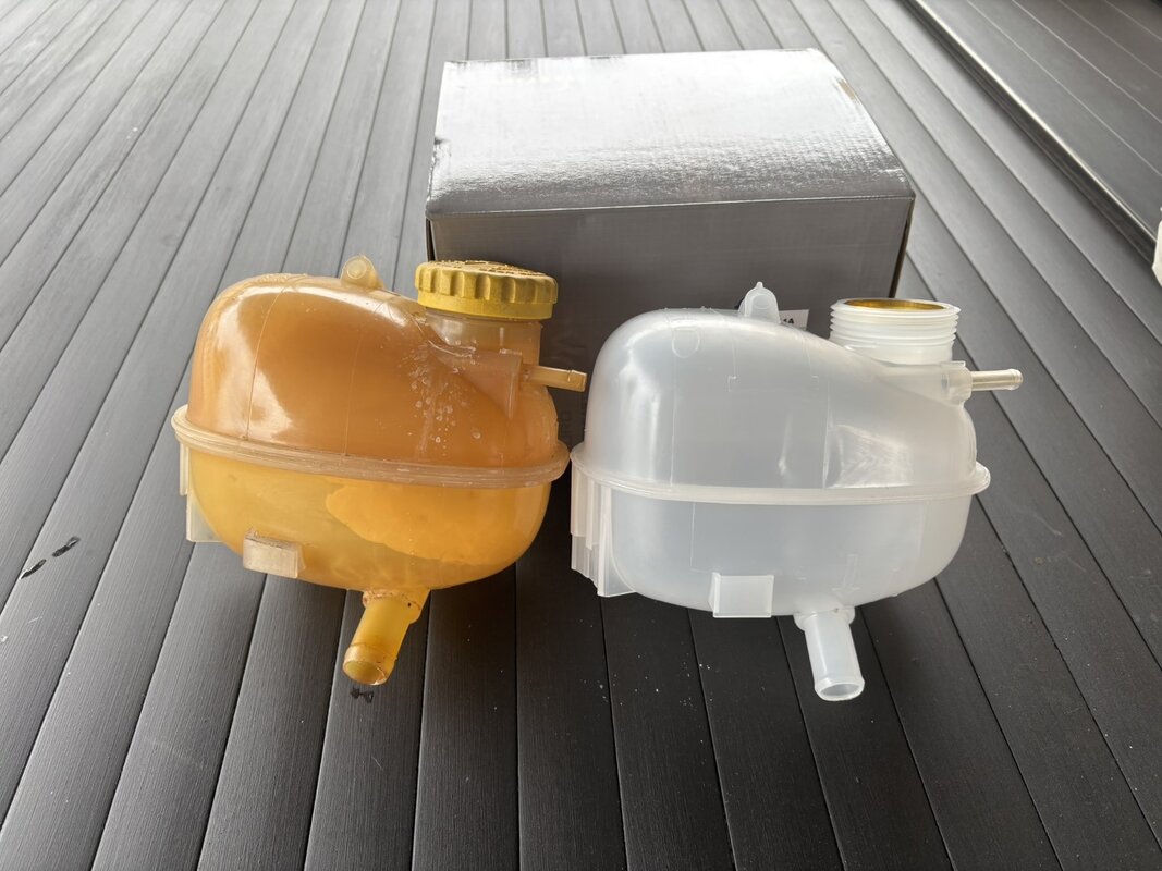

At around the same time, the coolant bottle decided enough was enough, and started to leak quite badly, so this was replaced with a new bottle and new cap:

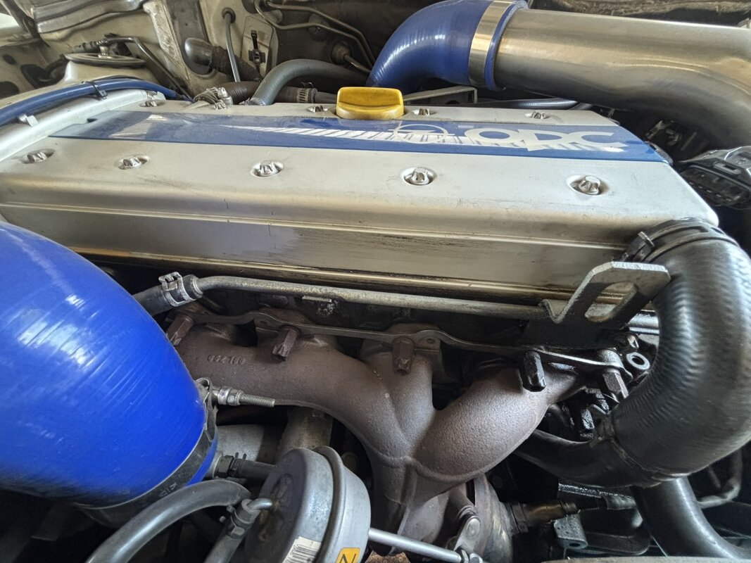

Fast-forward to January this year, and I did some more maintenance. There was a leak from the turbo oil return, as well as the tappet cover, so the corresponding gaskets were replaced. I’m glad I did, as the leak was getting quite severe into the spark plug wells, and would likely cause more issues sooner rather than later.

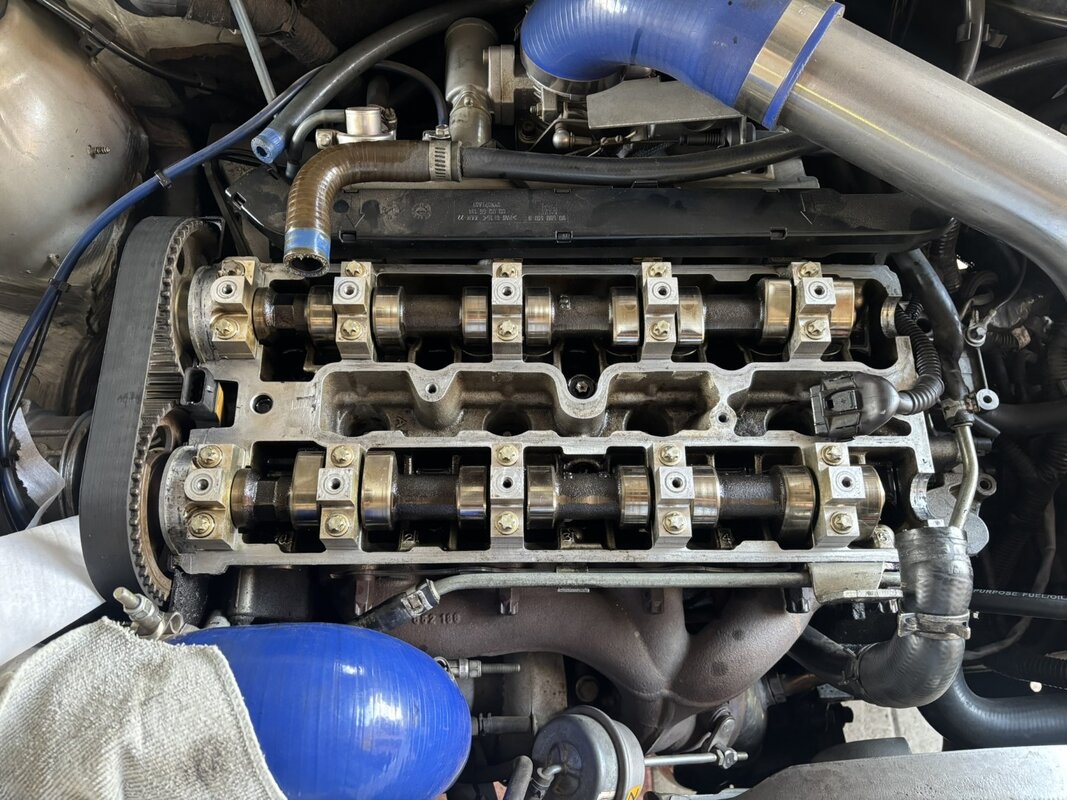

Victor Reinz FTW. Don't skimp on cheaper alternatives!

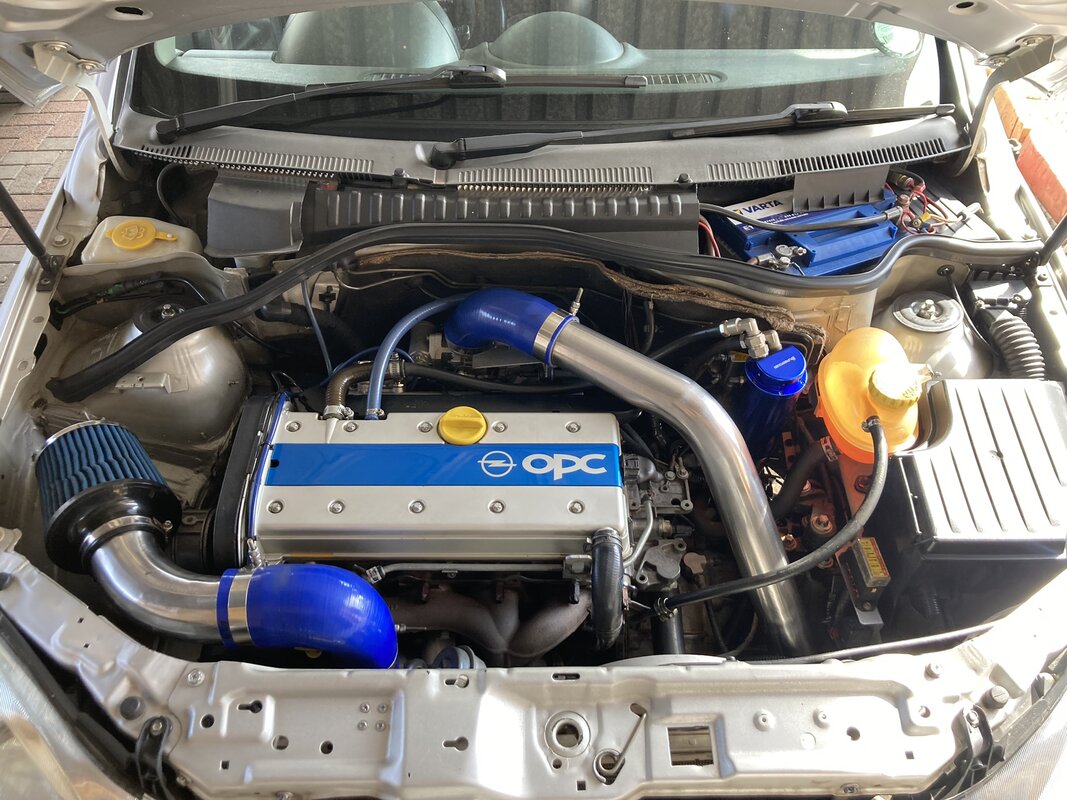

Valvetrain looking good, cleaned up and ready to close up:

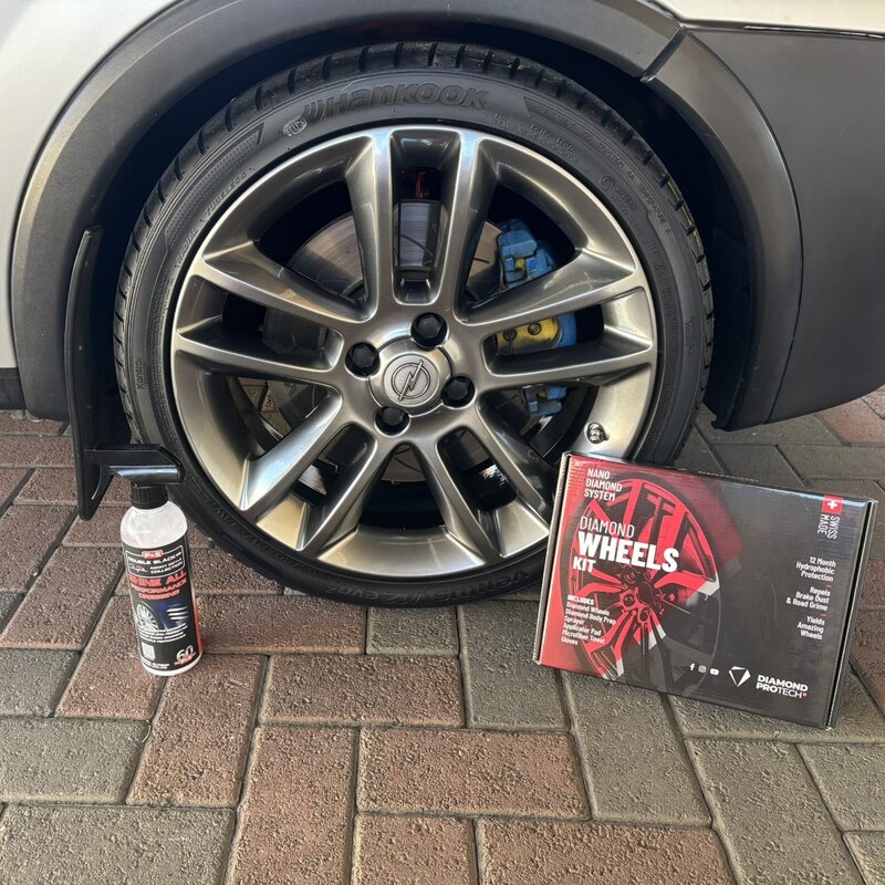

Onto a small cosmetic change, I received some LED globes from Secret Santa in December, so fitted these to the headlights (I just had regular halogen bulbs in temporarily).

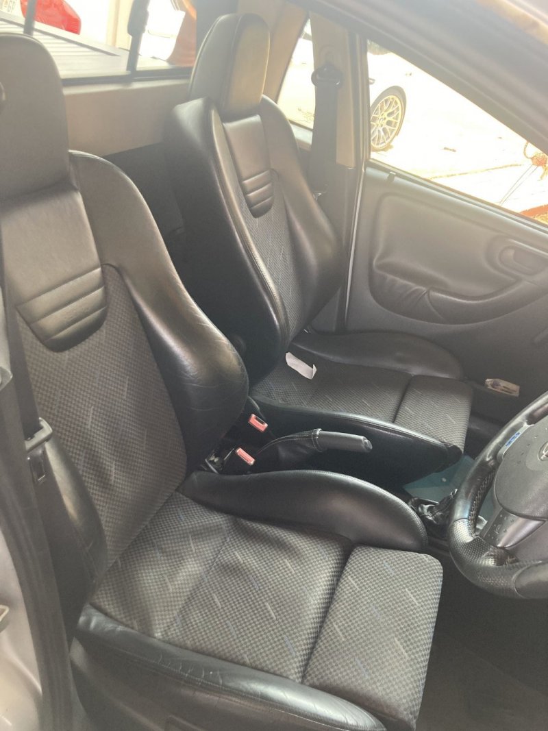

On the Detailing and Auto Care side, I went down a rabbit hole and detailed the interior completely, the seats came out, and these were cleaned and treated. The interior carpet, dash and everything else also received a thorough clean.

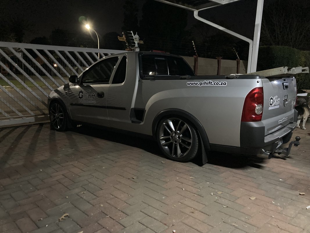

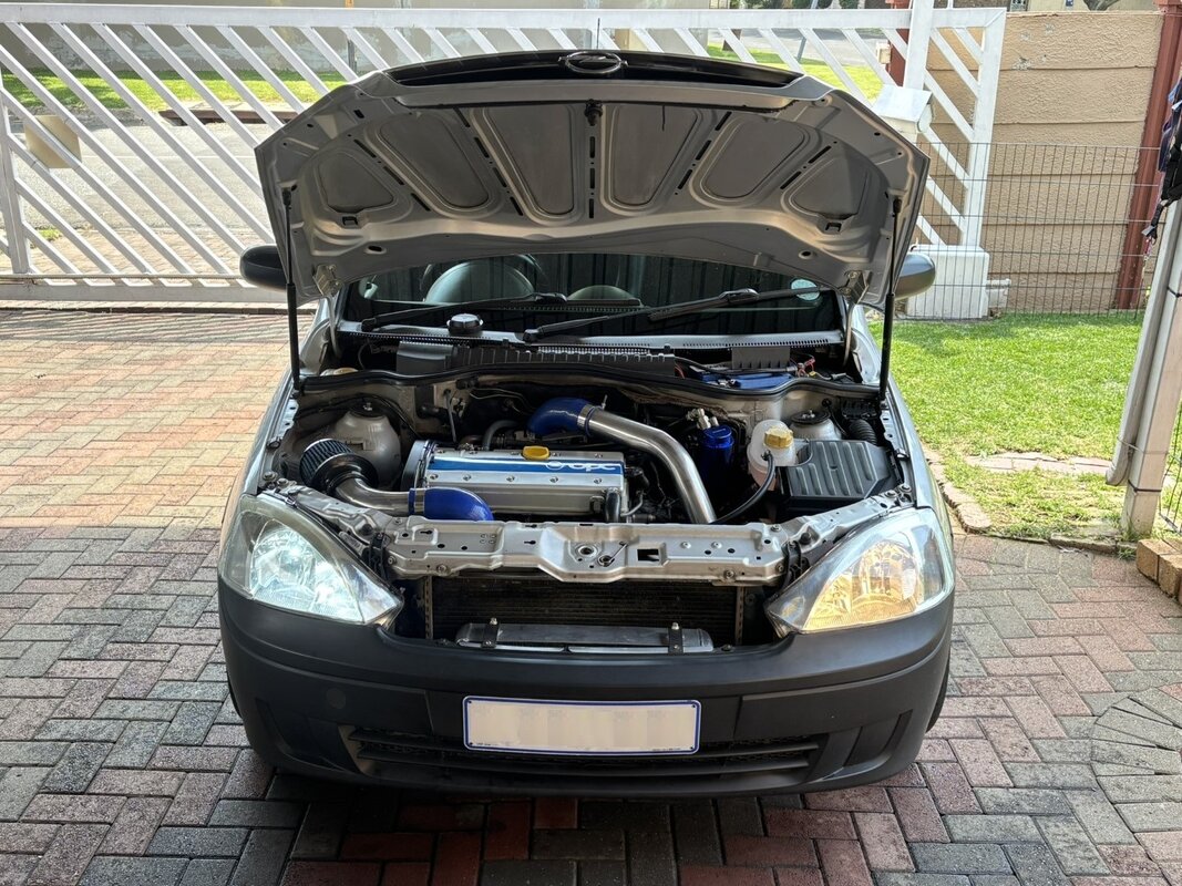

And that’s about all for the Ute. It is doing regular 60km round trips to and from Fourways for work a few days a week, so mileage accumulation is ongoing (currently on 268000kms). But it’s running like a dream still. Forthcoming plans include servicing, and an exterior detail. It will also be put to work towing a trailer for some upcoming shows and exhibitions too.
