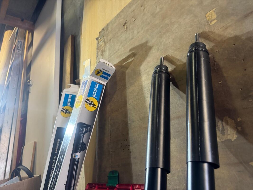

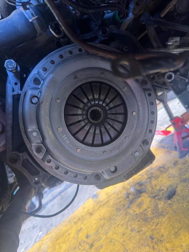

Mechanically, there has been a solid amount of work put into the car. New Bilstein rear shocks, front shocks are “new” 2nd hand items (I may change these in the near future). New control arms fitted, new rear brake pads. A new LUK clutch was fitted about 18months ago. New cambelt and pulleys done last year. Gearbox selector shaft seals were done, as well as fluid change.

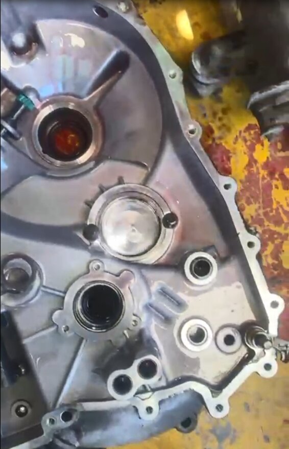

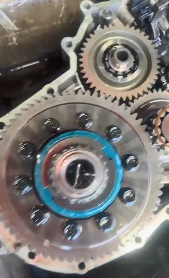

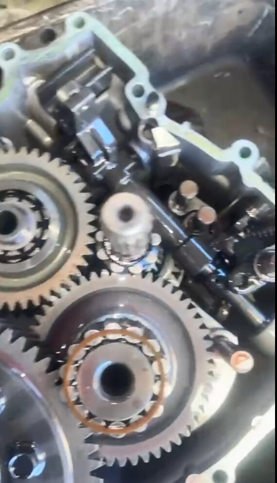

Here’s some pics of the inside of the box. Clean clean clean…
And the Unobtainium LSD showing "the cross":

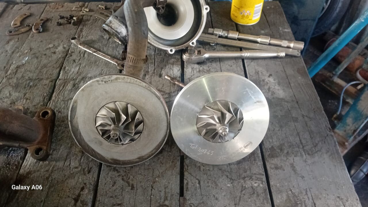

Two days after concluding a deal, the seller sent me some pics of the car in pieces, and the turbocharger on a workbench. He had a spare replacement core sitting on his shelf, and he did notice a bit of an oil sweat under the turbo, so he decided to replace the core, out of goodwill, no questions asked, no additional payment required. I was stunned, as good deeds like this are few and far between these days.

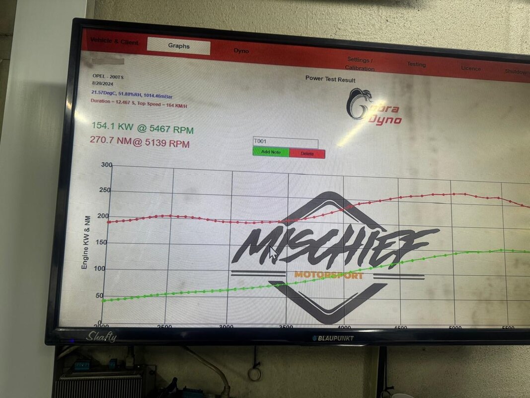

For the power junkies, here’s a dyno run from 2024, still plenty fresh for a 30year old car. Note how the power band builds, and from 4000-6000rpm it’s all-systems-go, old school is cool :)

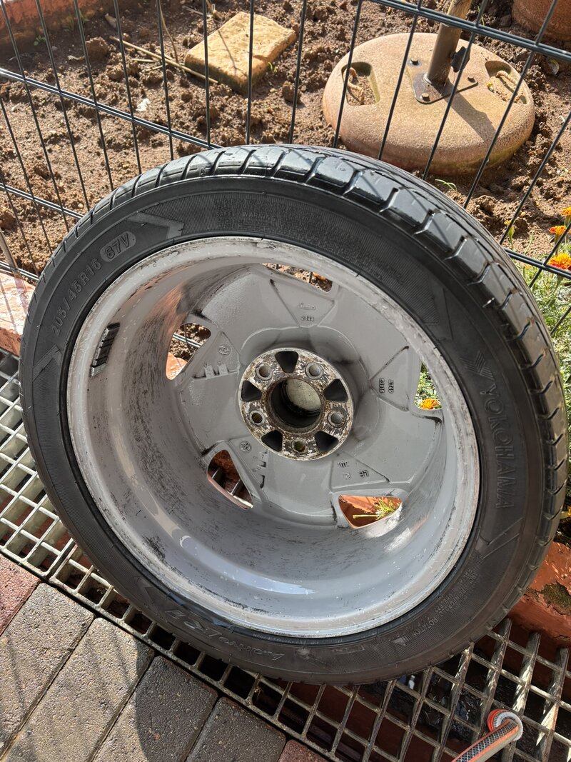

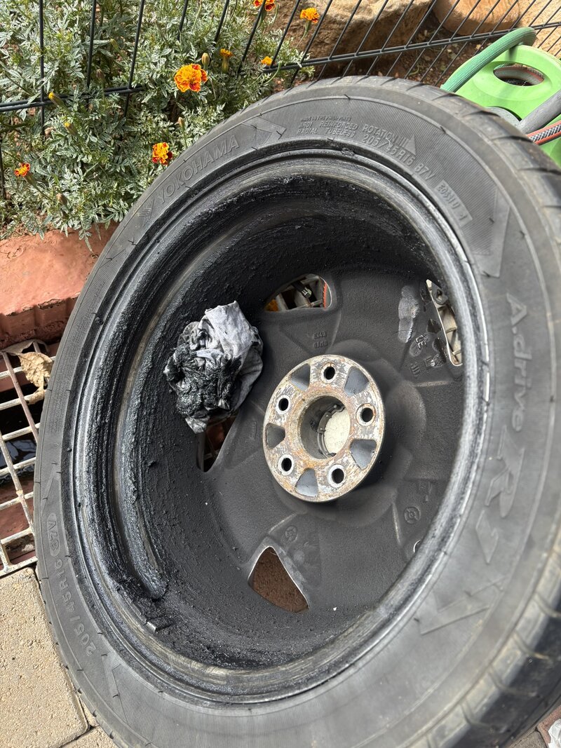

First up, when we washed the car, we noted that the wheel brush picked up some grease from inside the wheel barrel. Upon pulling the wheel off, we found that the CV boot was not properly secured to the CV joint, and as such, must have spewed CV grease all over the wheel. Thankfully this was a quick repair, but the associated cleaning took about 2-3 times as long. But all spewed grease was cleaned up.
Before and After:
The rims will probably get refurbished later this year, and new tyres will be fitted, so for now, rigorous cleaning will have to do.

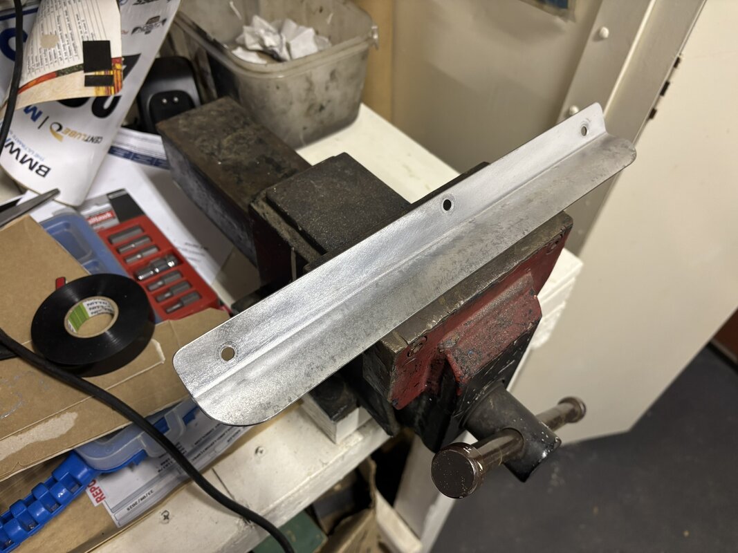

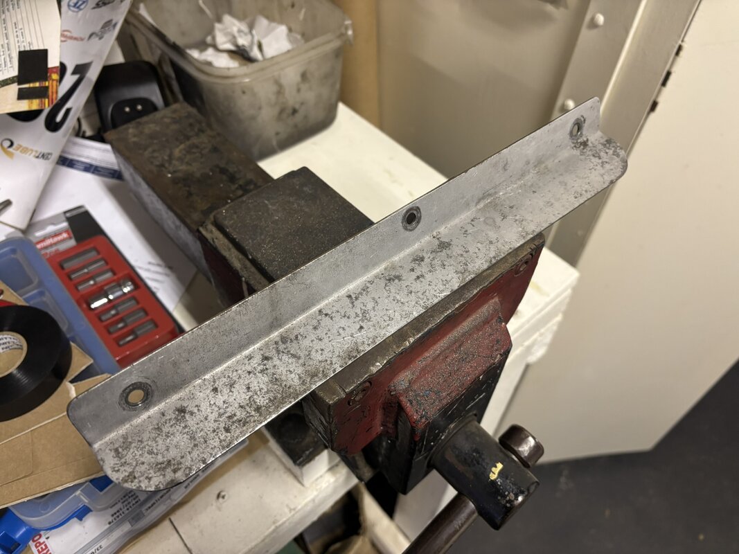

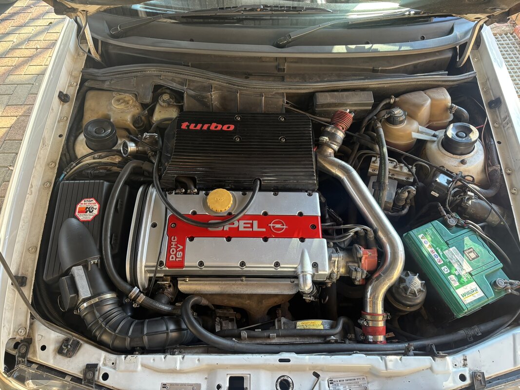

Dabbling in the engine bay, the heat shield for the turbo was also looking a bit caked up with corrosion. This was a quick 20min job. 3 bolts to remove, then 10mins in the bench vice, and I polished it up with a brass wire disc in my electric drill, before reinstalling, much better:

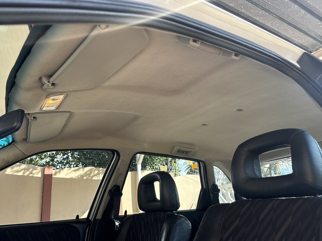

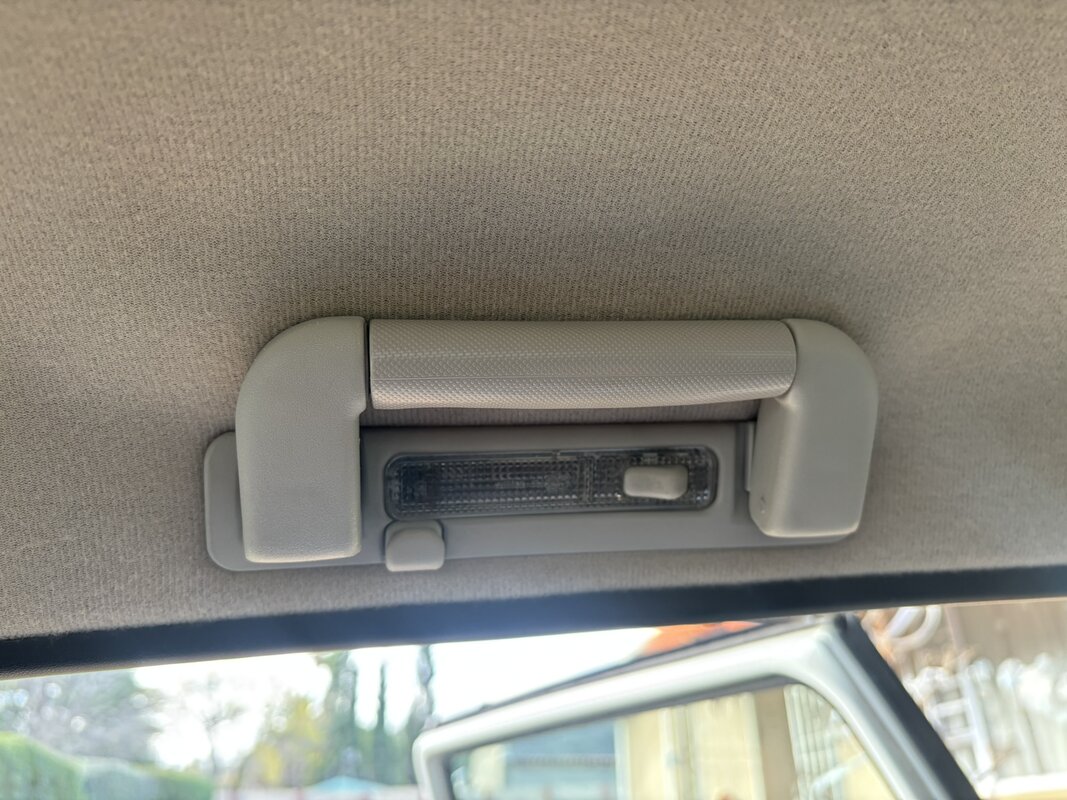

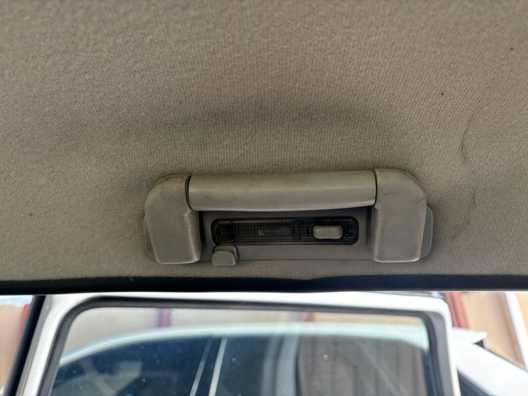

My trail of thought and attention then turned to the interior. I decided to tackle things top-to-bottom. The original headliner in the car is still in fantastic condition, no sagging material, broken clips or bent board. This cleaned up really nicely with my top-secret mix, which also does not attack the glue of the fabric. I also removed all the grab handles, sunvisors and interior lights, and cleaned them up before reinstalling. Whilst it didn't look too bad beforehand, the after pics really to highlight the changes quite significantly.
Before cleaning:
After cleaning:

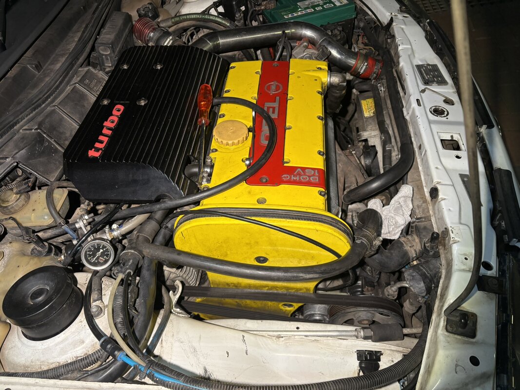

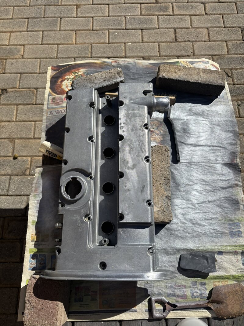

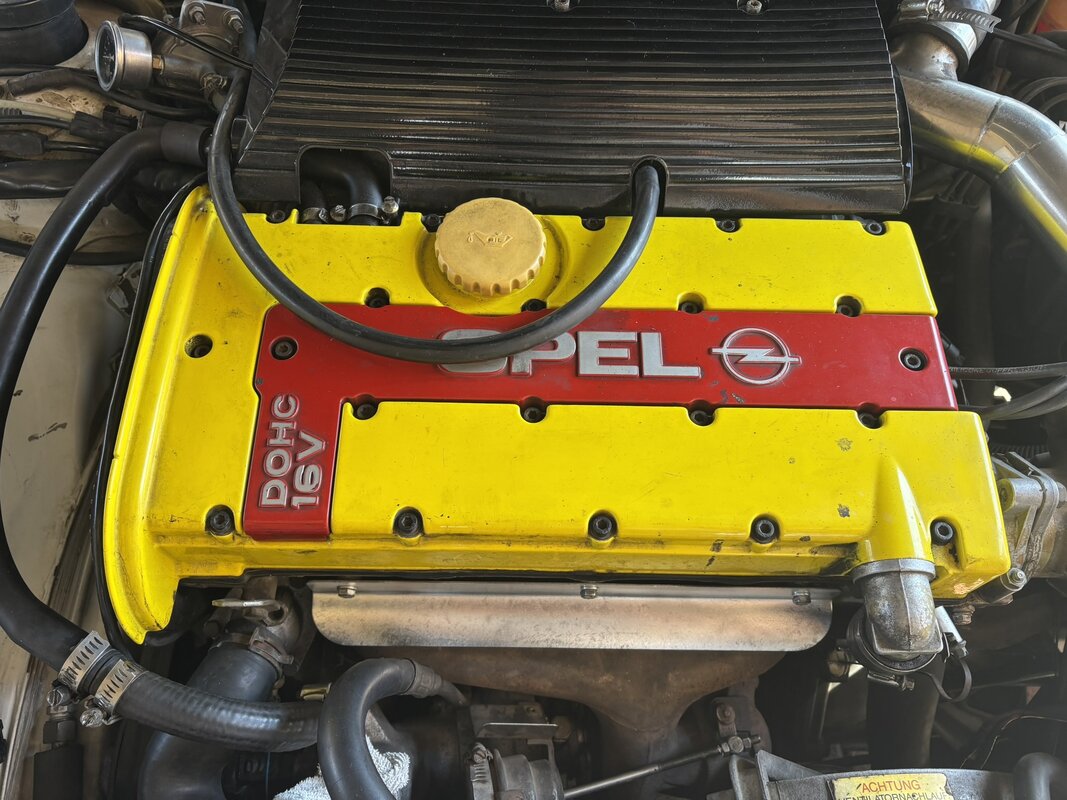

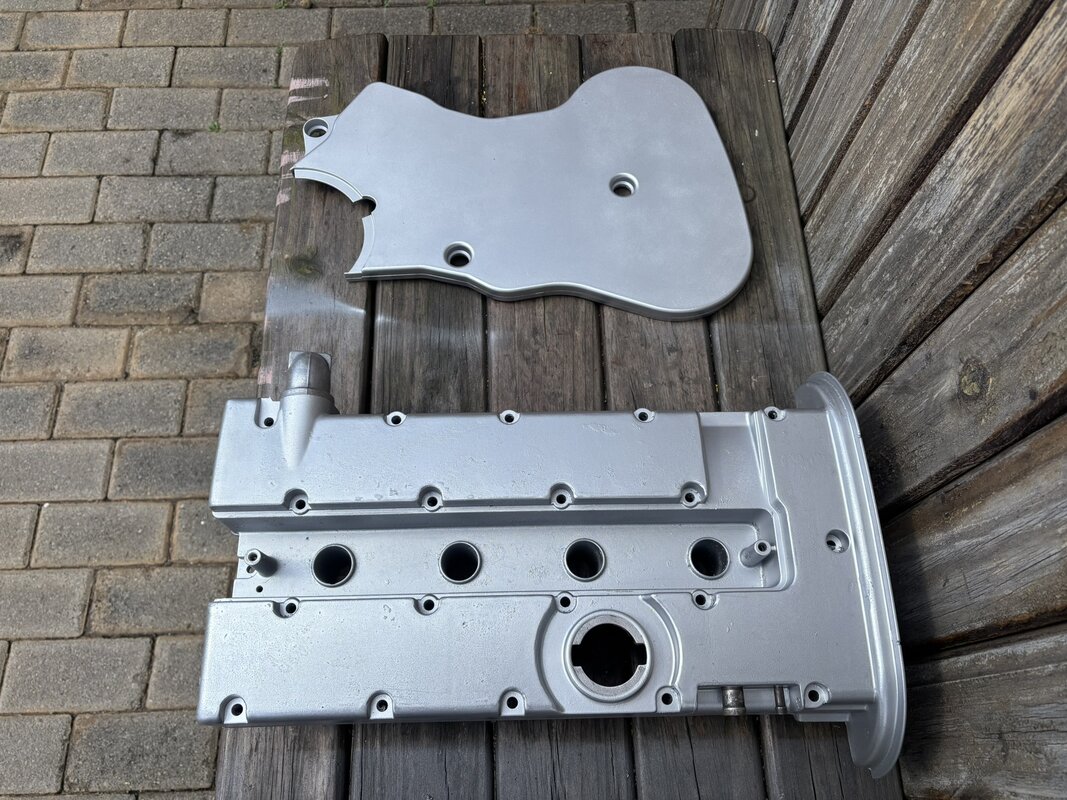

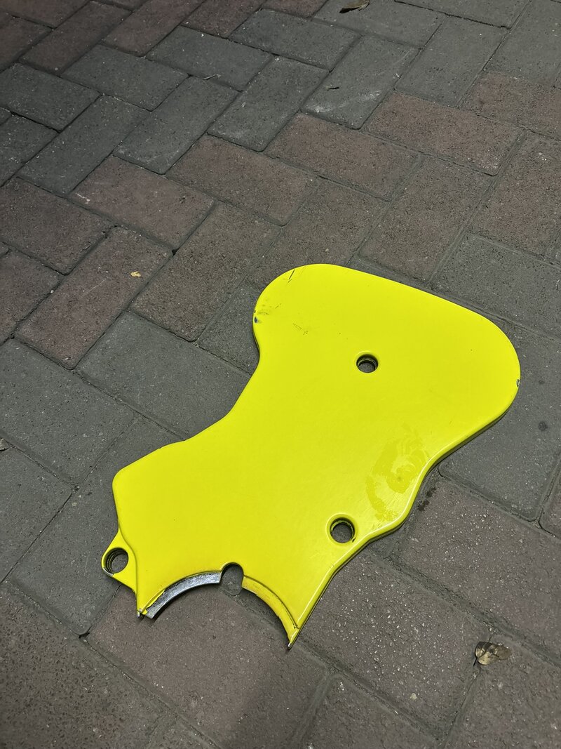

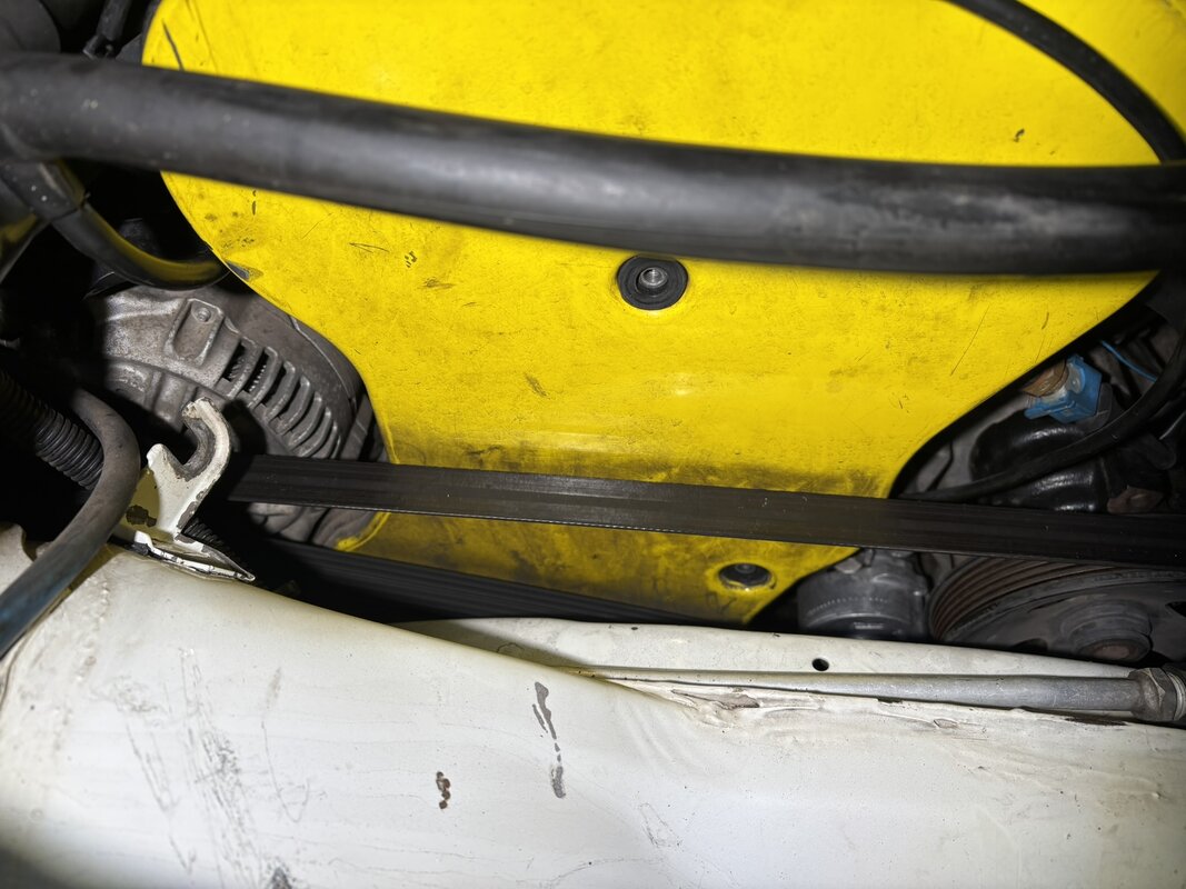

Yellow tappet cover and cambelt cover: I planned to do this over a weekend, which would give enough time to clean, prep and paint everything without leaving the motor open and exposed to the elements for too long.
Some pics beforehand:
After cleaning the cover, prior to starting with the paint stripper:

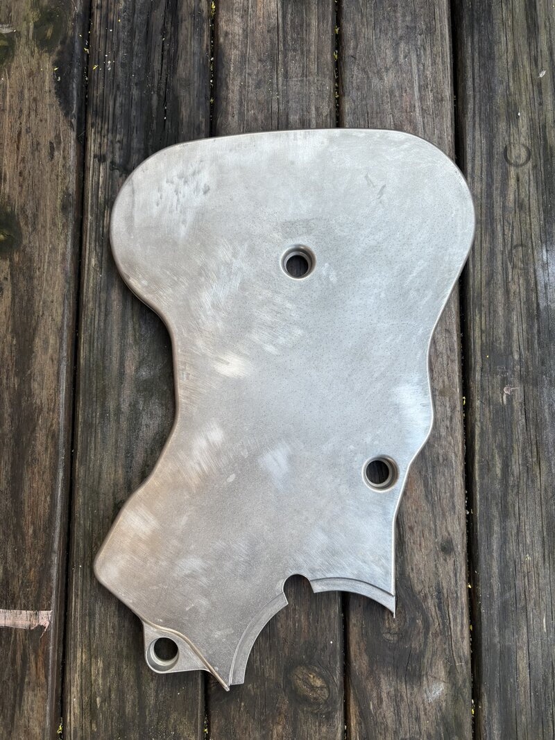

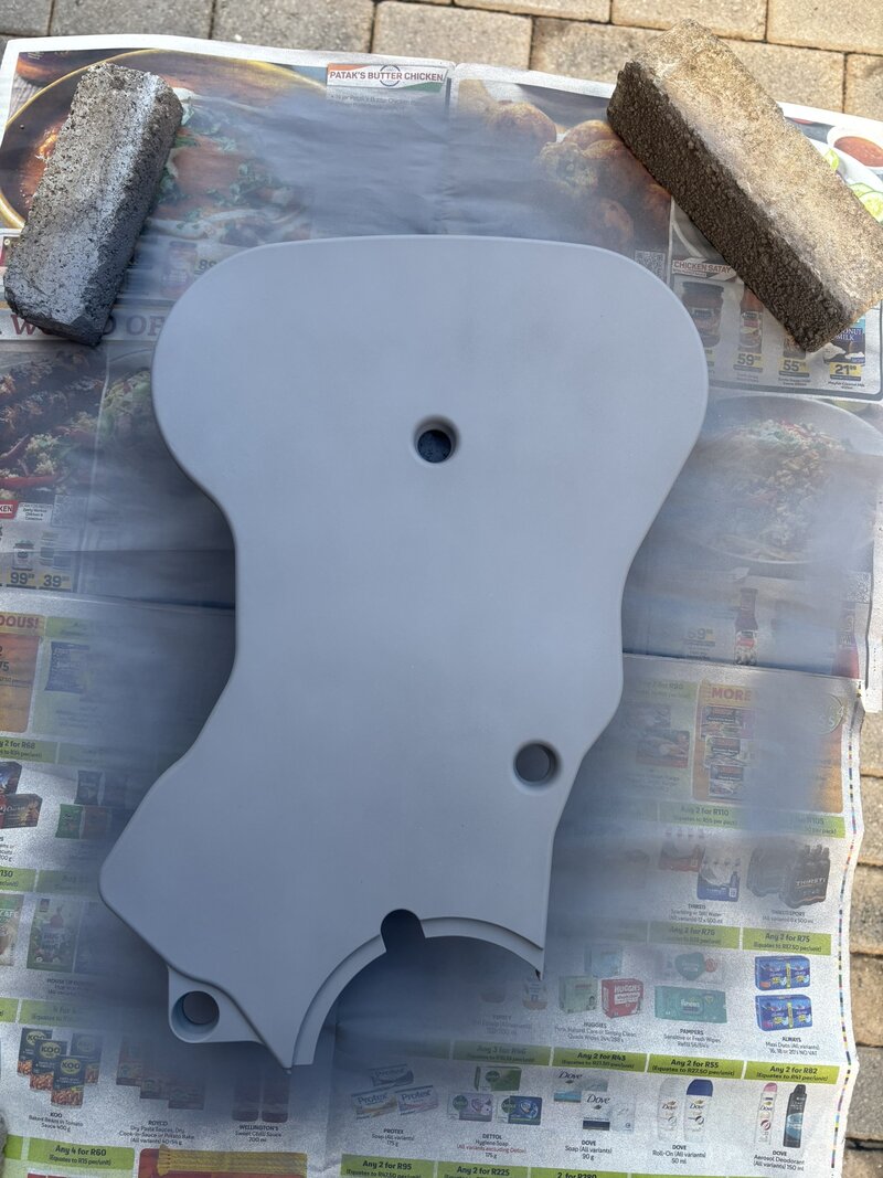

Then, using the %$#@& paint stripper, I tackled both covers. It did take some time, and multiple reapplications, together with use of some brushes, but all the old paint was removed, leaving bare surfaces for primer and paint.
Primer applied:

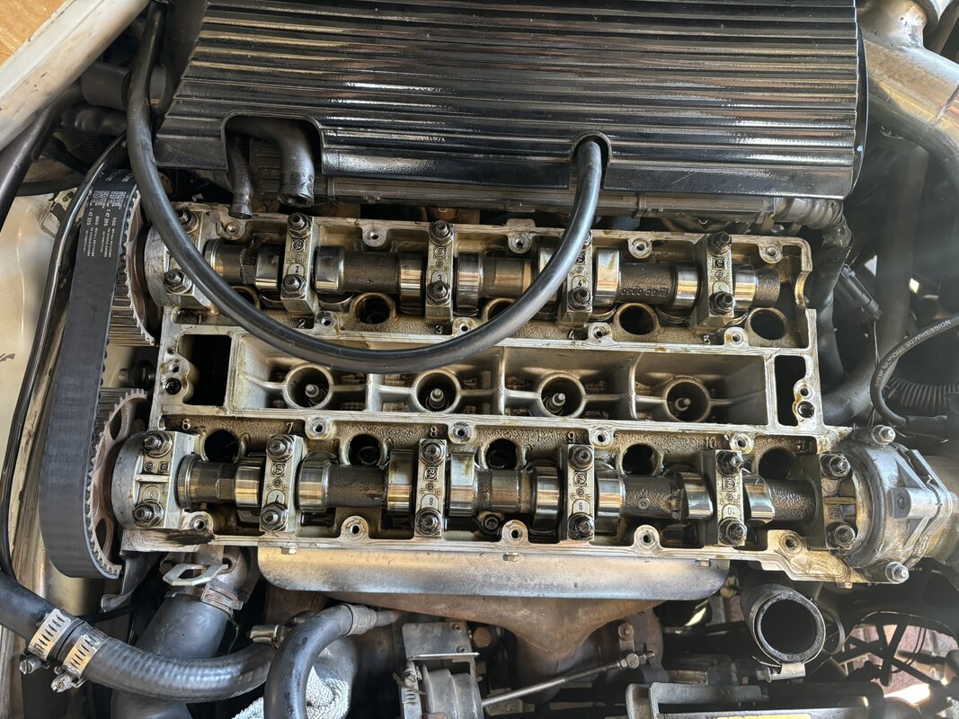

The cams and everything else in the valvetrain was looking pretty good too:

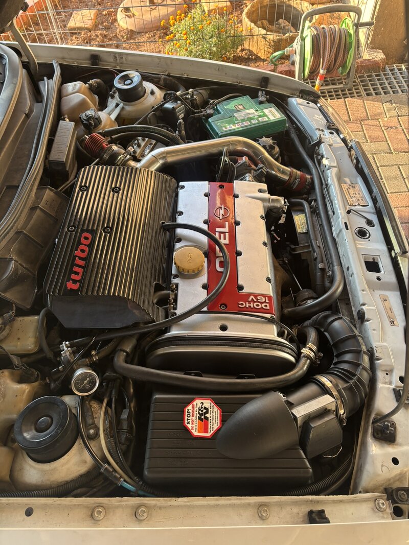

After painting:
Reinstalled and job done. Overall, I would rate the end result a 7/10. The finish isn't perfect, but it almost fits in perfectly with the age and patina of other parts. It doesn't look too new. I am however pleased with the outcome. Much much better for my eyes.

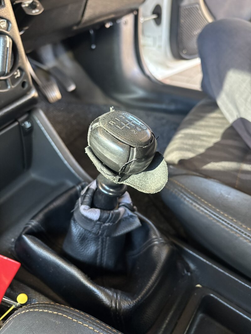

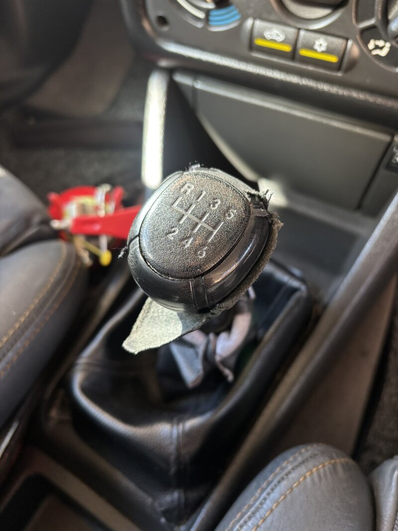

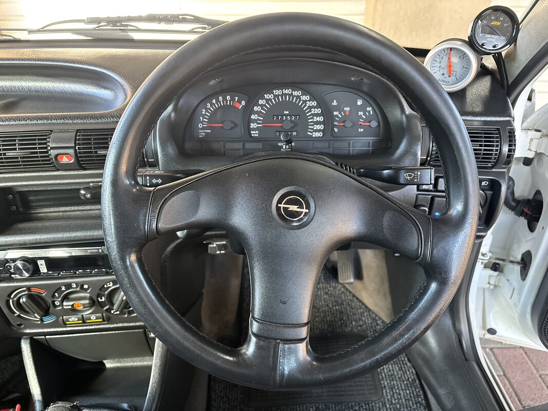

Time to move back to the interior. On the to-do list for the future, is to sort out the gear knob:
And the steering wheel. While it doesn't look too bad, some accumulated muck is discuising some wear on the leather. The dashtop gauges in the corner also need to be dealt with. Lastly, you can also get a glimpse of a clean door jamb:

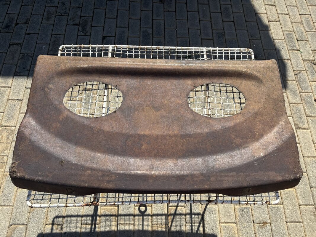

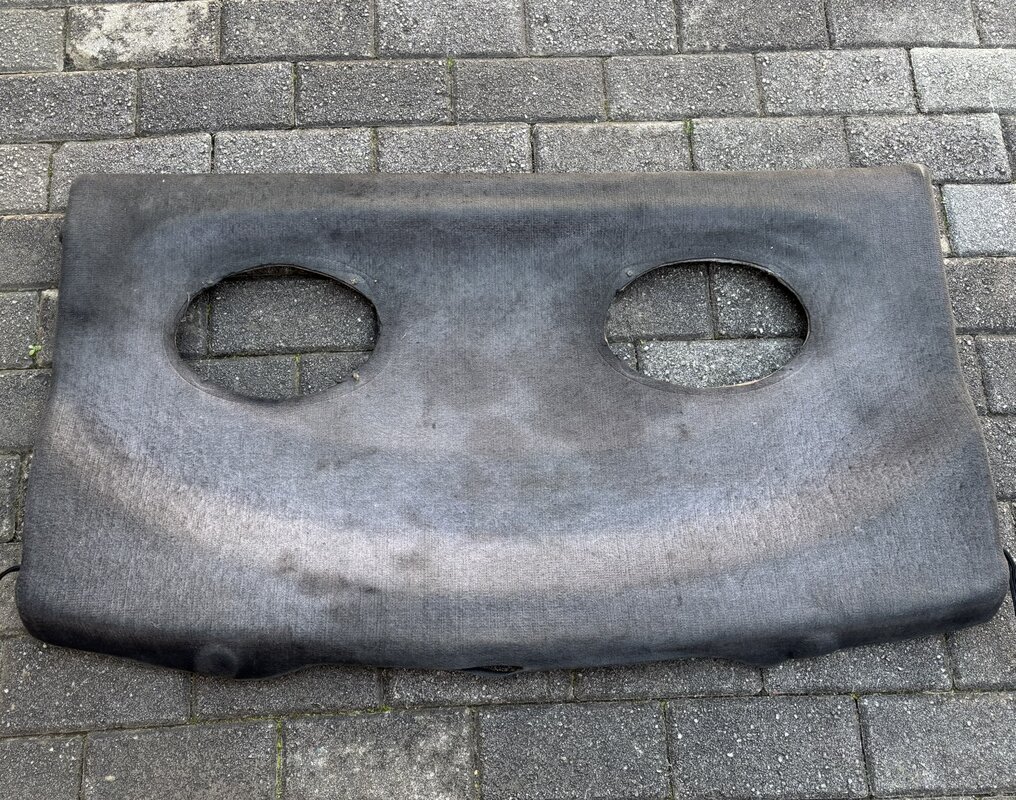

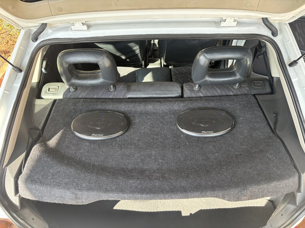

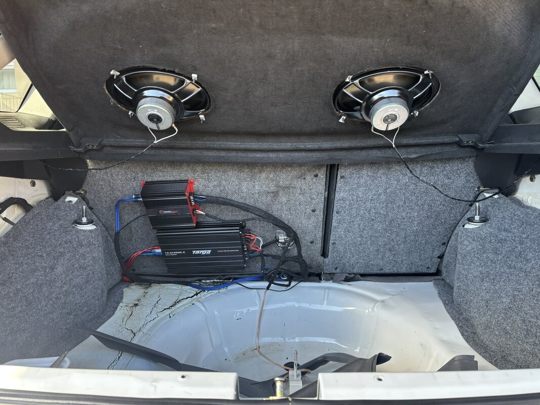

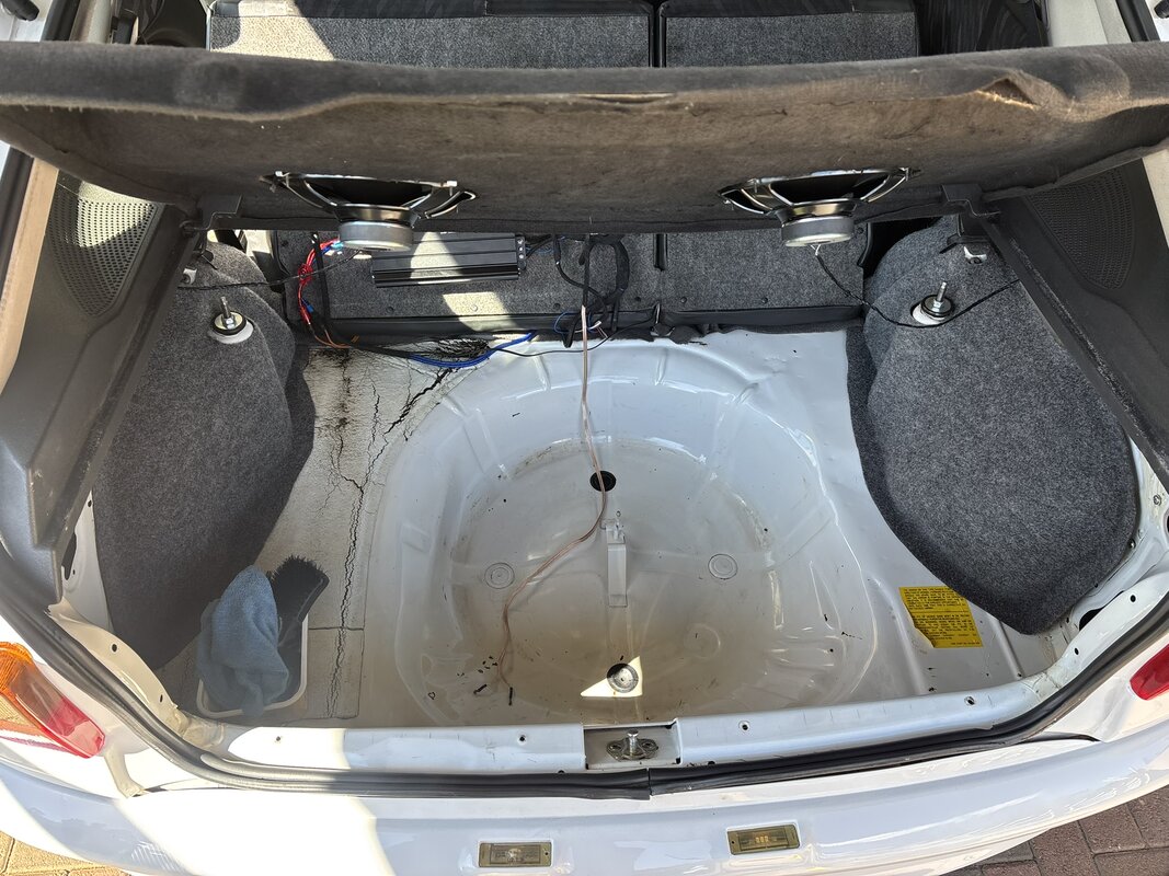

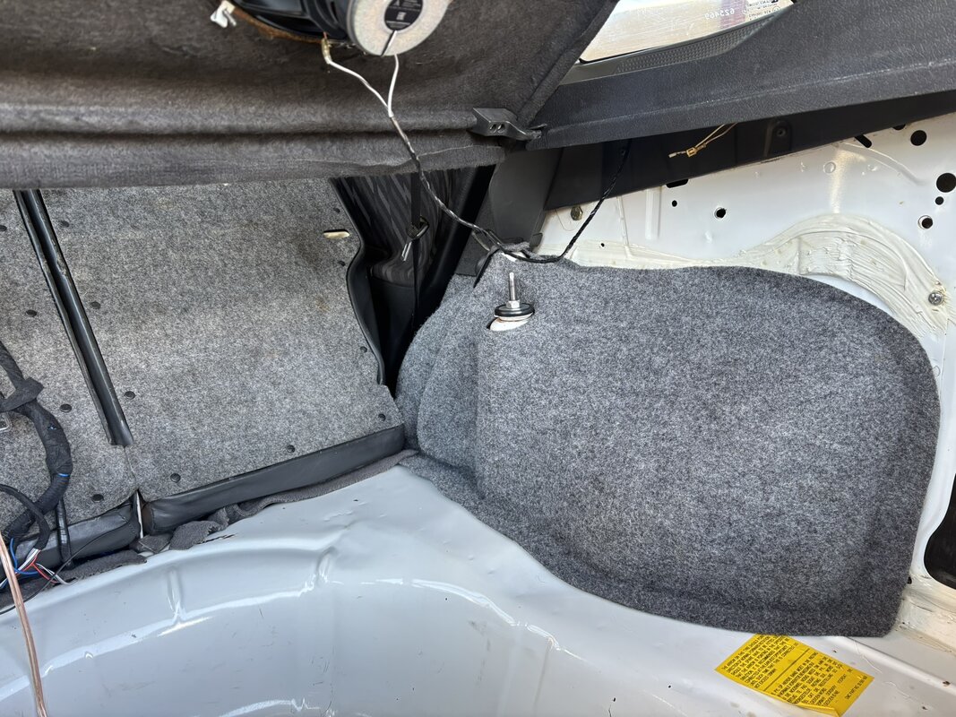

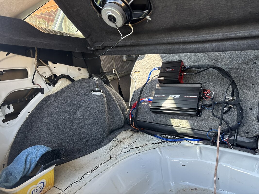

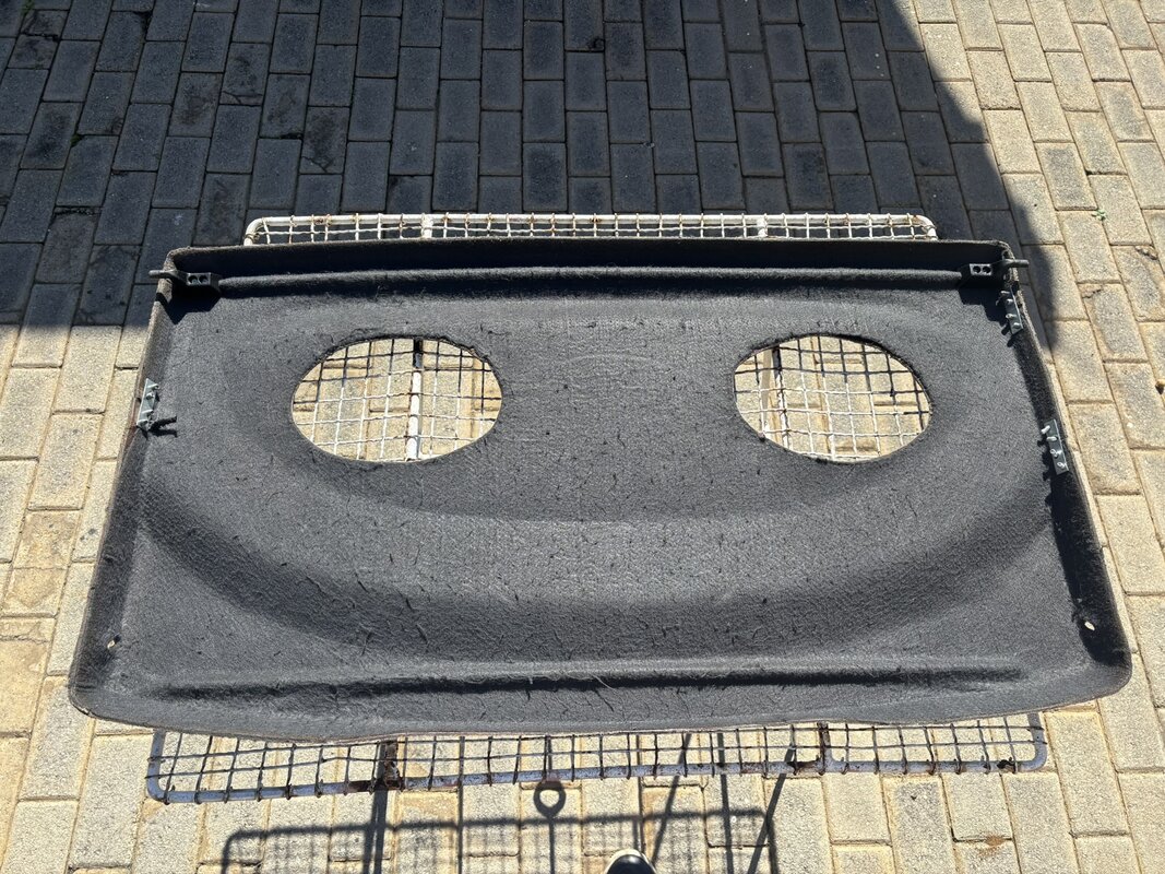

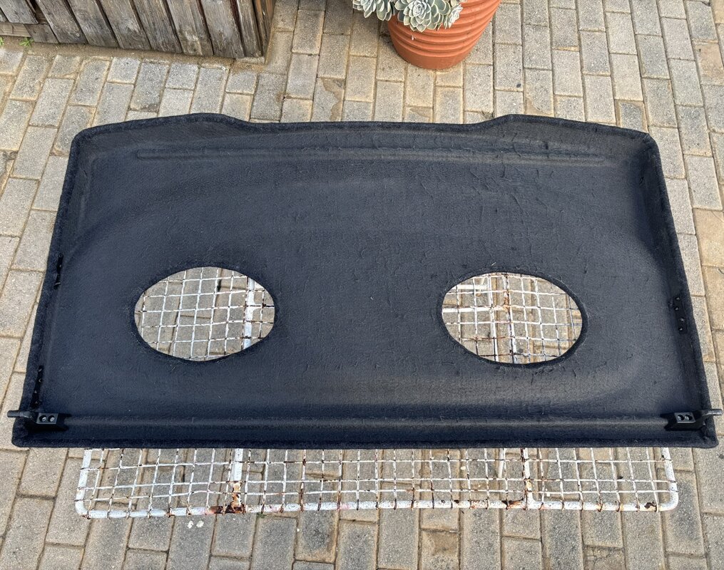

Having finished with the roof lining and door jambs, our focus turned to the boot area. Here things were quite tatty, and in need of some thorough cleaning. All the panels and carpeting were removed, and cleaning started. Painted areas received the same treatment as the door jambs (clean, clay, polish, seal). The carpeting was cleaned (extraction vacuum as well as spot treatment where needed), and then everything was reinstalled again.
Here the wheel arch cover was cleaned, but the seatbacks had not been cleaned yet. Noticeable difference:
A cleaned and sorted spare wheel well:
The LHS wheel arch liner cleaned, seatback behind amps not yet cleaned:
RHS seatback cleaned, LHS still to be cleaned:

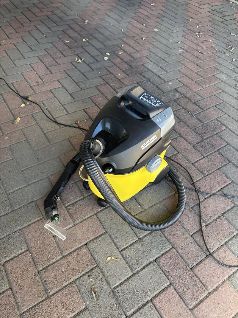

Our trusty Karcher working hard, with the worst still to come...

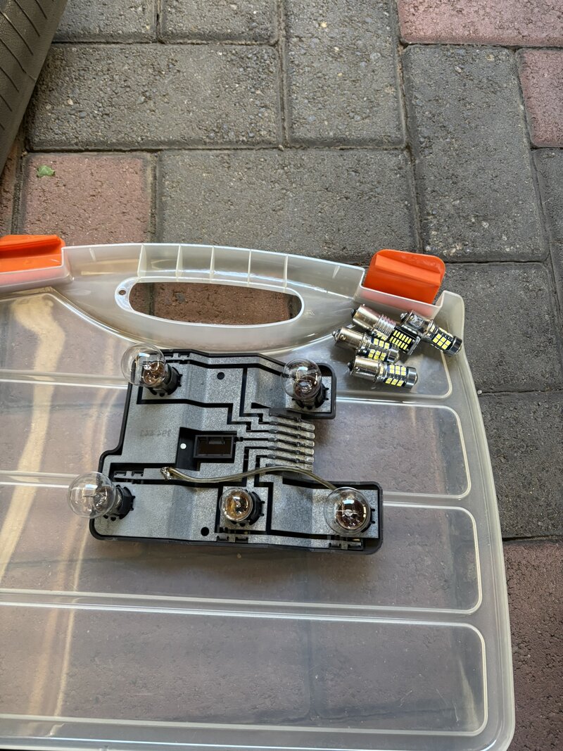

The previous owner had installed LED bulbs in the taillights, and while these did work, they were throwing warnings on the MFD in the dash. So I replaced the LED bulbs with “period correct” regular bulbs.

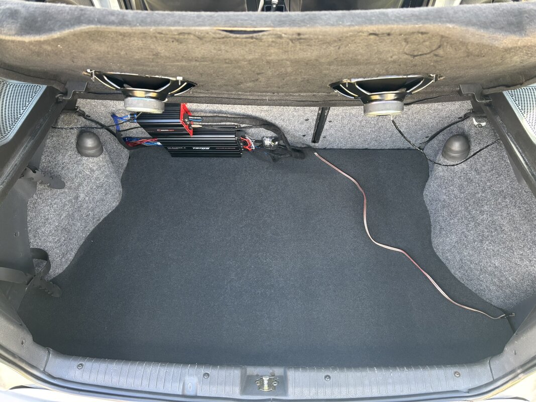

What are you planning on doing with the wiring spaghetti for the amps?
