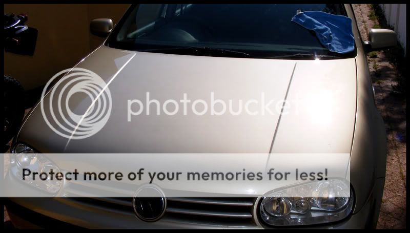

MK4 Golf - Todays test mule

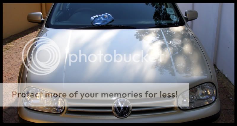

This car is very poorly maintained in terms of its paintwork. BP Car Wash is the designated place for a wash and vacuum and the car is rarely ever polished or waxed.
As you can see, the paintwork is dull with very little shine.

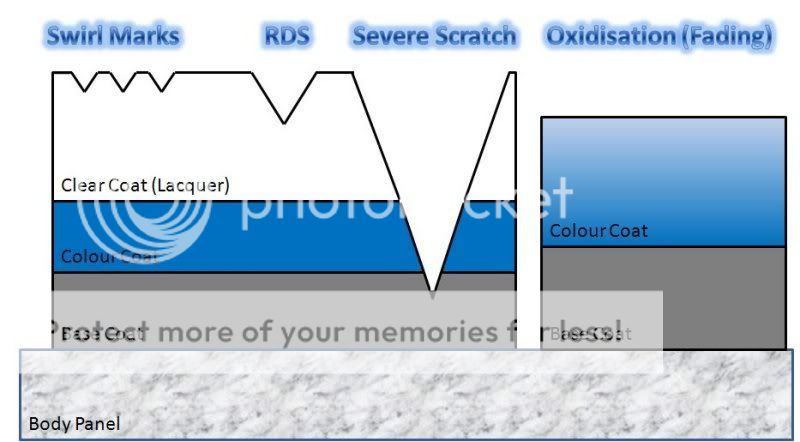

As per this image from Detailing World your cars bodywork is made up of a base coat, colour coat and then clearcoat. Some paint colours do not even feature clearcoats.
Over time, the paintwork on your bodywork suffers from the elements, poor wash technique and in some cars poor respray work. This is the reason the Golf looks dull and lifeless.
In cars with Metallic & Flat finishes swirling, holograms and paint imperfections can easily remove the sparkle or shine from the paintwork. The reason for this is because your clearcoat on the car has suffered. Imagine a glass window, clear and you can see perfectly outside. Now take sand paper to the glass - Your view outside is now impaired. The same applies to your BMW.

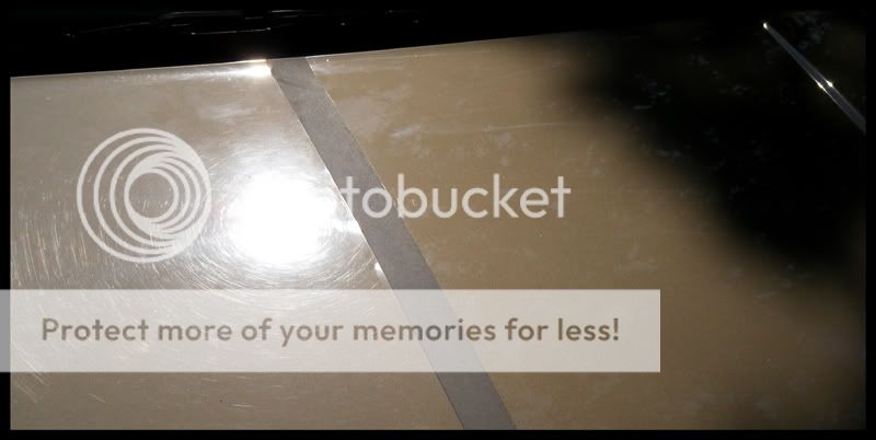

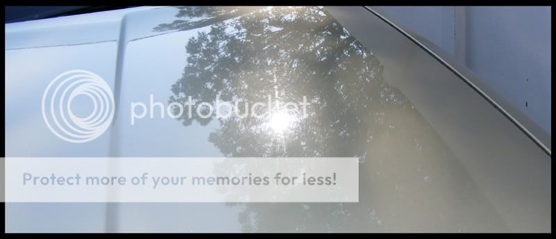

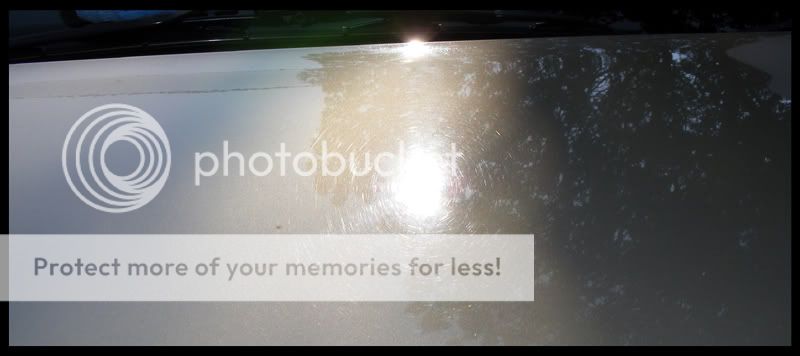

Lets take a closer look at these imperfections:
Swirling, oxidation and Holograms can all lead to less shine and clarity in your paintwork.

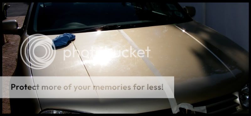

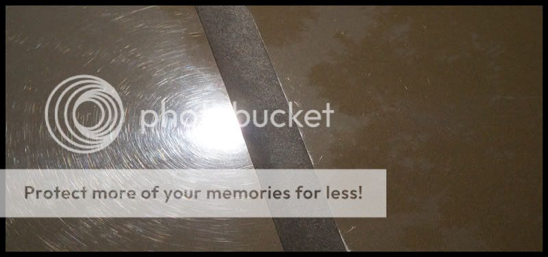

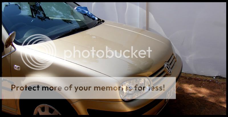

My results after two passes with the Rotary Polisher on the derelict Golf:
Lets take a look from afar and smile at the difference:

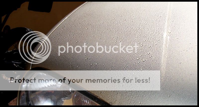

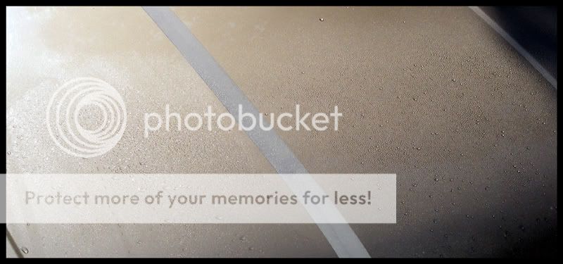

Todays wax is Chemical Guys XXX Hardcore White Wax, applied evenly with a microfibre and removed with a clean microfibre. The right side of the bonnet recieved two coats, the left is still unpolished and unwaxed.
Look at the beading the wax creates. Whereas the unpolished/unwaxed area is unable to repel the water causing the water to remain, causing more damage to the finish of the car.

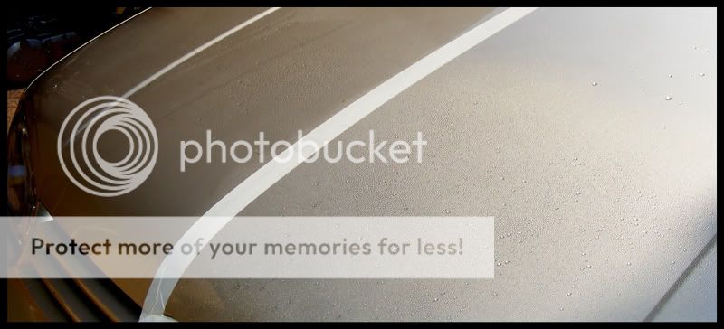

Beading up close:
With your paintwork enhanced, efforts protected you can now sit back and grin at your BMW:
