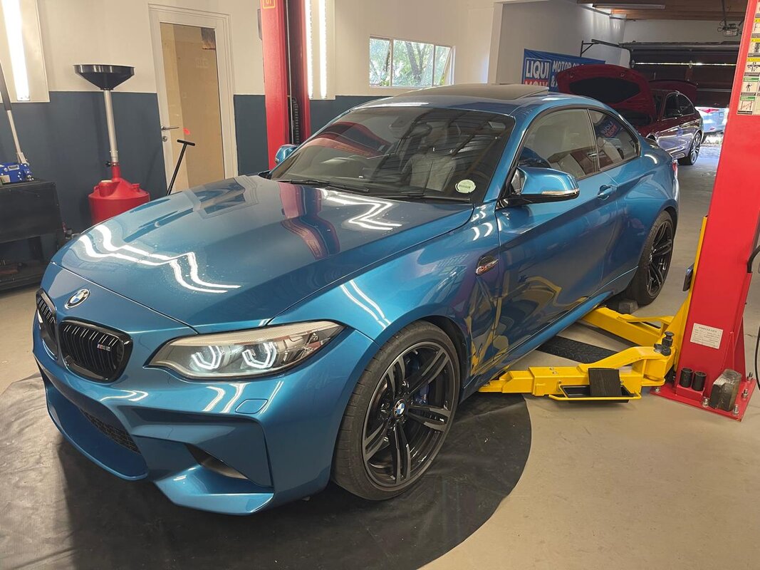

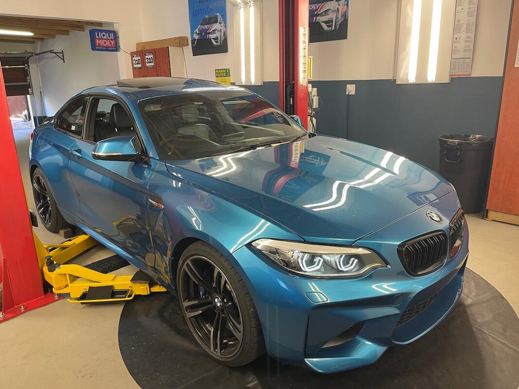

A few weeks ago, fellow fanatic Mo and I were chatting about his latest acquisition — a BMW F87 M2 LCI — and I offered to give it a thorough pre-trip inspection before he hit the road to KZN. With just two days before he left, we agreed to meet on the public holiday to get the car checked out properly.
He pulled in with this absolutely stunning example, and after taking a moment to appreciate the clean lines, subtle mods, and that unmistakable M presence — it was time to get to work.
🔍 Underbody & Mechanical Inspection

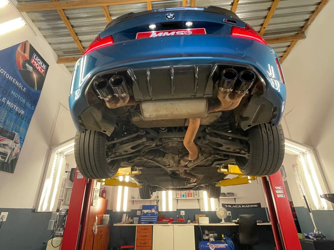

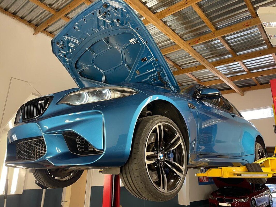

We got the M2 onto the lift, removed the undertray, grabbed our flashlights and started the inspection.
What I found was nothing short of impressive:

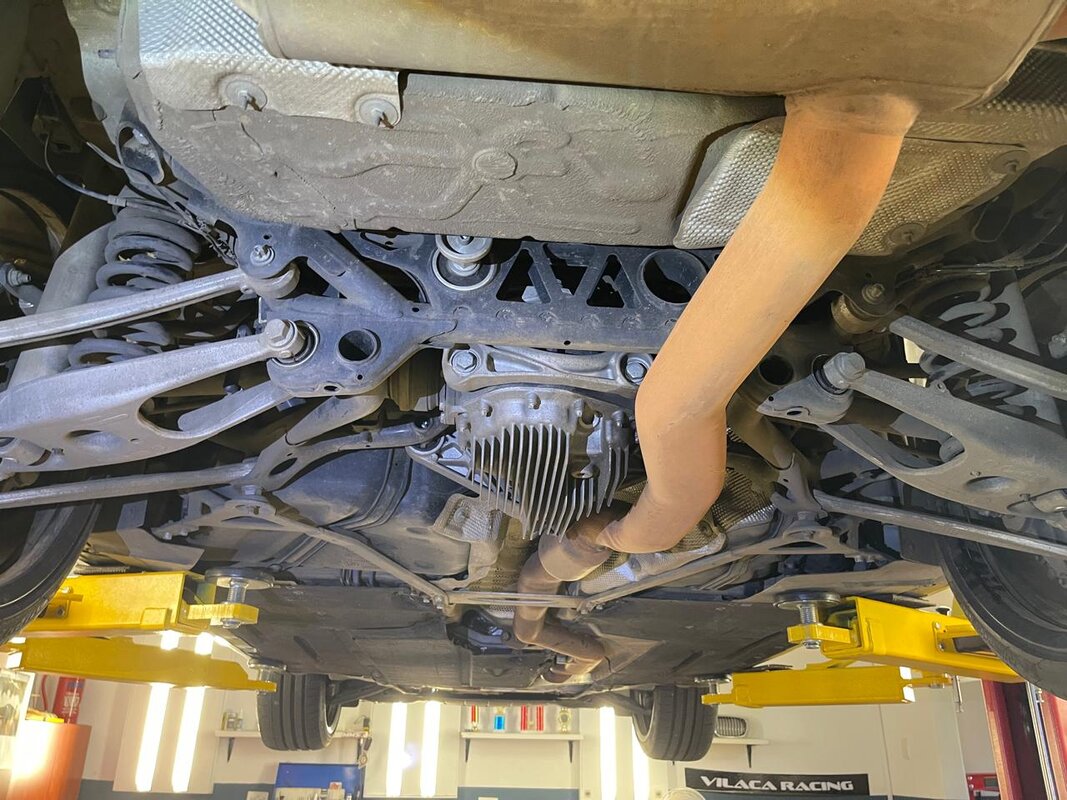

✅ No oil leaks – bone dry from the engine, gearbox, diff
✅ No residue or signs of past leaks
✅ Suspension components in excellent condition
✅ No play or movement in the usual suspects
✅ Exhaust hangers and bushings all solid

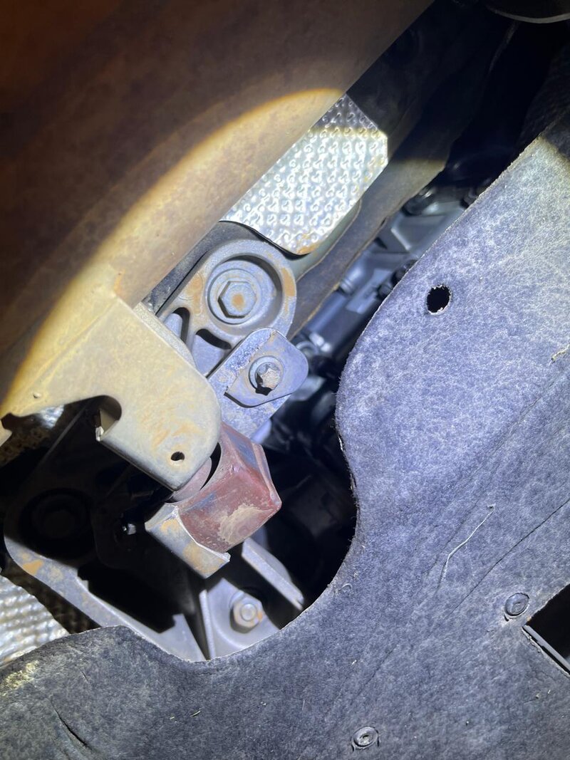

The only issue worth noting:
🔧 The downpipe bracket was broken. Small part, easy fix, and nothing serious. I sent Mo the OEM part number, and told him to bring it back whenever he has time — we’ll sort it.

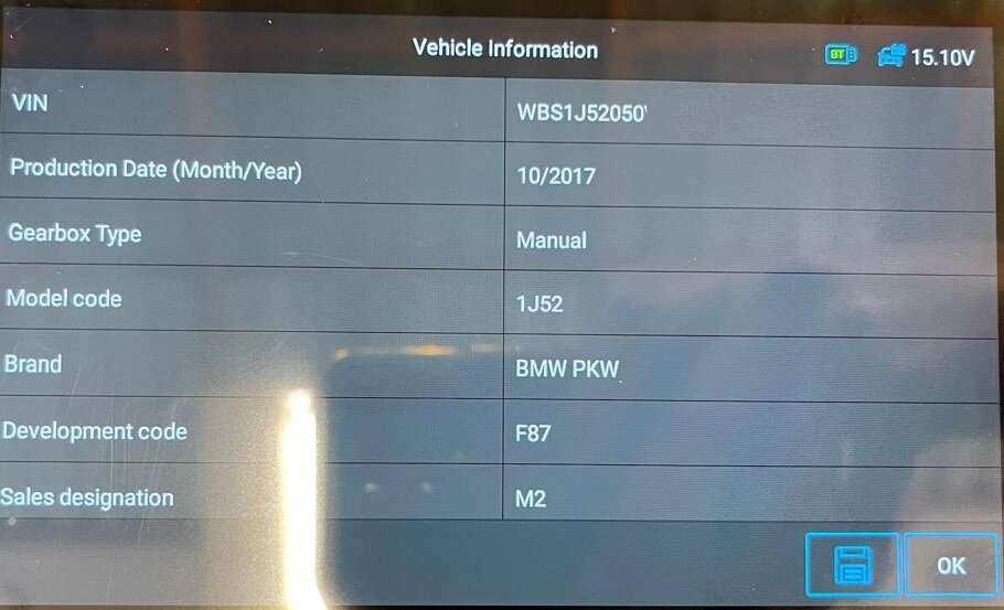

💻 Diagnostics & Final Checks
With the mechanical inspection wrapped, we:

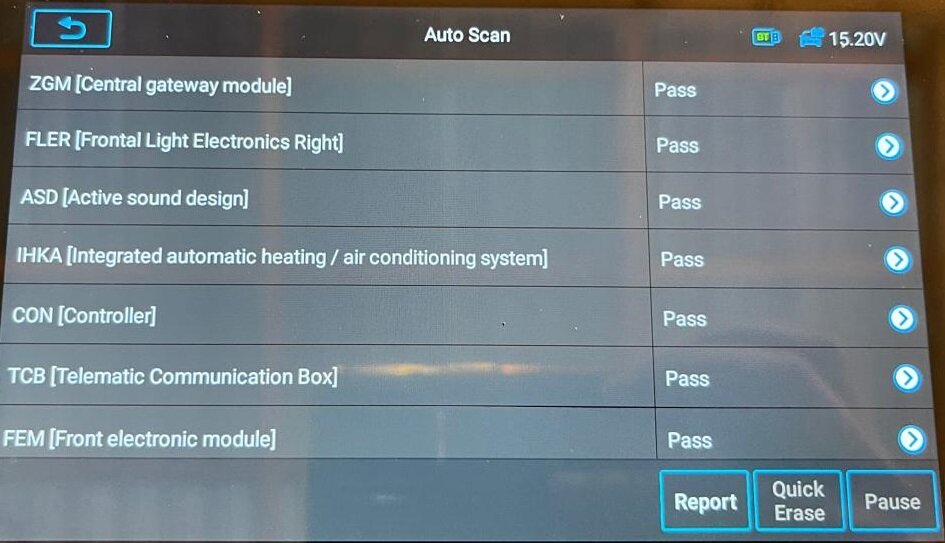

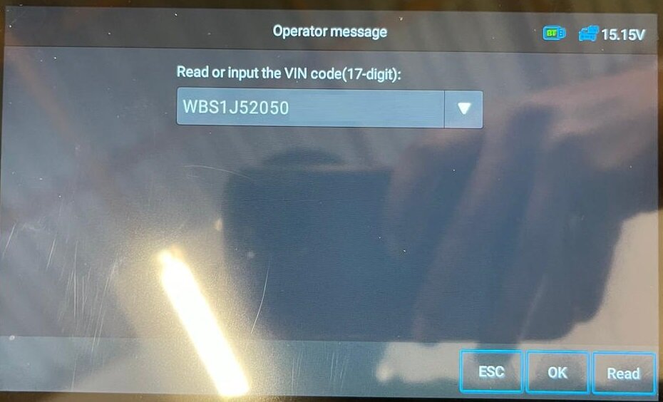

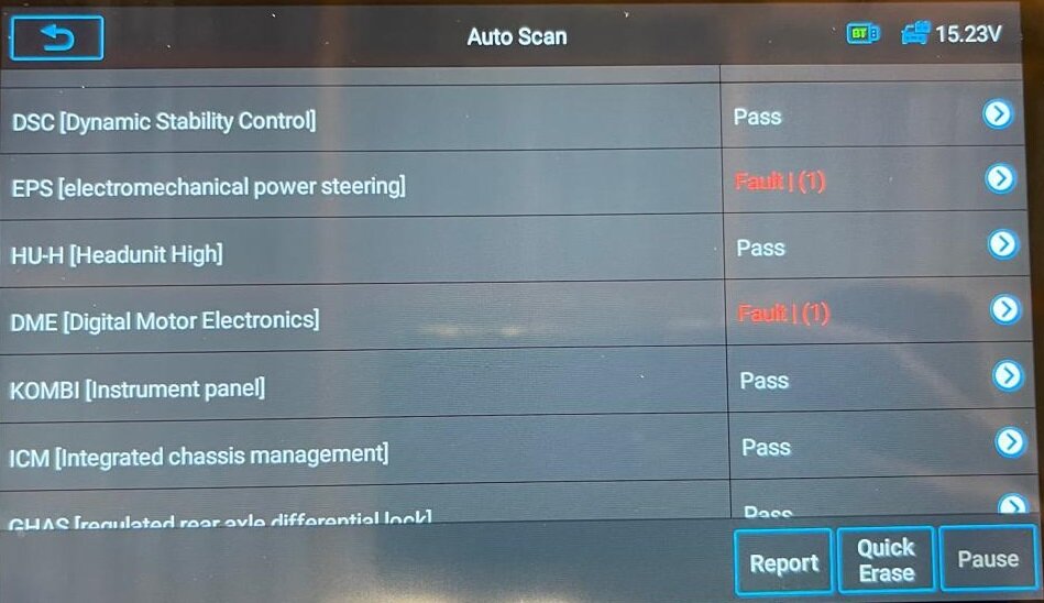

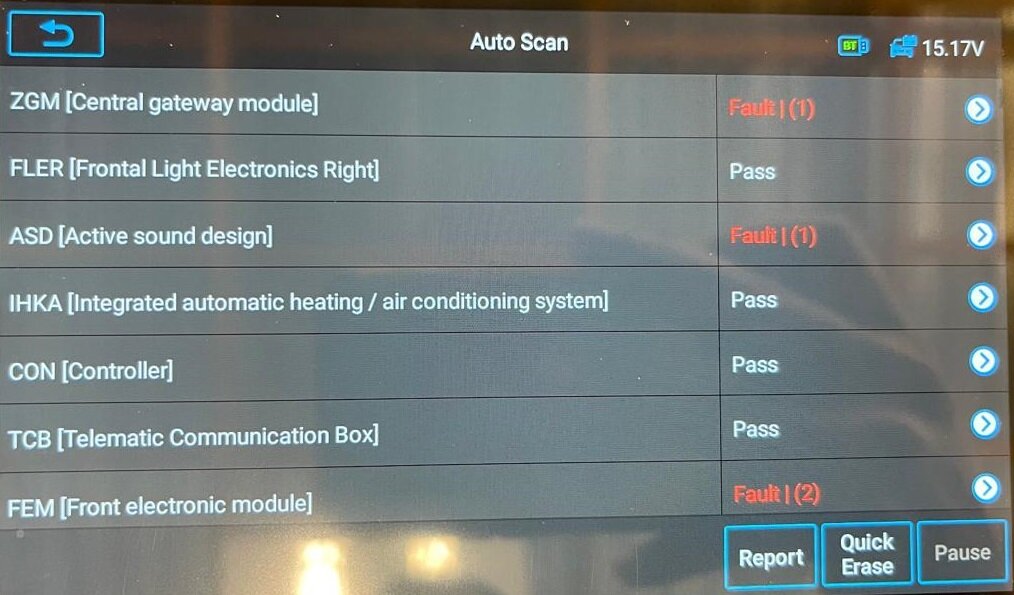

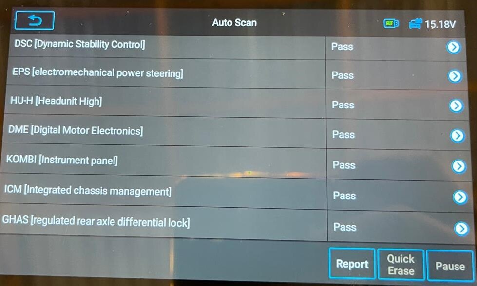

  • Plugged in the diagnostic tool
  • Found 18 stored error codes
  • Cleared them all successfully with 0 remaining
  • Sent Mo a full diagnostic report + pics
And just like that — he was on his way to KZN in a super clean, healthy M2 that’s ready for the open road.
