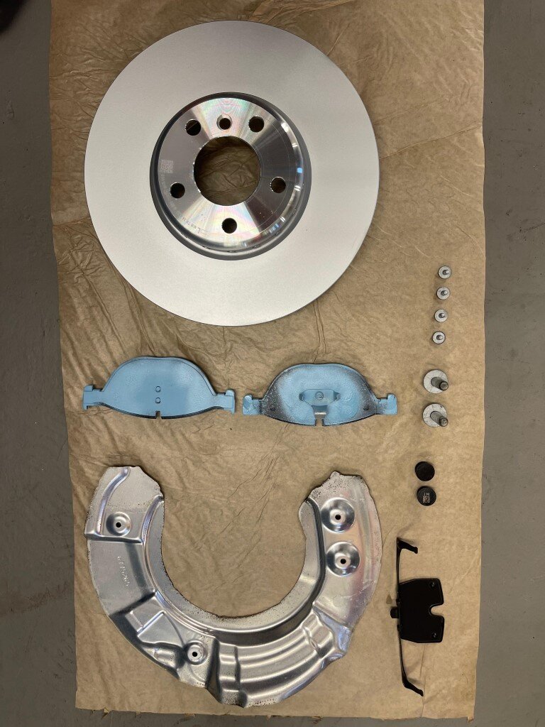

  • 🛞 New front discs
  • 🛞 New front pads
  • 🛞 New brake pad sensor

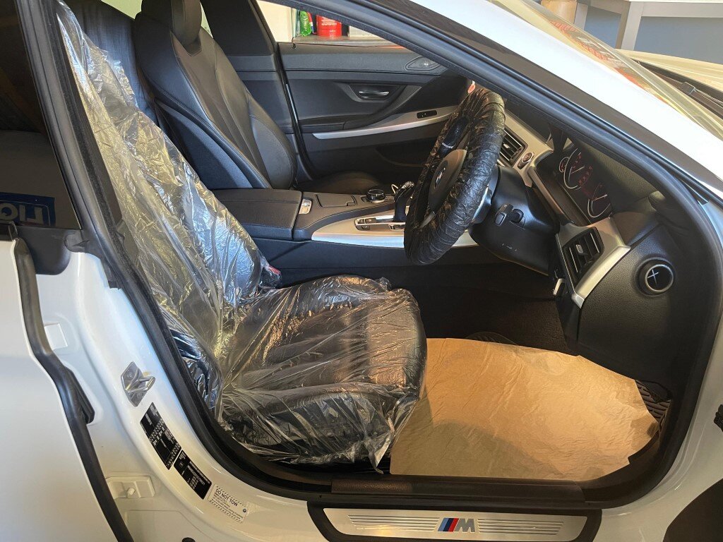

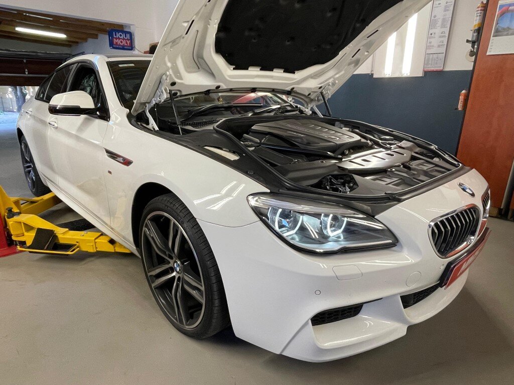

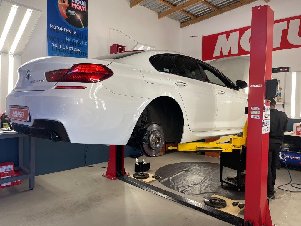

As always, we began by adding protective covers to the driver’s seat, steering wheel, and footwell to keep everything spotless. The 640d was then moved onto the lift and the wheels removed.

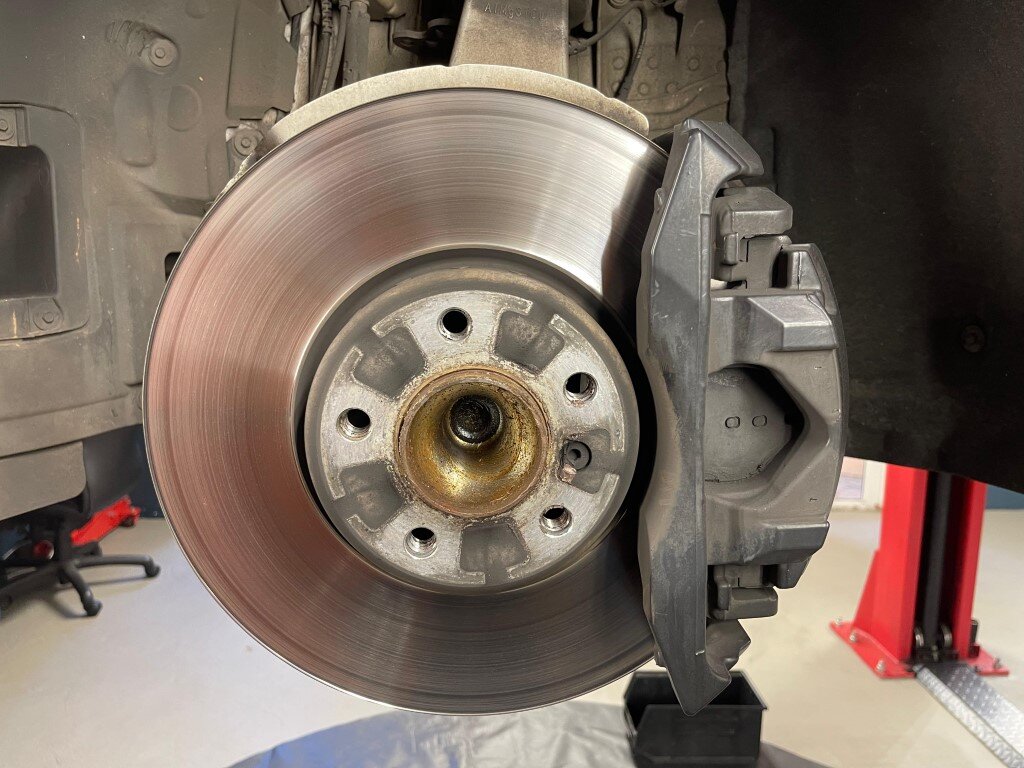

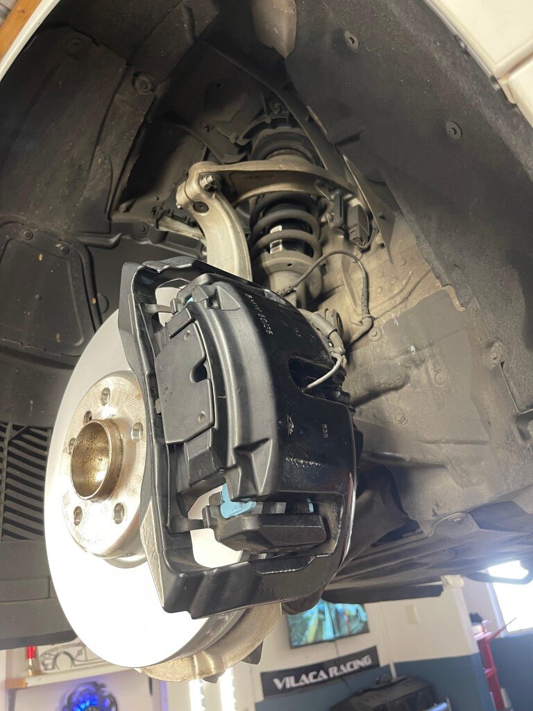

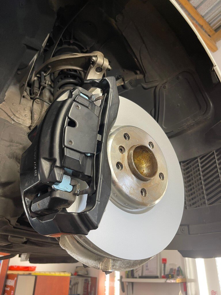

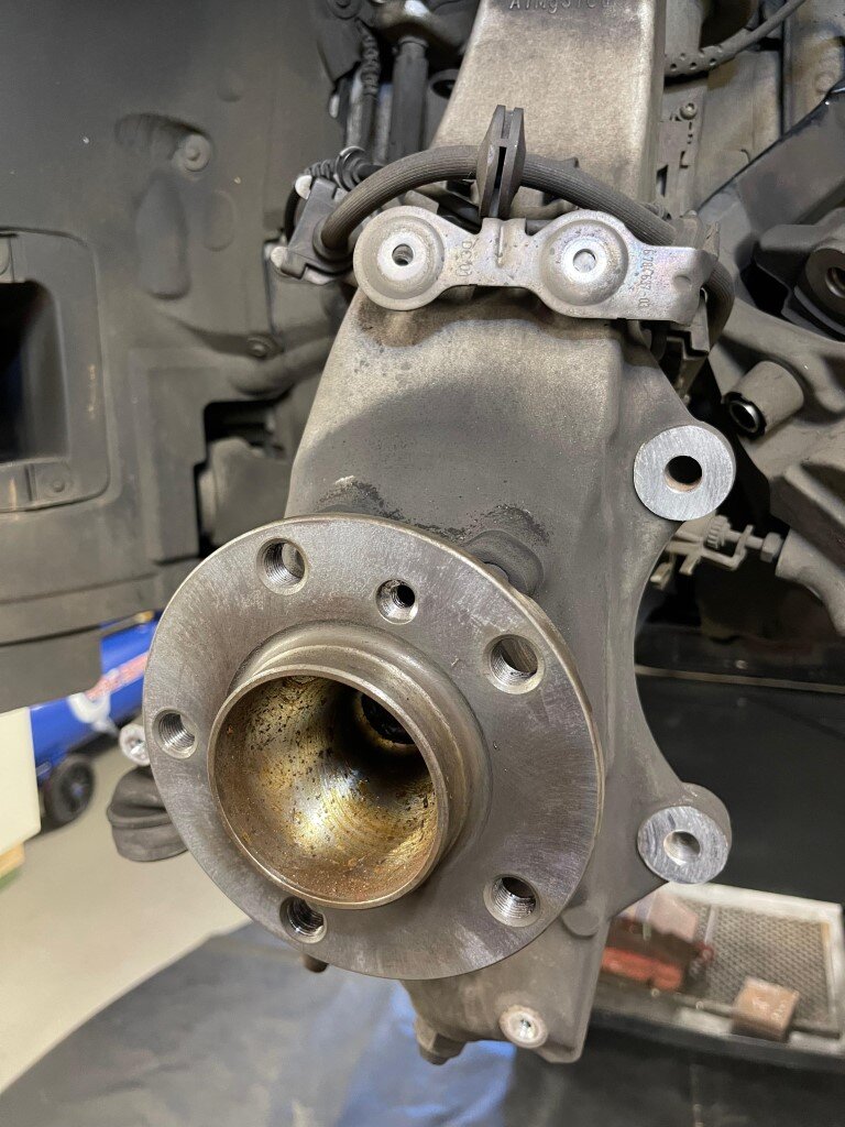

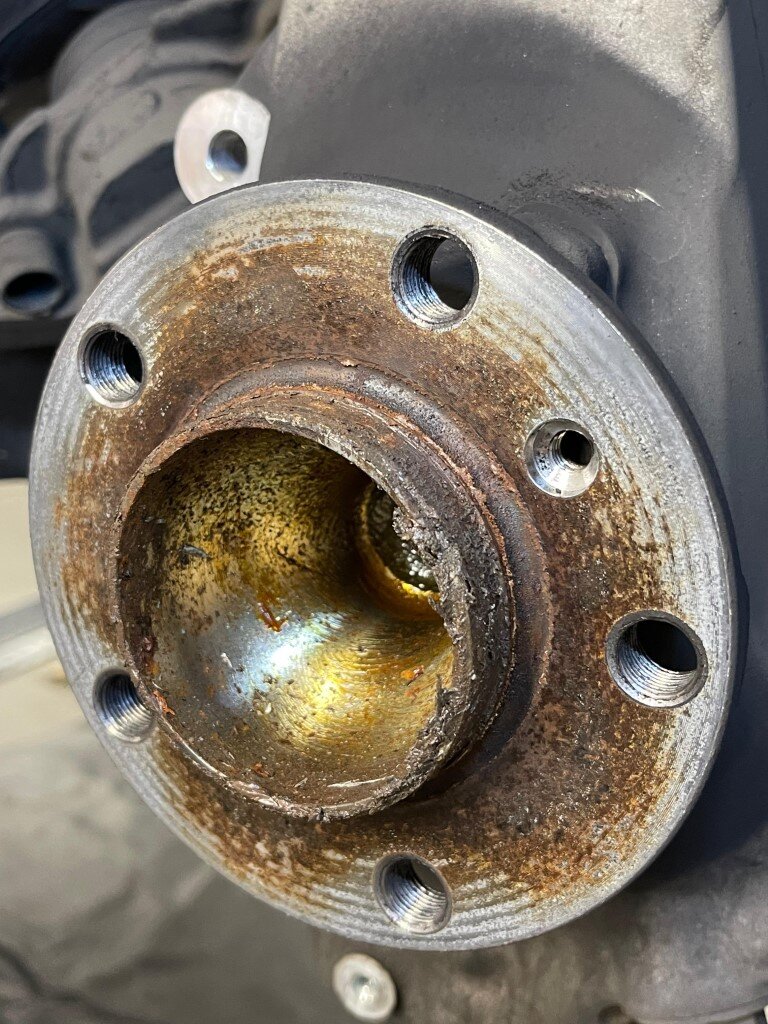

  • Stripped the front brakes completely down to the hubs.
  • Degreased and cleaned all hardware (calipers, brackets, retaining clips, bolts, etc.).

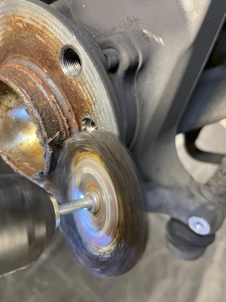

  • Rust on the wheel hubs was removed with a wire wheel and cleaned up.

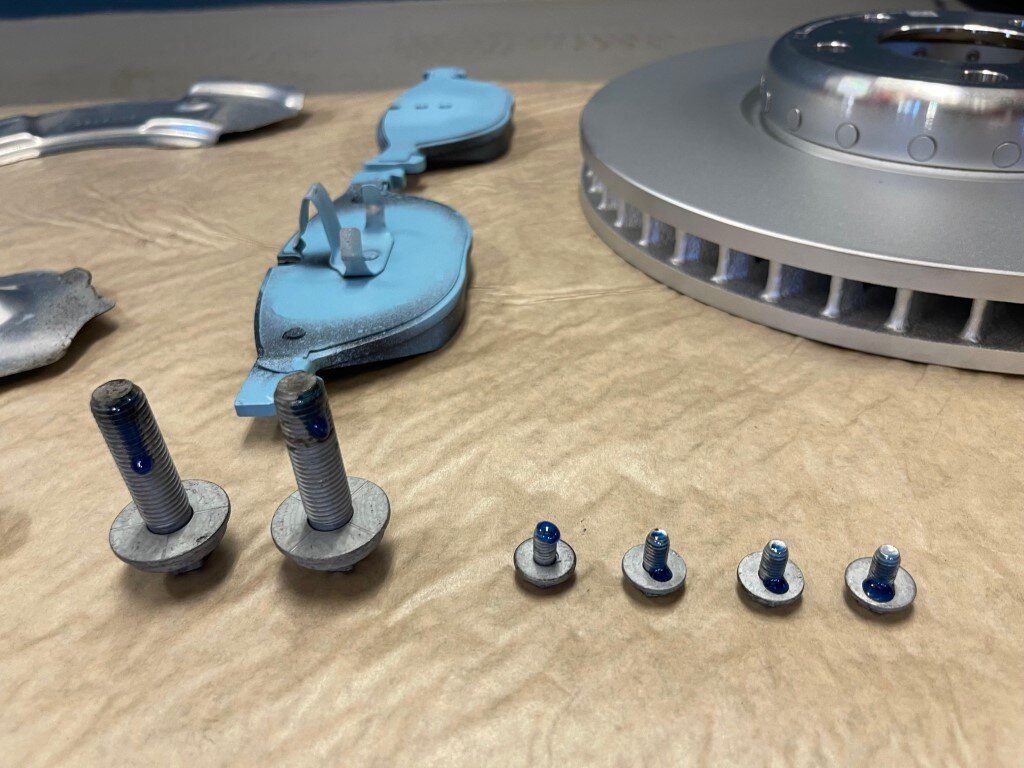

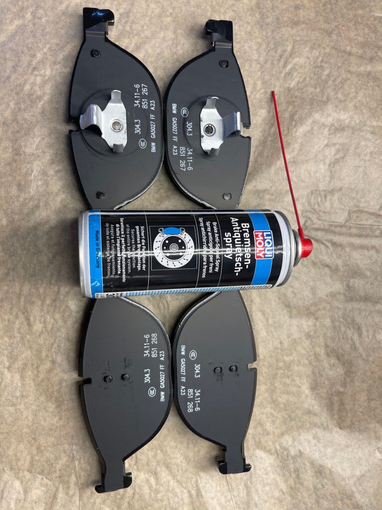

  • Prepped the new pads with anti-squeal spray.

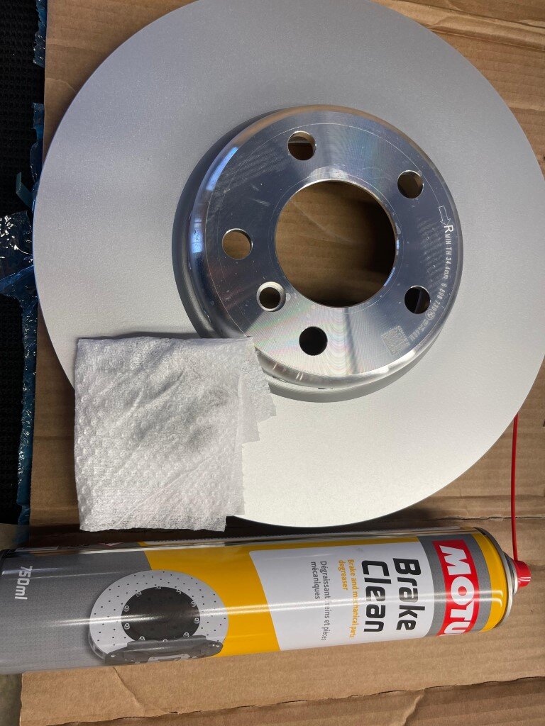

  • Cleaned the new discs with brake cleaner.
  • Carefully reassembled everything using anti-seize paste where required and medium thread-locker on bolts.

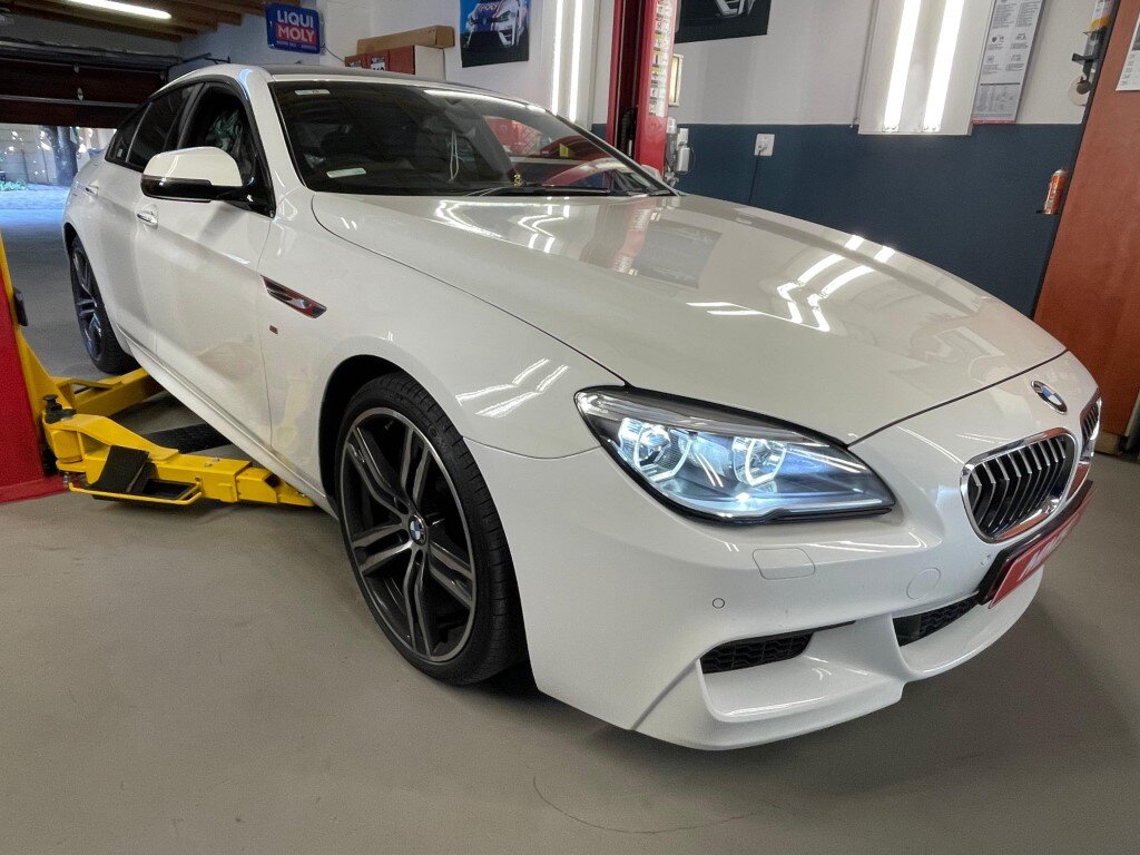

    Reinstalled the undertrays and wheels before lowering the car.
