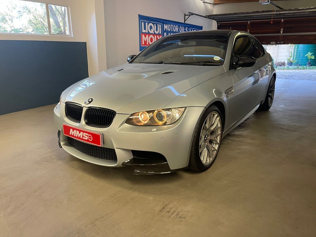

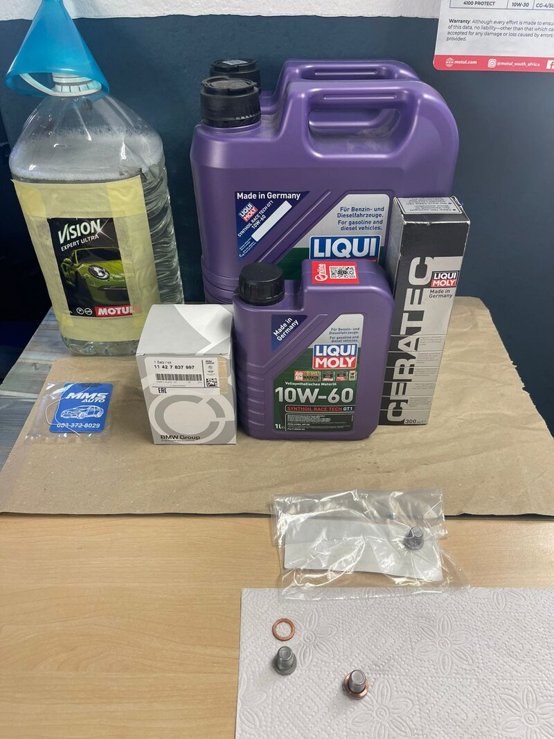

I was recently contacted by Kev, the owner of a stunning BMW E92 M3, for its annual service. He had already purchased a few quality components ahead of time, including a new OEM BMW oil filter kit, a new Drain plug, a bottle of Liqui Moly Ceratec and 1 Liter of GT1 10w60, and requested we supply the remaining Liqui Moly Synthoil Race Tech GT1 10W60 as well as a can of Liqui Moly Injector Cleaner.
Once the oil arrived, Kev dropped off the car and we got to work.

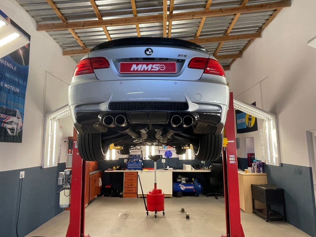

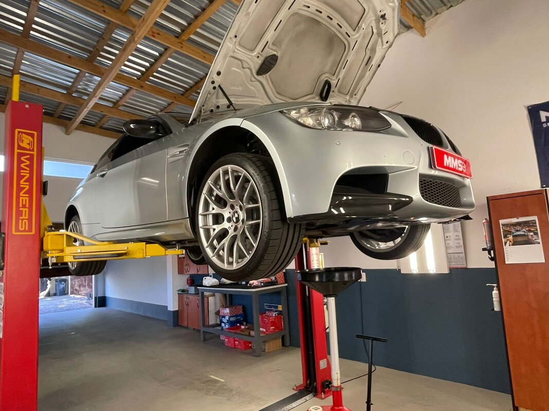

🔧 Service Procedure
- Fitted protective covers to the steering wheel and driver’s seat

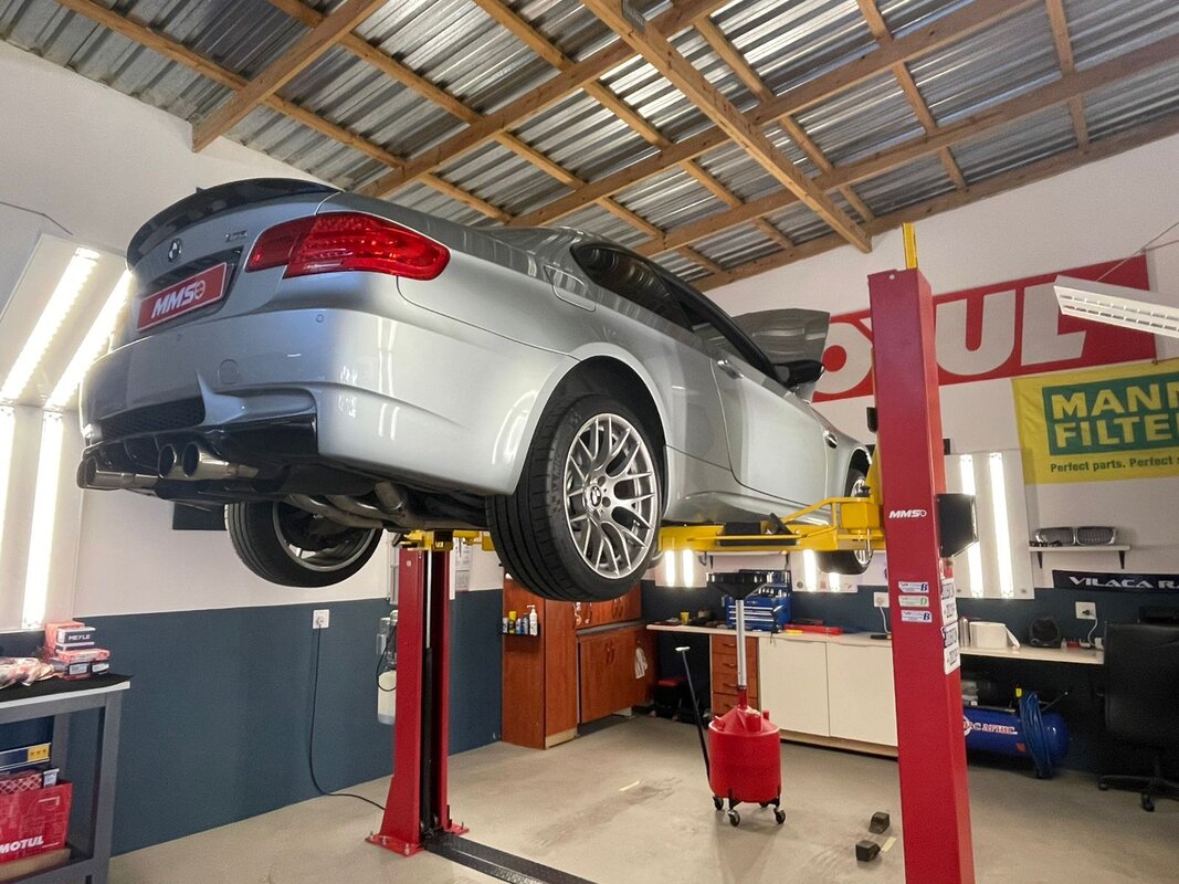

- Moved the vehicle onto the lift and began the service

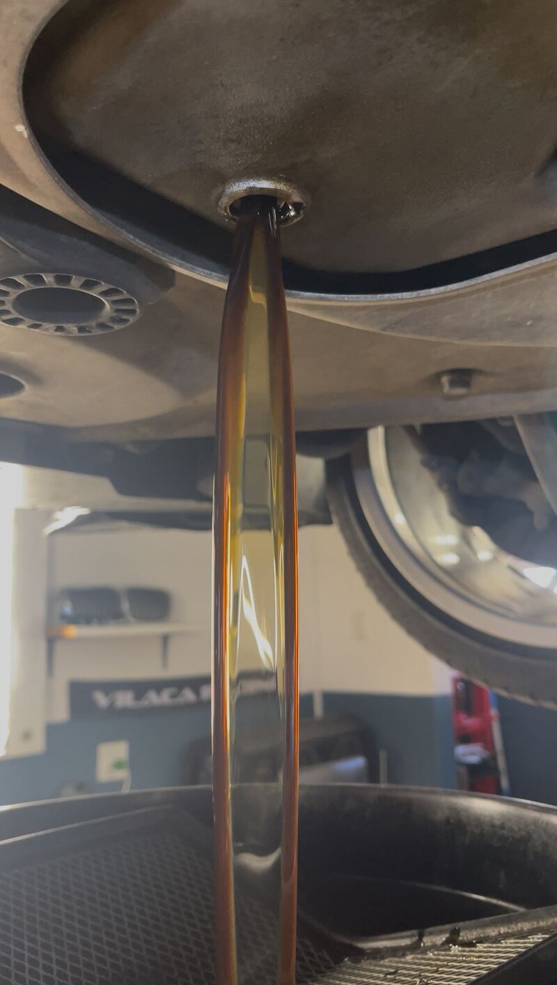

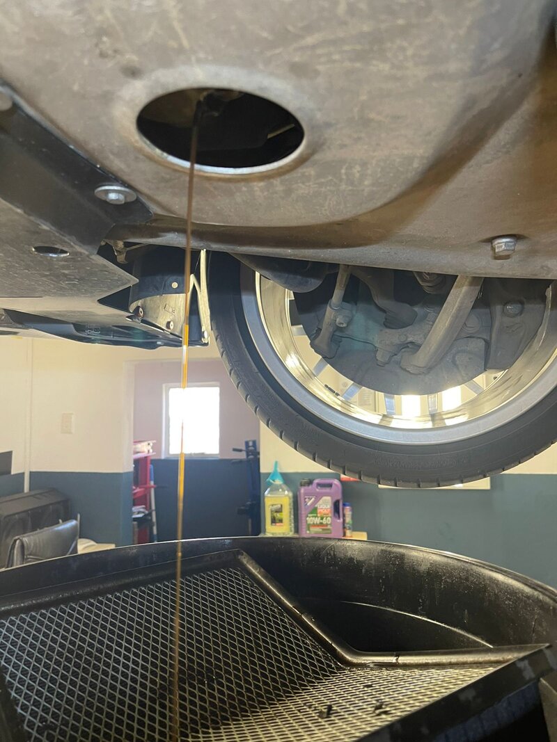

- Drained the engine oil from both sump plugs, allowing a full drain until no oil remained

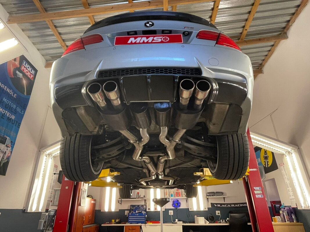

- While the oil was draining, we gave the undercarriage a full inspection checking the Tyres, Brakes, Suspension, Drivetrain, Exhaust, Differential. Etc

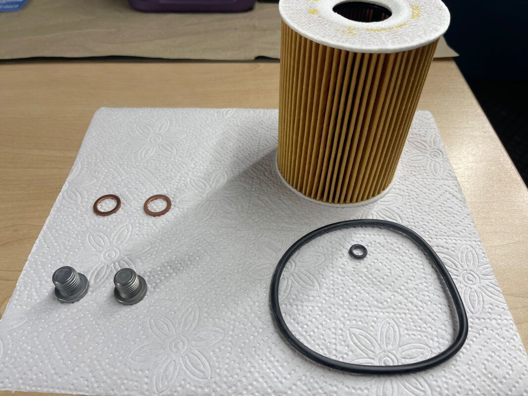

- Replaced copper crush washers and refitted the sump plugs
- Cleaned the drain plug area to avoid any residual mess

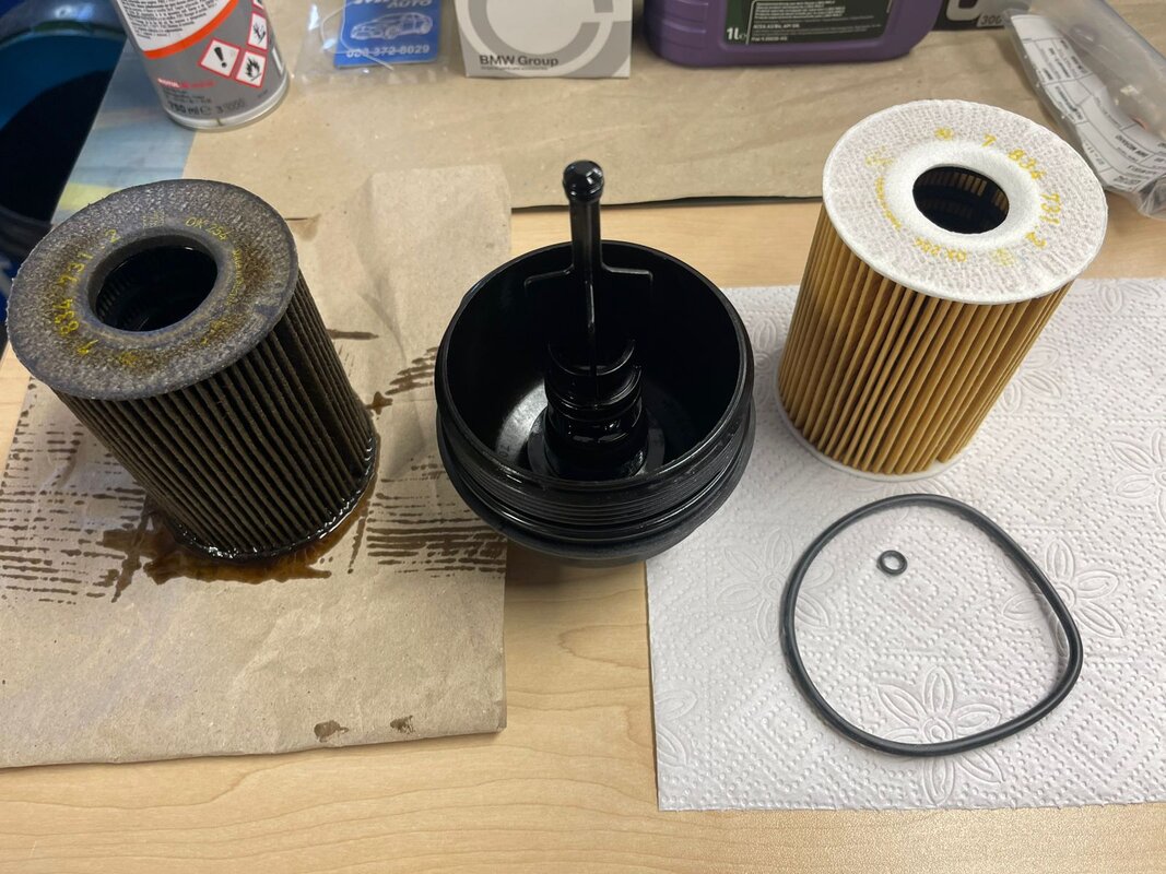

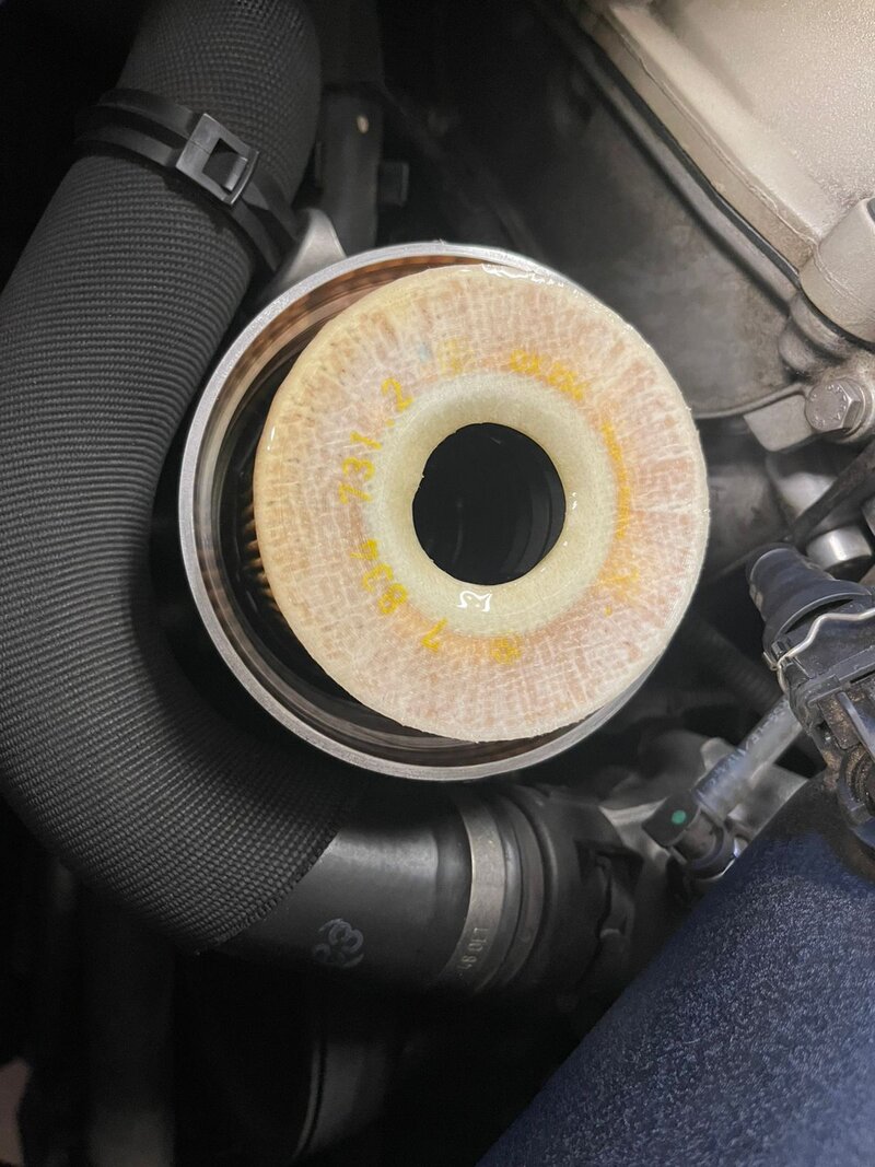

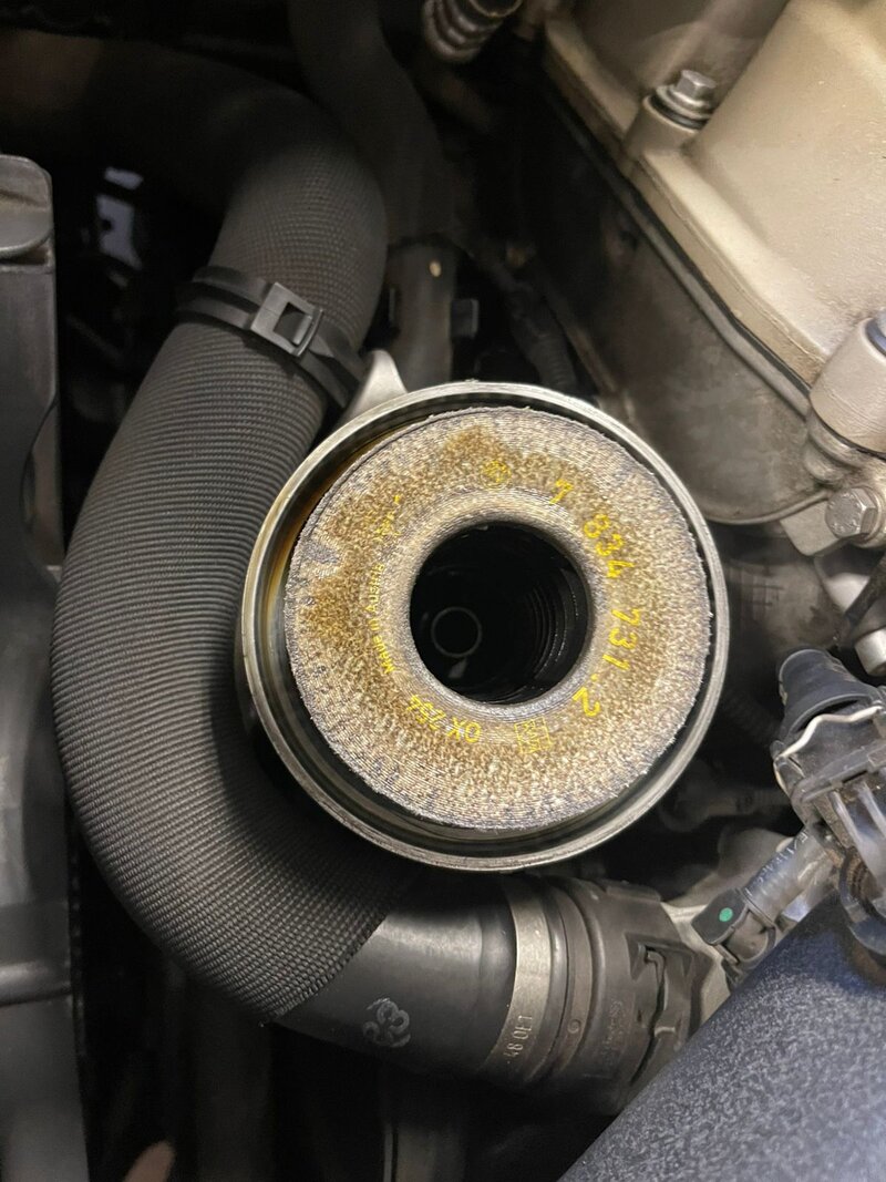

- Lowered the car and removed the old oil filter, checking it for any metal particles or glitter – none were found
- Extracted remaining oil from the oil filter housing, thoroughly cleaned the housing and cap

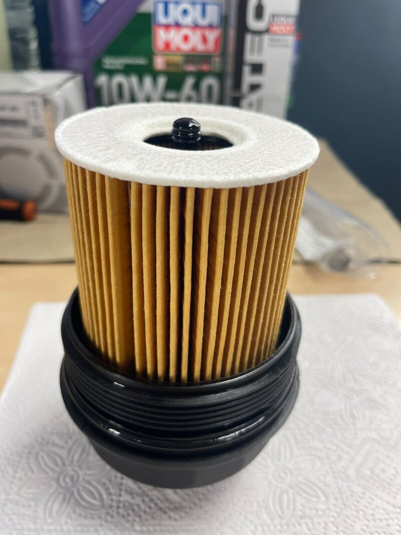

- Installed the new OEM filter, pre-filled the housing with fresh oil, and torqued the cap to 25Nm
🛢️ Fluids & Additives

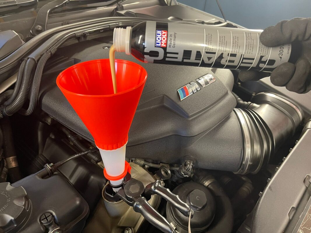

- Added Liqui Moly Ceratec for added wear protection

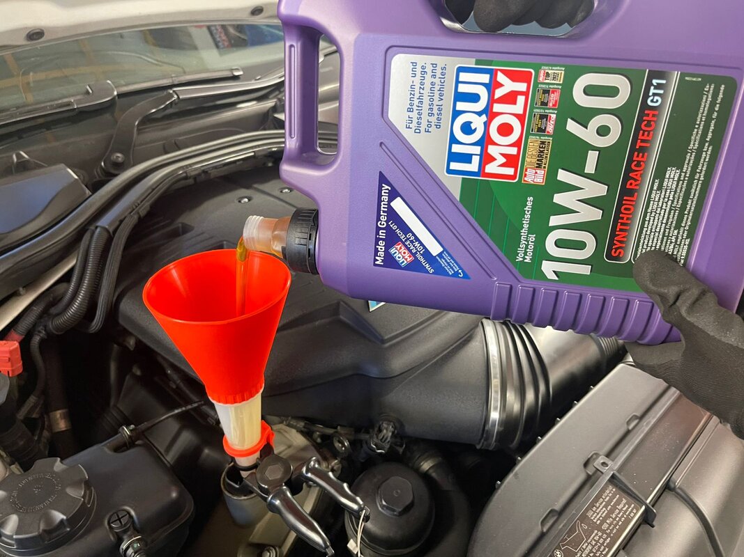

- Filled up with Liqui Moly GT1 10W60, one of the best oils available for the high-revving S65 V8

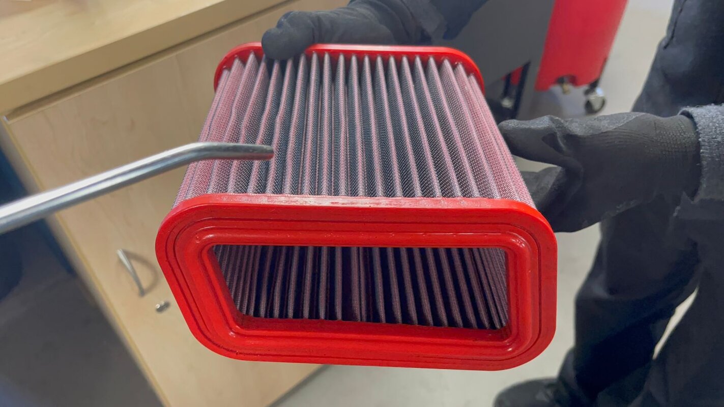

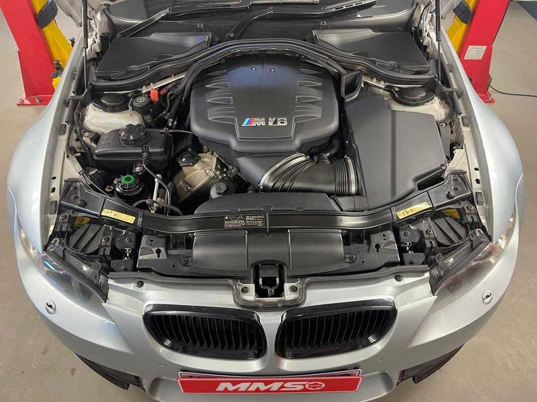

- Removed the BMC performance air filter, cleaned it with compressed air to remove debris
- Cleaned the airbox interior before reinstalling the filter and lid
- Gave the engine bay a light detail, wiping down plastics and trim with a rejuvenating plastic dressing for a clean, OEM+ finish

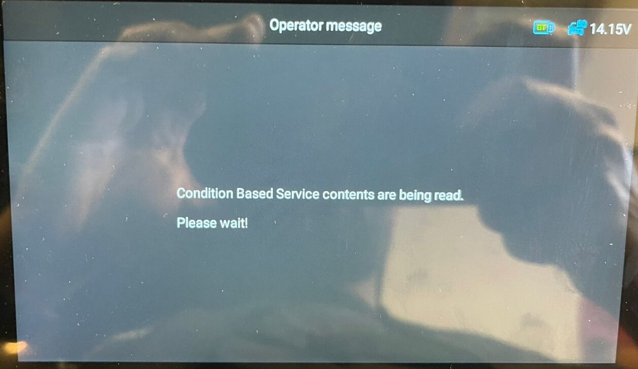

- Removed the car from the lift and connected our diagnostic tool
- Accessed the CBS system to reset the engine oil service interval
- Ran a full system scan and found stored fault codes
- Saved a full pre-service diagnostic report, cleared all codes, and verified that they cleared successfully (all historic faults)
