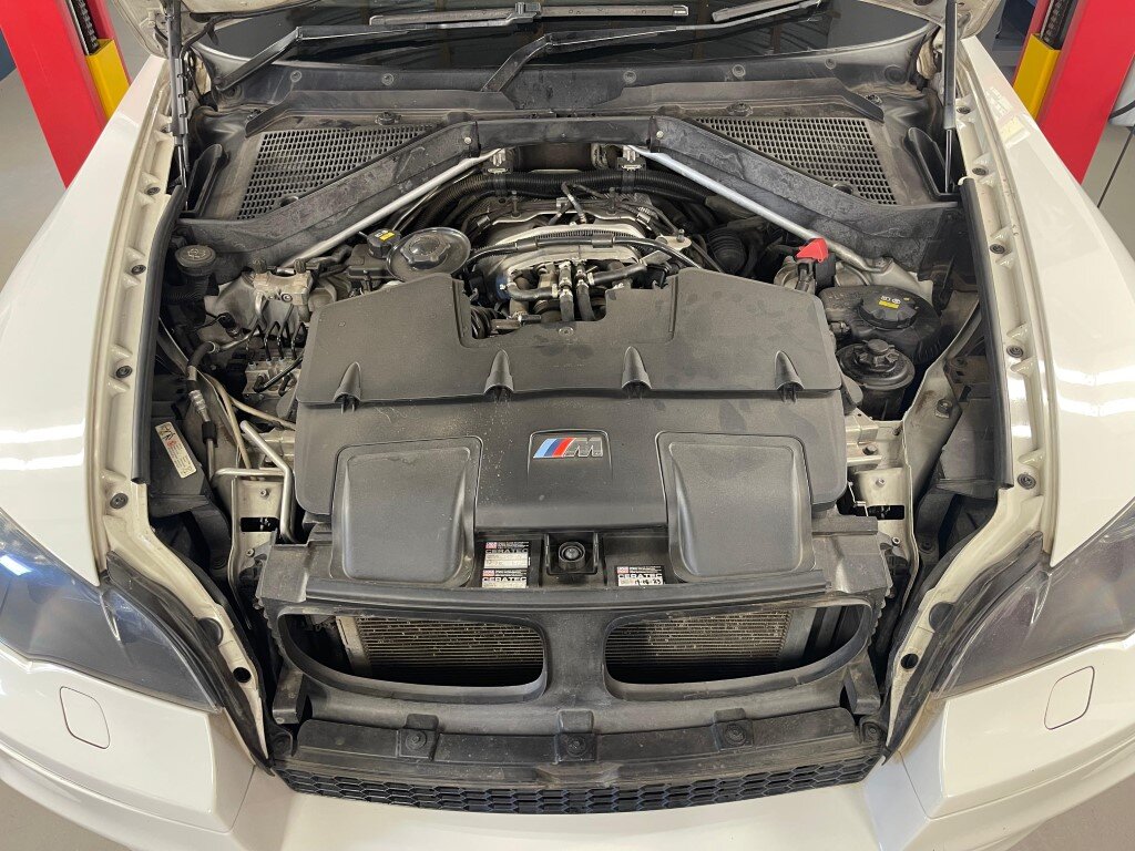

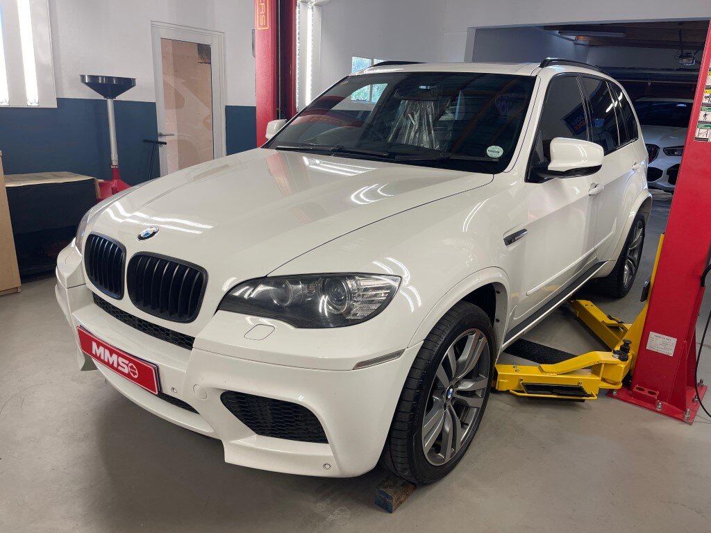

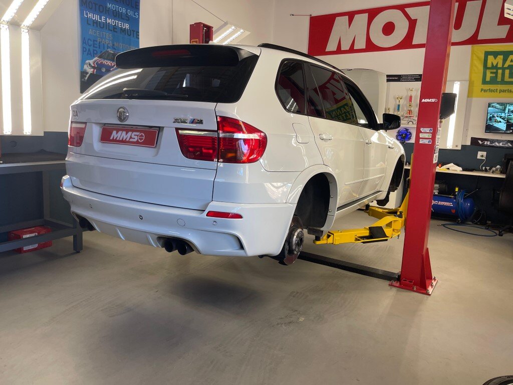

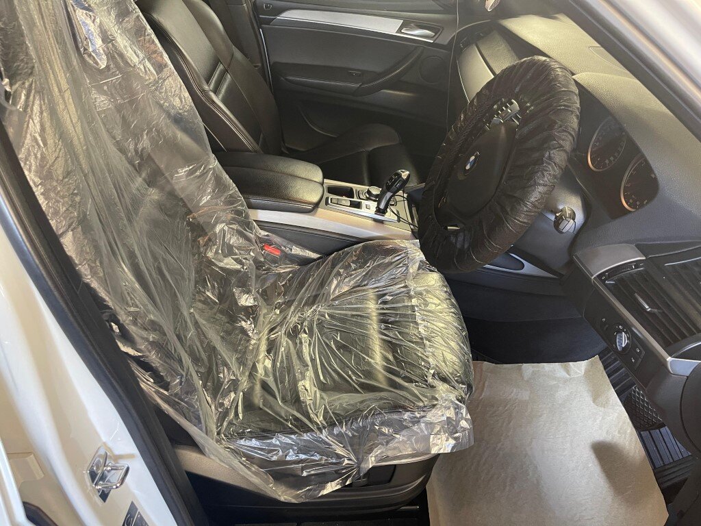

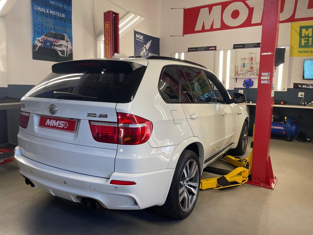

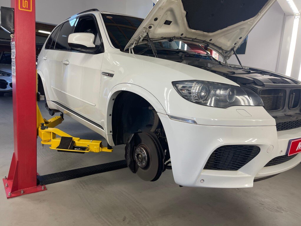

As always, we started by fitting protective covers to the driver’s seat, steering wheel, and footwell to keep everything clean. The X5M was then moved onto the lift, raised, and the wheels removed.

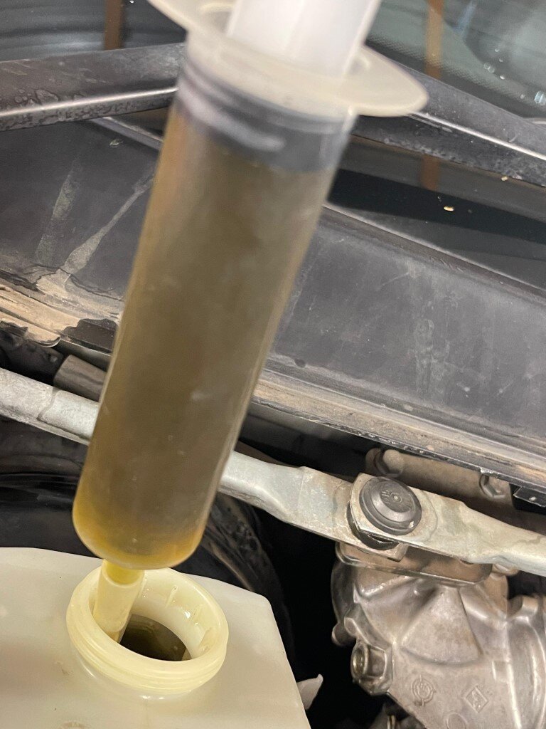

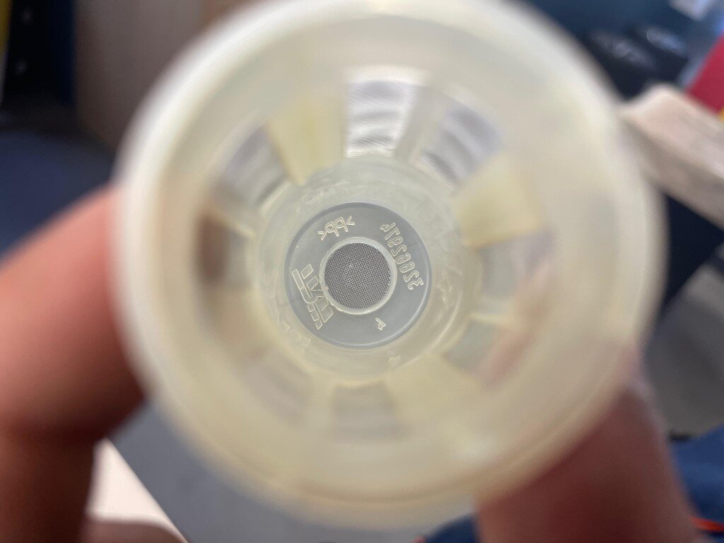

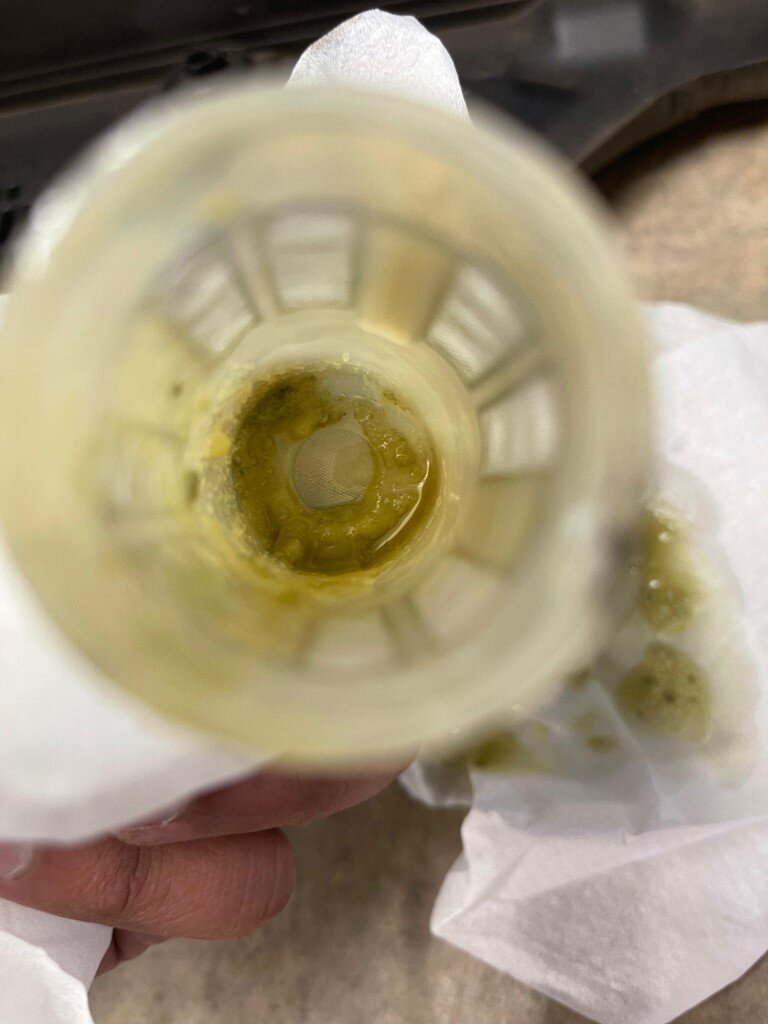

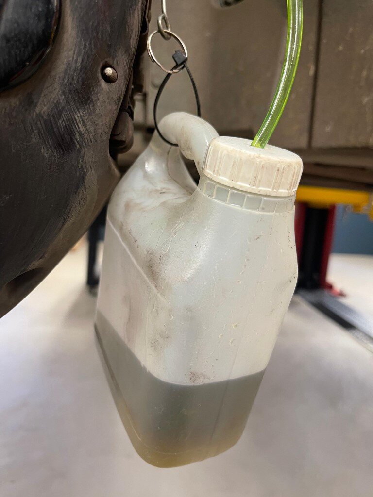

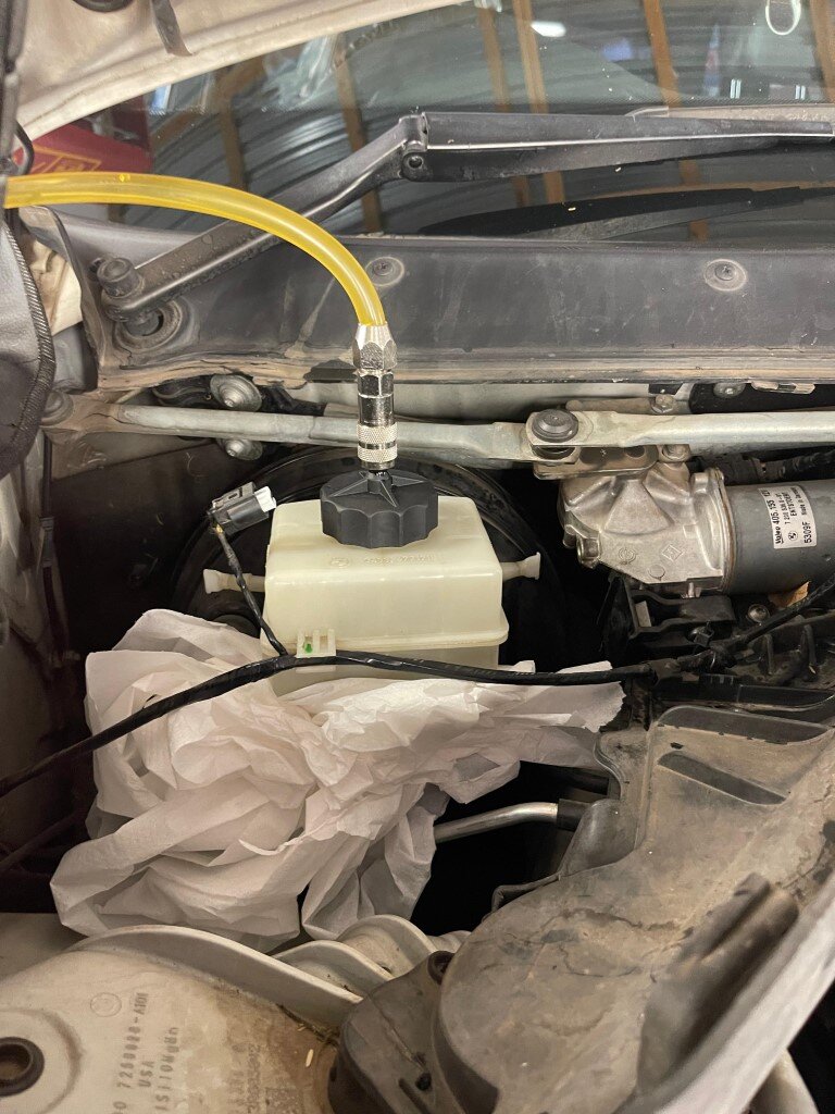

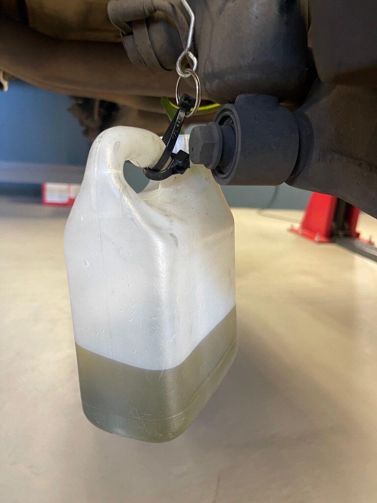

  • Opened the brake fluid reservoir and cleaned the plastic filter.

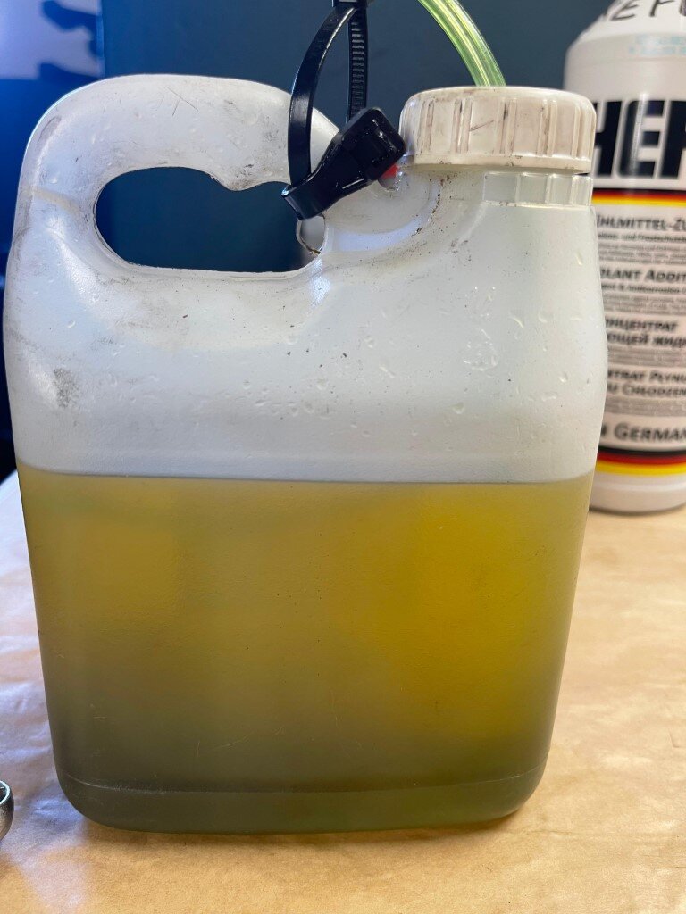

  • Removed some of the old, dirty fluid.

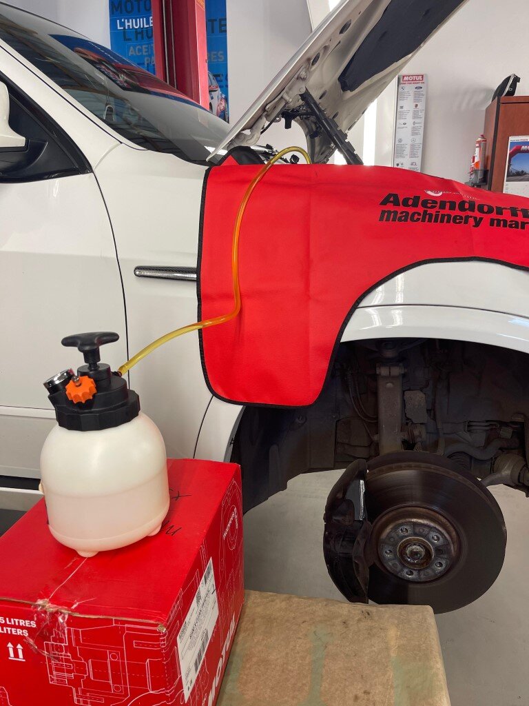

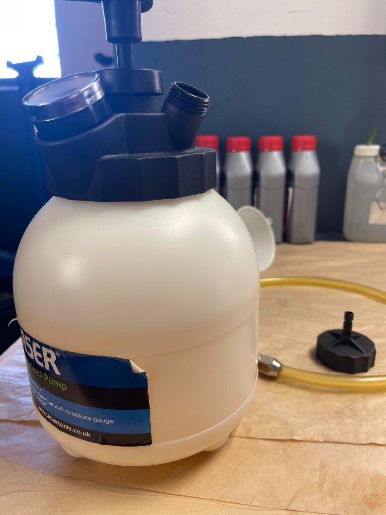

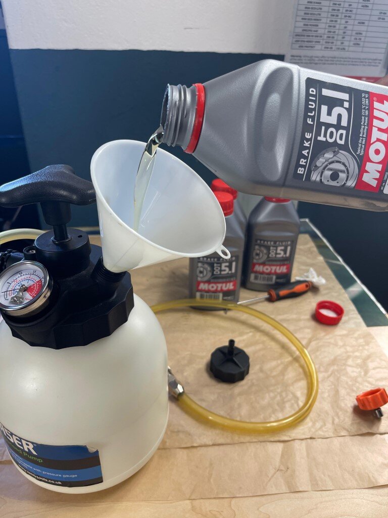

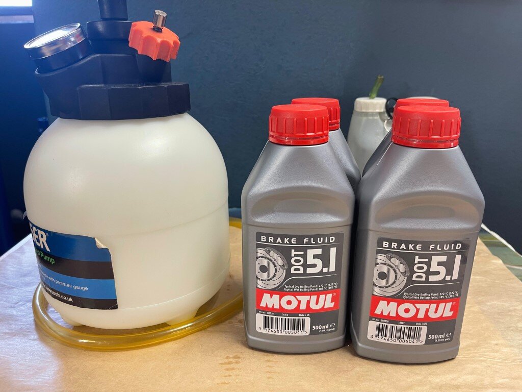

  • Filled the pressure bleeder with Motul DOT 5.1 brake fluid — chosen over regular DOT 4 for its higher boiling point and better performance at a samilar price 🔥.

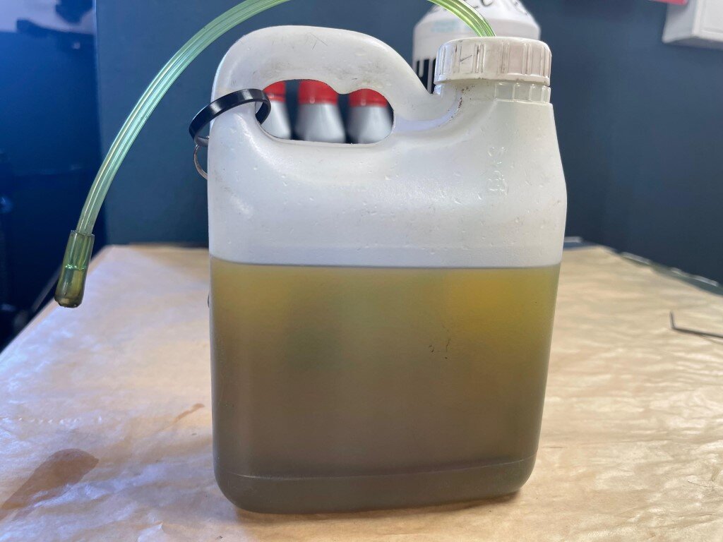

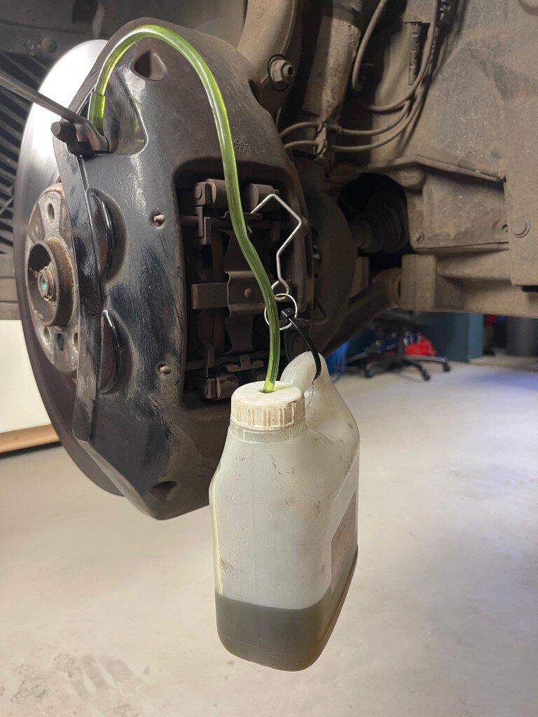

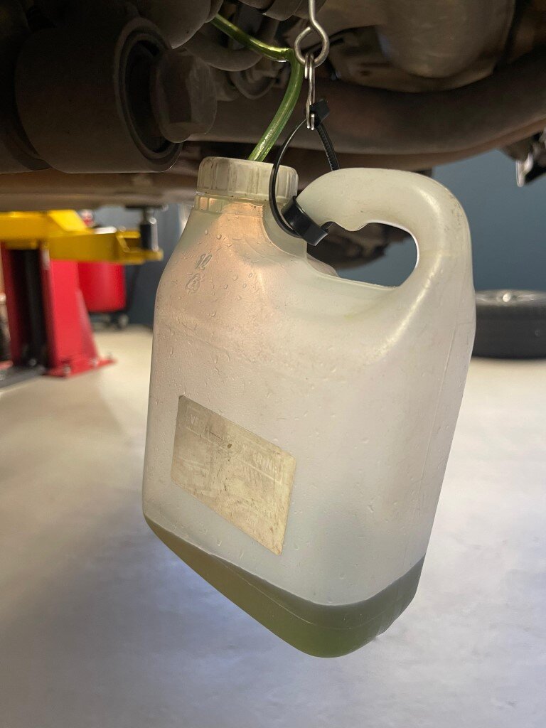

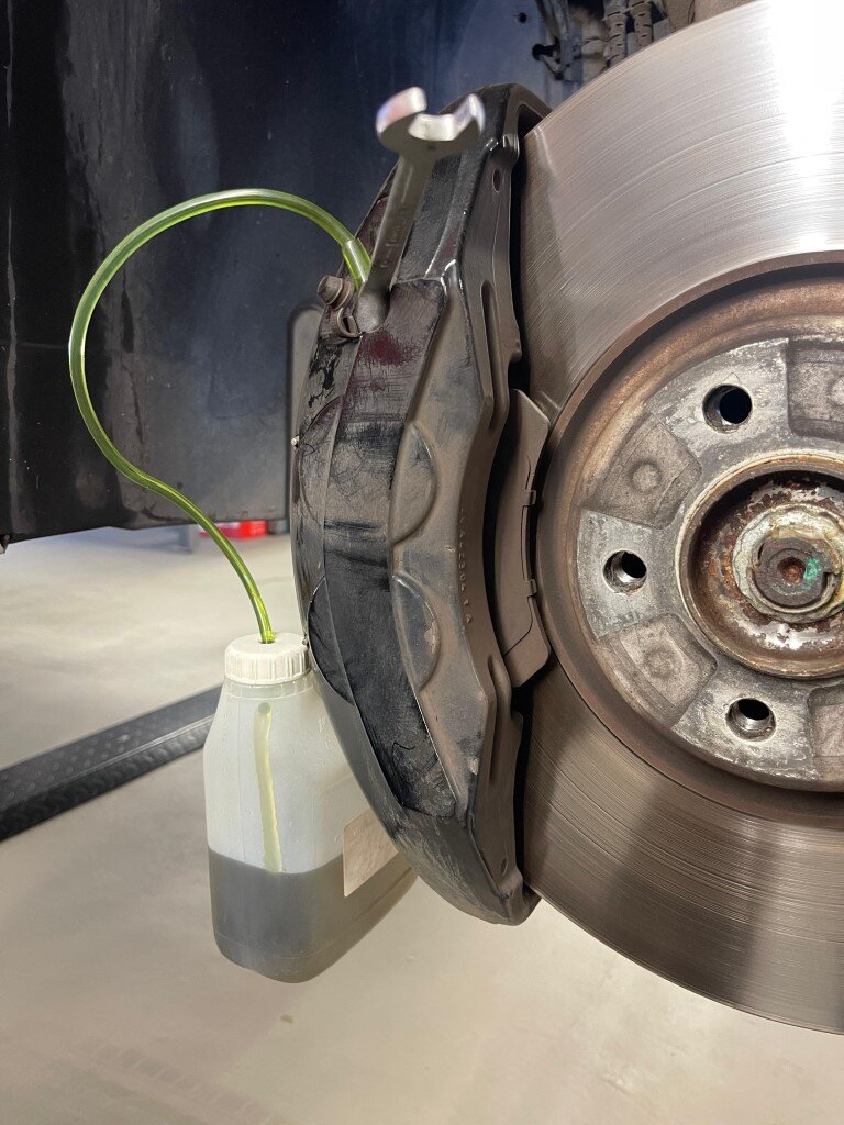

  • Bled all four corners until the old fluid and any trapped air were completely flushed out.

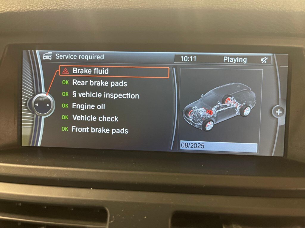

  • Ran diagnostics, cleared old stored codes, and reset the brake fluid service reminder.
