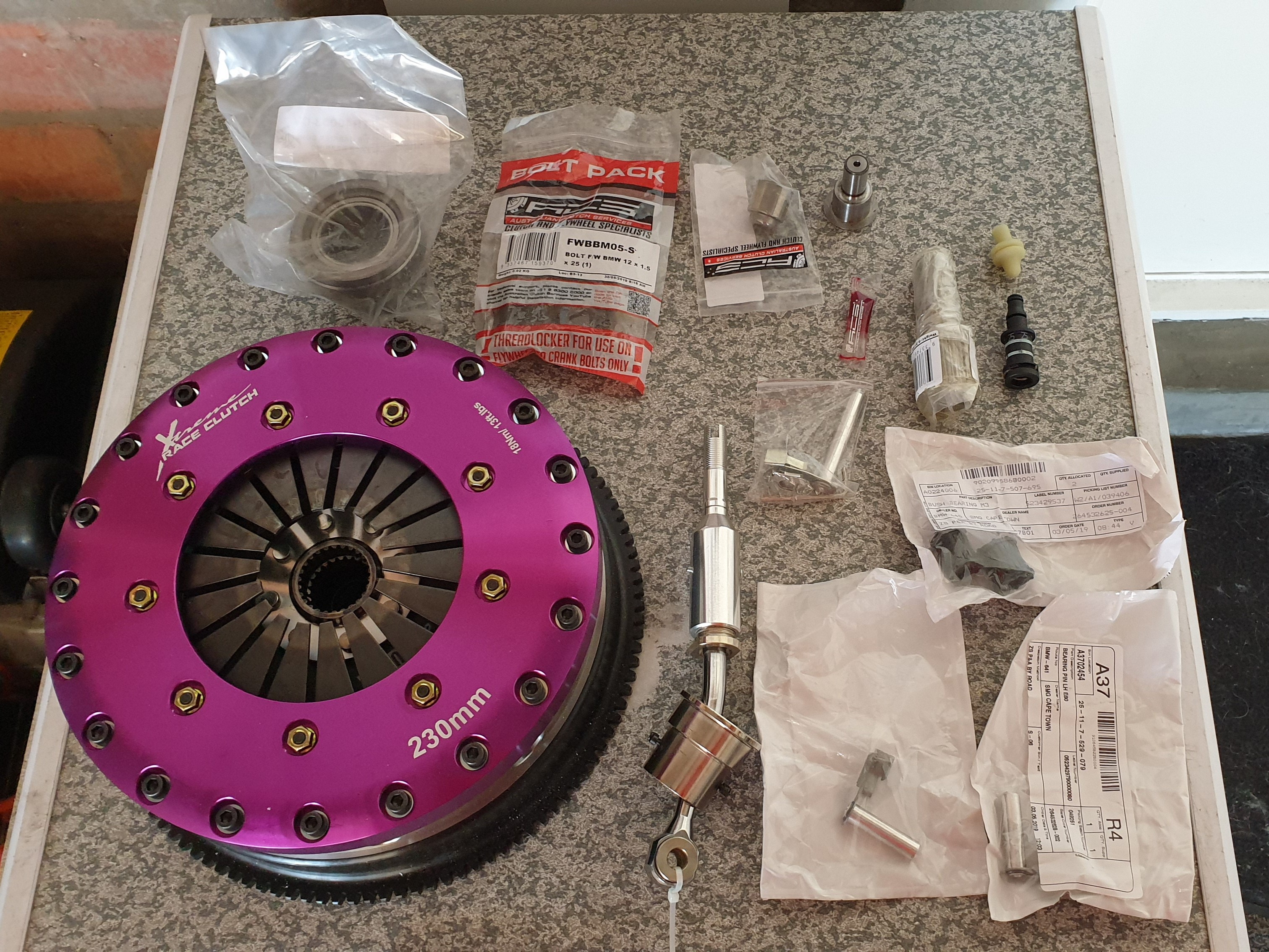

Within the first month the radio stopped working, water pump went south and crank seal + clutch had to be replaced, I fitted an Extreme Race Clutch (karter Performance imported for me) at the same time I did a Short Shifter kit from BMS

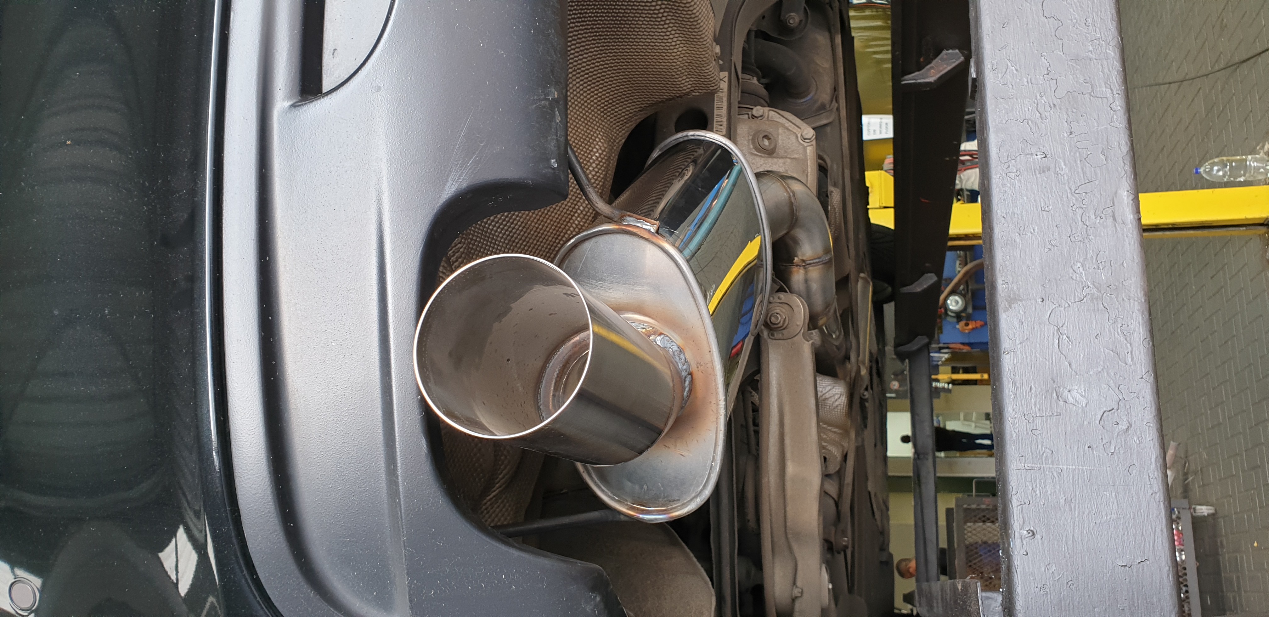

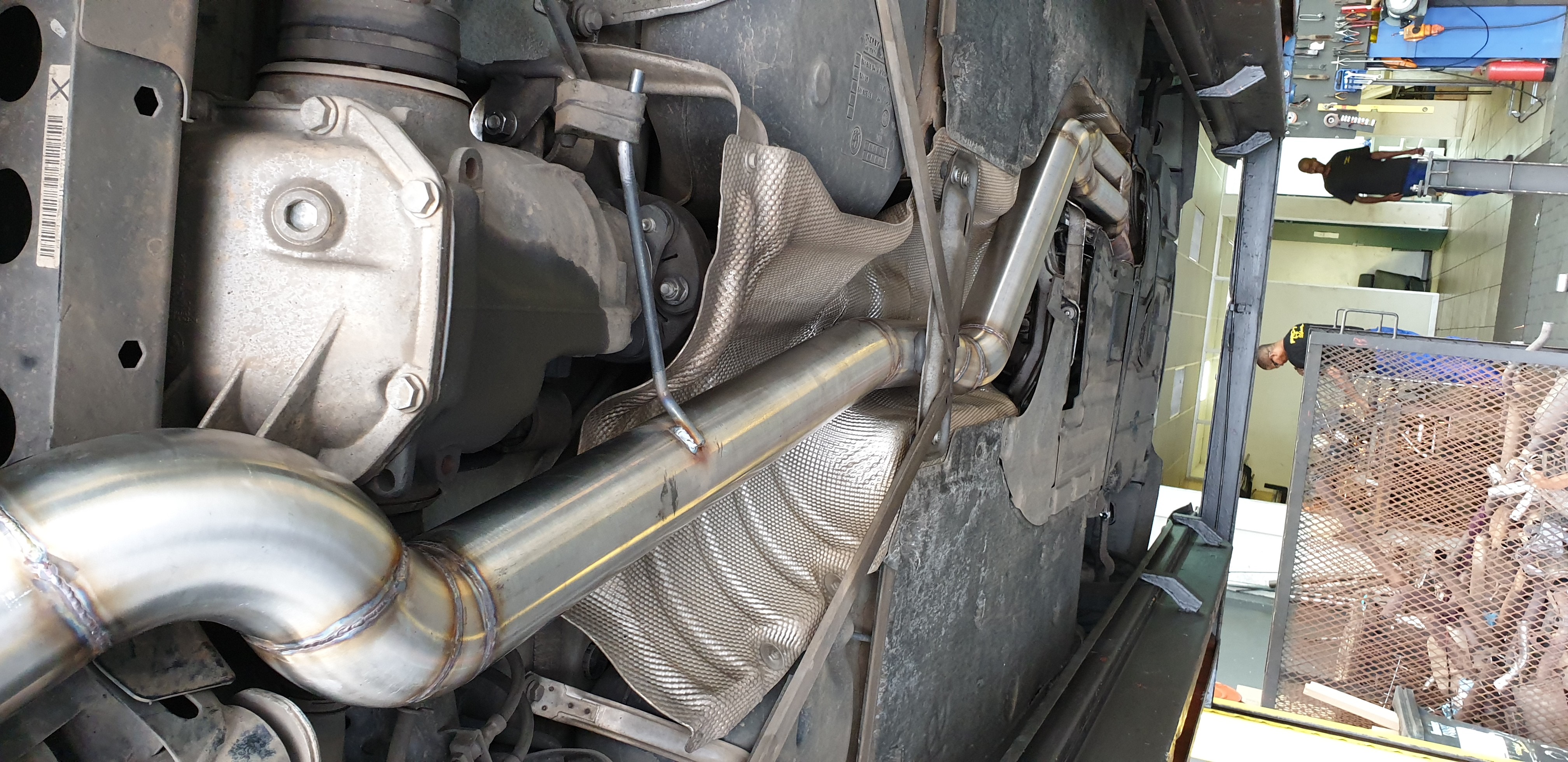

The next thing I did was to have a 3.5’’ single pipe made up, I was following and basing the car on Jake Spence (60 ROLL) this would prove to unhide some more problems with the car (Will explain later)

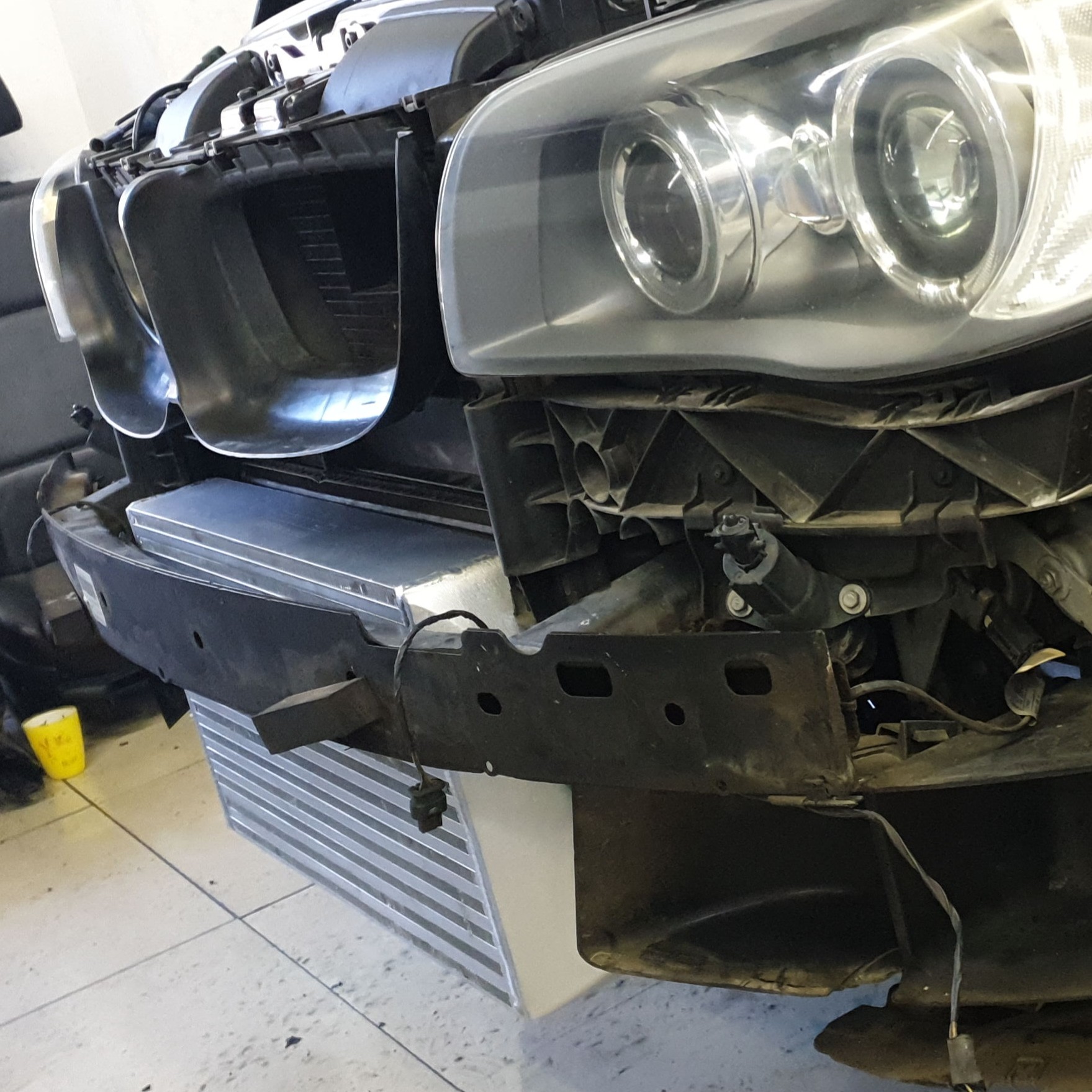

7.5" Race Intercooler

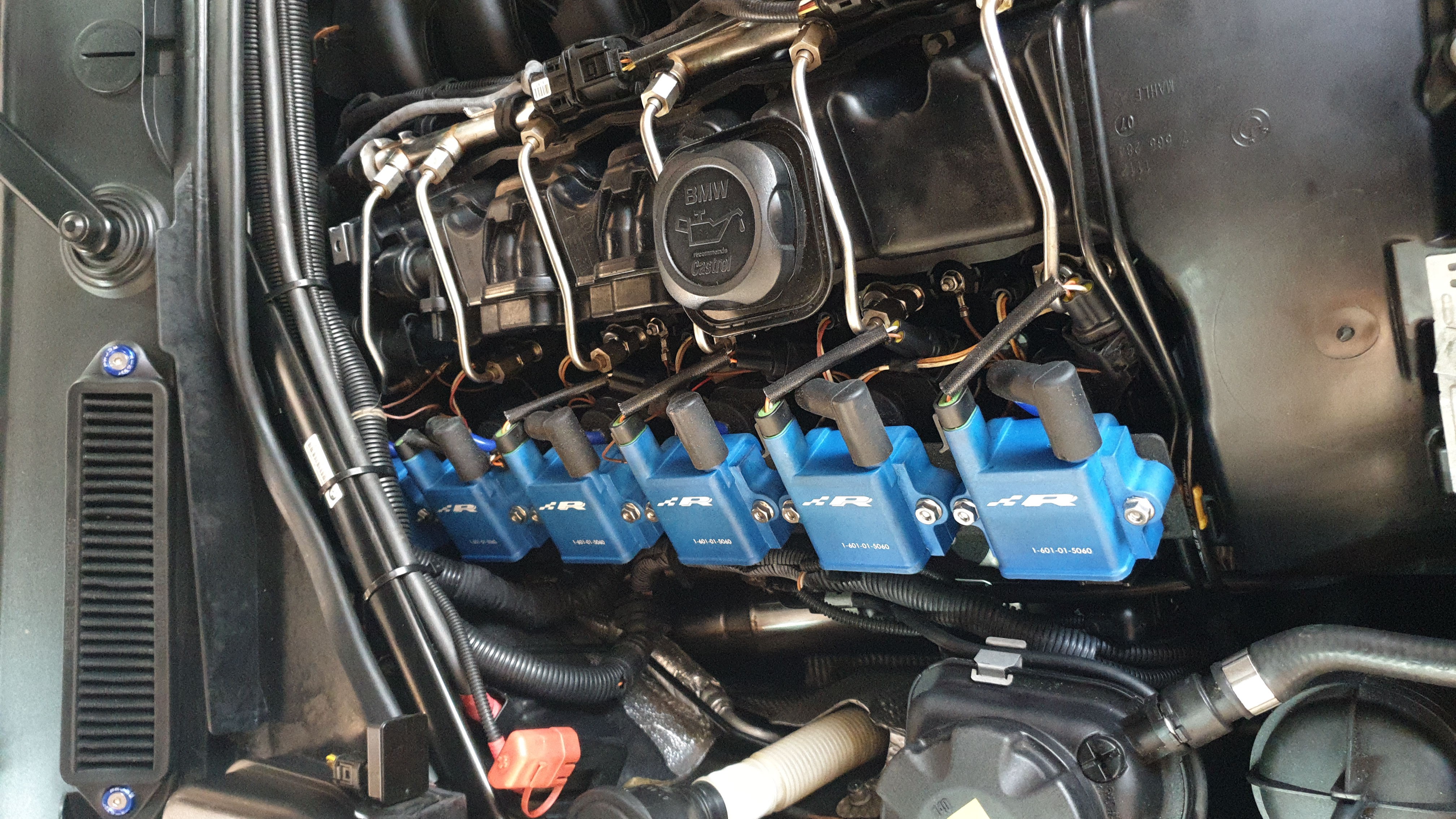

Precision Race works Coils

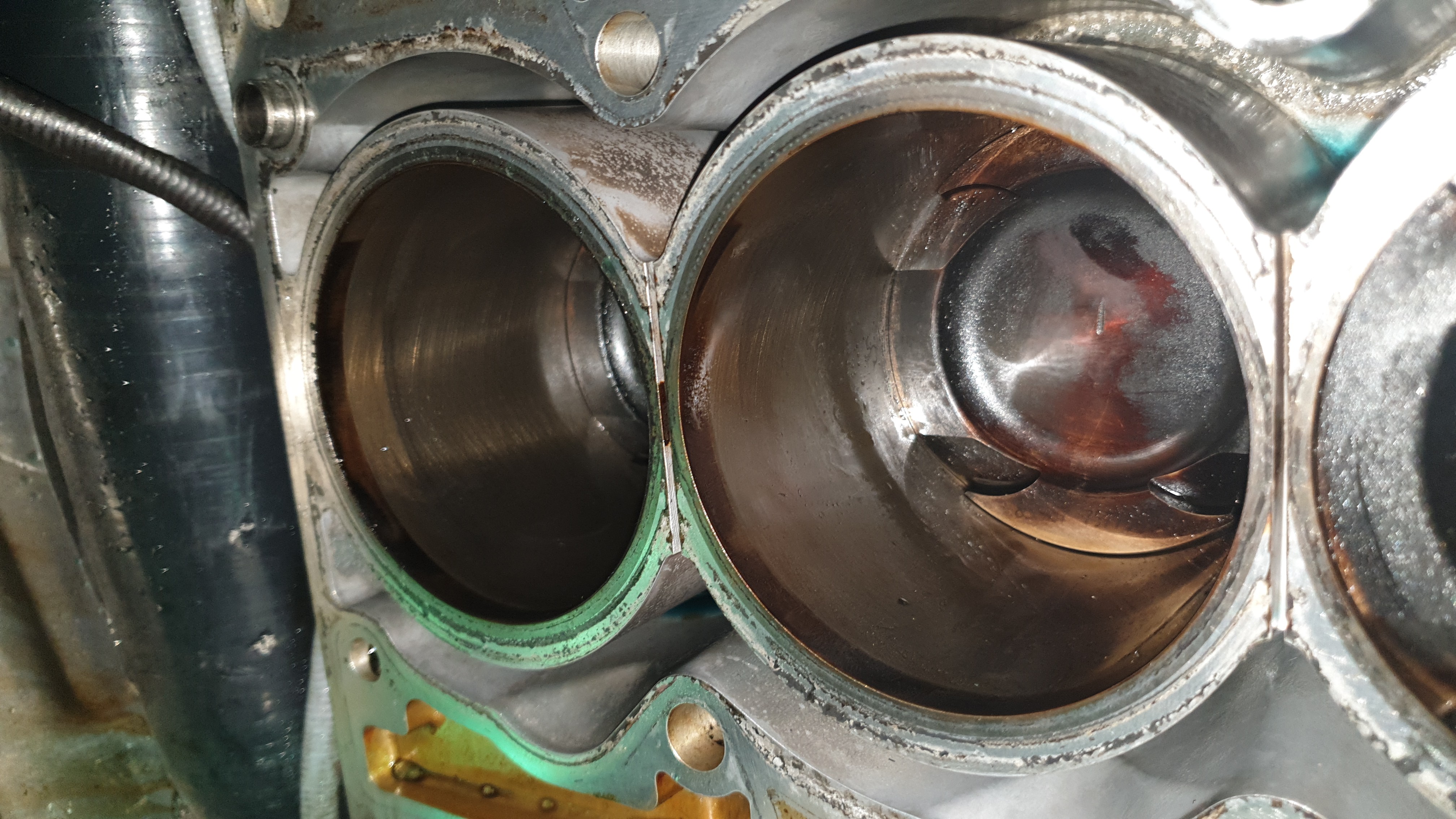

when I fitted the 3.5'' exhaust and removed all the cats the car started smoking, sorry that is when I realized the car smokes, I have read 100's of posts, I have tried every thing and the car still smokes, 2 catch cans (Low and Hi side) blocked ports.
the other major concern was timing drops in cylinder 5, the tuner could not get the car to run at its best because of this, on pump gas (E20 mix) we could only get 440kw and we could not get the car to run correctly at all with E85.
I assume this was caused by too much oil going into the cylinders (Cylinder 5 is the weakest link when you have PCV problems)
new valve cover upgrade PCV Valve trust me I have done everything possible with no joy,

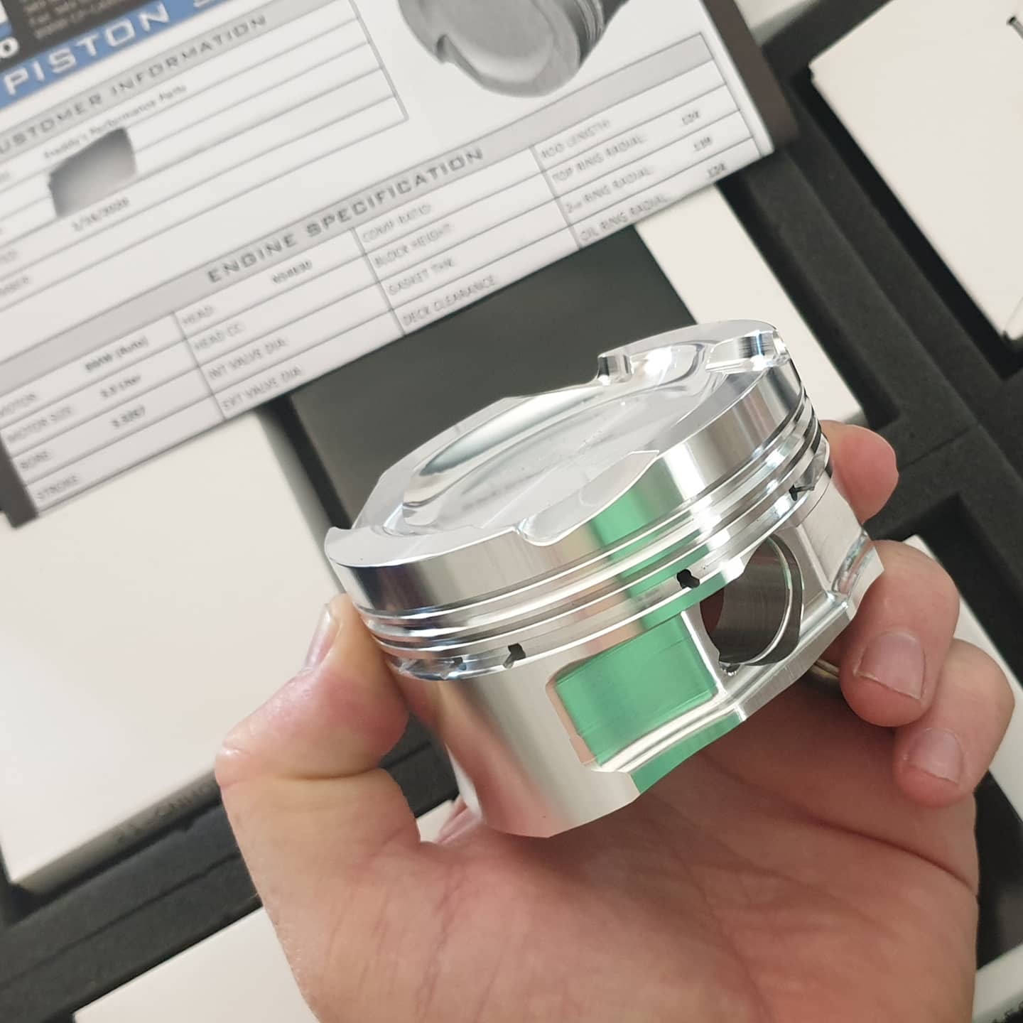

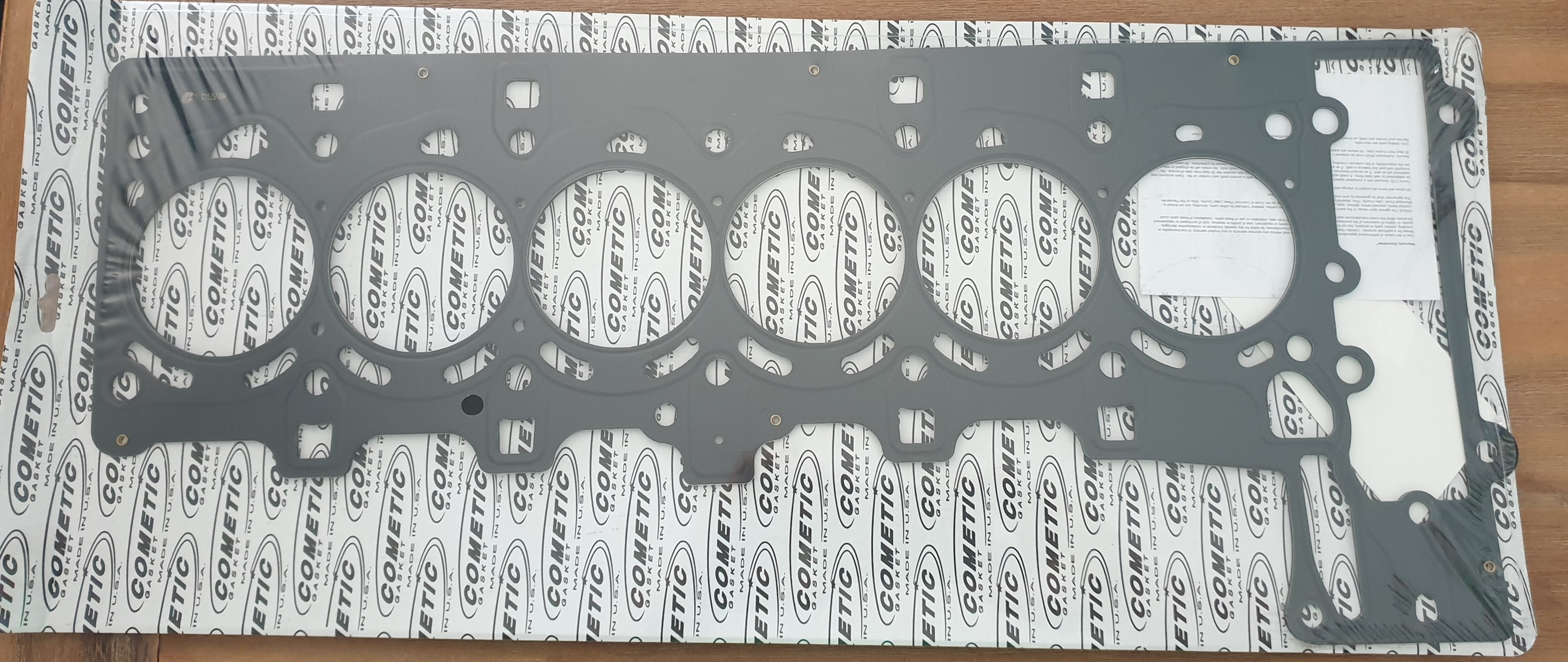

The last resort was to pull the head,

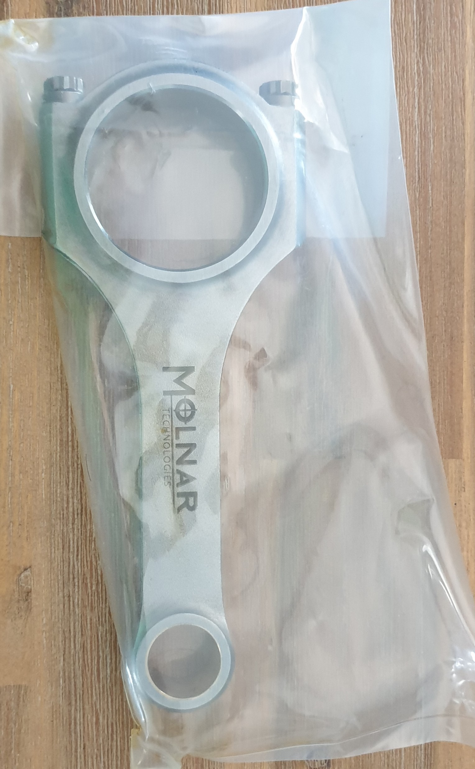

I have purchased new Pistons and Rods, the head has gone in to be ported and reconditioned but due to COVID 19 it is all on hold.

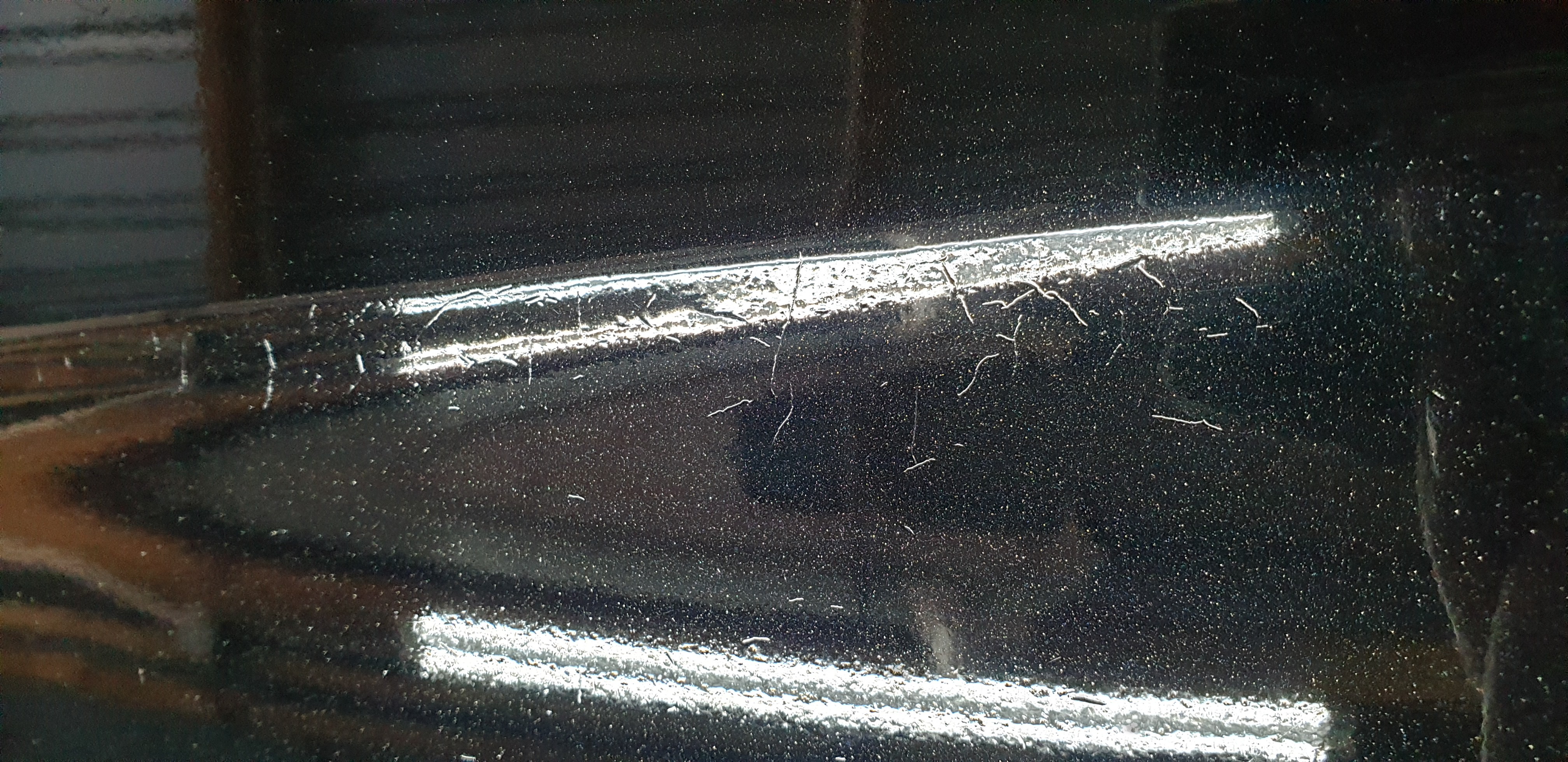

Cosmetically I have done a lot but still need to complete a few more things, the paint was in a terrible condition.
this was the Bonnet after a polish, I had it resprayed.

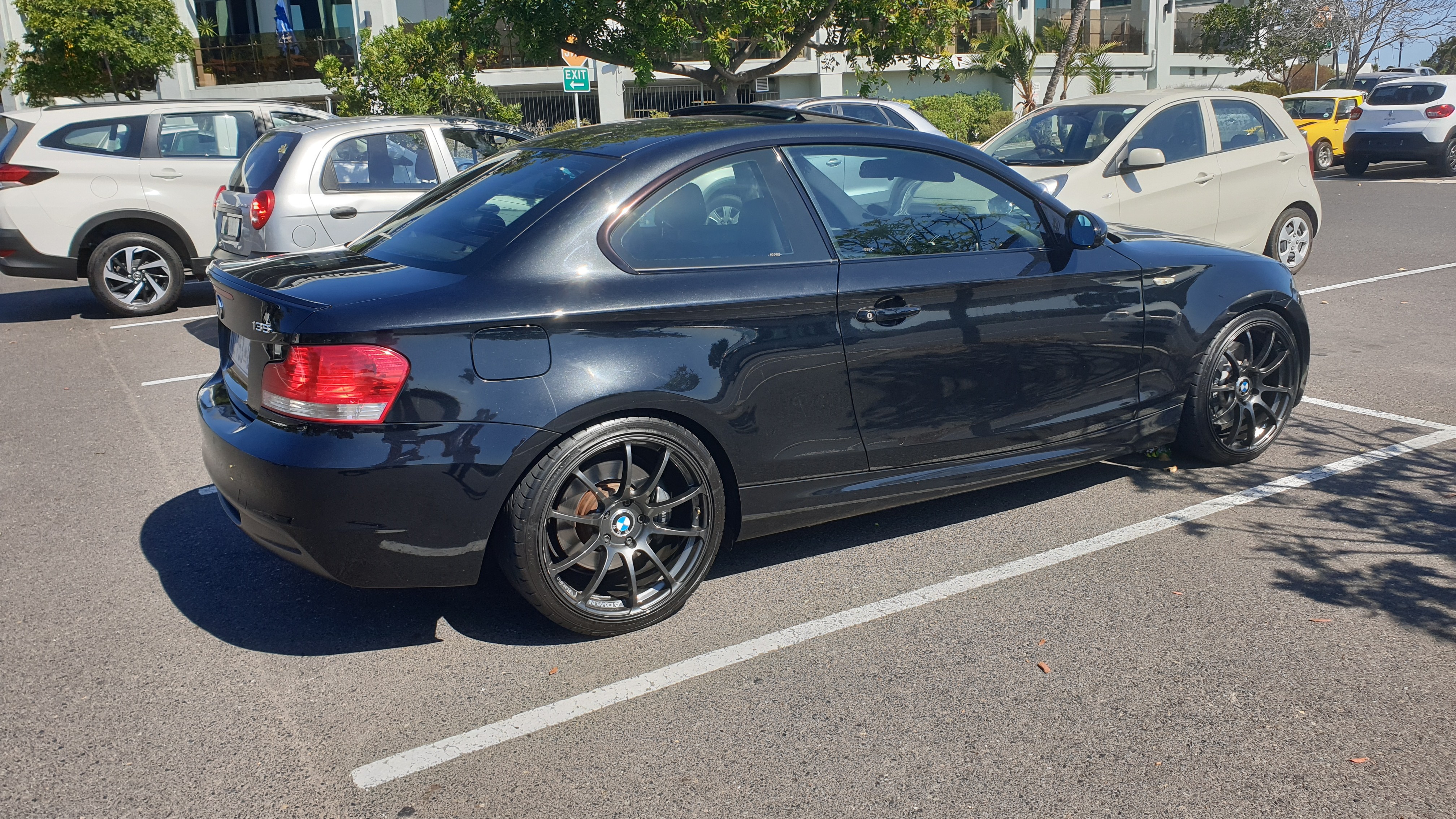

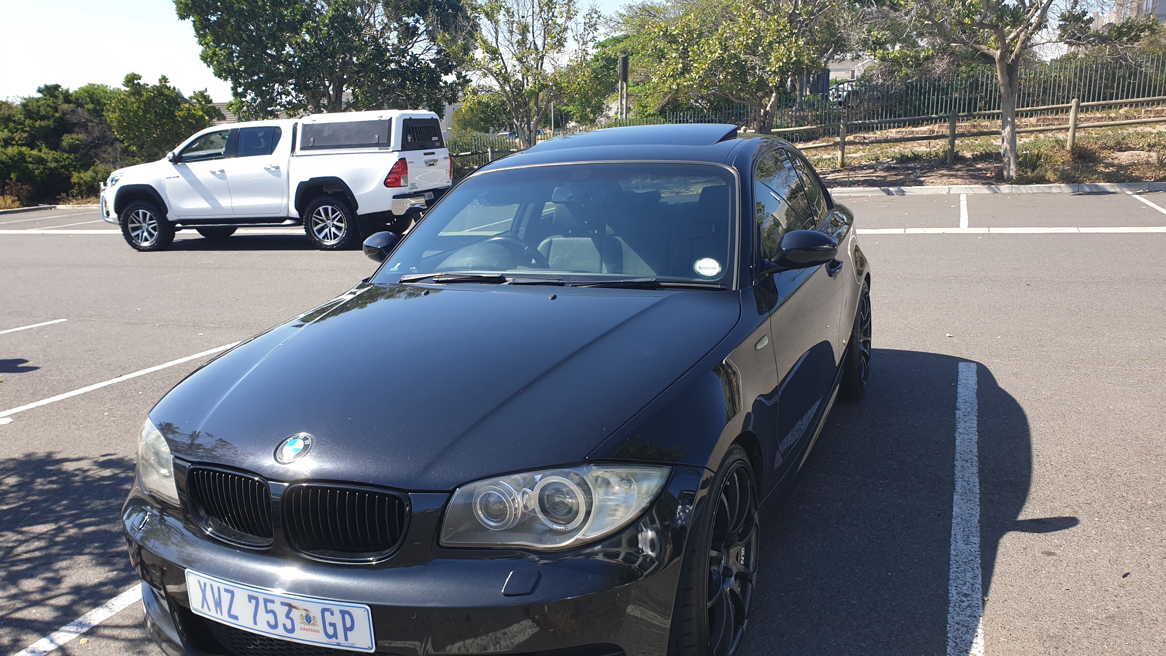

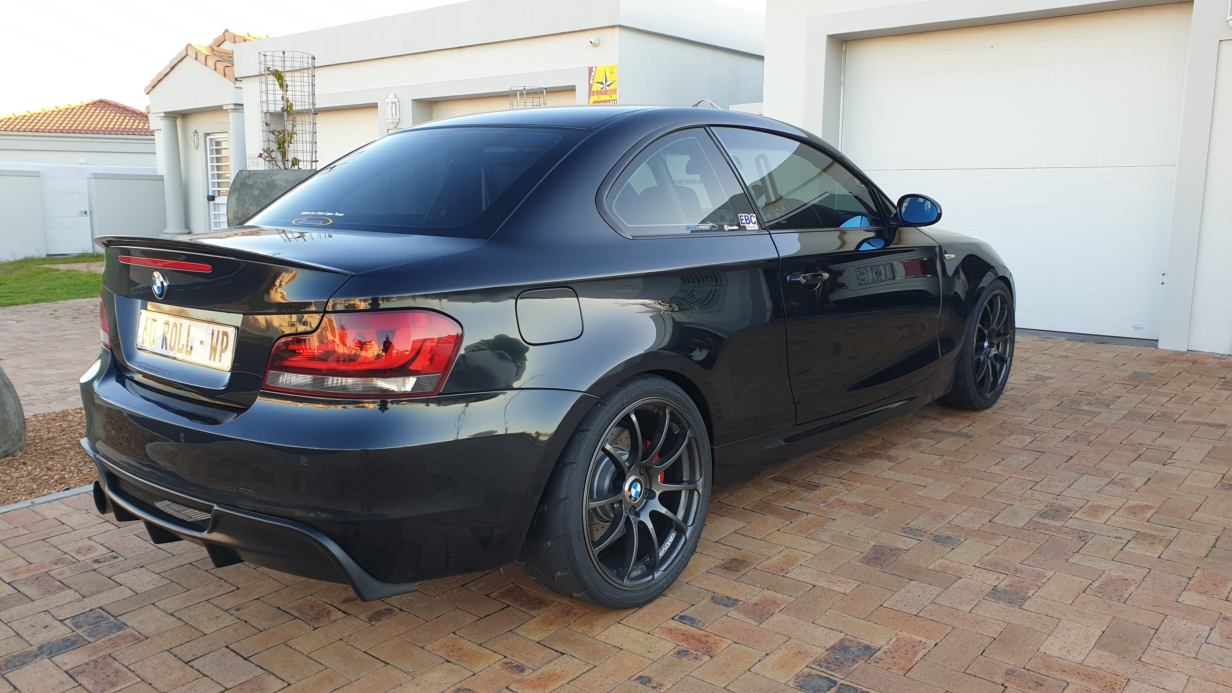

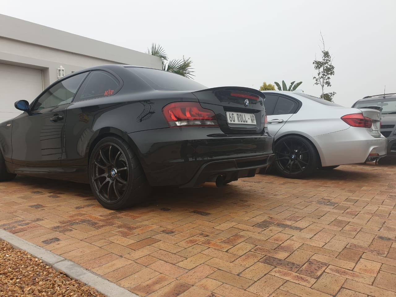

The Car now and some more parts fitted:
http://www.bmwfanatics.co.za/uploads/user/9606/20191201_101903_597239
[img]http://www.bmwfanatics.co.za/uploads/user/9606/img-20191125-wa0002_2313682877.jpg

Sorry it has been such a money pit, but hopefully it will reward you once its running properly.
What was wrong with the head in the end? I don't see anything obvious.

I think the valve stems are stuffed, I sent the head up to JHB and I went over to the USA on business, I didn't followup when I got back everything was crazy with the CONVID 19 crap.
if you look at cylinder 5 valves you can see a slight difference in the intake valve color,
I don't have a pic but the inside of the inlet port was also wetter with oil than the rest.

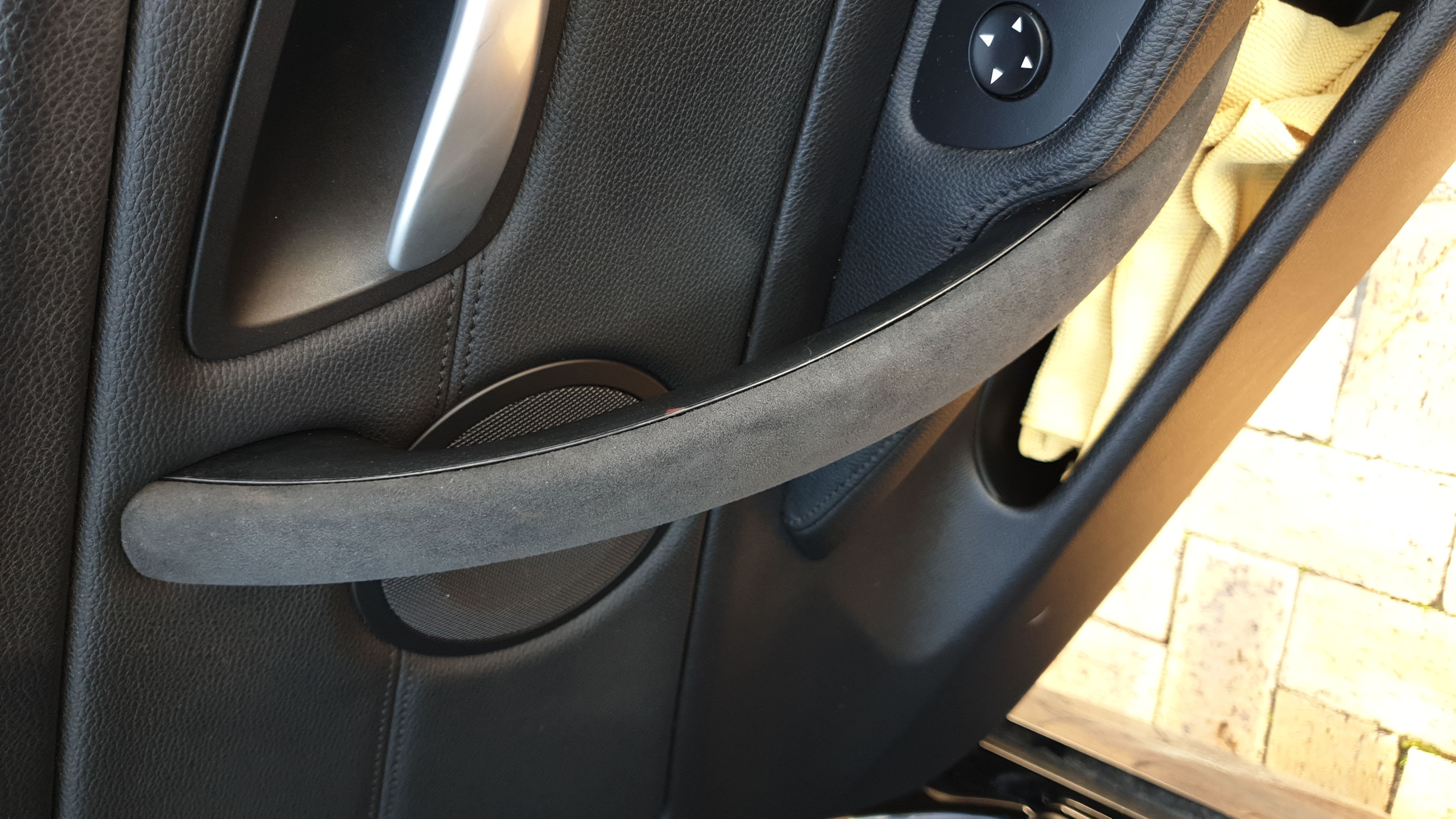

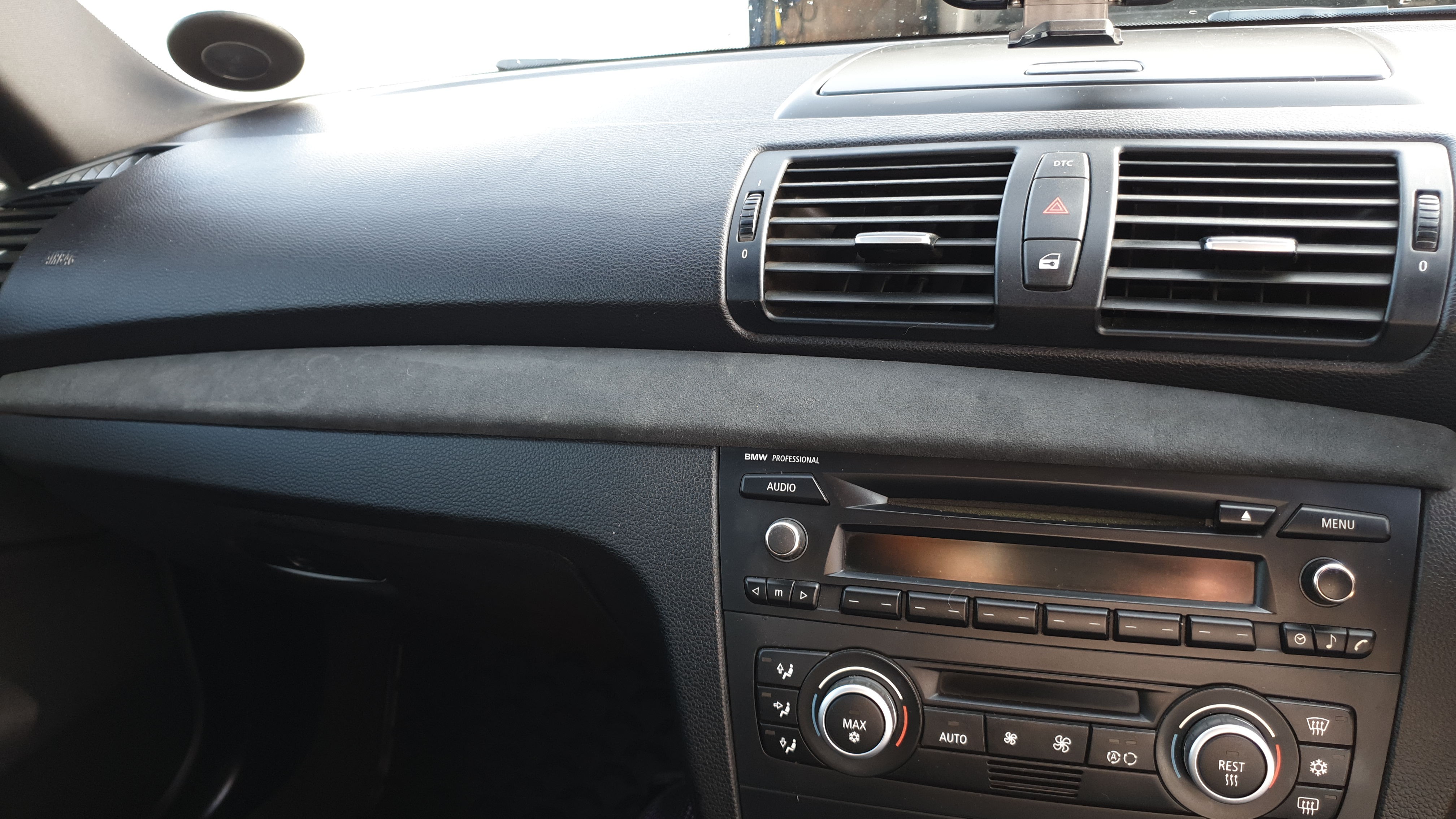

I did some alcantara

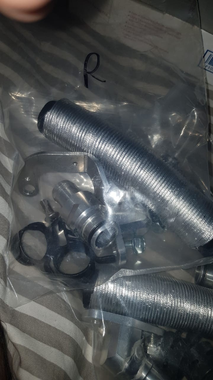

RB Oil drains

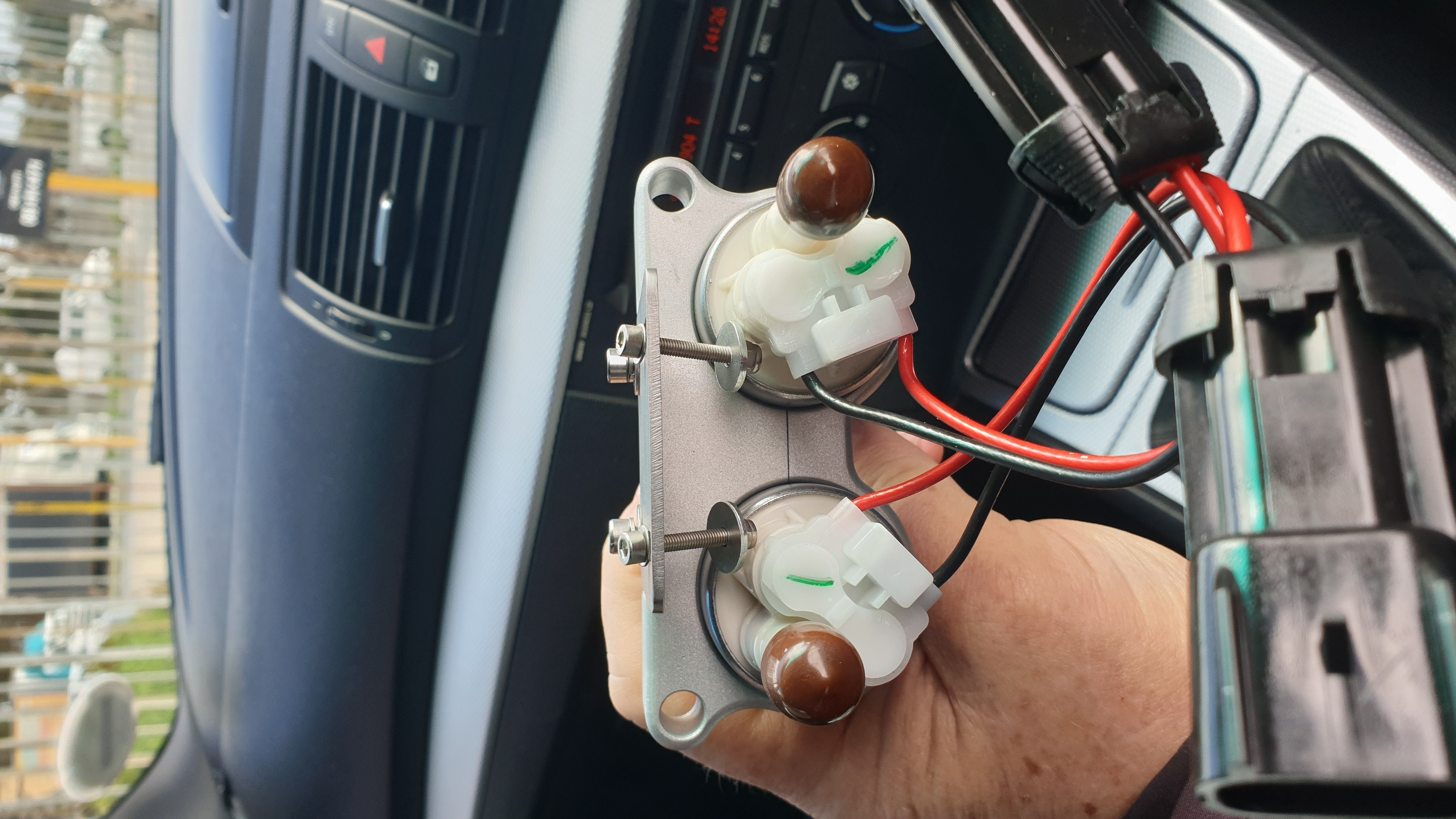

I had a dual fuel pump bracket made and then another bracket that the bucket fits into, turned out really good. (Don't have a pic) so the car has three pumps stock in bucket and 2 x 450's

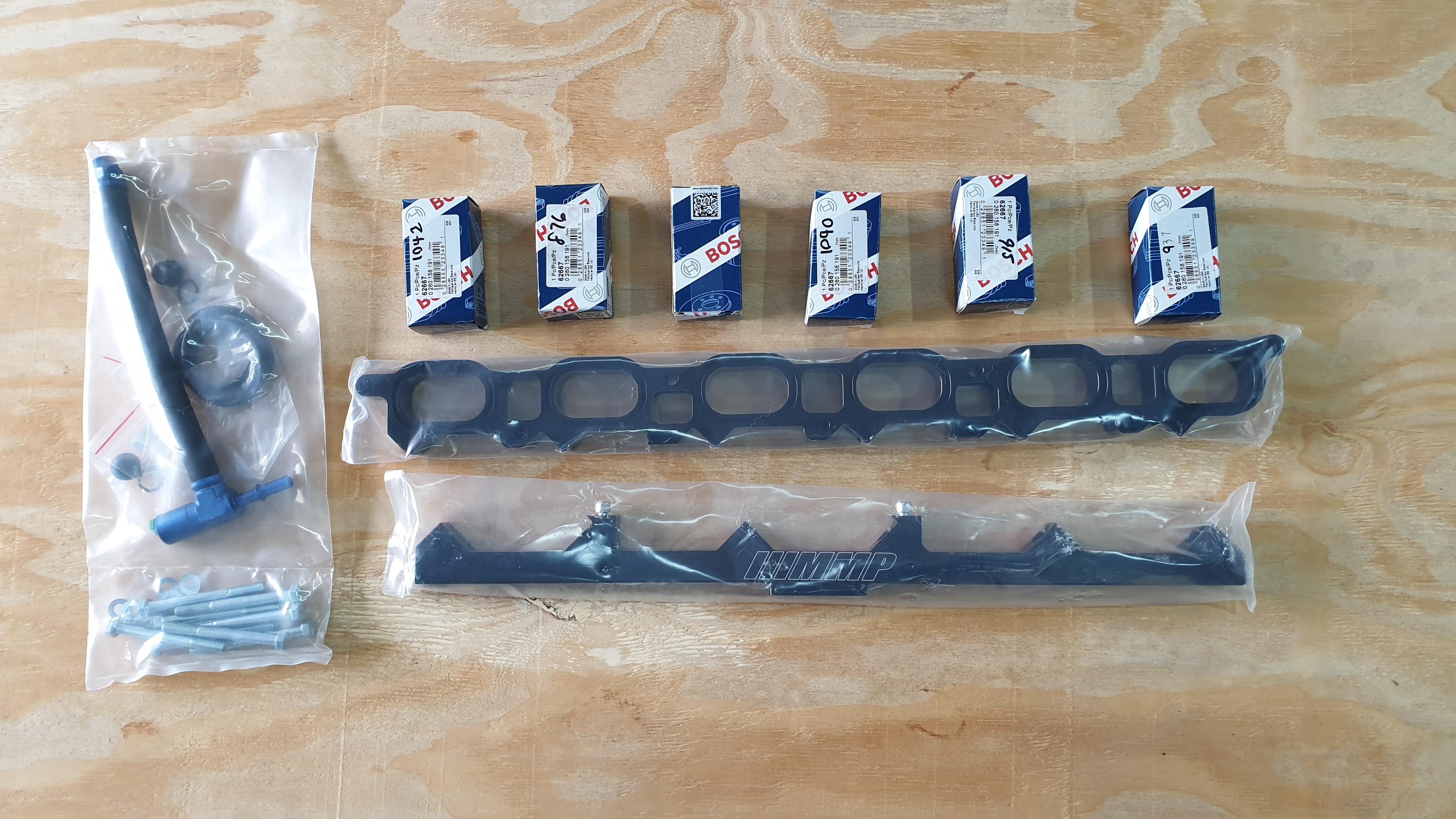

MMP PI

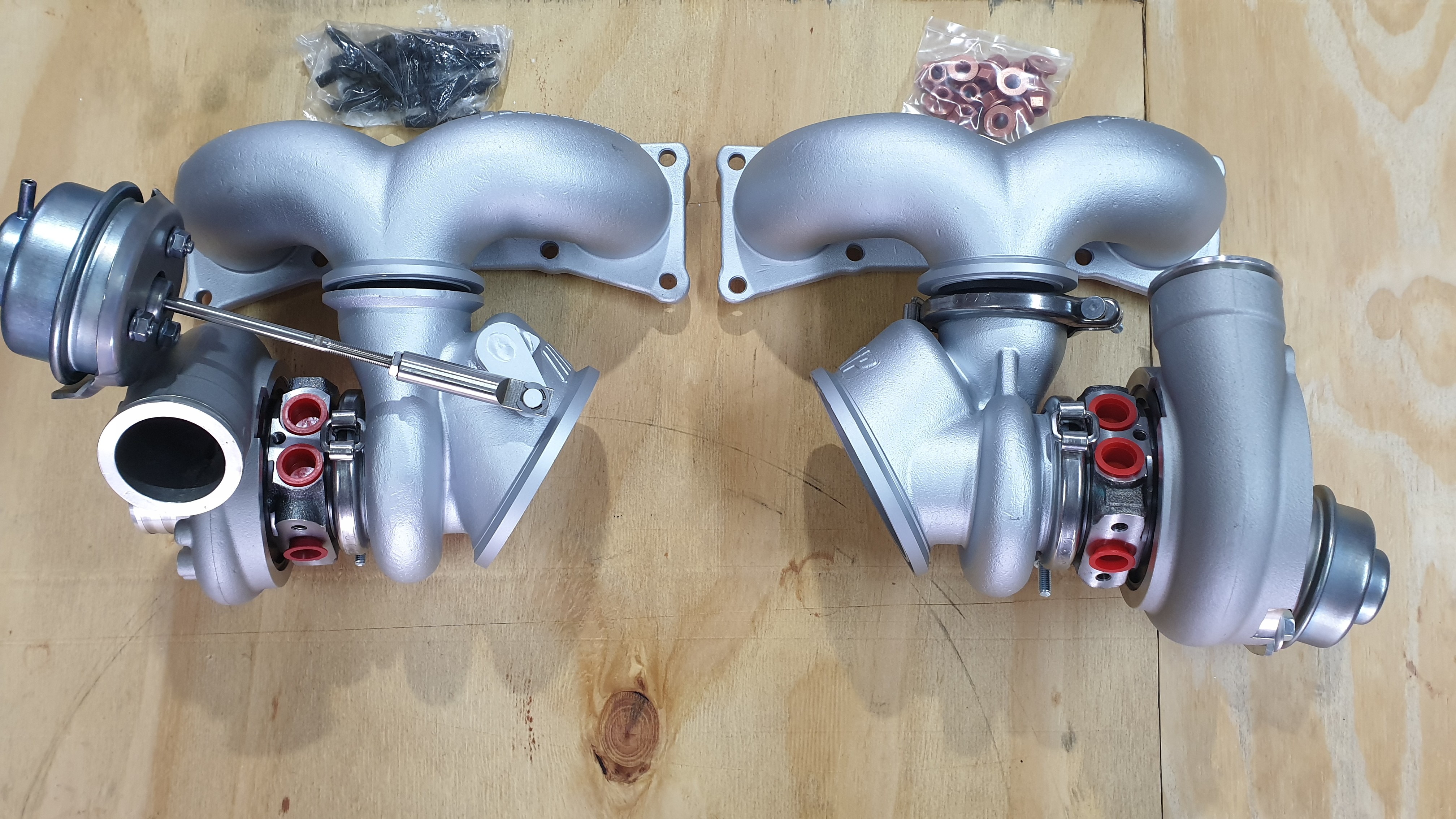

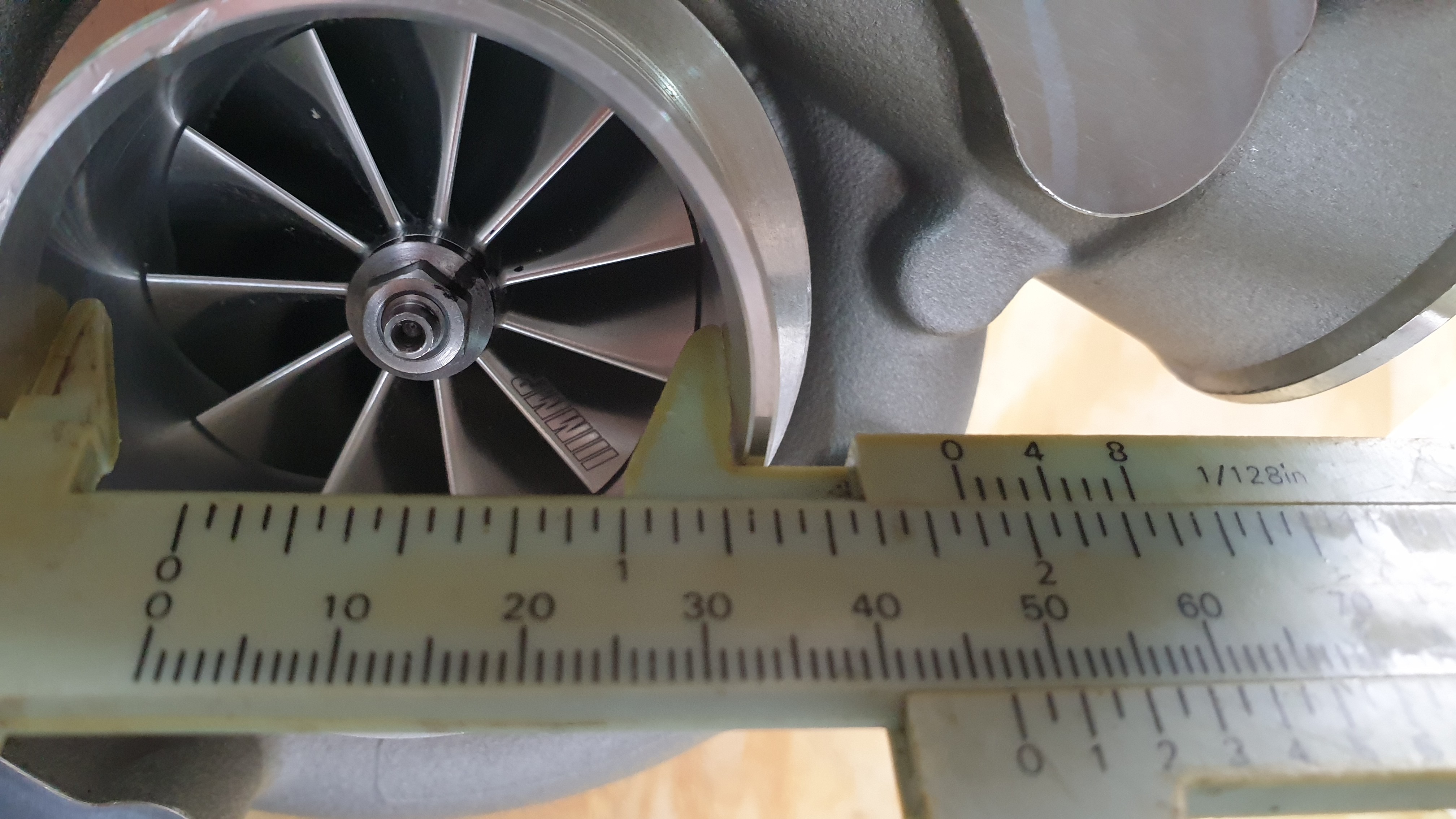

MMP K1's 46mm wheels

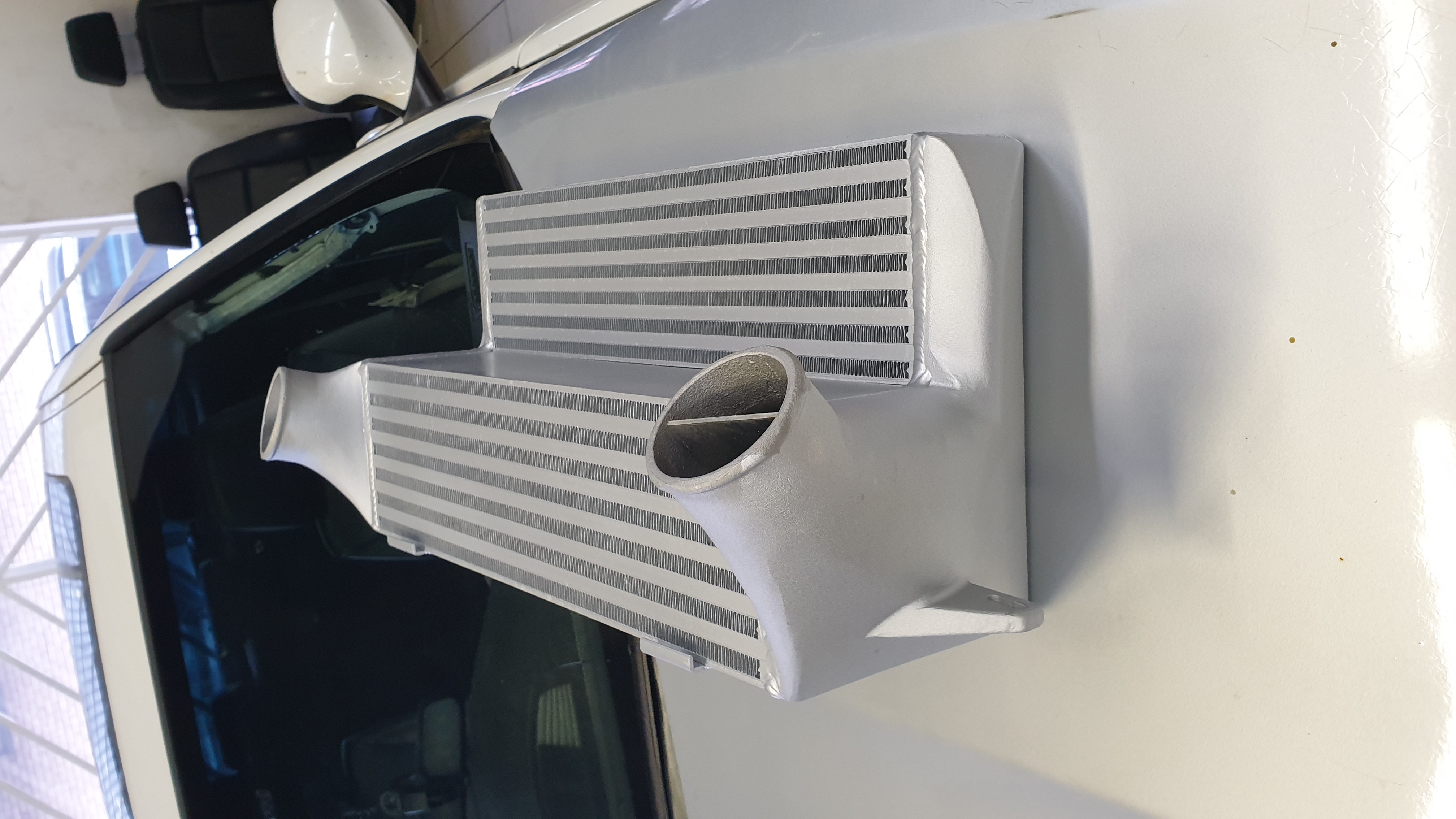

the intercooler is massive.

Good work done there Dax. Yeah the MMPs are not a straight fit at all, and the turbos are huge. The outlet sold with the kit is for lhd, so a custom solution had to be done.

the biggest problem was the clocking of the turbo housing, it pointed straight into the engine mount, we had to take pins out re clock and then the waste gate actuator would not fit, all that said we got it to work Chris at KB Turbo's is great at stuff like this no job too big or too small and really does things proper.

Ah ok nothing too serious then! Happy to hear that.
