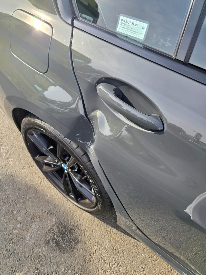

A truck bumped my dad yesterday and luckily it was mostly minor damage, it's a 2020 M340i in Dravit Grey which my dad has taken exceptional care off
I'm looking for the absolute best repair shop who can get the car back to OEM (I'm talking panel gaps, paint, paint thickness, everything basically)
Attached below is the damage, luckily it's just cosmetic so my dad was able to drive it home

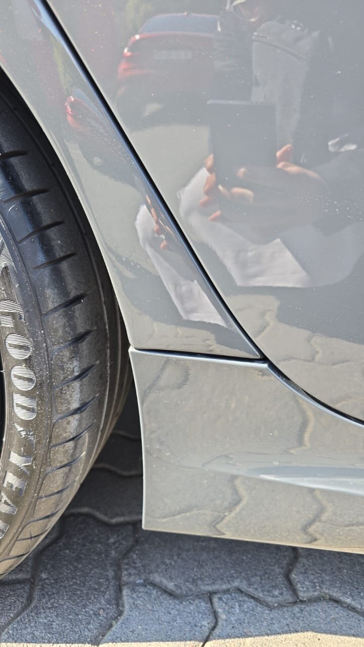

The sideskirt and rear fender don't align properly, and neither does the rear bumper.

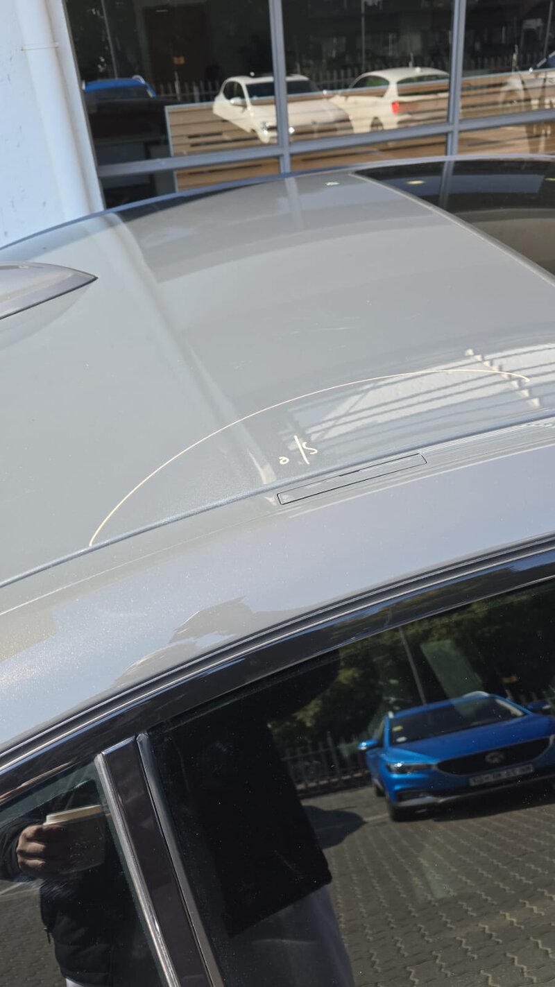

there's overspray on the roof, they said they didn't notice it until we took it out in the sun

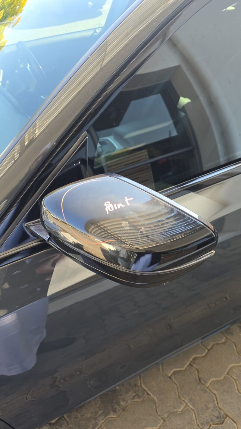

They burnt 1 of the mirror caps by trying to polish it so now they have to respray both

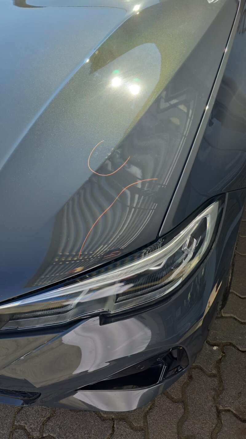

The worst part. They managed to scratch the car on the front left bonnet, I'm almost 99% there was no scrathes when the car was handed over
