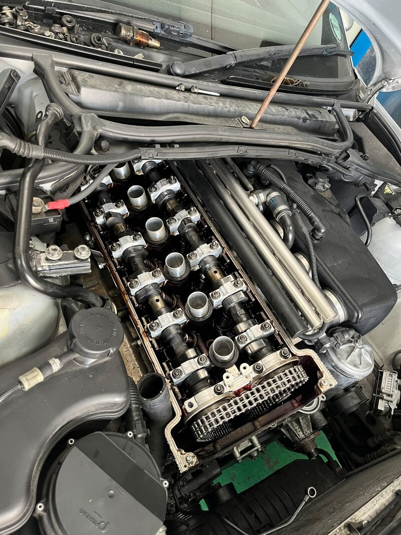

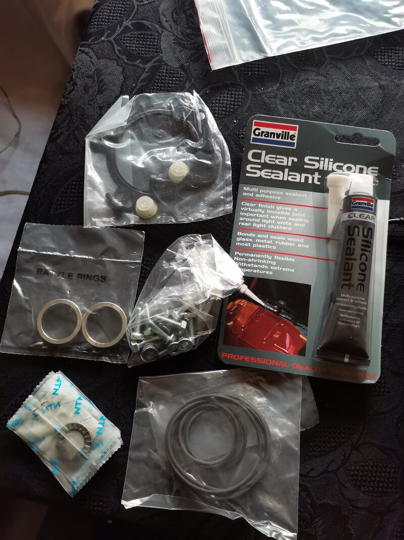

So I am busy sorting out some power delivery issues on my M3 and now need the S54 Vanos Seals for the job. Are these still only available directly from the States or is there perhaps a local supplier? Unless someone has a spare set lying around for sale :cool:

Based on my Personal experiance in trying to find for the M54, noone stocks it locally.
I went with the X8r Kit from the UK for the M54 engine and Man what a difference. (was also cheaper than the Beisan kit)
S54 i have to assume the Same. no local stock
