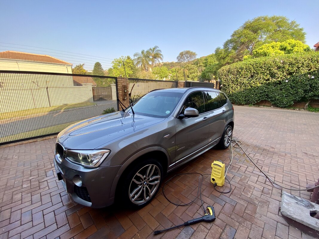

Good afternoon
New to the thread. Recently took ownership of my mother’s 2016 f25 x3 20dX that she drove from new and currently has BMW dealer FSH.
Currently on 120k km.
I would like to drive the car until it dies and do not plan on selling it.
Excluding ZF service that should be done between now and 150k, what other preventative maintenance should I do?
Is cat and egr delete worth the hassle and would be a downpipe be beneficial. I understand that this requires a remap and if done incorrectly can go pear shaped( Greater wear and tear and smoking ). If it is worth the hassle, what workshops do you recommend?
I am based in JHB.
Finally, could you please include an estimated cost for your recommendations.
Thanks a lot!

Hi there what beautiful X3. Enjoy

Stunning car, congrats
