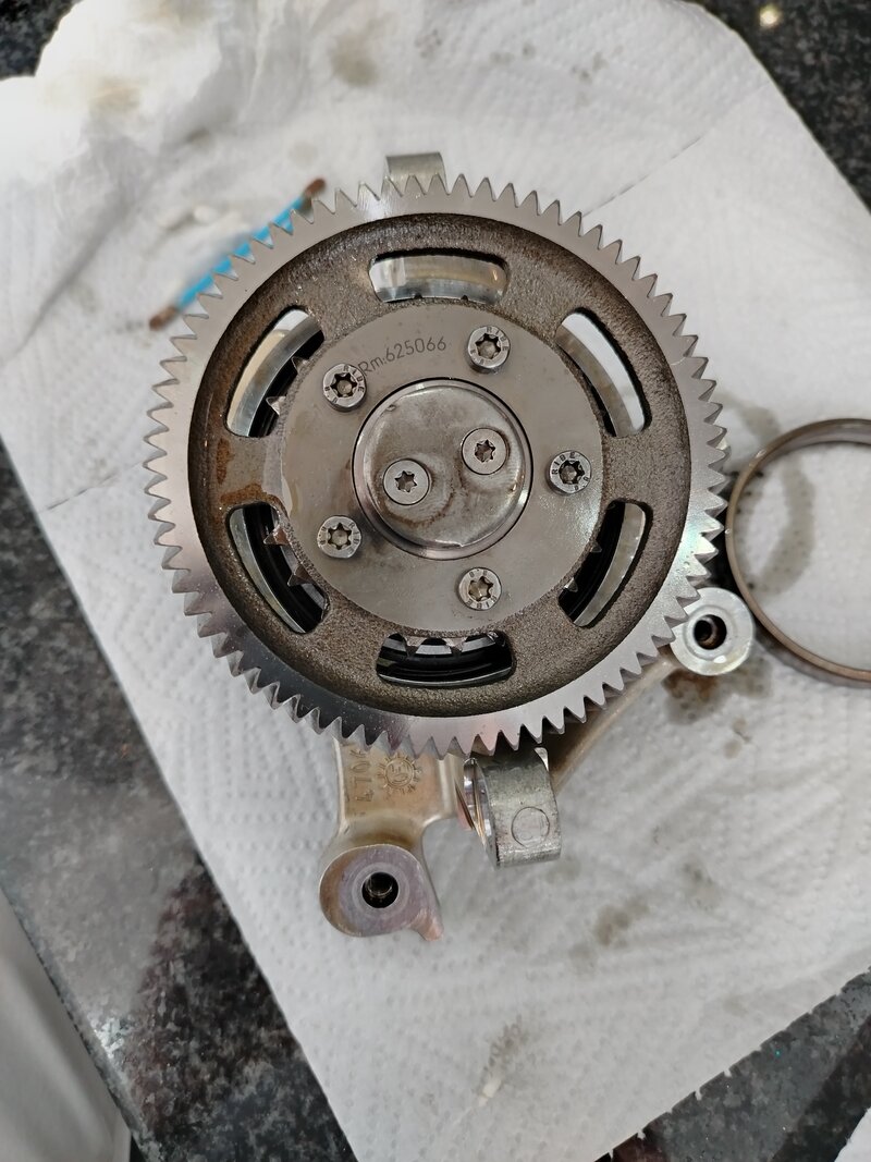

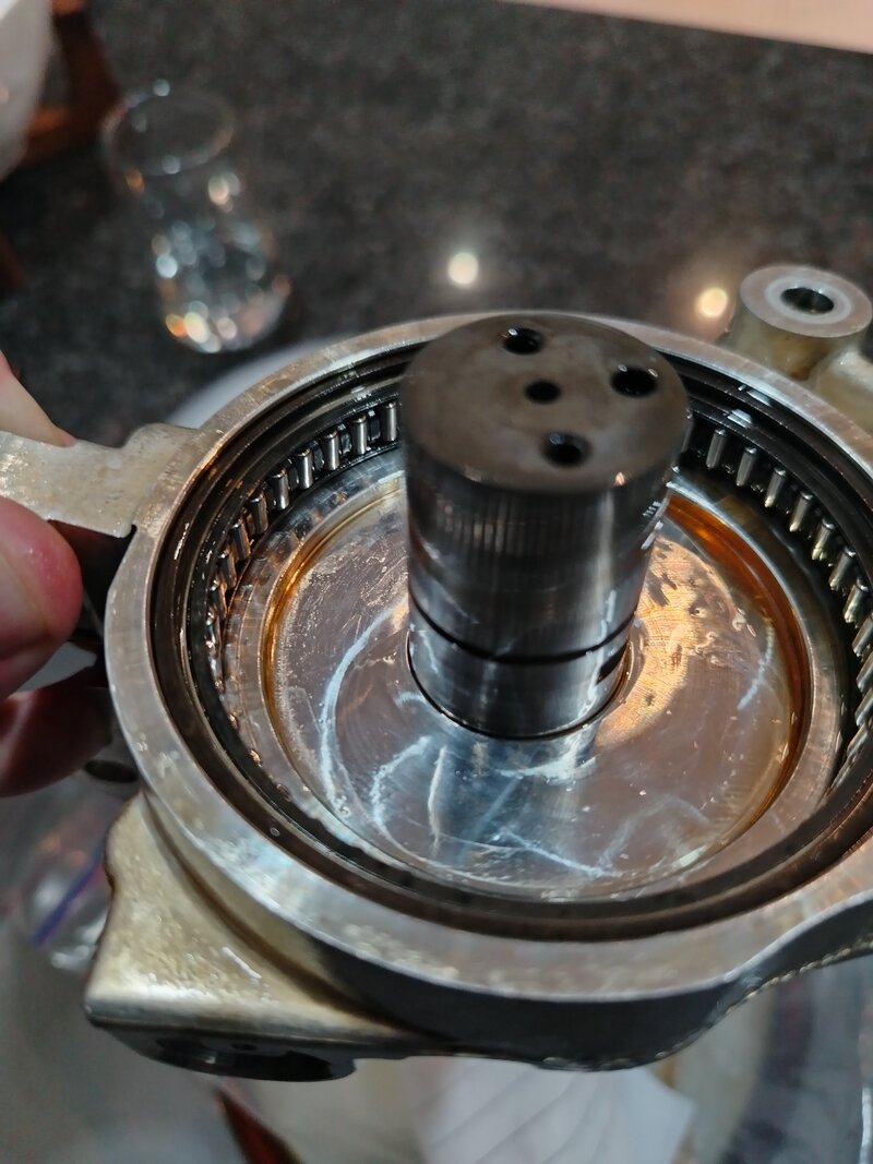

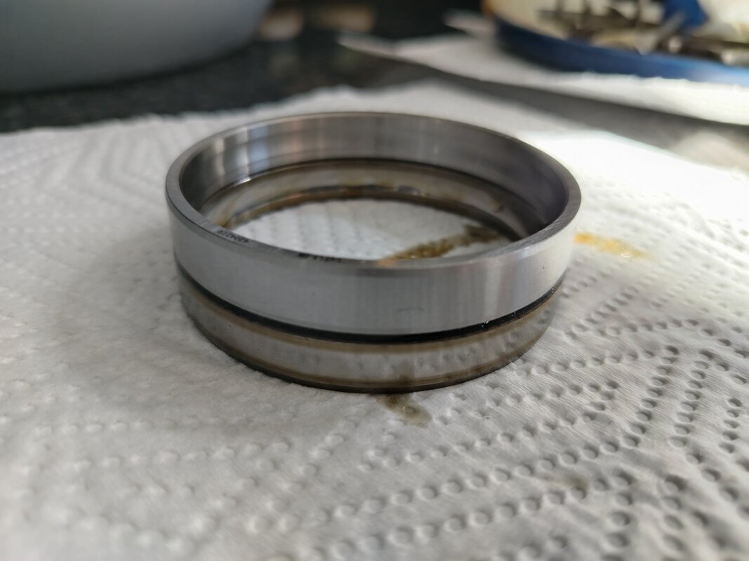

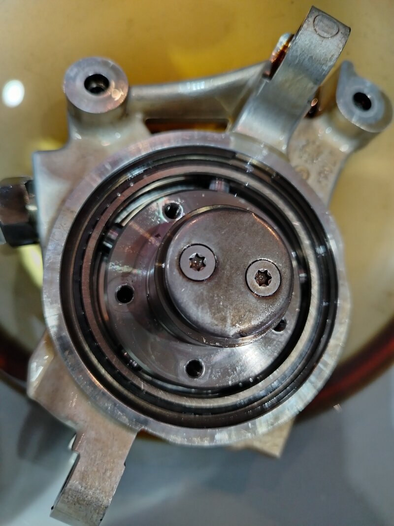

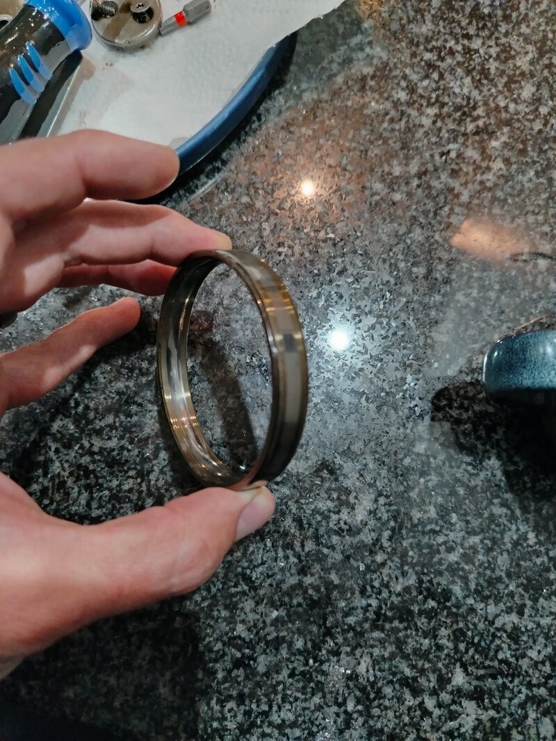

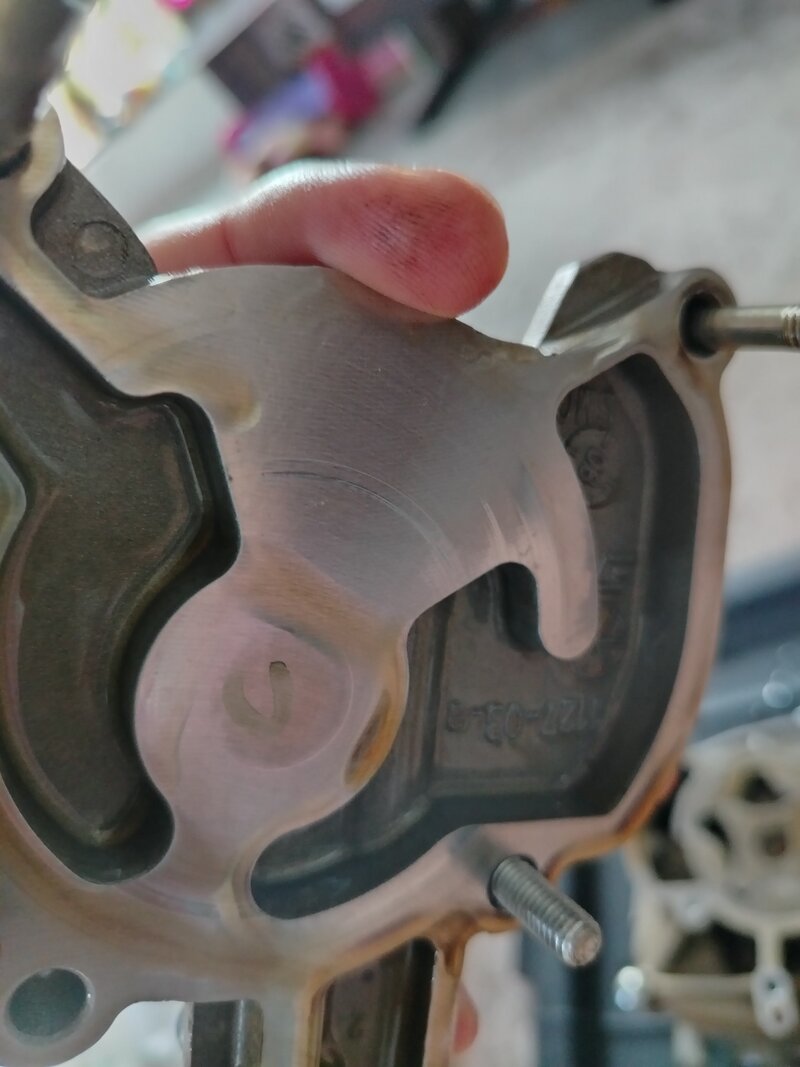

Opened up the vanos pump, bearing race was deformed to the point that it would not turn freely without extreme resistance. These new pumps are not cheap 30-35k.

Benji
Glad you found the root cause of the problem...and well spotted as well!
S85 ownership in all its glory
Peter@AEW
Ouch, part of S85 ownership I guess.
I see you get rebuild kits: https://drvanos.com/products/s85-vanos-pump-rebuild-kit
Even with shipping & customs it would likely work out cheaper than a new pump.
You can do that kit if your wish is for it to fail again.
Once the race is deformed the pump extensions also deform and when you re assemble you have a new race and deformed extensions.
Rinse repeat

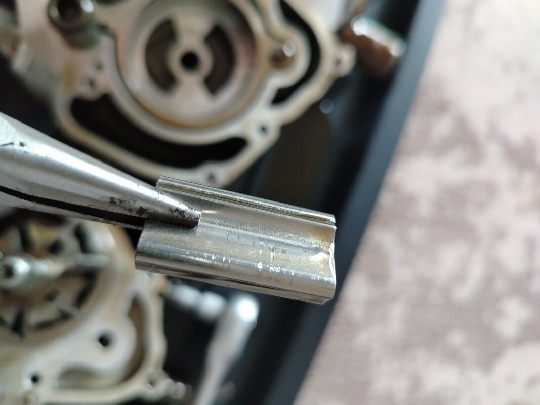

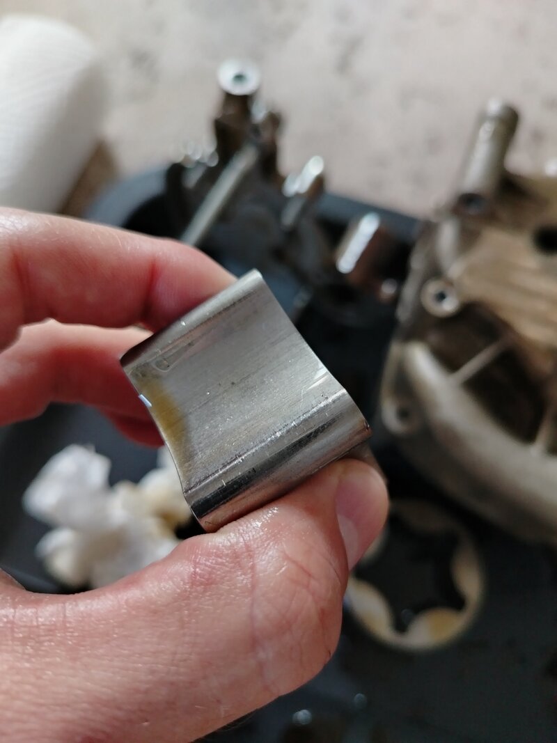

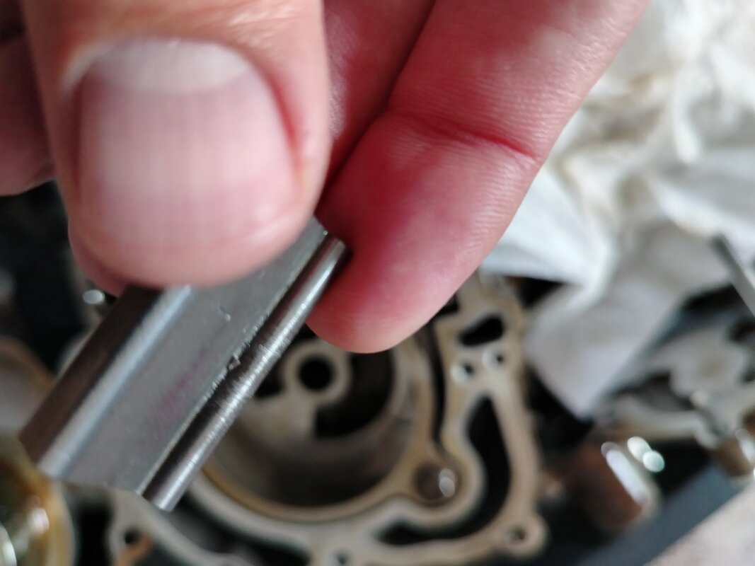

Soooo glad I opened up. The metal debris was embedded in the main oil pump.

Katanator
Rinse repeat
I have ordered the kit from DrVanos. Shall fit it and see how it turns.
My reasoning is it will an all cases be significantly better than what it was.
I will definitely order a new main oil pump from dealers.
Katanator

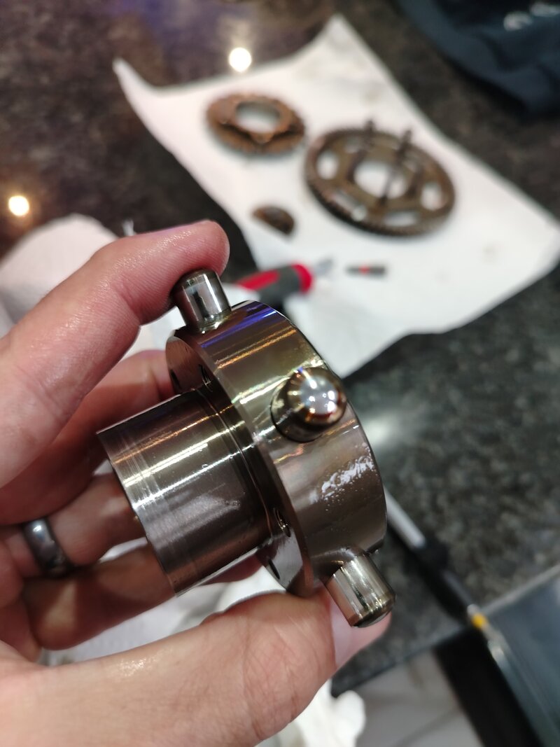

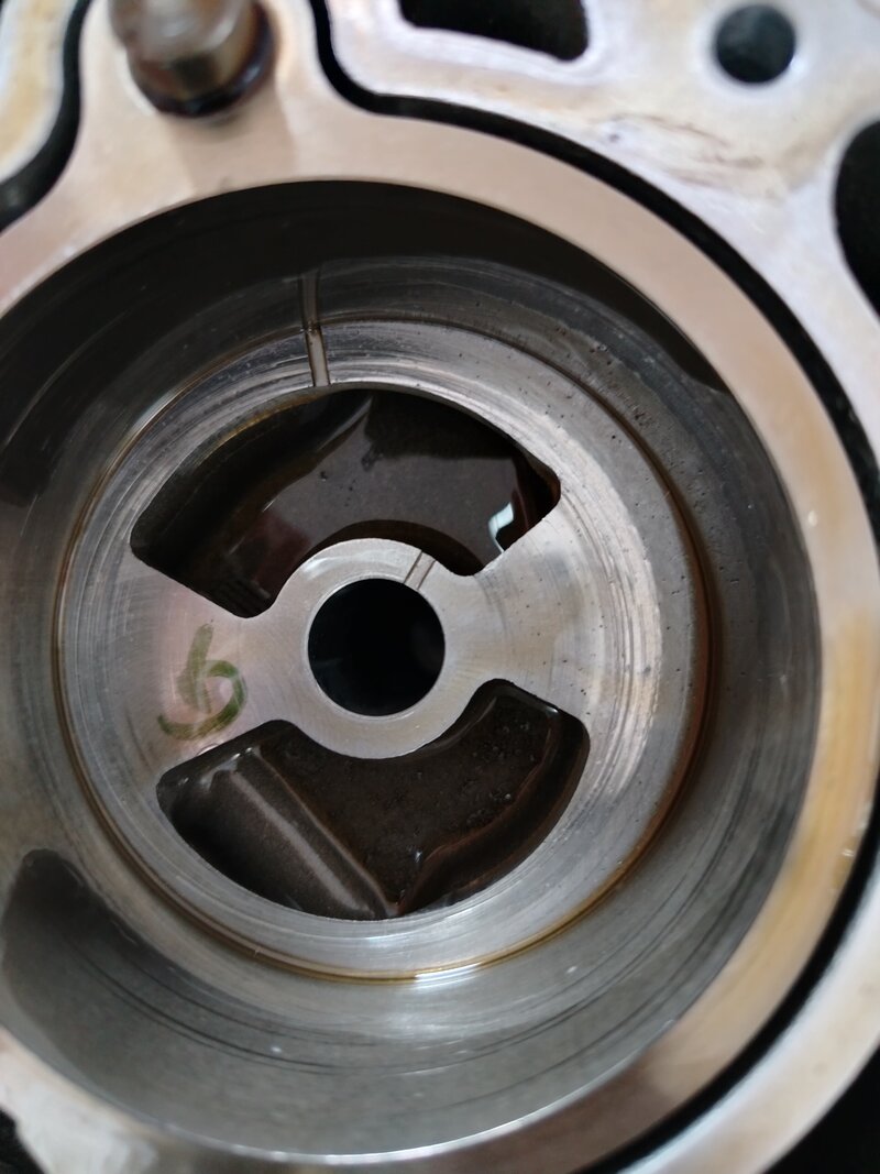

Bearing race fitted. The difference can not be described. Previously could not even turn 1/10 of a rev without significant resistance. Smooth as butter now.
The old bearing race had an oval shape from wear.
The kit comes with new o rings for all the pressure valves.

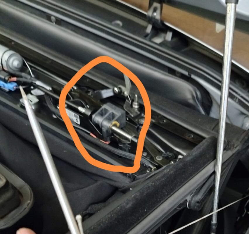

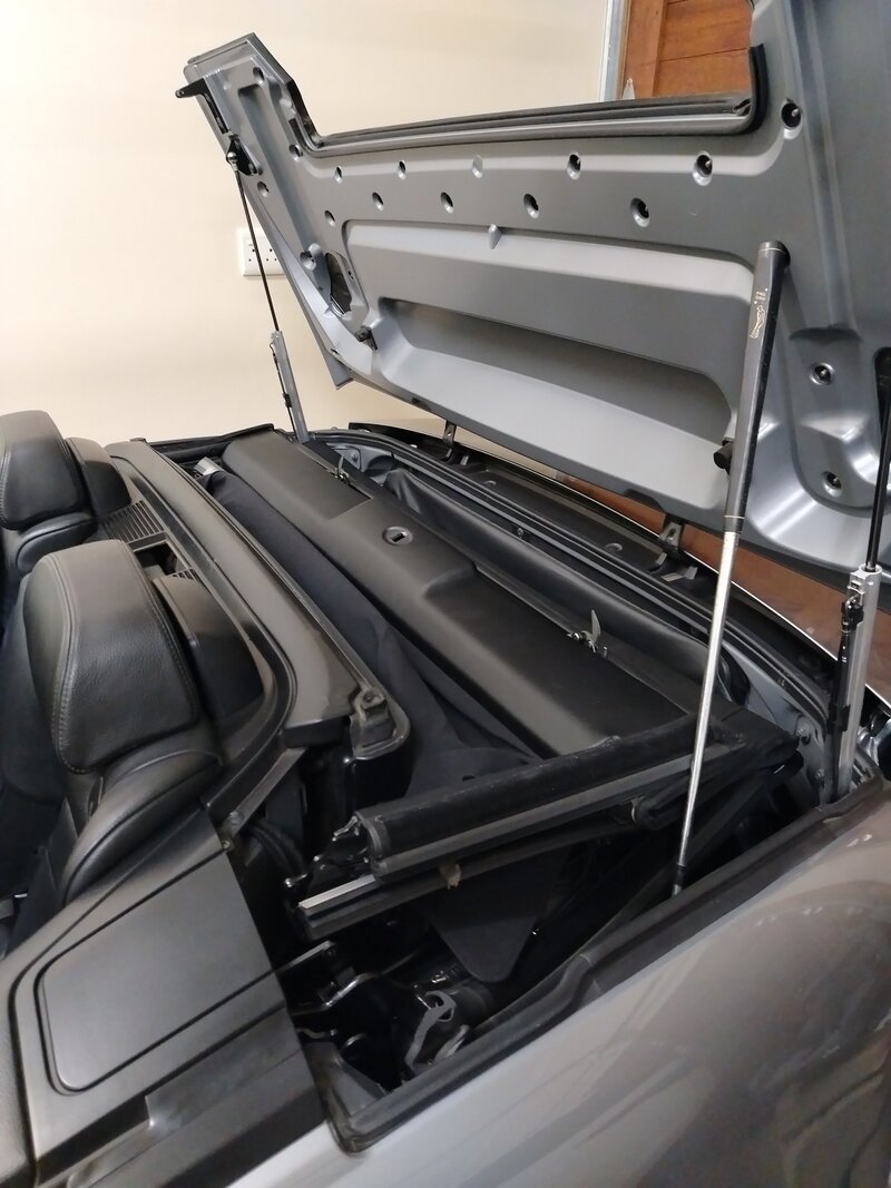

I have been getting the dreaded red flickering light and soft top not locked error leaving the soft top locked and all windows not operable. Had it on previous occasions as well and managed to get it fixed with fiddling here and there on the sensors and front locking mechanism.
This time nothing worked. Opted to open the roof manually which also didnt work, figured this would solve the issue if it was the rear support angle sensors.
From a previous time I remember I got it fixed with adjusting the front locking mechanism. Opened up the front panel and found the bugger. One of the position sensors not reaching full position. And just like that error fixed. IMG_20250925_200813.jpg

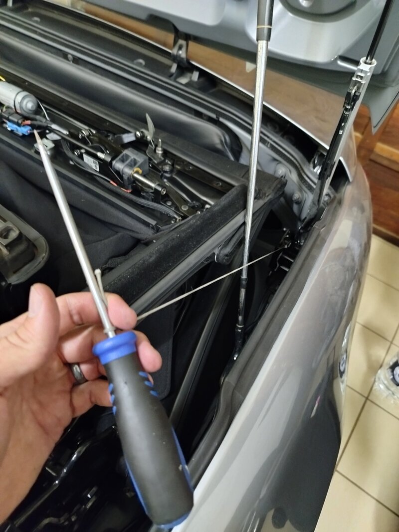

My plan to lock the rear boot cover with kitesurf lines pulled through the small openings. I see no other way of locking the roof lid from the inside. IMG_20250925_200520.jpg
