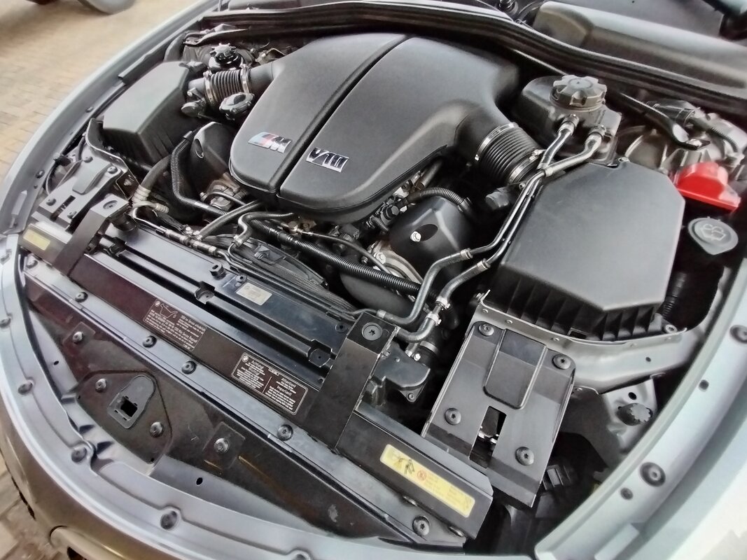

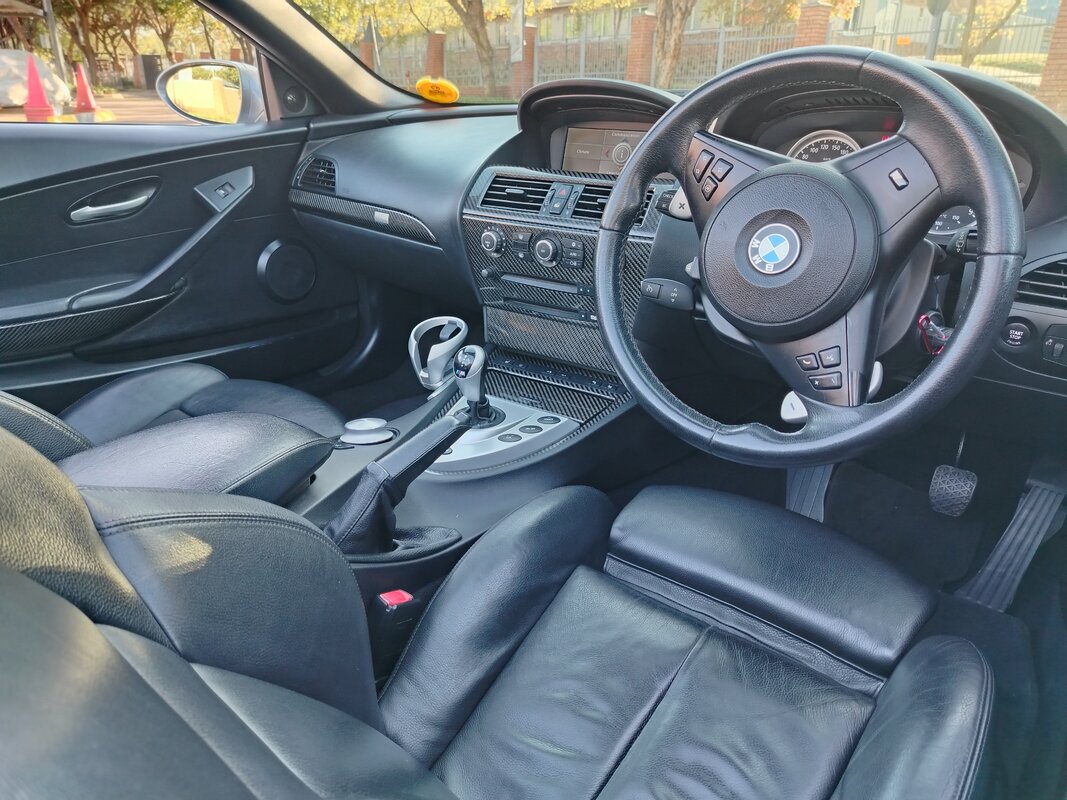

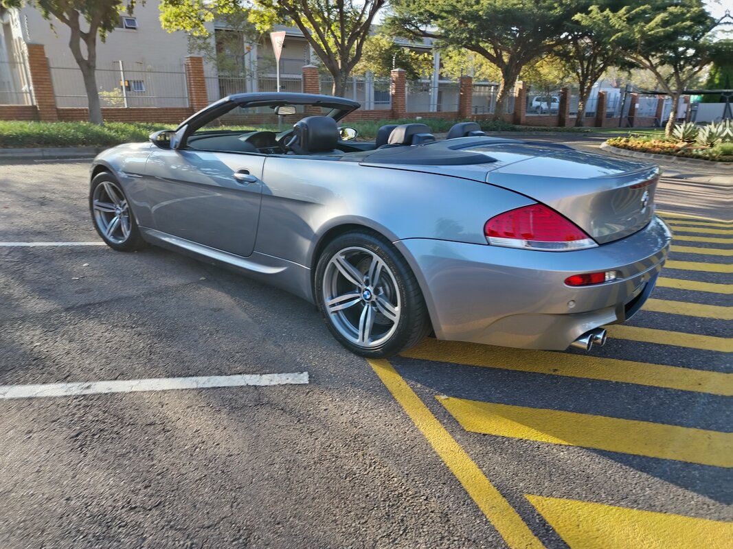

Preventative maintenence done. Detailing done by none other than myself. She is complete for now.

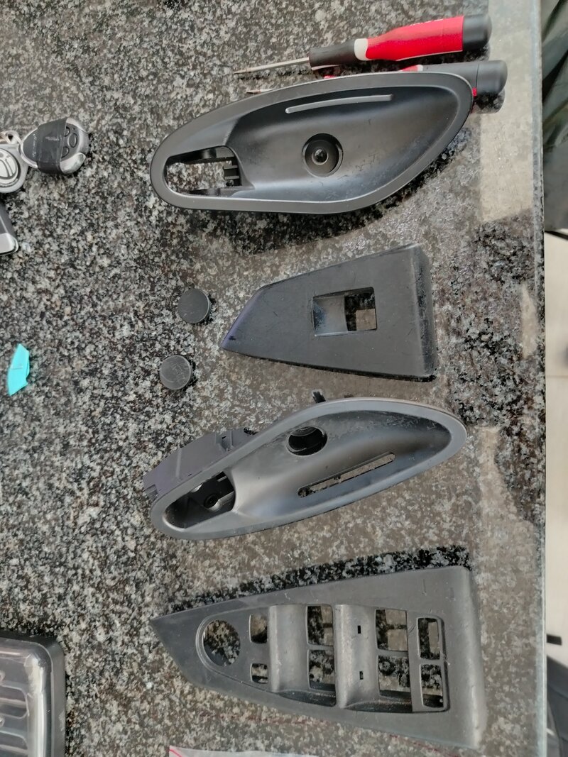

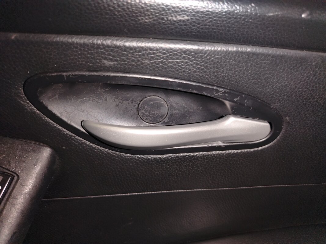

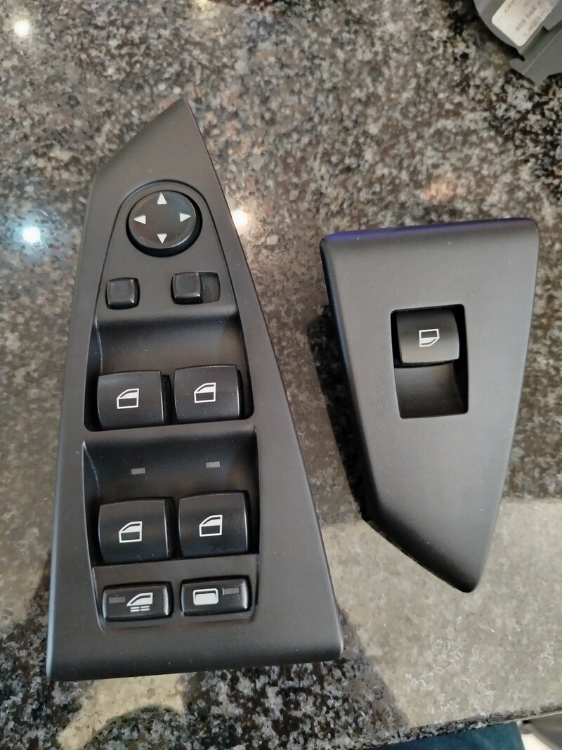

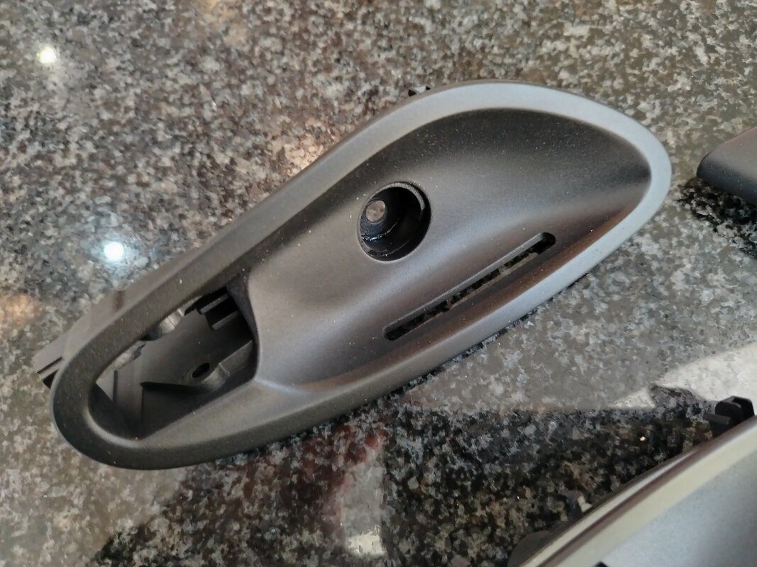

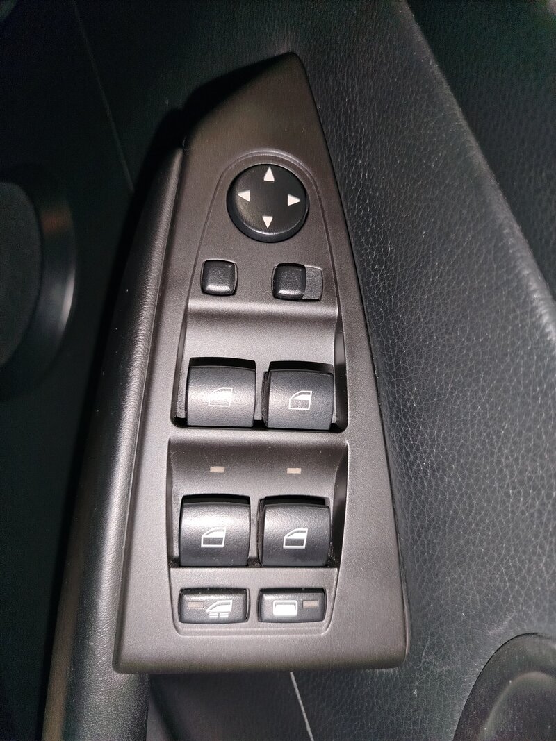

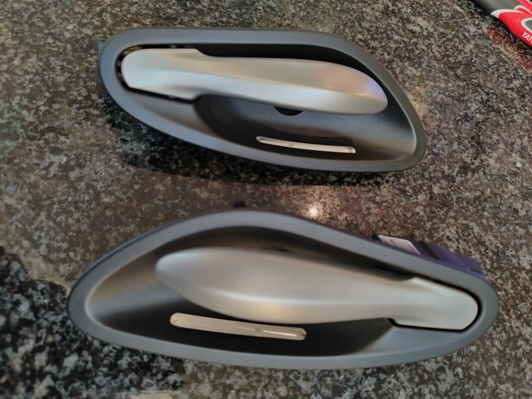

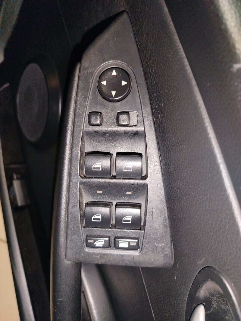

Katanator

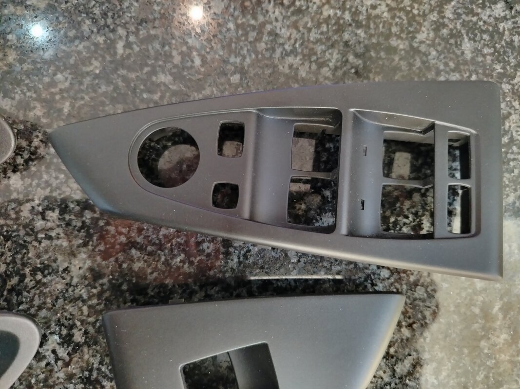

Being the only interior parts to show some wear they had to be attended to. I shopped around and the dealers say they are not manufactured anymore due to only 420 RHD convertibles worldwide I can understand that the window switches in this orientation would not be available.
So I decided to strip them down and had them recoated. And must I say I cant be more happy with the outcome. It matches and looks perfectly OEM.

FiRi@Rennzport
This came out brilliant. Who did you use or what did you use to recoat them?
Sareshan
A local guy in Centurion specializing in interior repairs. Pm me and will send you his number.
He sanded and prepped the surface and then colour matched spray painted it.
That came out great,
Please share details, I need to do redo some interior parts

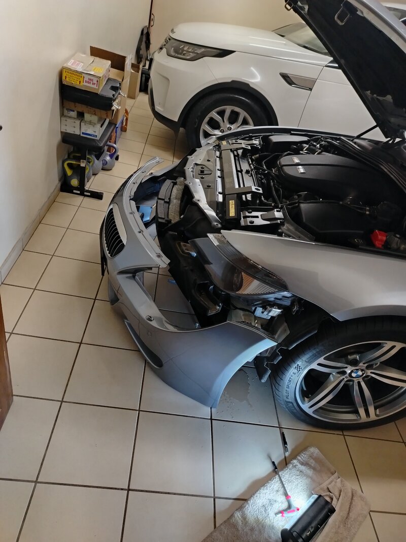

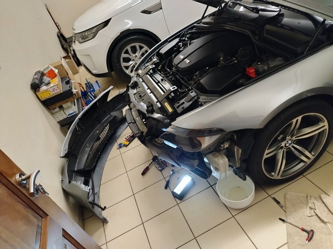

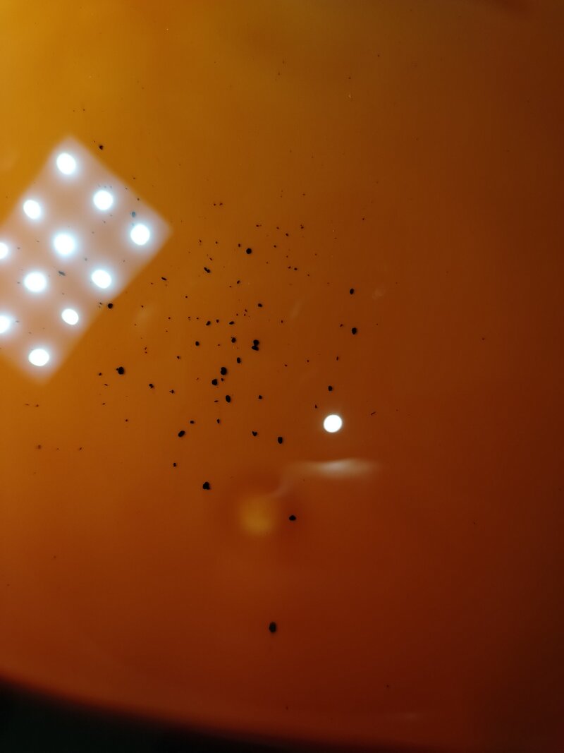

A little update. Buy an old M car it will be fun they said.

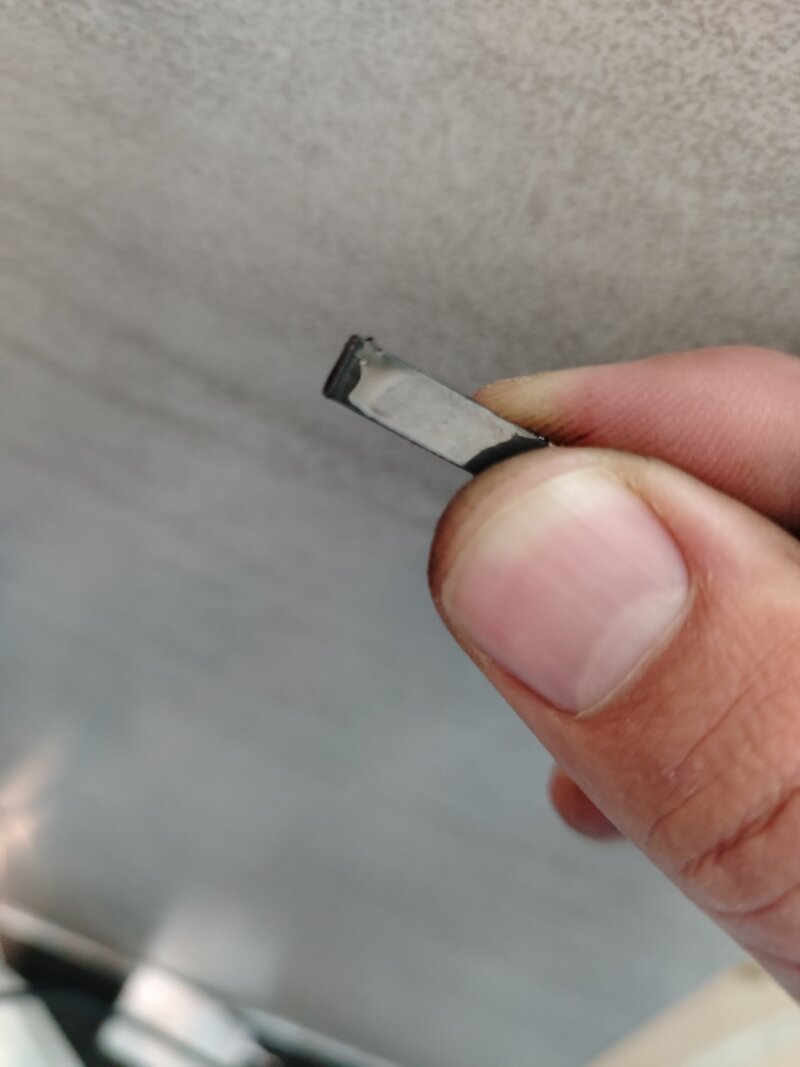

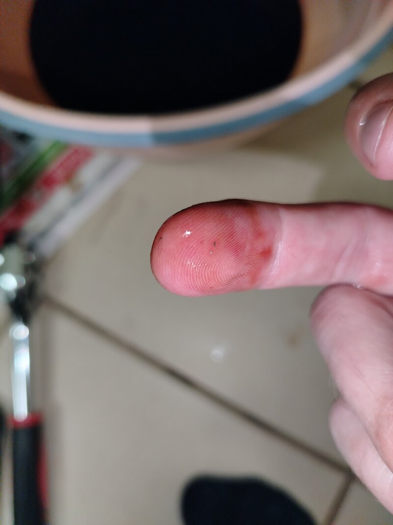

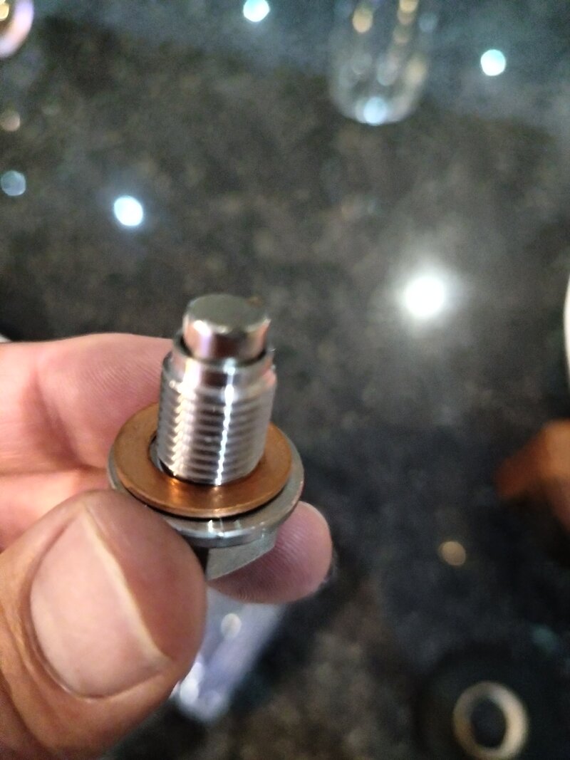

So notwithstanding my needs to know that everything is always as it should be on the car I have changed oil twice since my ownership and about 2000-3000km driven. Castrol edge 10w60, stuff is not cheap.
First time round I noticed some small metal shavings in the oil filter housing, very fine, some magnetic and others not. Decided to put in new oil and filter and drive another 100-200km and then change oil filter again, its easy enough. Could have been some residual from previous work on one head or bearings.

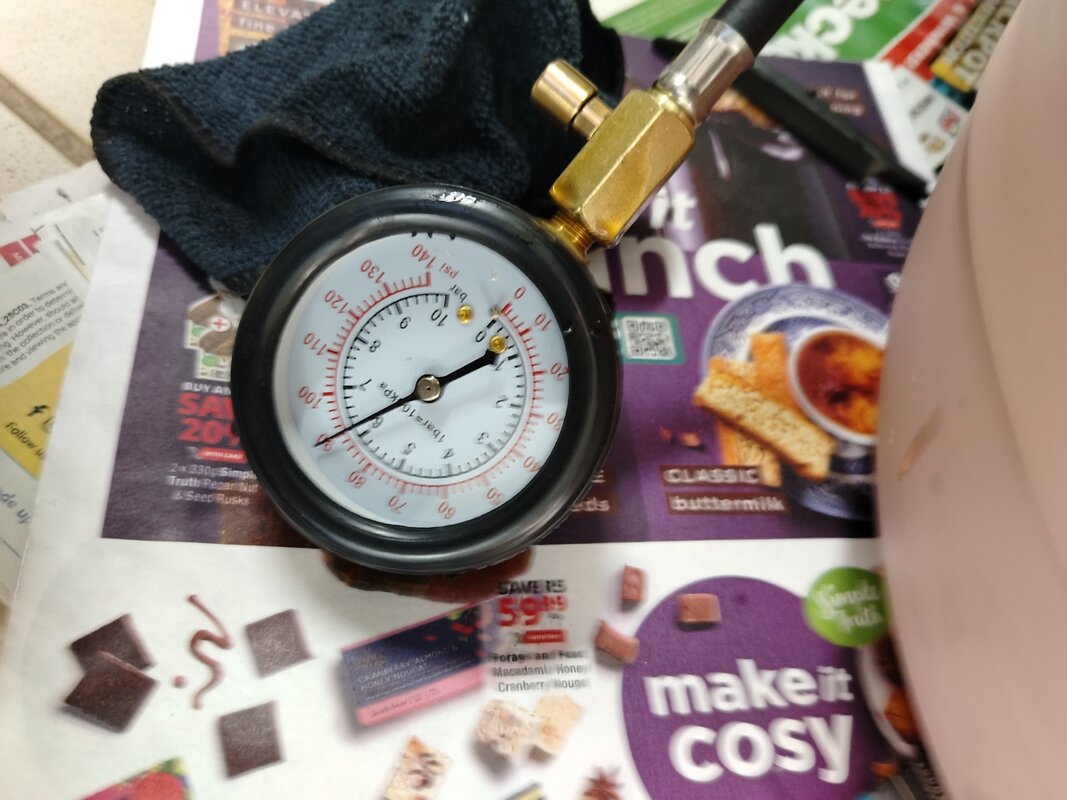

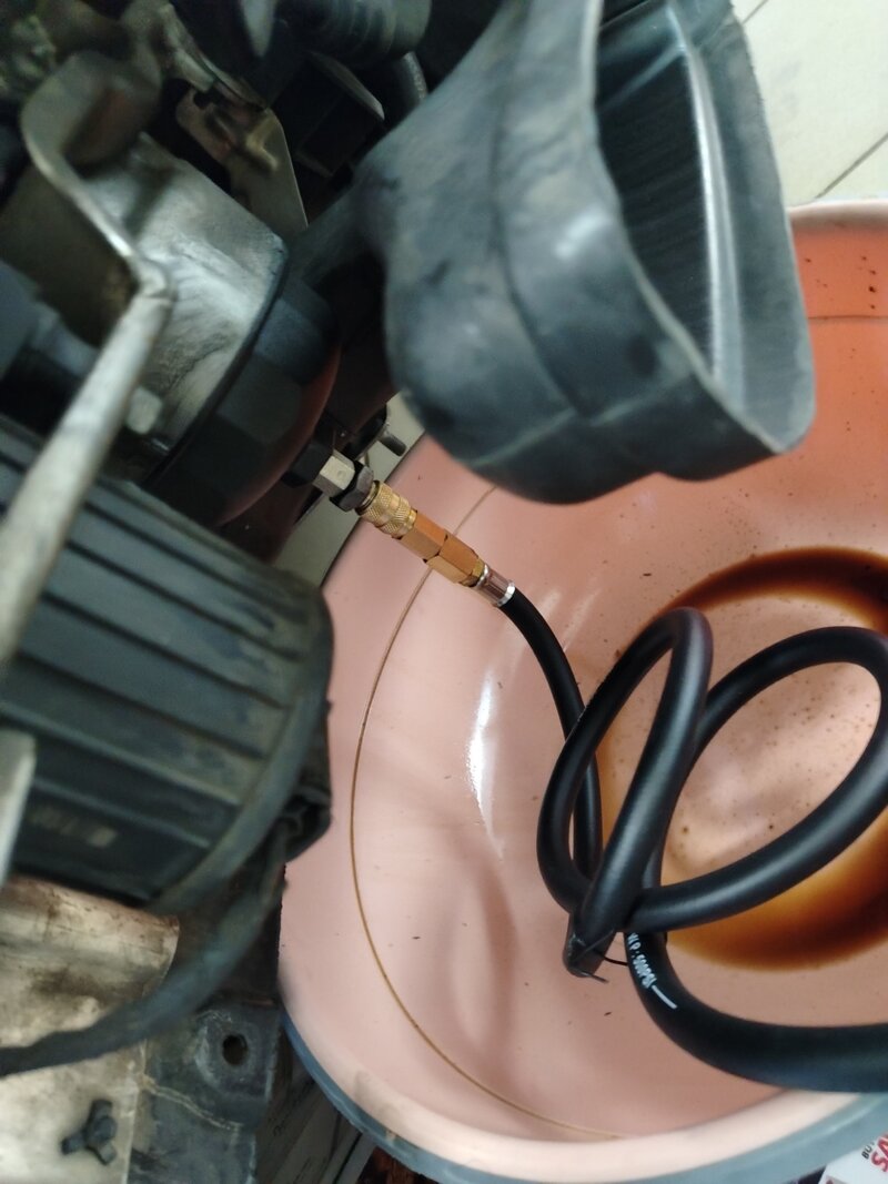

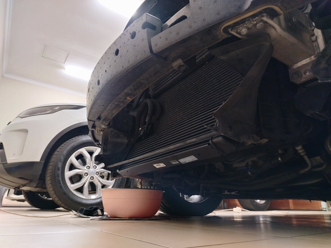

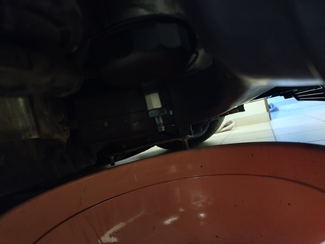

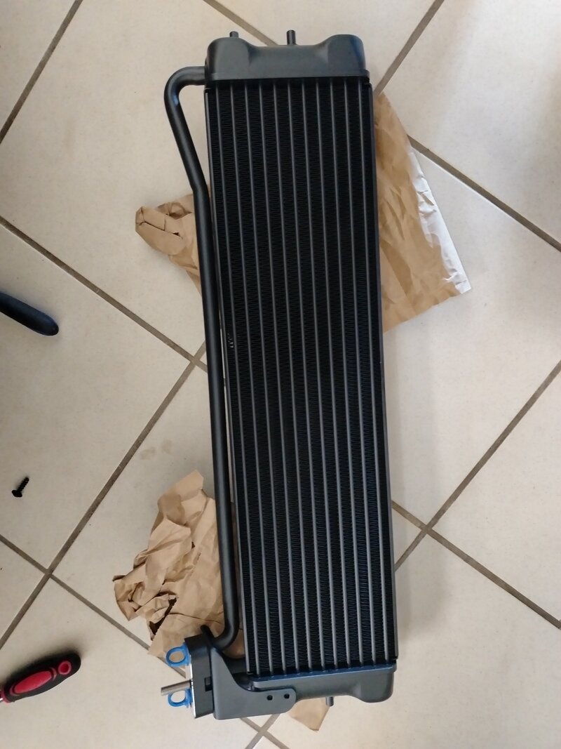

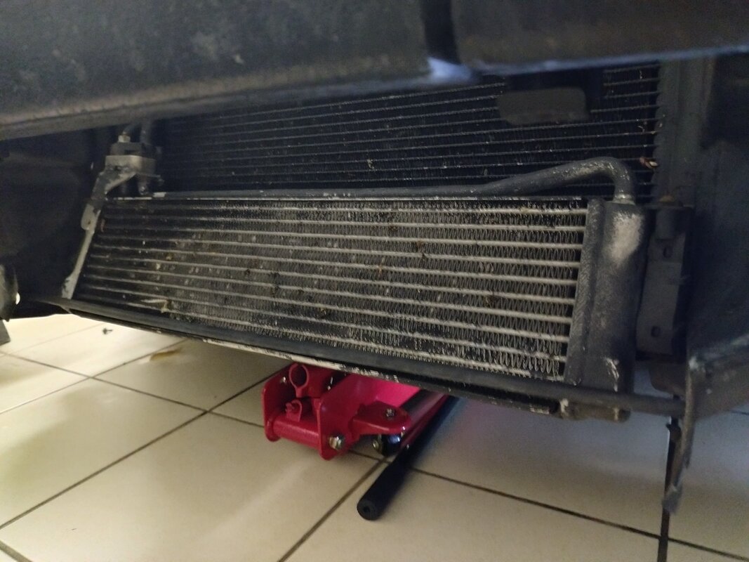

Katanator
After about 100km changed oil filter to find some again, not a lot, one or two specs but too much for my liking.
This led me to consider changing the oil cooler, could be residual from there although I find it highly unlikely since it sits after the oil filter in the flow pattern.
I also assembled an adaptor to test oil pressure, easiest for me was at oil filter housing drain hole. This car does not have a oil pressure reading, only a sensor to warn if too low. The oil pressure sensor can also be tied in at the spot of the oem oil pressure sensor.
Oil pressure seemed perfect at around 6 bar cold idle.
Katanator
After oil cooler change got engine to temp to test pressure across all rev ranges.
With the new oil (2nd round) and new oil filter in.
When I disconnected the oil pressure gauge from the filter housing I inspected the oil that drained again, and to my disappointment found another shaving, even after brand new oil and just getting up to temp once.
So into the belly it is. The culprit must be found.
At the moment crank and bearings look decent but the vanos pump does struggle to turn a bit.
I will open up the pumps to inspect and see how to continue from there.
Open to any advice or other recommendations.
