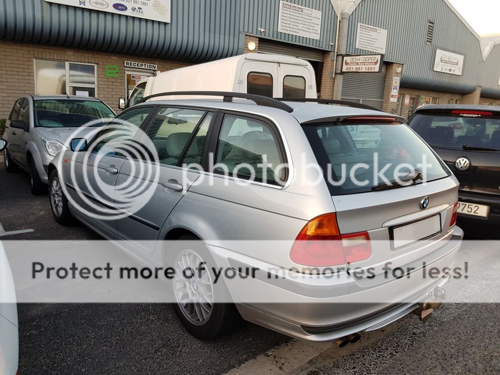

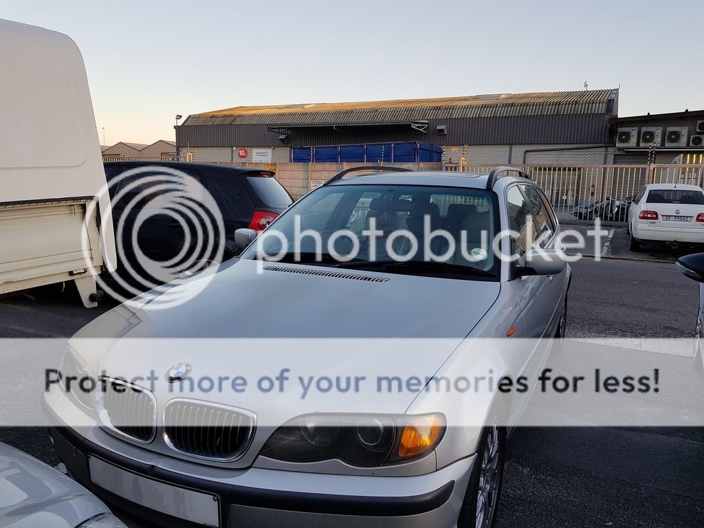

Some pics taken when I dropped her off:
Any questions, ask away :=):
