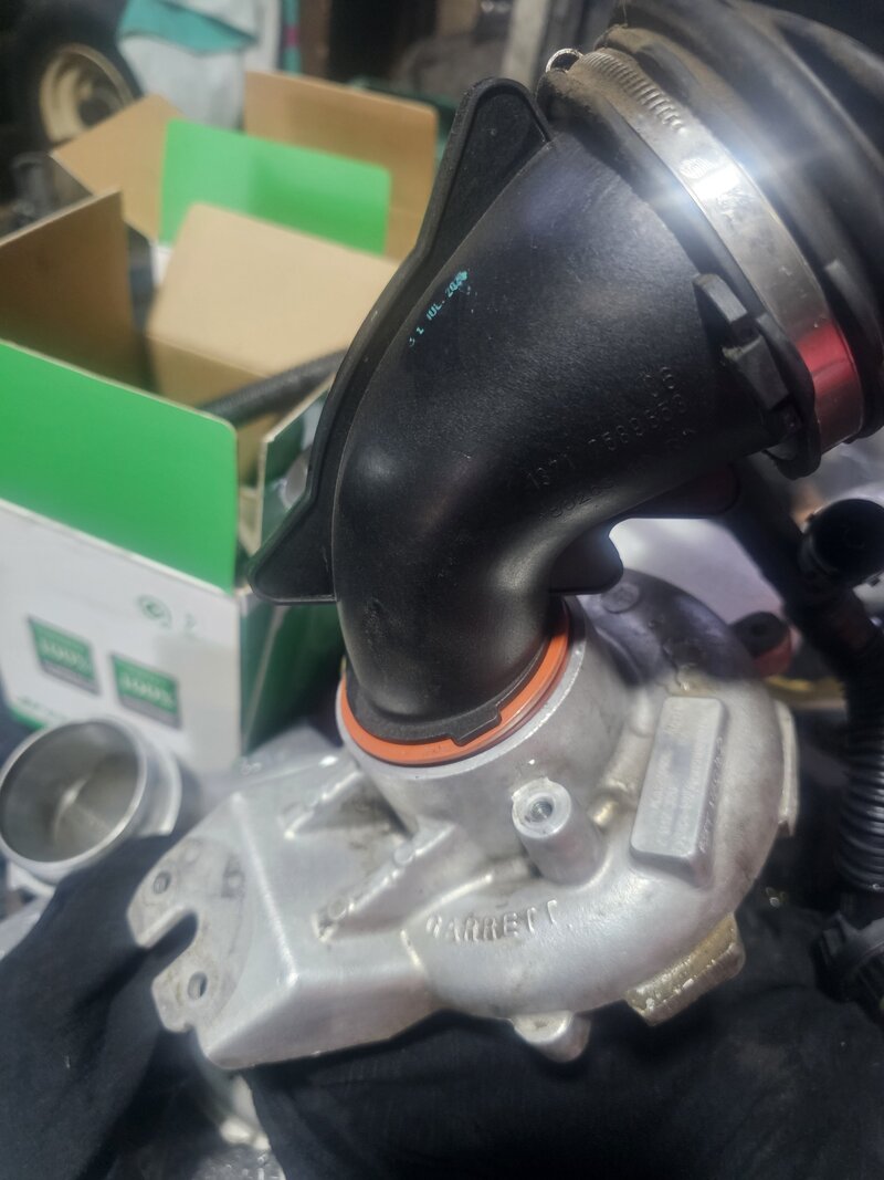

Ok I see it now, so it's actually for the air tube. So on the last image I sent with the orange scribble on it, it seems like that...

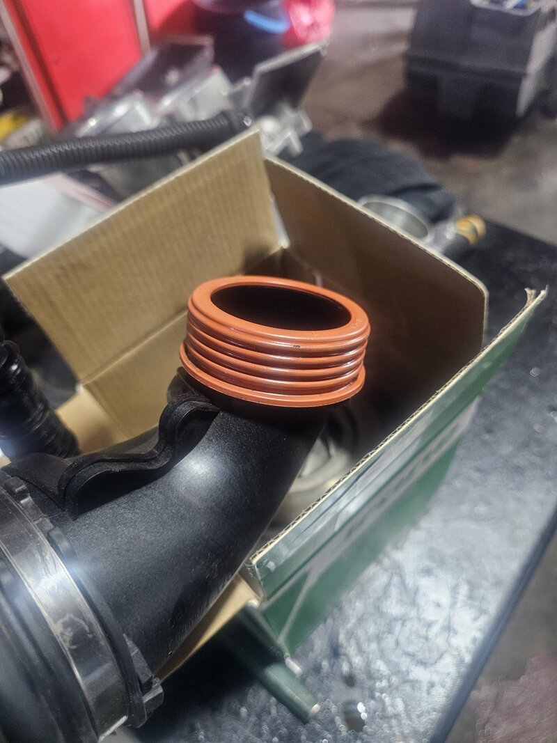

Ok I think I am making a bit of progress here. Check this photo below. It seems there is an o-ring that sits just above the main core...

The part numbers on your turbos should be 11657848320 and 11657848116 (they're left and right turbos, N63 used identical turbos). The...

There is a couple of partnumbers on realoem, the N63 turbo's is diffrent from S63. The S63 uses dual core turbos with slightly larger...

@Gordvisr I dont see the recess in your turbos pictured for the O Ring. Here are the turbos from the m6/S63tu Can see the green oring...

I suspect yours is the original S63 engine, whereas the F10 and the F12/F13 used the S63Tu. The original S63 is based very much more on...

I found a pic of when I did mine. So if you haven't done the o-ring gaskets in these inlets, do them anyways, they were cheap. You can...

I'm coming in real late here, and kinda skimmed read through the last few pages to see what you were posting. Your smoking issue? Where...
