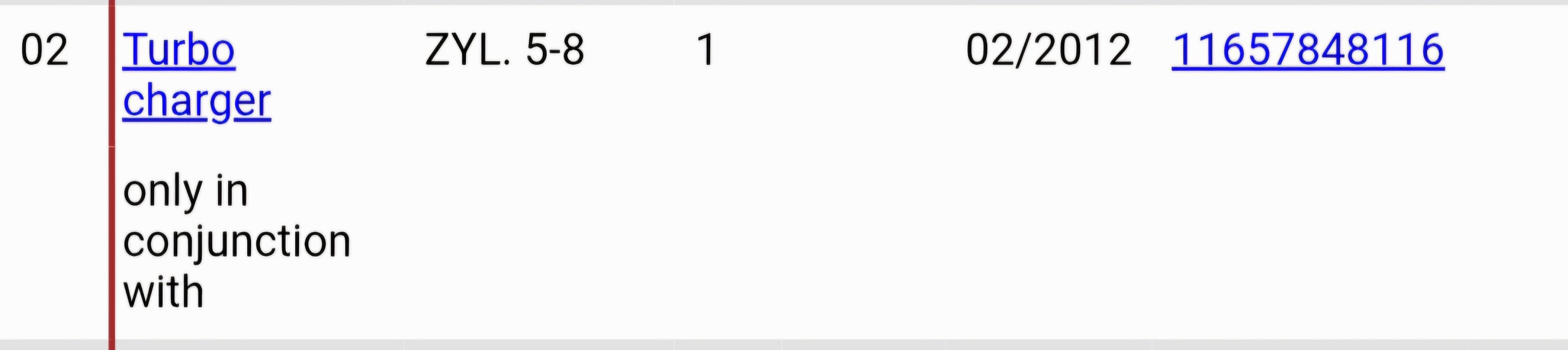

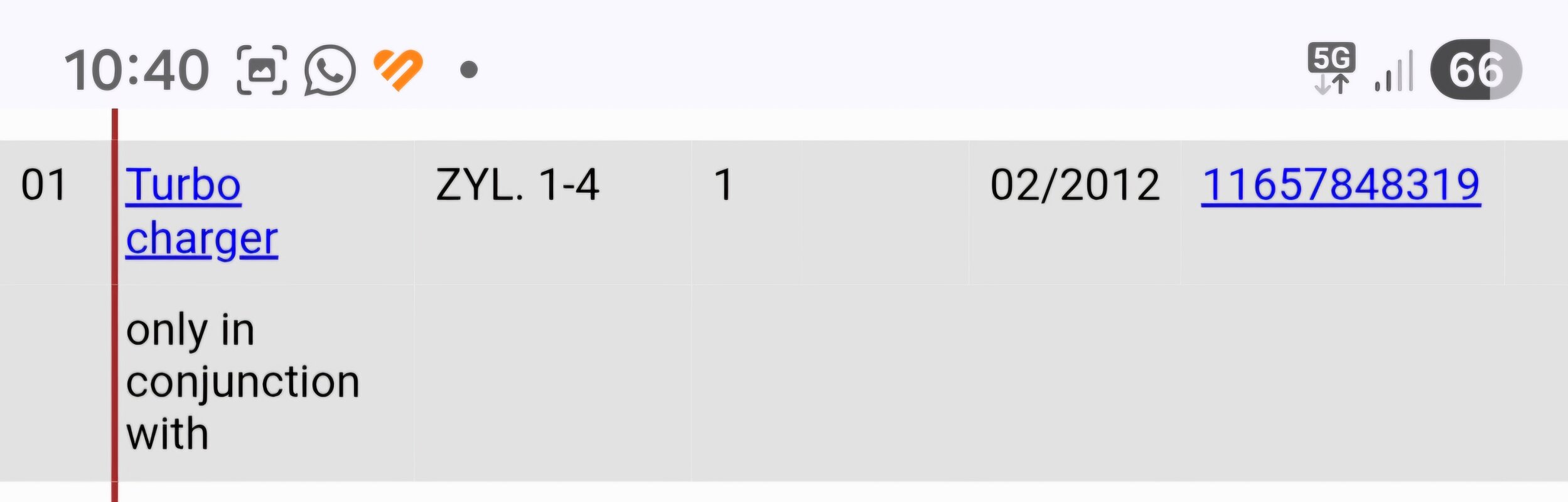

The part numbers on your turbos should be 11657848320 and 11657848116 (they're left and right turbos, N63 used identical turbos). The...

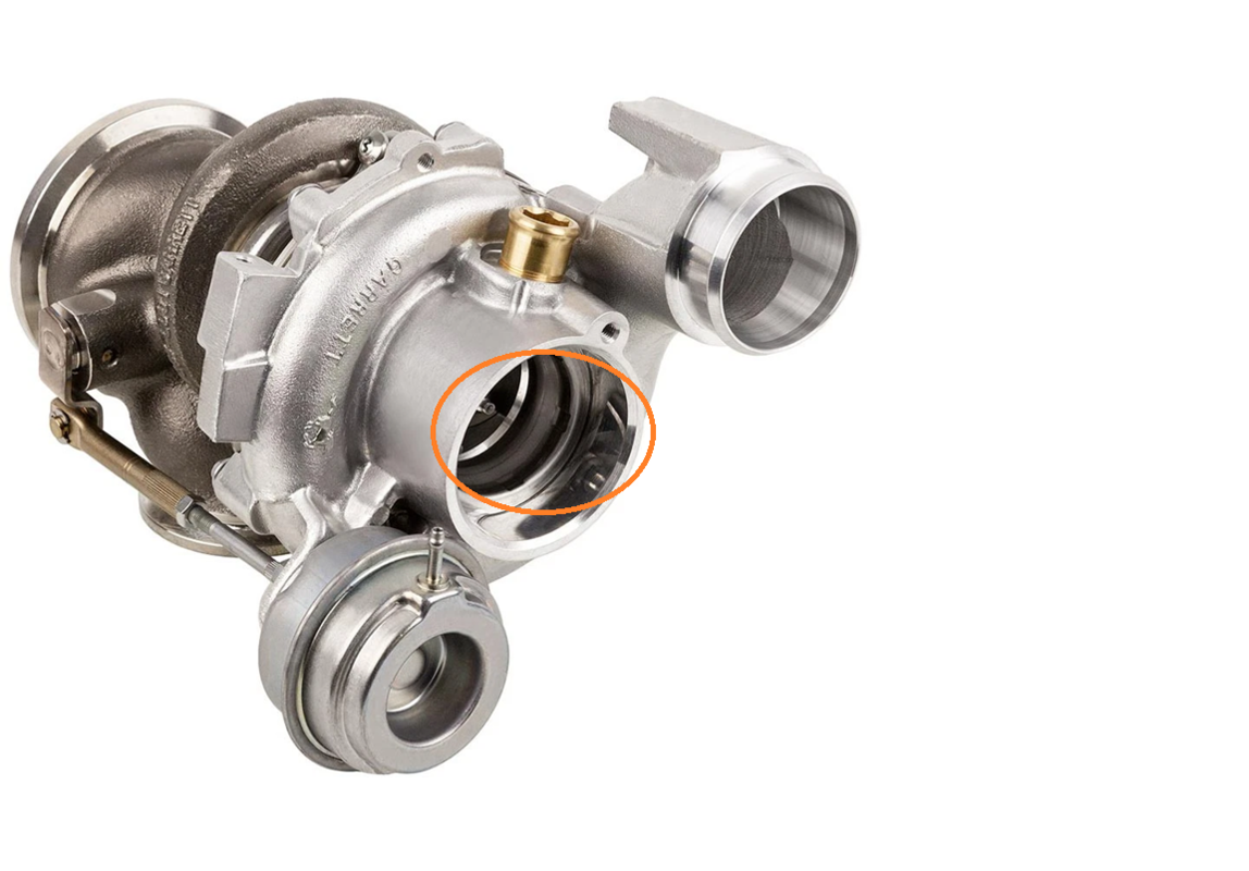

Ok I think I am making a bit of progress here. Check this photo below. It seems there is an o-ring that sits just above the main core...

Just been looking up some info on those turbos from the E70, and your turbos definitely don't have them, so I am guessing (contrary to...

@Gordvisr I dont see the recess in your turbos pictured for the O Ring. Here are the turbos from the m6/S63tu Can see the green oring...

I suspect yours is the original S63 engine, whereas the F10 and the F12/F13 used the S63Tu. The original S63 is based very much more on...

Thanks Bugger, when asked at agents they supplied me with these.
