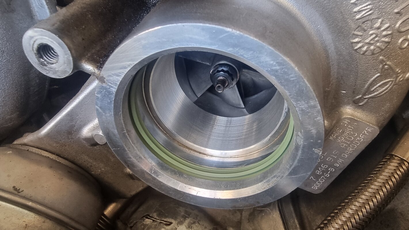

Yeah JD I am wondering if the ones we had were Tu upgrade inclusions.

Just been looking up some info on those turbos from the E70, and your turbos definitely don't have them, so I am guessing (contrary to...

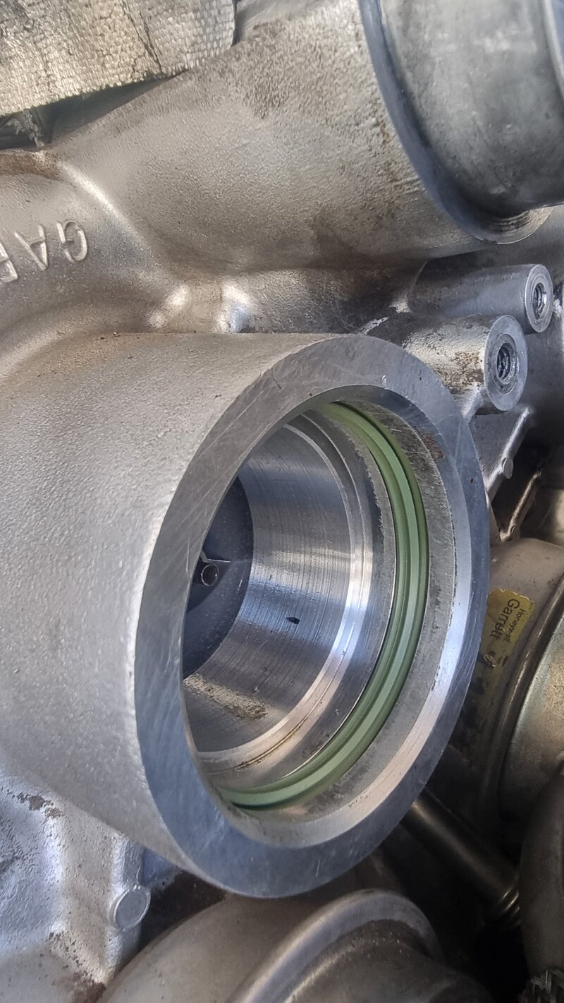

@Gordvisr I dont see the recess in your turbos pictured for the O Ring. Here are the turbos from the m6/S63tu Can see the green oring...

I suspect yours is the original S63 engine, whereas the F10 and the F12/F13 used the S63Tu. The original S63 is based very much more on...

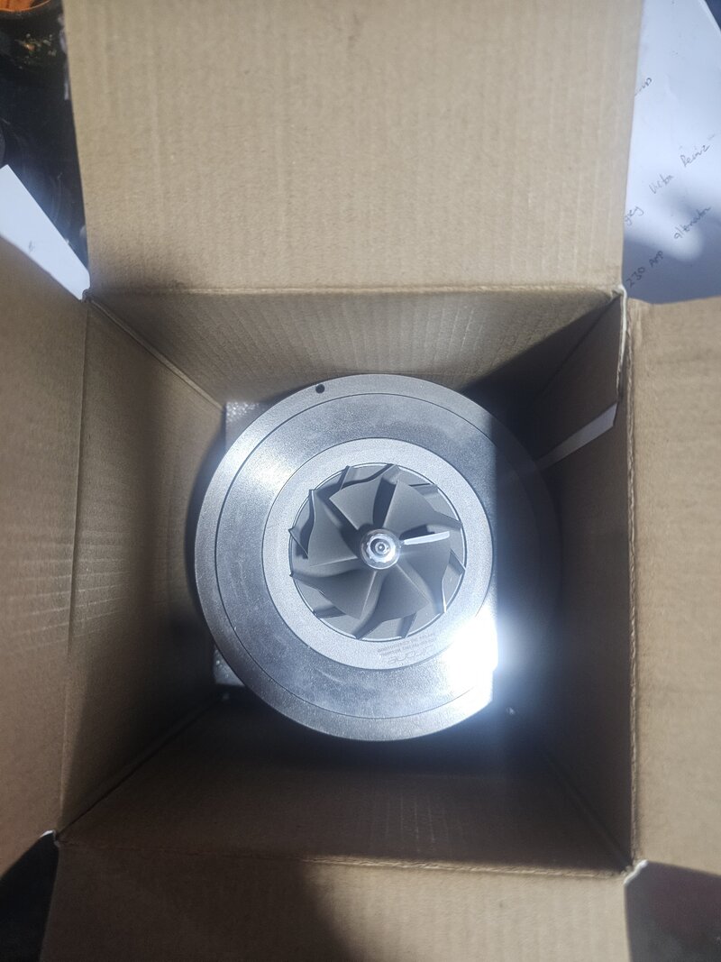

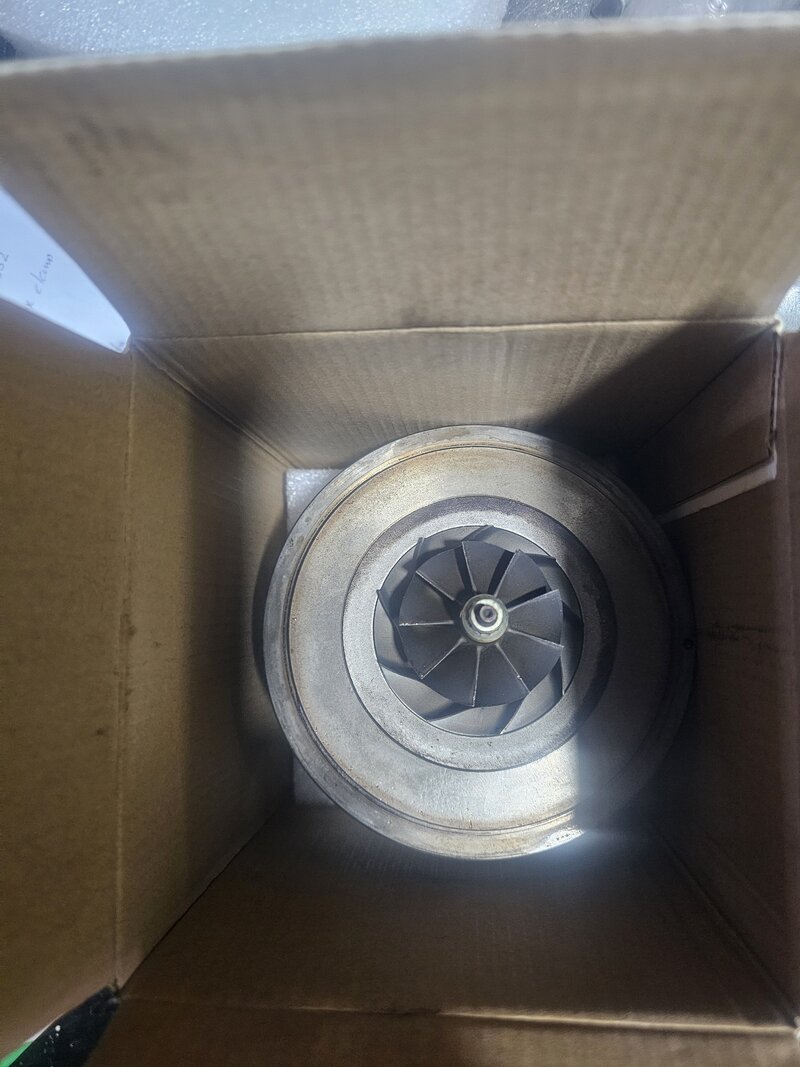

So bought the two cores as previously mentioned but some dislexy's jumped in, my cores part # MGT2260SDL but bought MGT2260DSL of which...
