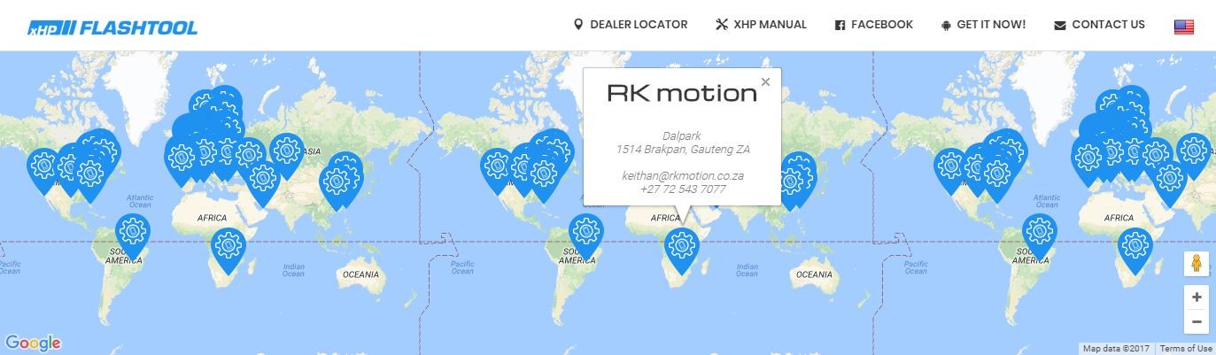

Rayzor
Awesome achievement to be the first and only official provider in SA, well done RK :cartel:
