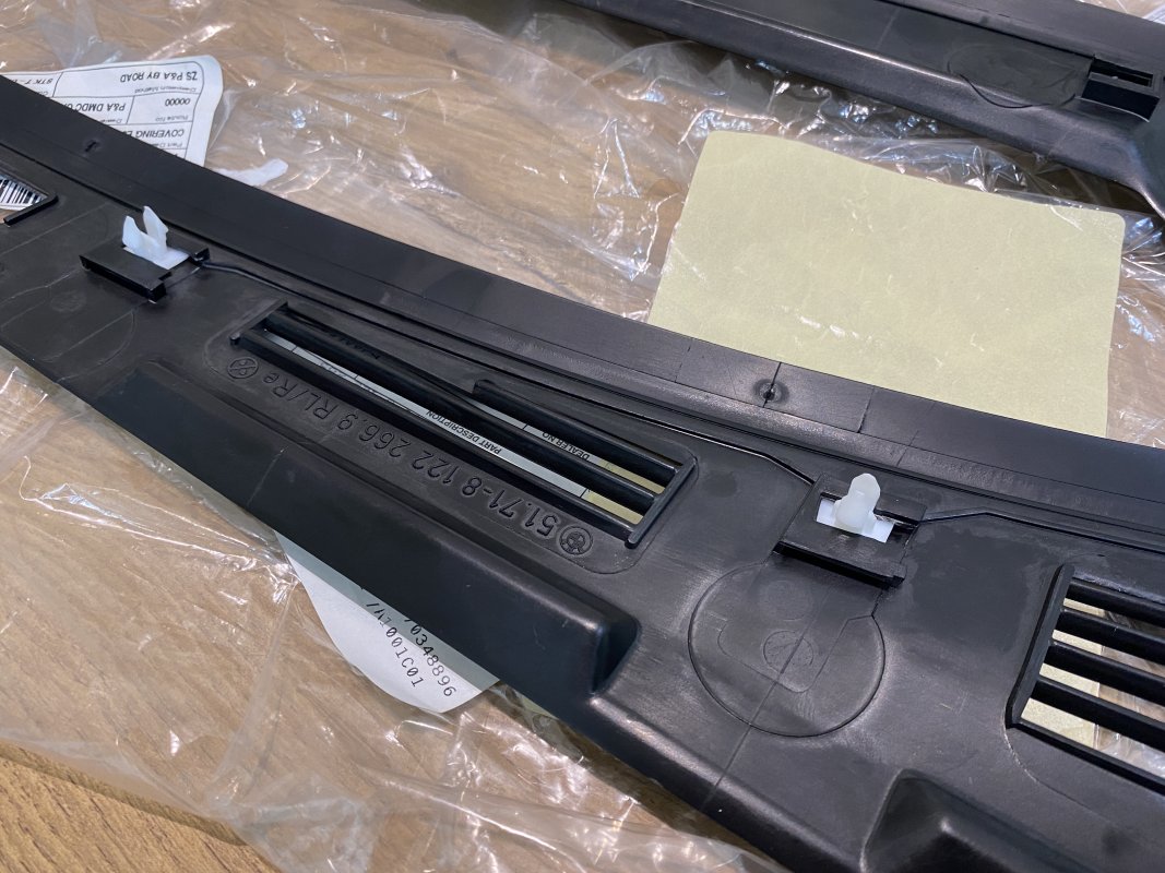

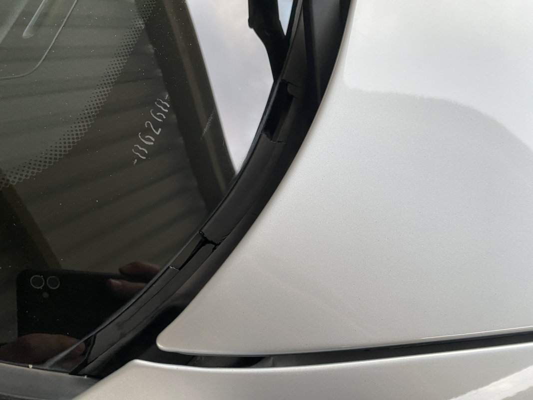

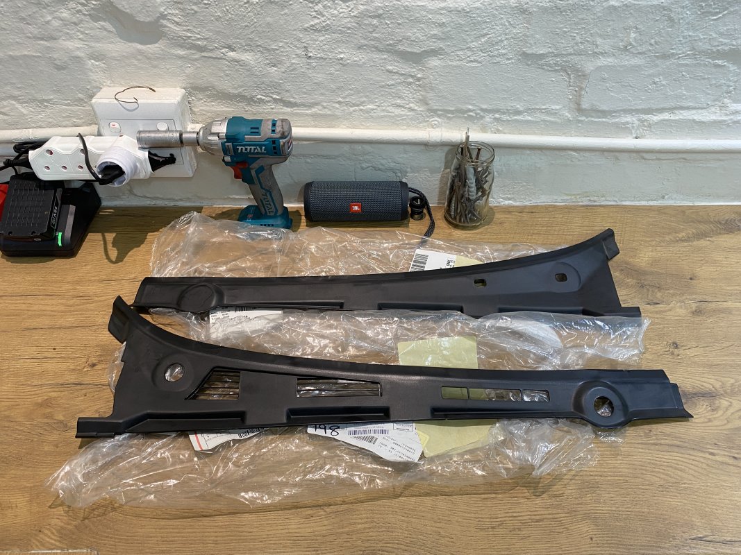

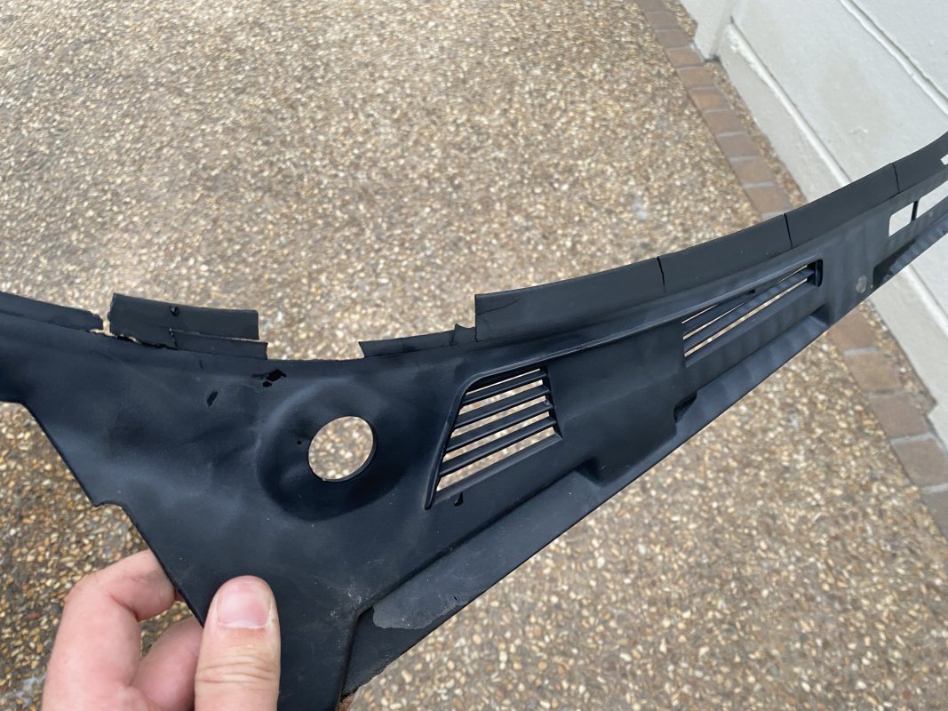

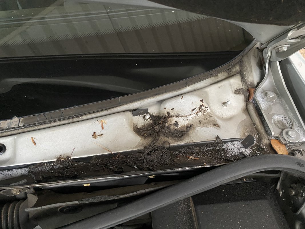

First thing to do was replace the rain tray covers, standard E36 things:
Disgusting. Cleaned everything out before fitting the new ones.

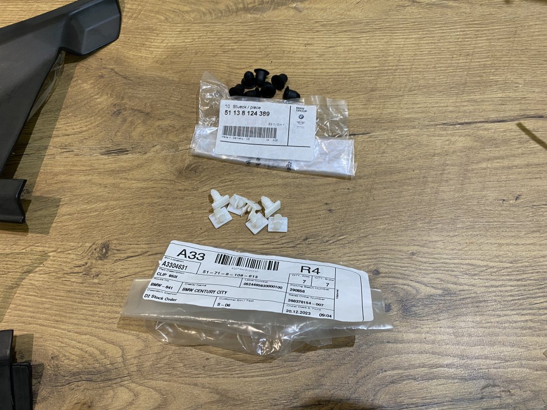

All the new bits, part numbers included for those that need to do the job

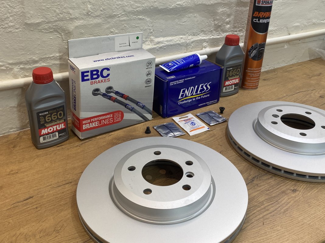

Then onto a bit of a bigger job, fitting the E46 330i front brakes:

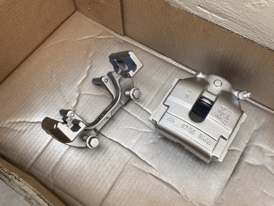

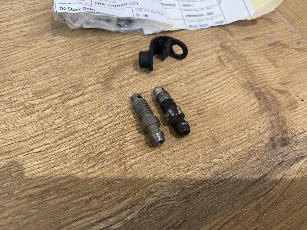

Cleaned and sprayed the calipers in a high temp OEM-looking finish, and replaced all the seals, bleed valves etc:

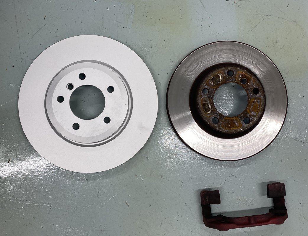

New 325mm vs old 294mm:

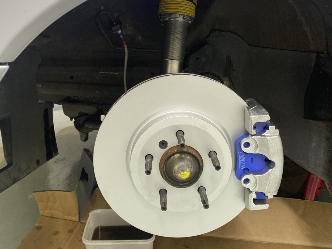

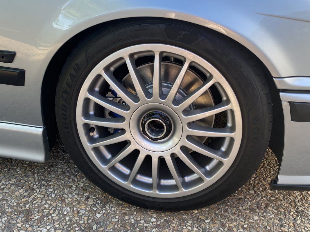

Fitted, along with the EBC stainless lines:

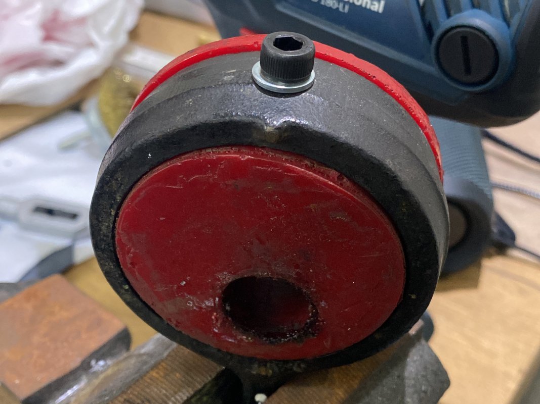

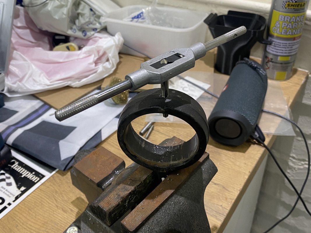

While I was down there, I got onto the job of putting set screws into the lower control arm brackets and bushings. I noticed that after pushing the car hard, the bushings were spinning inside the brackets, changing the caster from side to side. Quite a common problem apparently, and not ideal at all. So I drilled and tapped them to M6x1, and put some M6x20 cap screws in. Seems like its worked perfectly.

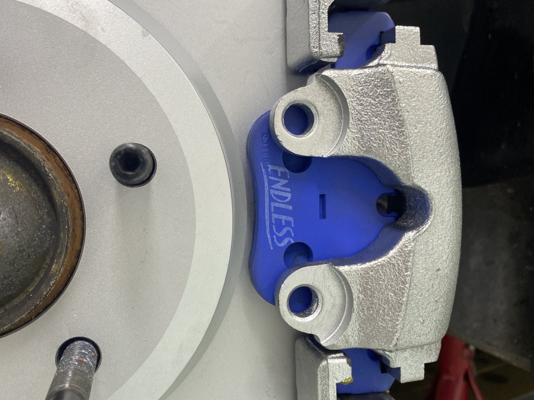

Then straight into testing with the first early run for the year! Did 100km or so of normal driving to get some heat cycles into the discs, before completing the Endless bedding process.
Was the brake upgrade worth it? VERY much so, especially if you want a "budget friendly" brake upgrade. The difference is extremely noticeable.
These Endless ME20 pads are ridiculous. They are quite aggressive for a street car, but they are so damn impressive. Zero fade, and the bite is awesome. I can go onto the brakes so much later, and they keep getting better with more heat. I am super impressed. What I lack in power compared to the cars I drive with, I now make up for in handling and braking which is great to see.
