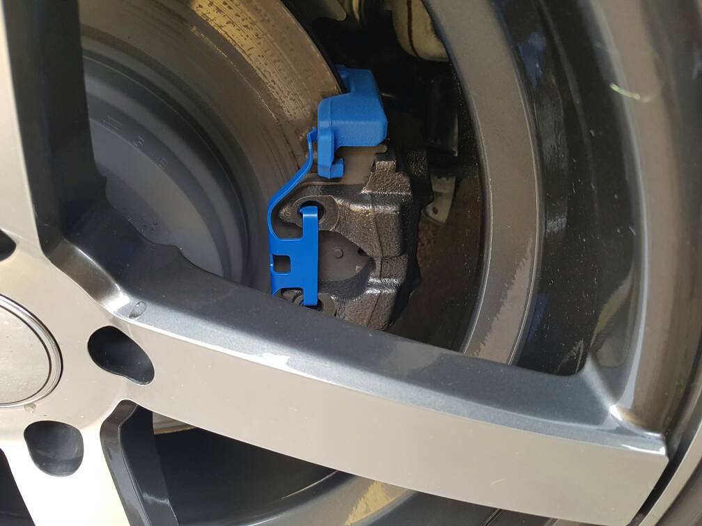

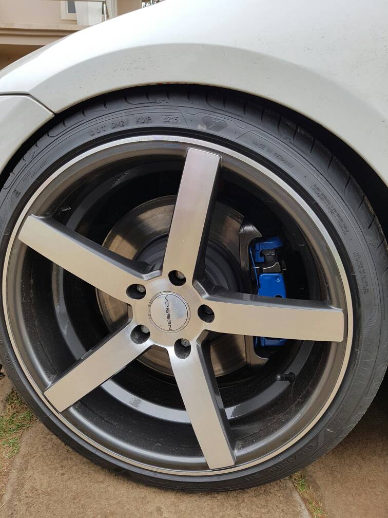

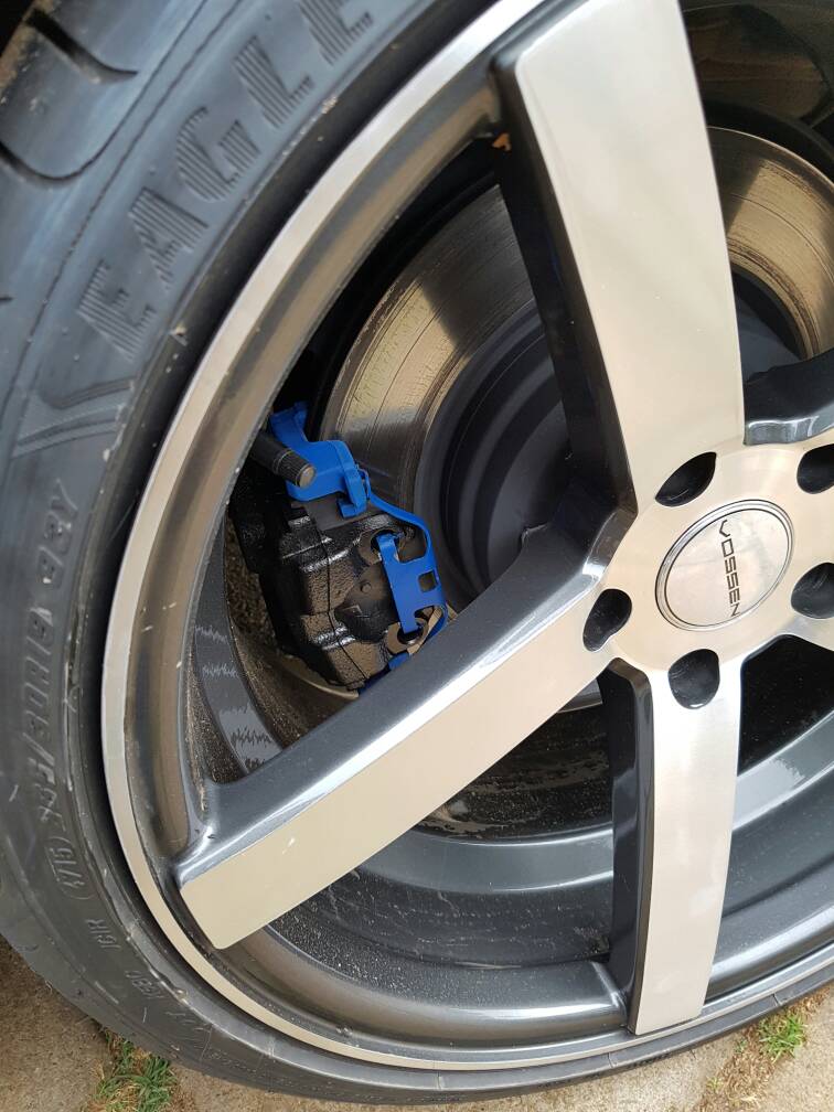

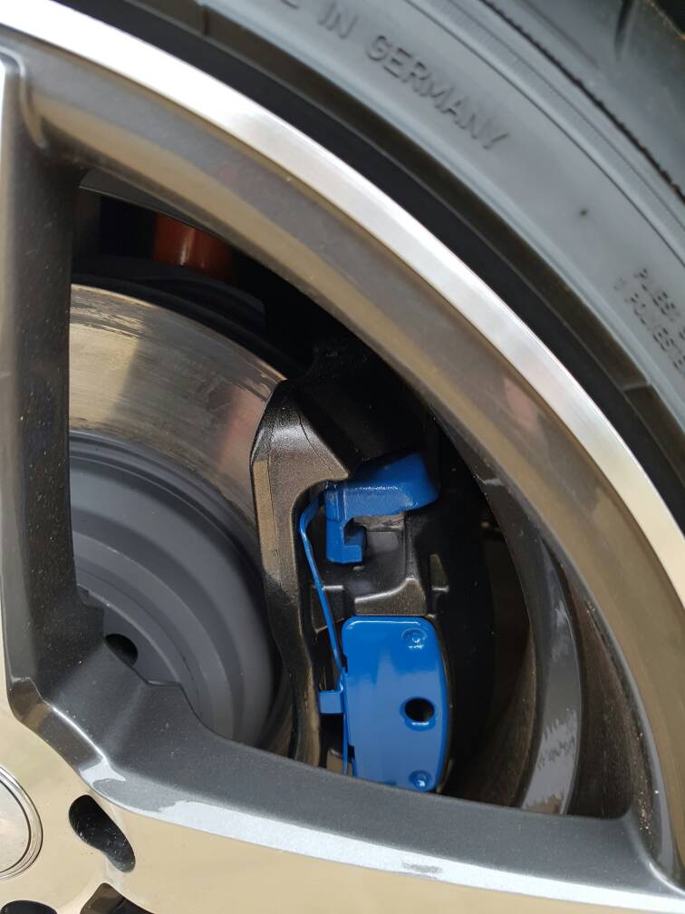

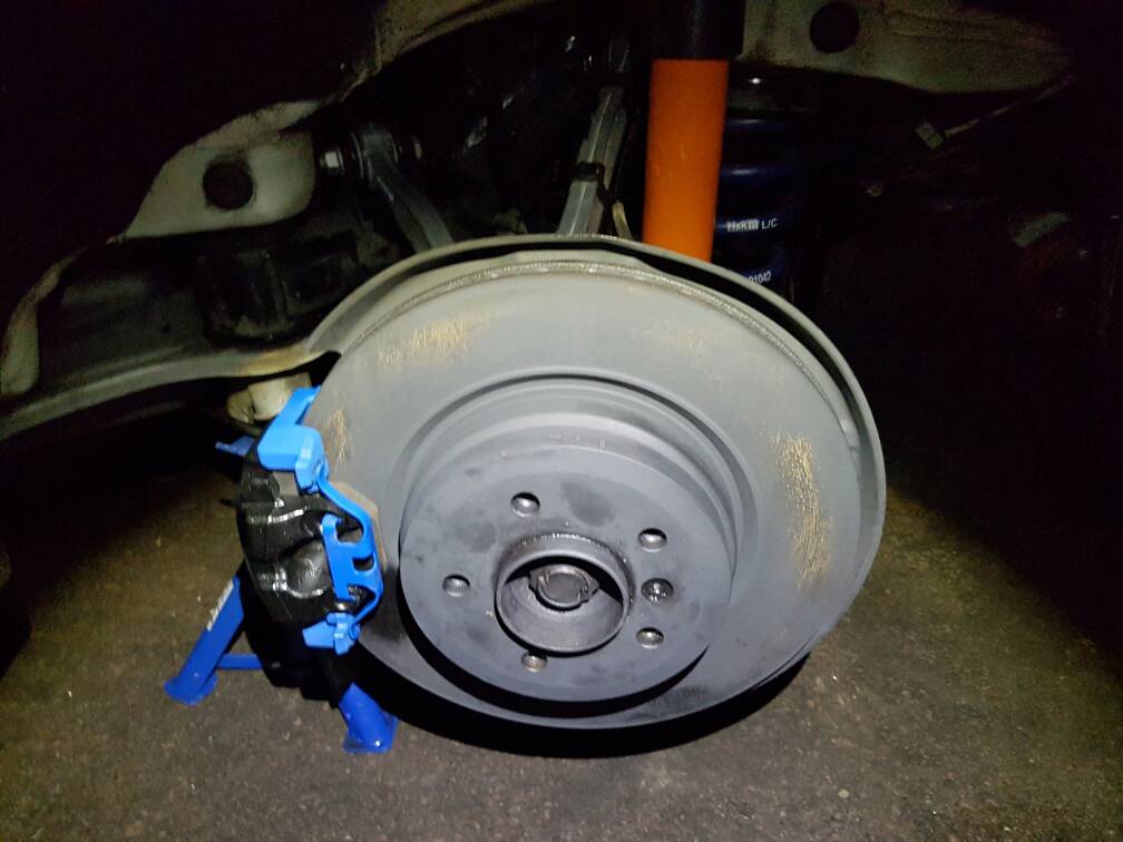

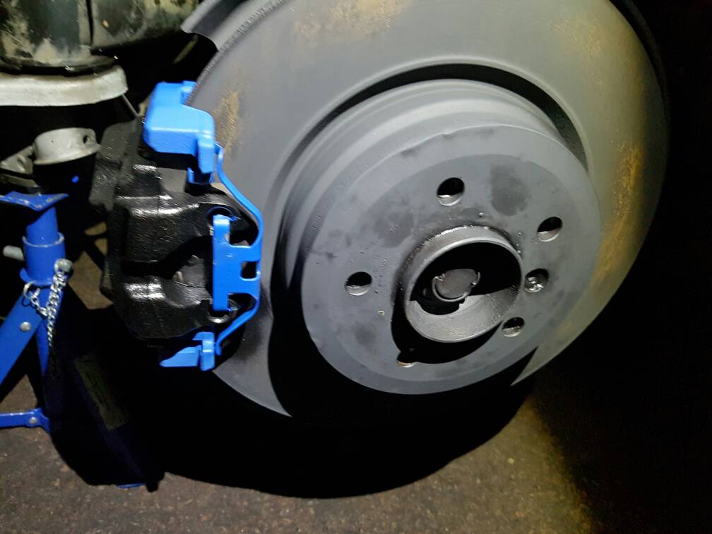

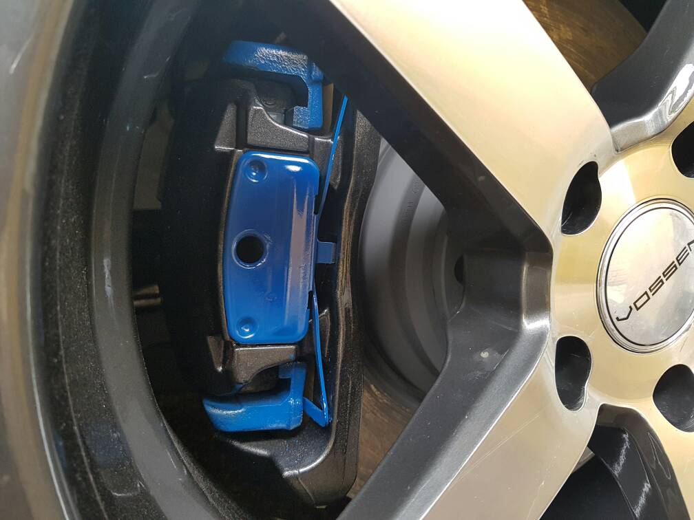

As with ownership of any car the process of modding to taste is never done, with the rims having been refurbished the brakes callipers and disc hats were looking a bit sad, the next bit was a to tidy that up but what could I do that would look good but not stand out to much? the thought process here was to do the rattle clips and caliper carrier in BMW blue while leaving the rest of the caliper in gloss metallic black and the disc hats in high heat matt black so they fade away into the background.
Step 1 was to strip the front brakes, get the rattle clips and carriers cleaned and primed. these were then washed and left to dry.
Step 2 was to clean the callipers with brake cleaner and dry. (I couldn't srip the brake line of as I didn't have suitable tools to press the brake pipe to keep the fluid inside.
Step 3 was the spray work which wasn't to bad for a rattle can. The paint went on evenly without running and the finish was good. the only thing I battled with was getting it to dry quick enough in the winter cold.
Step 4 was the calliper which was a little harder inside the wheel well and still connected but I managed to mask of everything that would show overspray.
Step 5 was very carful reassembly.
Overall I am happy with the finish but there are a few things niggling me. Firstly the rattle cans are enamel based paints which while they offer a good finish, they aren't very resilient to impacts and scratches from removal and refit. Secondly the E90 range of calipers have a very rough finish to them unlike the F30 M sport which are machined smooth and hence finish very well when painted.
Ideas are being formulated on how to tackle version 2 of this mod...
