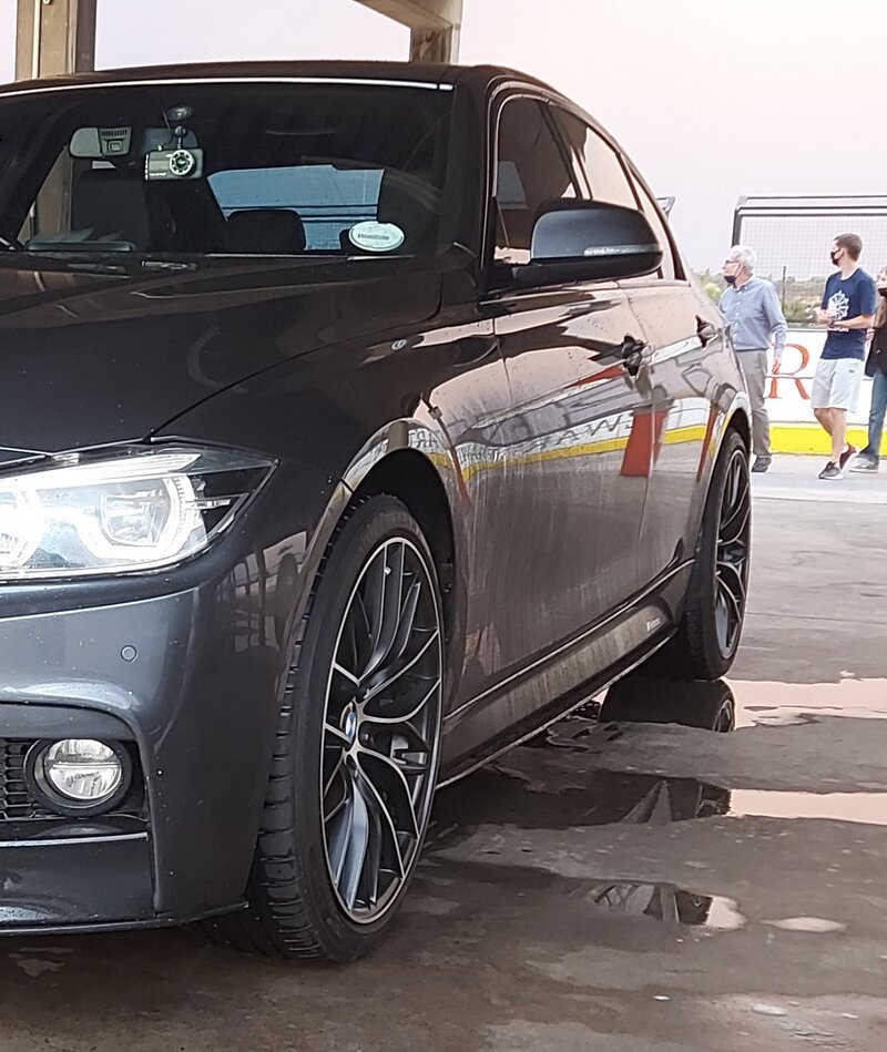

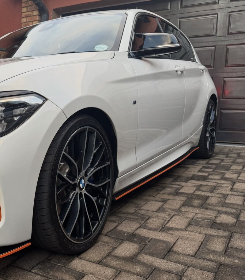

These might be fake, not 100% sure...

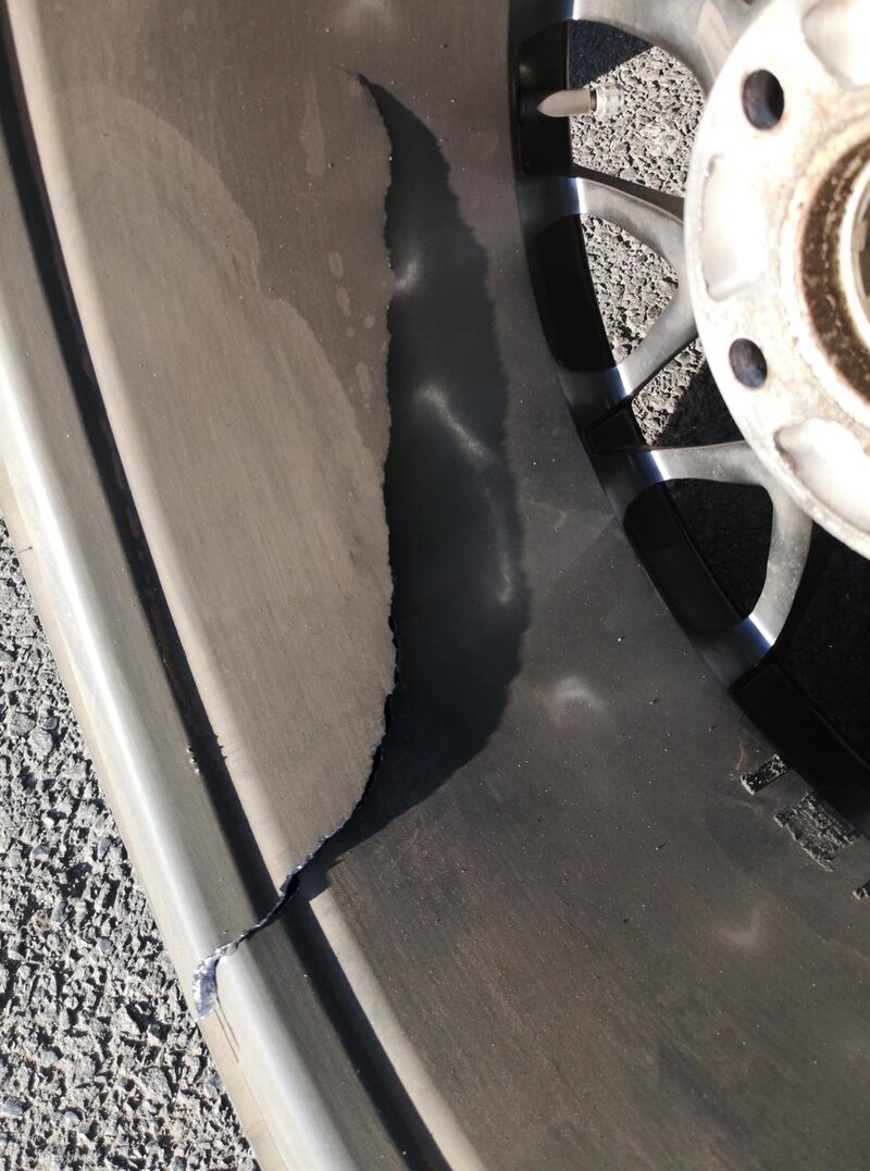

From my experience...the most likely way to spot rep 405's is the offset. The reps have a more negative offset (the rim sits further out). I had reps on my F30 and there was no need for spacers for example. I've got OEM 405's on the 140...and I could do with some spacers. And then you can also check part numbers inside the rim. The reps cracked in half from a pothole...
OEM
Reps
Rep
