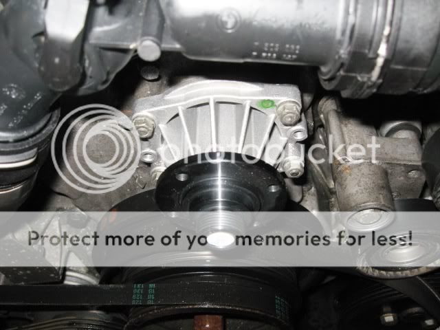

2. Water pump
Another common problem for e46's. These also leak from the bottom of the housing and are hard to see taking a quick glance. Alot of times the fan on automatic cars have to come out to be able to see the leak. Be careful and like I said above, make sure its not the thermostat leaking down over the water pump.
Part number needed:
Water pump: 11-51-7-527-910
