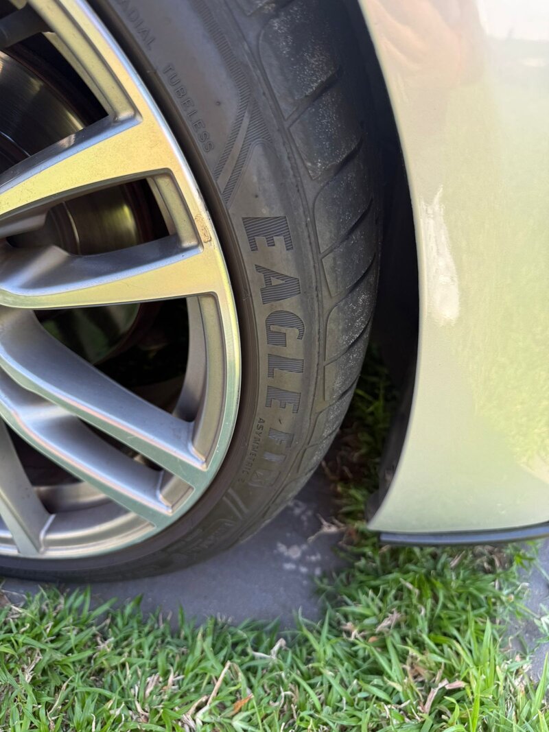

Think I may have spoke a bit too soon regarding being problem free.
This morning on my way to work, I noticed a hissing sound from the car. When I got to my office, I noticed there was a slight bump on the side wall of my front driver's side tire.
Its not that big of a bubble, but with things like this, its best to get them replaced early before we end up having regrets at a later stage. The sad part is that these tires have done less than 6000kms and there's plenty of thread left, but we gotta do what we gotta do I guess.
I had that happen to me after hitting a pot hole on my way down with my move and after having to replace the left front tire. both fronts were new so only replaced the one. Only realised the back left had a bubble some time after arriving in Cape Town. Had to replace both rears, but fortunately they were not far from the mark
