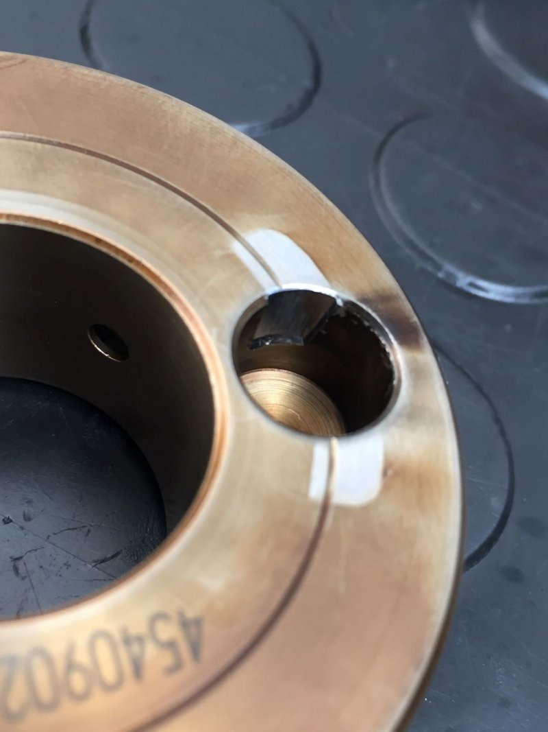

Car update! The car has been with Garage 808 for the better part of 5 weeks now. The vanos system did show some wear. Heres some pics of the wear sent through to me:
Stripped vanos unit:
Guide rail wear:
Oil pump disk wear:

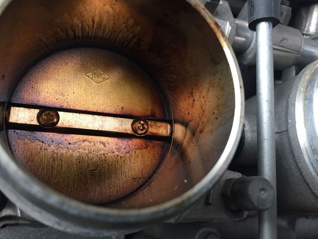

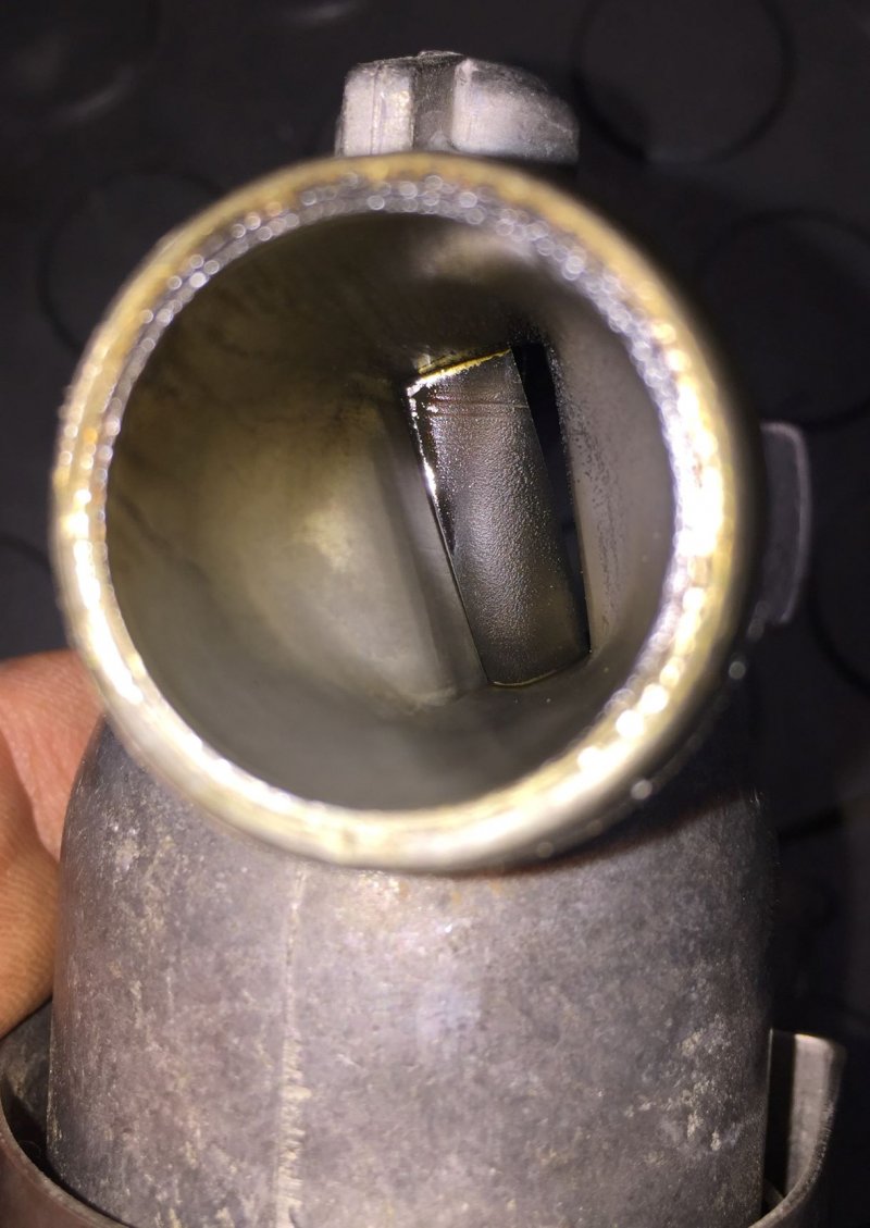

I would have the car back by now, but last minute asked them to strip the intake and clean the idle control valve and throttle bodies. Pretty happy that I decided to do this, because from the looks of things they really needed it.
The reason I opted for this was because I had noticed a slight hesitation on throttle response at the beginning of the rev-range. Initially I thought the hesitation may have been caused by the vanos, but after some research I found that it is often caused by oil build up on the ICV and throttle bodies. Decided to get these all done at the same time without testing so we're covering all grounds from the outset.
ICV before and after:
Before:
After:
Throttle bodies before and after:
Before:
After:

Again, to point out, this is what the wear on an engine with 111k kms looks like - obviously all cars are treated different over the years, but it might help someone know what to expect! Preventative maintenance is NB.

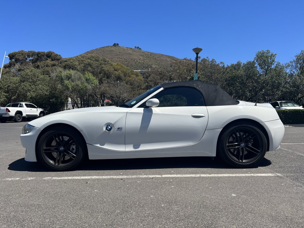

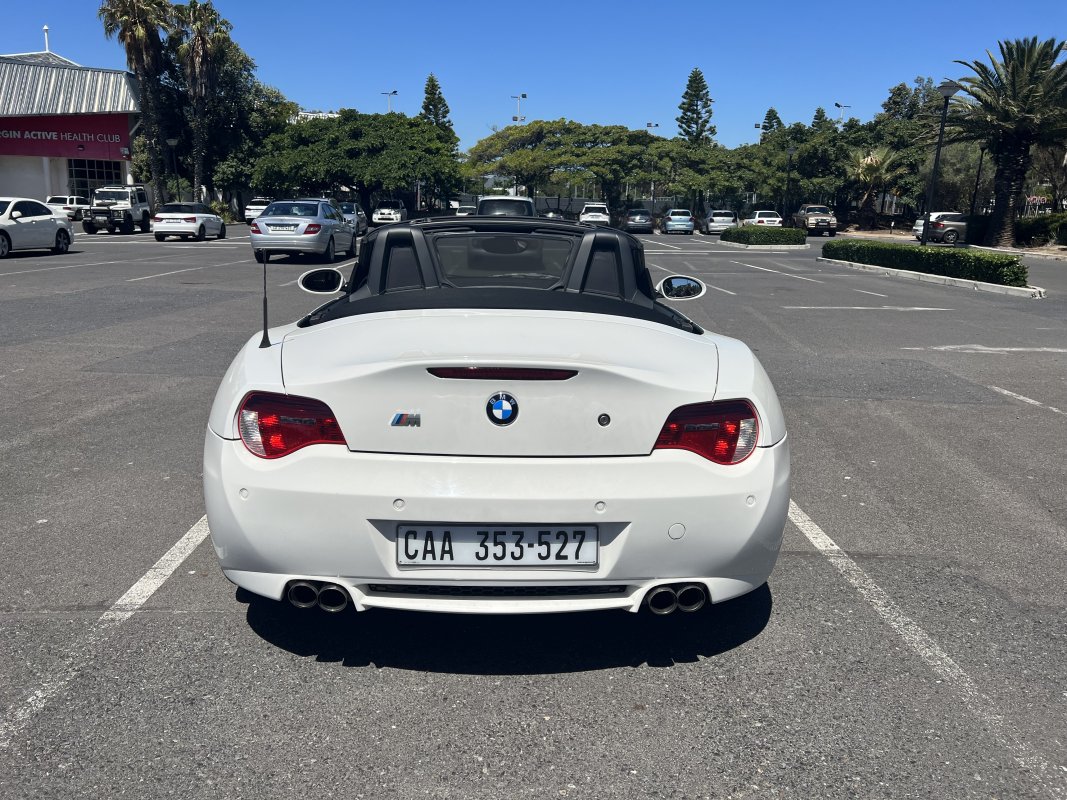

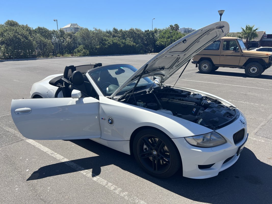

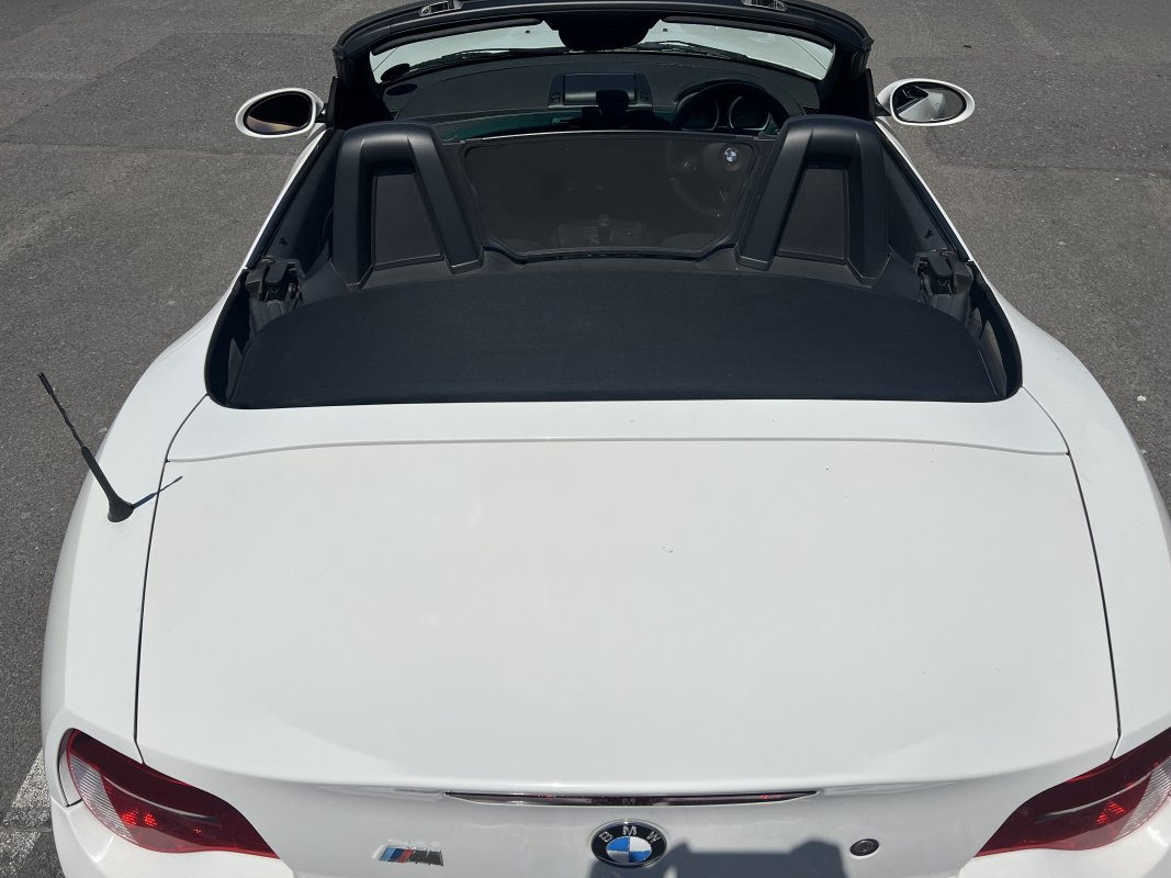

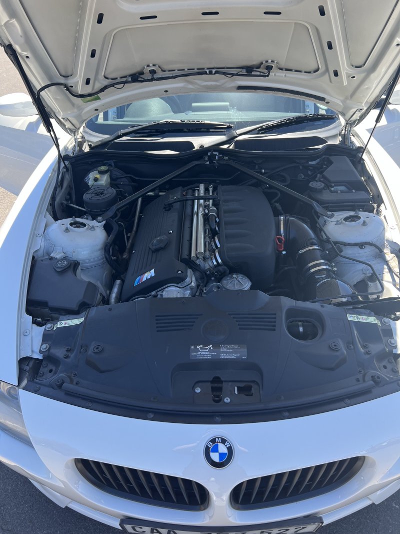

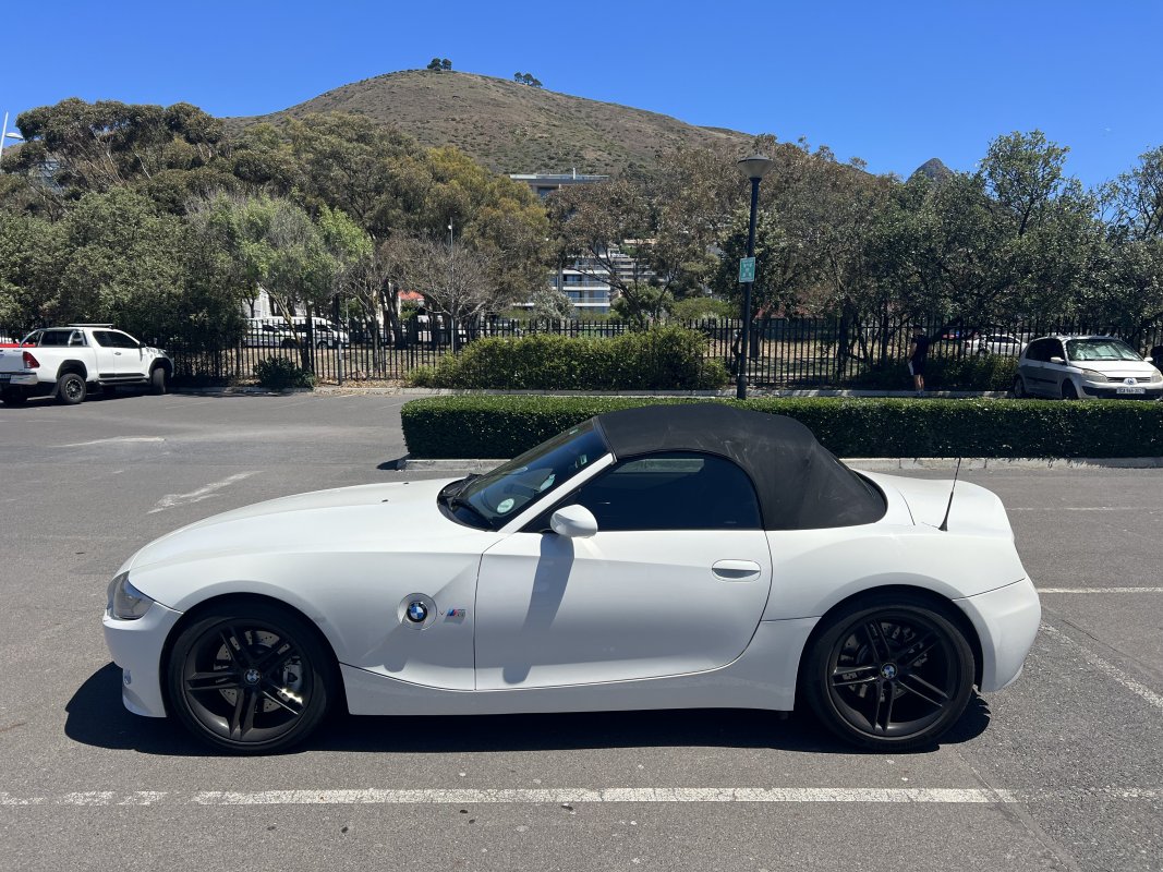

Afternoon everyone! Managed to take a few pictures this afternoon.
Here are a few to get the blood flowing. I have many more - if anyone needs anything else, feel free to get in contact with me and I'll send more through.
