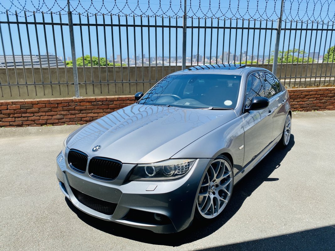

Very nice work and congrats on the Vehicle, looks great,
Such a pity the DCT only found its way into the E92 and the LCi E82, would of been a great addition to the E90 IMO.
Enjoy the car and well done on tackling the Carbon Clean yourself.

Thanks bud,
That would have been quite cool, in this case I specifically wanted a manual though 😁

Congrats on the car
You scored on the spec too
And the sound system
