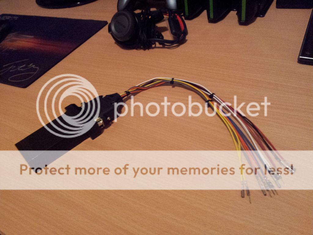

One item in particular is the BMS PowerBox :
BurgerTuning Website for more details.

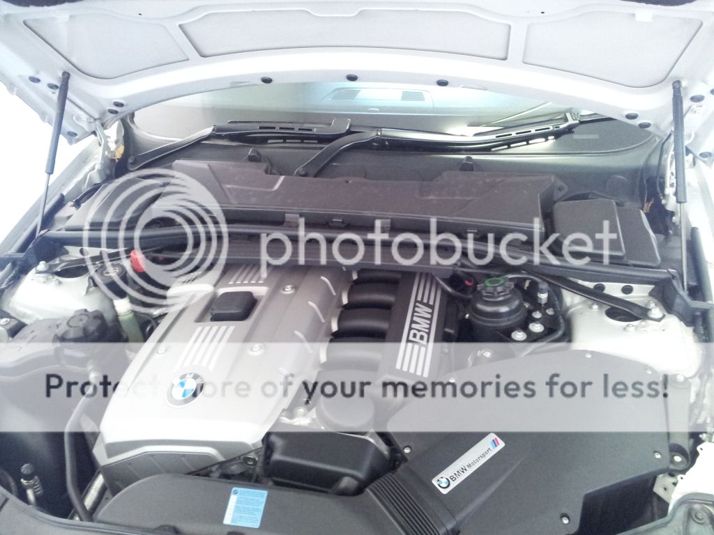

Started off with the bare motor :

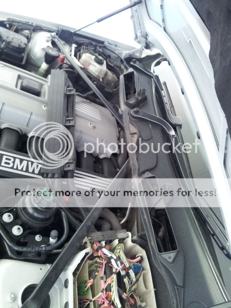

Had to strip some items off :

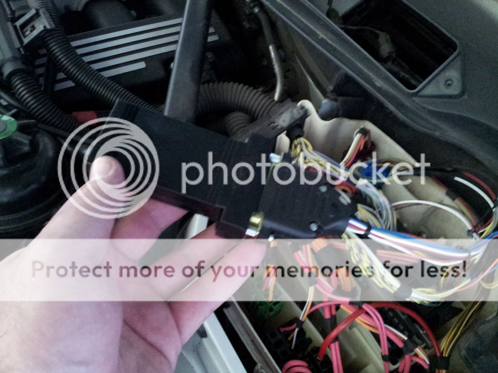

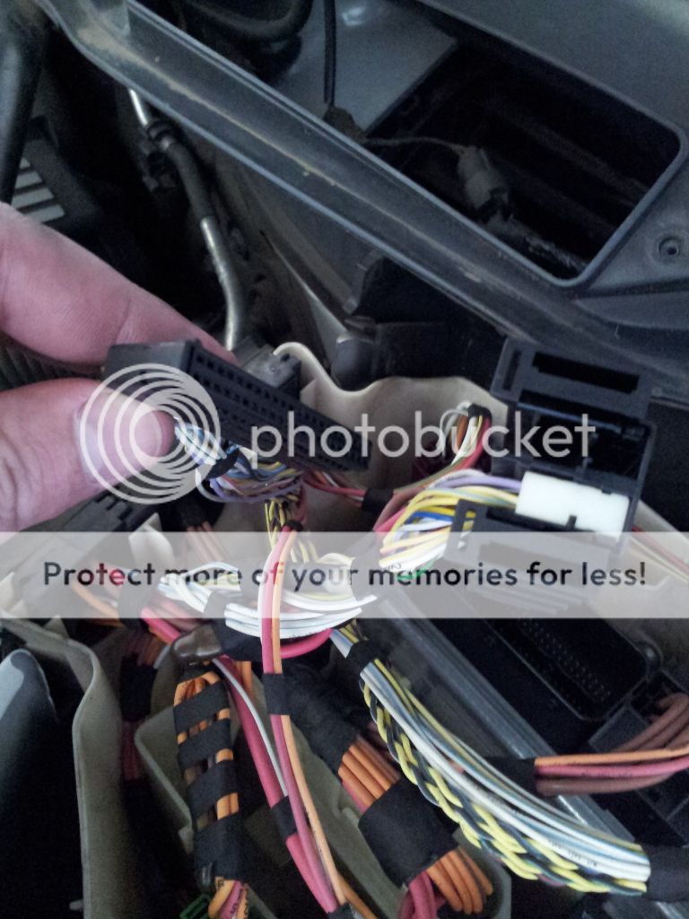

Then you get to the brains of your car :
This is the scary part where you have to remove plugs and wires and reconnect and and and...

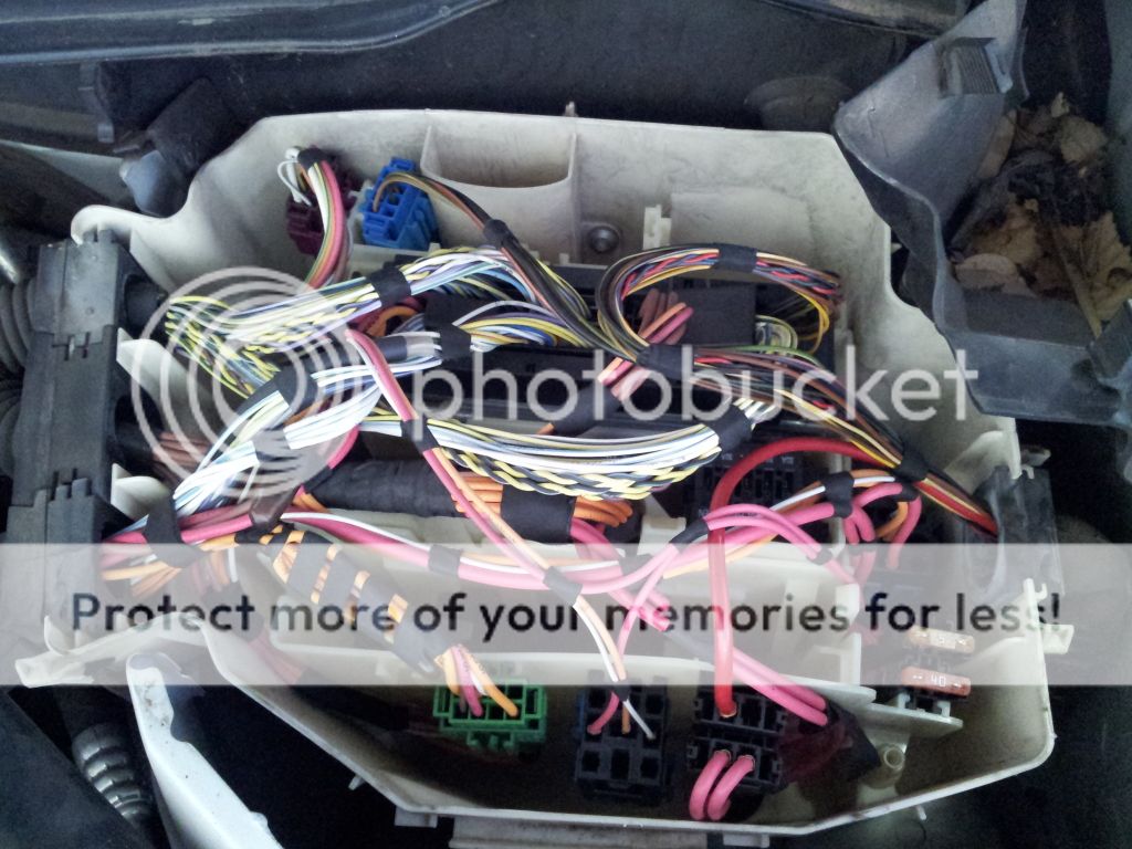

And eventually end up with this bugger installed :
Thankfully the car started after the install and immediately seemed to rev much better!
