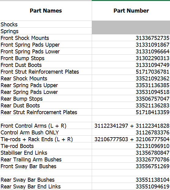

A long anticipated update.. With the 320d having gone on to a new home, I am looking forward to giving the 330i some attention.. I have finally procured ALL my suspension parts after starting this journey a year ago.. Thanks to everyone that chimed in and shared feedback on my other thread
HERE, the advice has been invaluable.
I decided to go for the traditional set up of a shock and spring combo, whilst refreshing all the other associated components. My thought process was to look for OE or better critical components, where I couldn't find a brand I was sure of, I opted to buy these bits from the agents. Hopefully the breakdown below can help anyone looking for suspension guidance on their Sport Pack E46's. One can really go down the rabbit hole when it comes to work like this.. I have finally tallied up the costs and the grand total is a shade over R30k, just for the components listed below..
I am keen to get all these parts on the car and then go for a proper hoon... Update to follow once I've had these fitted in the coming weeks.
