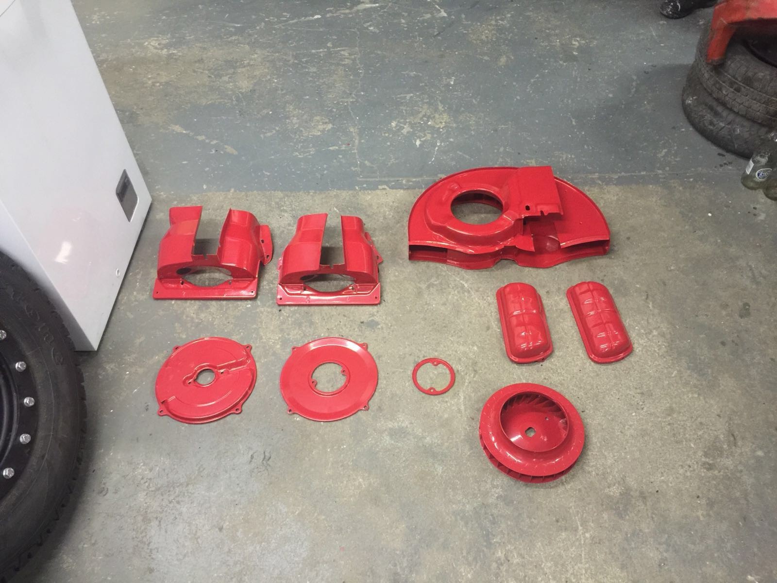

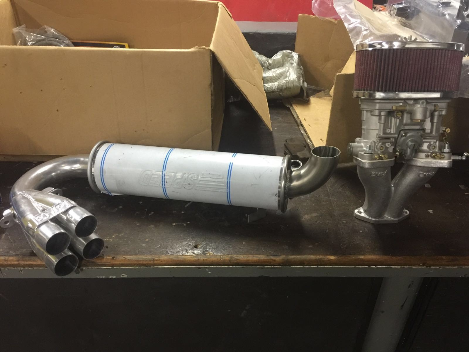

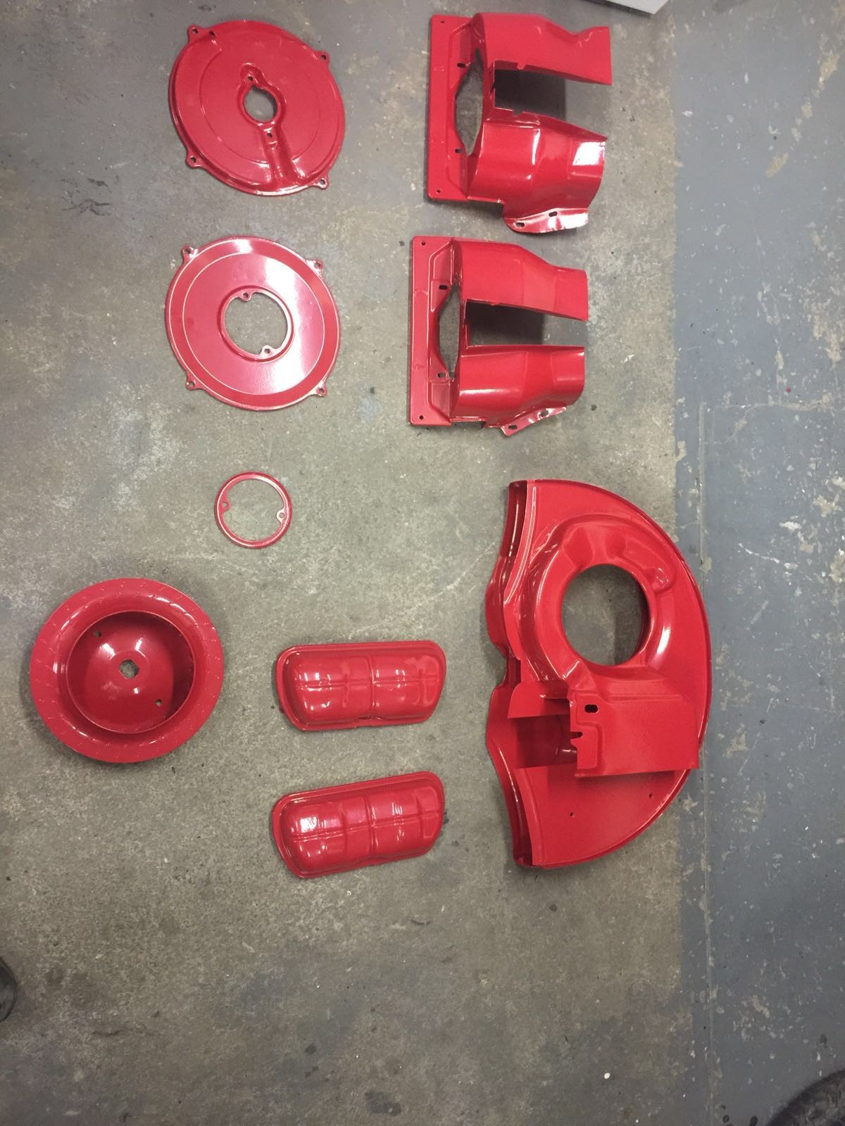

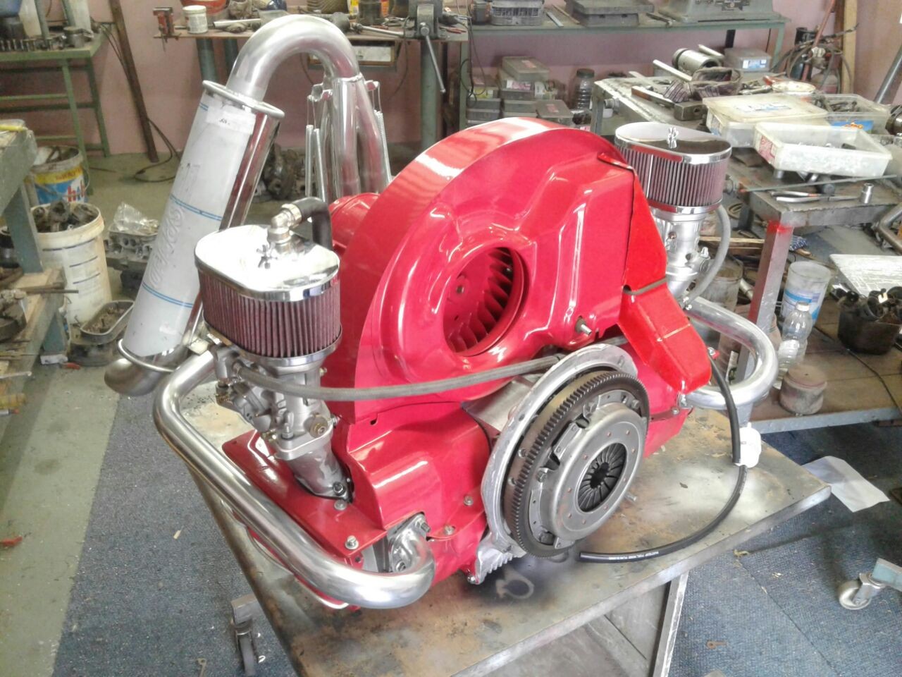

Engine parts delectably sprayed, a bit of exhaust and some carbs... Sounds like a recipe for success!

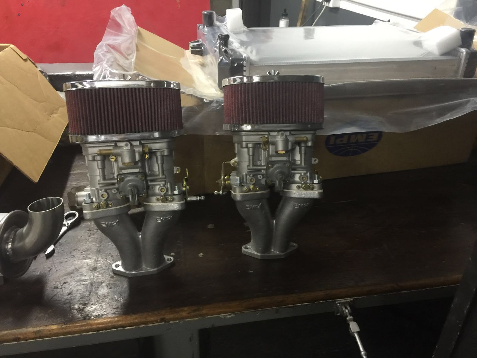

herr bmw
1835 ??????
twin 36 carbs ?????
empi oil cooler ????
gonna be one hell of a nice motor,reminds me of my first beetle
scunick
herr bmw said:
1835 ??????
twin 36 carbs ?????
1914.....

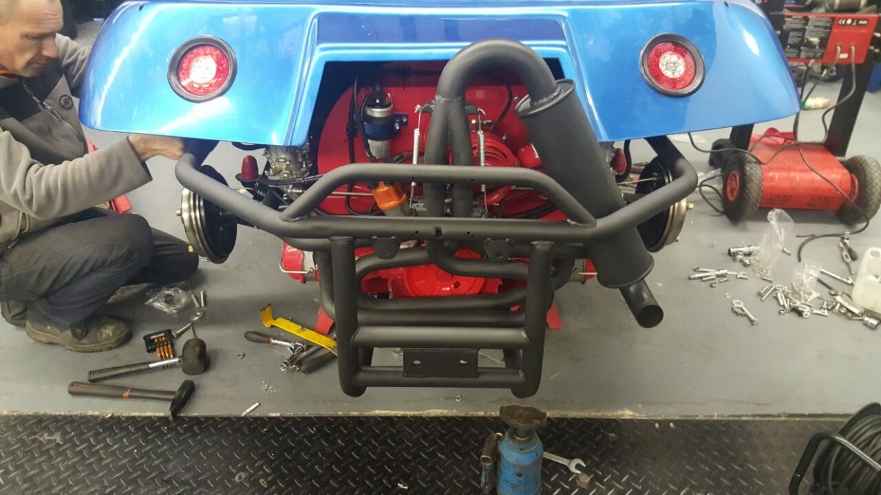

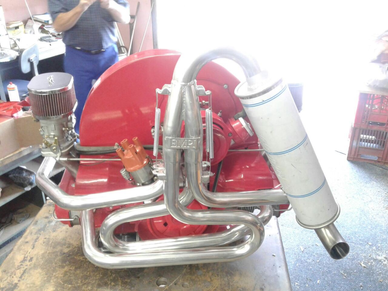

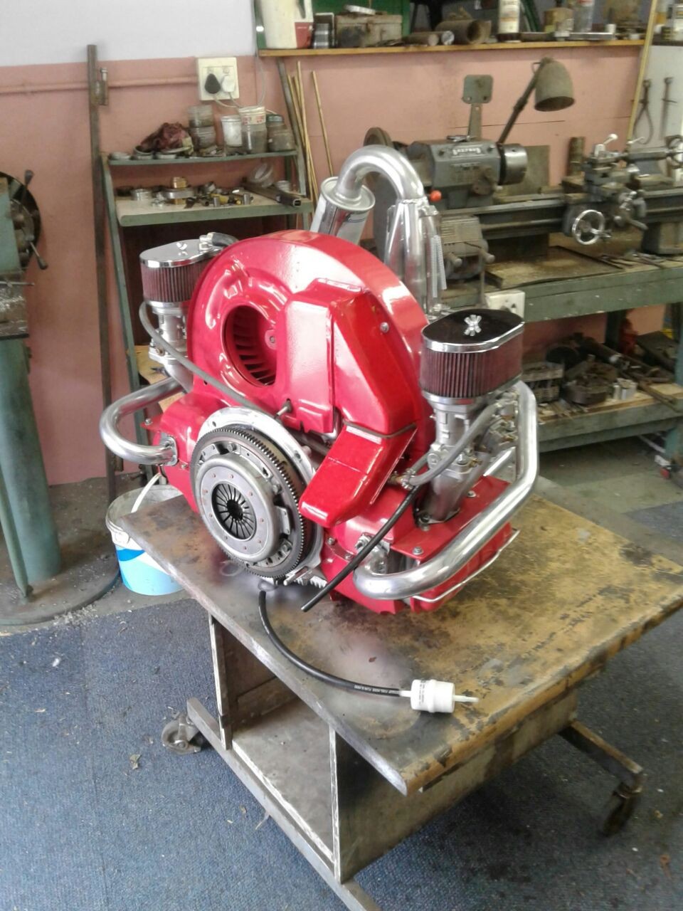

Take a look at this beauty - a 1914 (originally 1600) stroker with twin Weber downdrafts :blowheart::blowheart::blowheart:

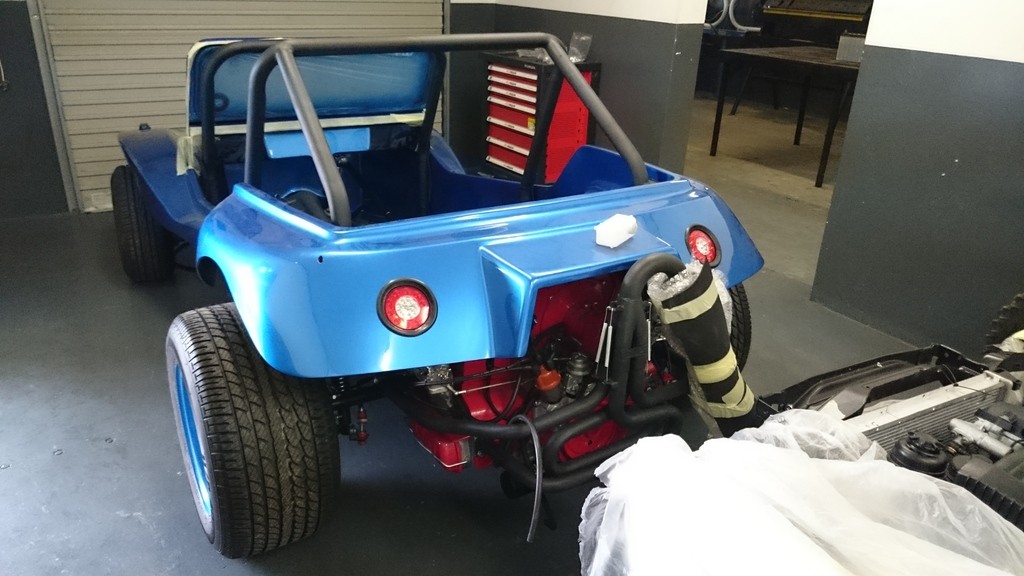

The final stages of this build are underway and the excitement to have it up and running is growing ever so speedily :rollsmile::rollsmile::rollsmile:
MaverickWRX
damn this brings back memories
I had a 1776cc with the following
69mm polished crank
engle 110 cam
solid rocker shafts
044 cylinder heads
36 DRLA Dellorto twin carbs
18 row oil cooler
Holley fuel pump and FPR
Bosch 009 Dizzy and screamer coil
Man i miss my bug

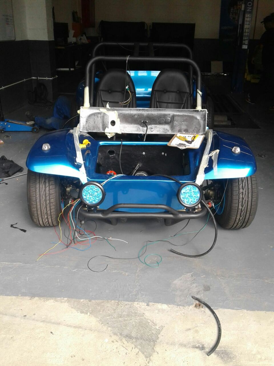

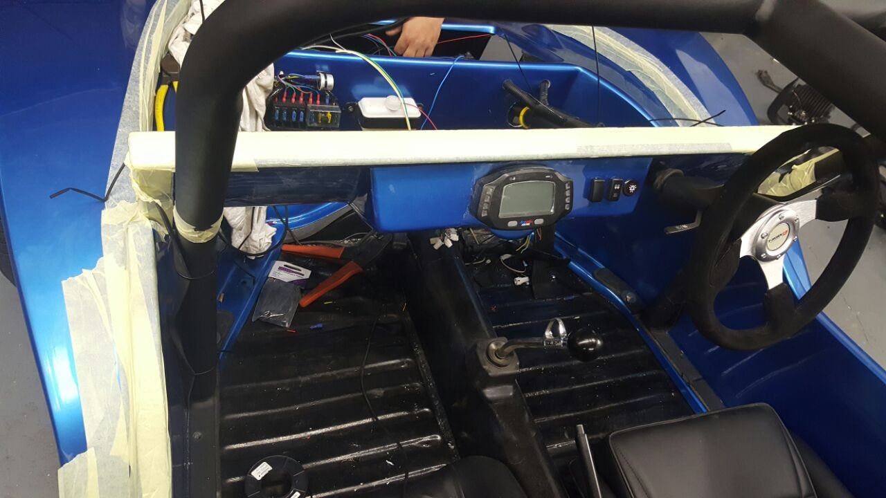

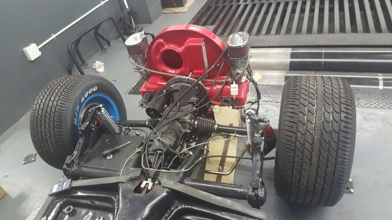

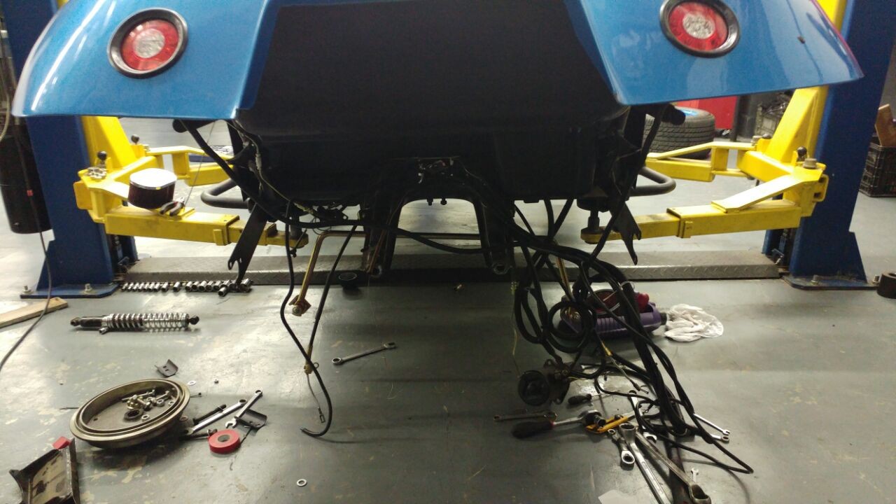

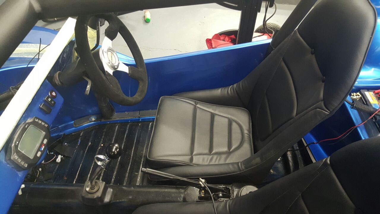

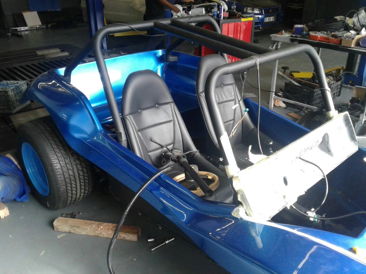

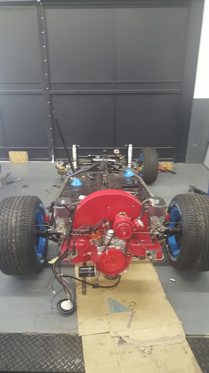

Some more progress on the Buggy build :rollsmile:
All wiring almost done, then onto final assembly and suspension setup, and then time to run in!

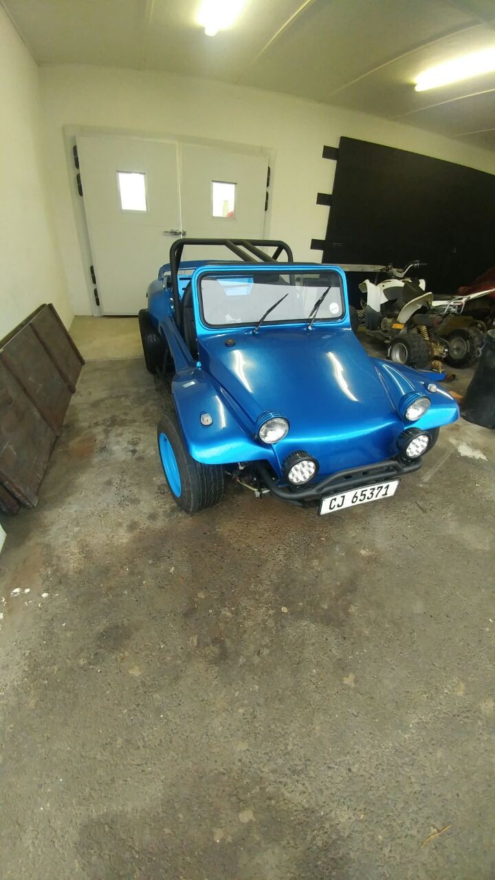

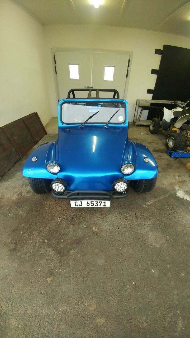

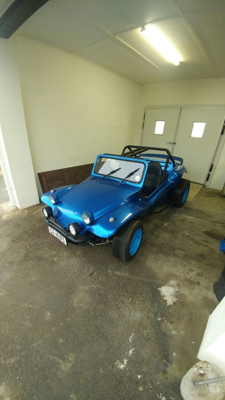

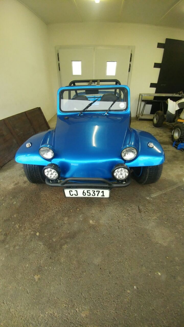

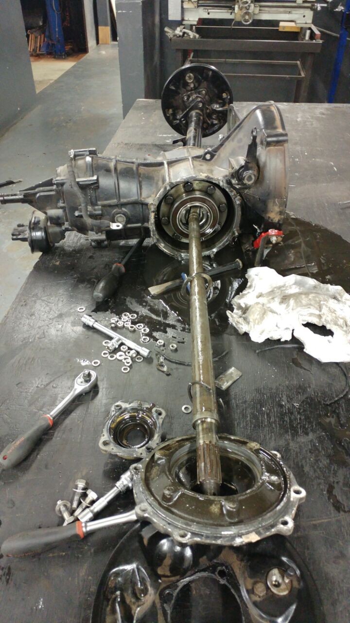

The buggy build hit a snag with the gearbox, however all is well :=):
GoCart
I am pretty sure this little masterpiece is zooming about already, show us the finished product :skit:
