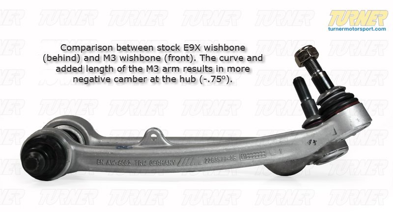

Lower Control arms
Stock
- Shorter length than m3 for reduced camber, mounts to subframe via bushing
///M3 - Longer component this increases the negative camber, mounts to subframe via a ball joint!
Here is an illustration courtesy of turner motorsport, notice the end that connects to the subframe is actually a ball joint.
control_arms_E9X-M3-CONTROL-ARM-UPGRADE_m3_E9X_control_arm_wishbone_comparison (1).jpg
The claim here is that you get vastly better steering feel with this mod. I happened to land a set of these for cheap from a junkyard, and they are in stellar condition. More than anything I'm hella curious about the improved handling claims, not that I have any qualms with how the car rides currently.

Supposedly These changes are because of the negative camber, makes sense that alignment is a must after install.

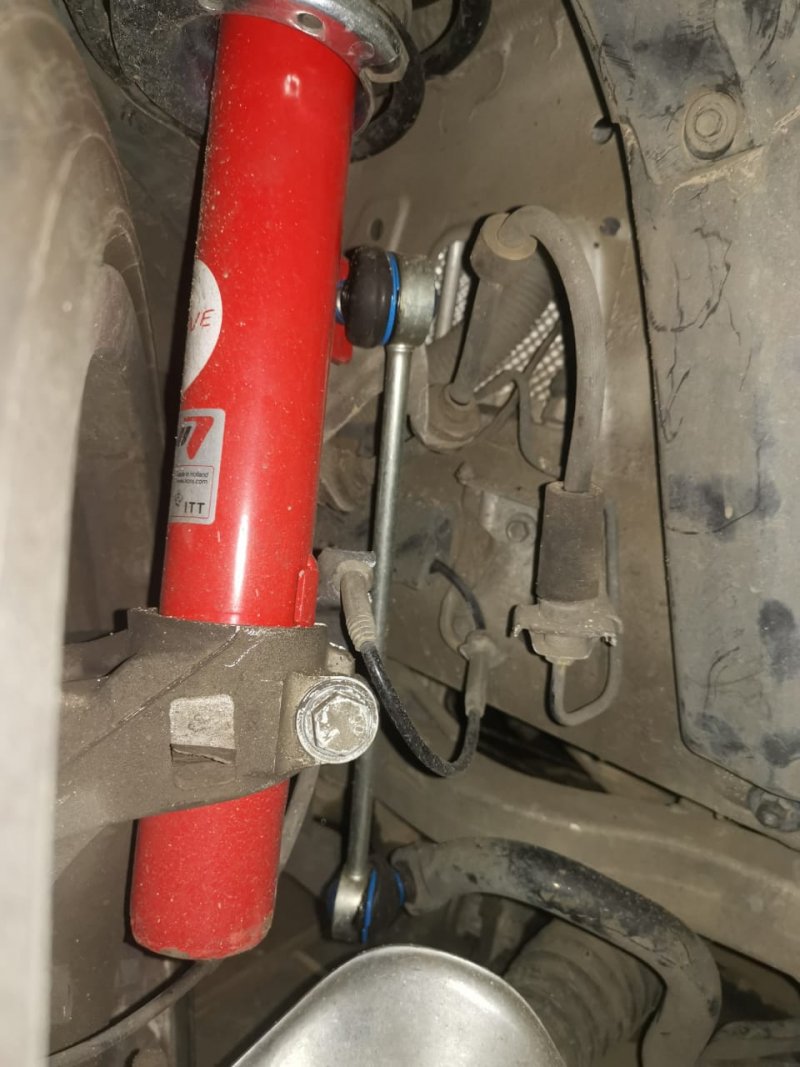

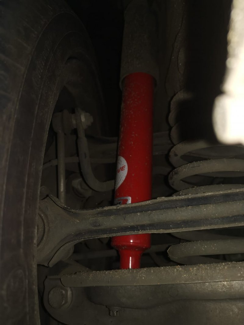

I'm not a mechanic by trade and working on cars is a hobby, I tackle all repair jobs myself, no matter how big. I hate being taken for a ride by service techs. These control arms will be going on my e90 323 with the standard suspension. The Car is bone stock except for the Meyle HD tension arms, stabilizer links and Koni special active shock absorbers that I fitted a few weeks ago.
The tyre setup is 255/40/17 rear and 225/45/17 front, continental contisport contact 2 SSR on style 192m rims
The Ride
Current setup front
setup rear
BTW thus far this setup has been amazing for the price, the special active shocks have a sort of variable damping which is entirely mechanical. For anyone interested I got them here https://www.bimmer-diyshop.co.za/
