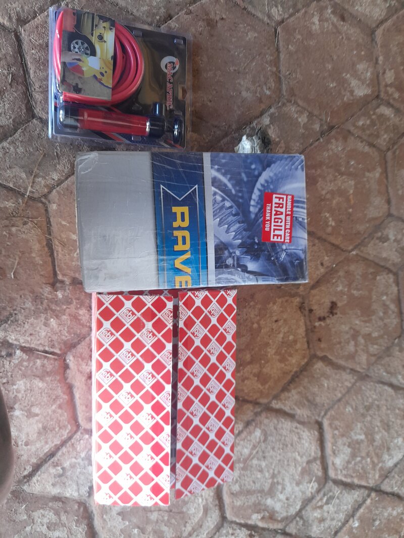

I purchased the oil (ravenol 5/4hp), filter and gasket (Febi).

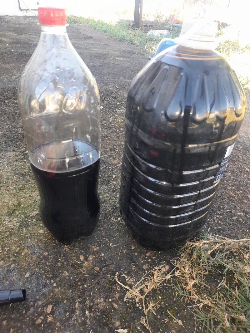

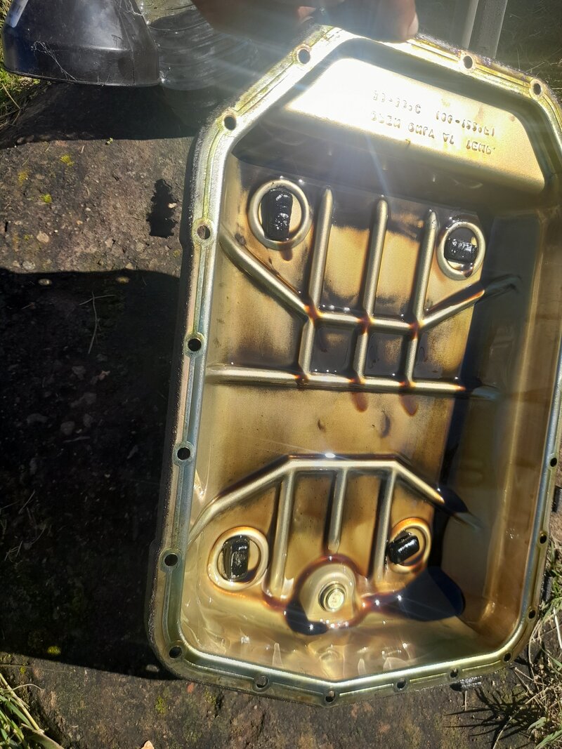

I started the job and just after cracking the sump bolt I had to attend to something else, leaving the oil draining overnight (6is liters). What came out was black oil which didn't stink at all as other forums state. (A glimmer of hope as I thought the oil/filter had been done before).
Filter removed was a Filtran dated 20 Feb 2002. the fear of not having a driving car at this point was at peak.

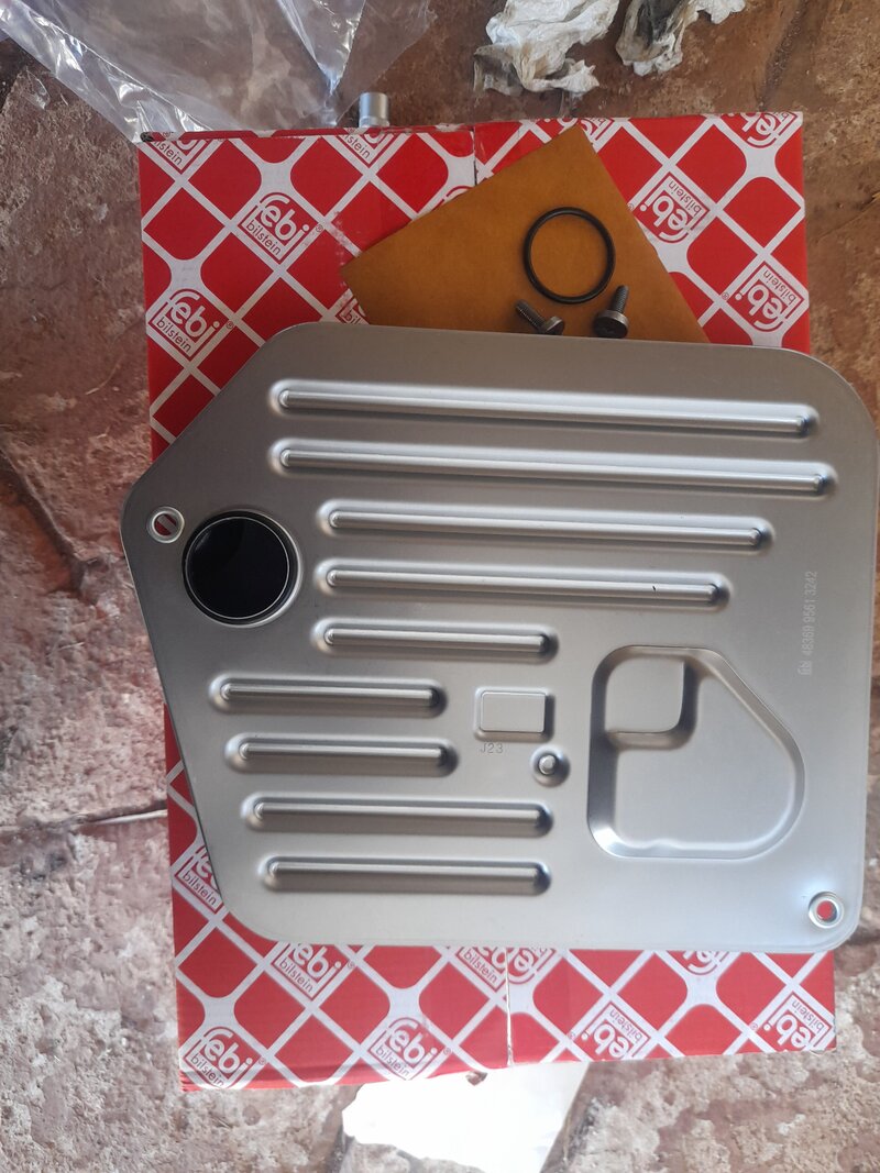

The new filter came with a gasket, filter screws and two O rings, one already installed on the filter.
