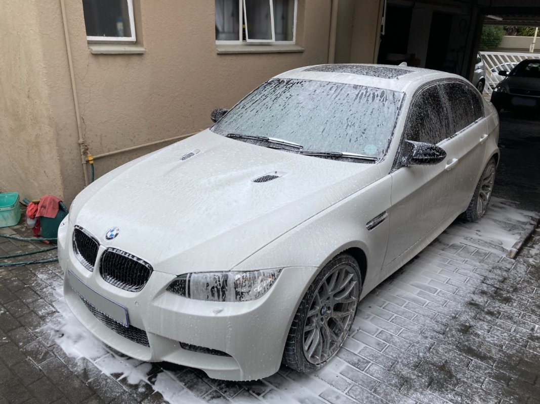

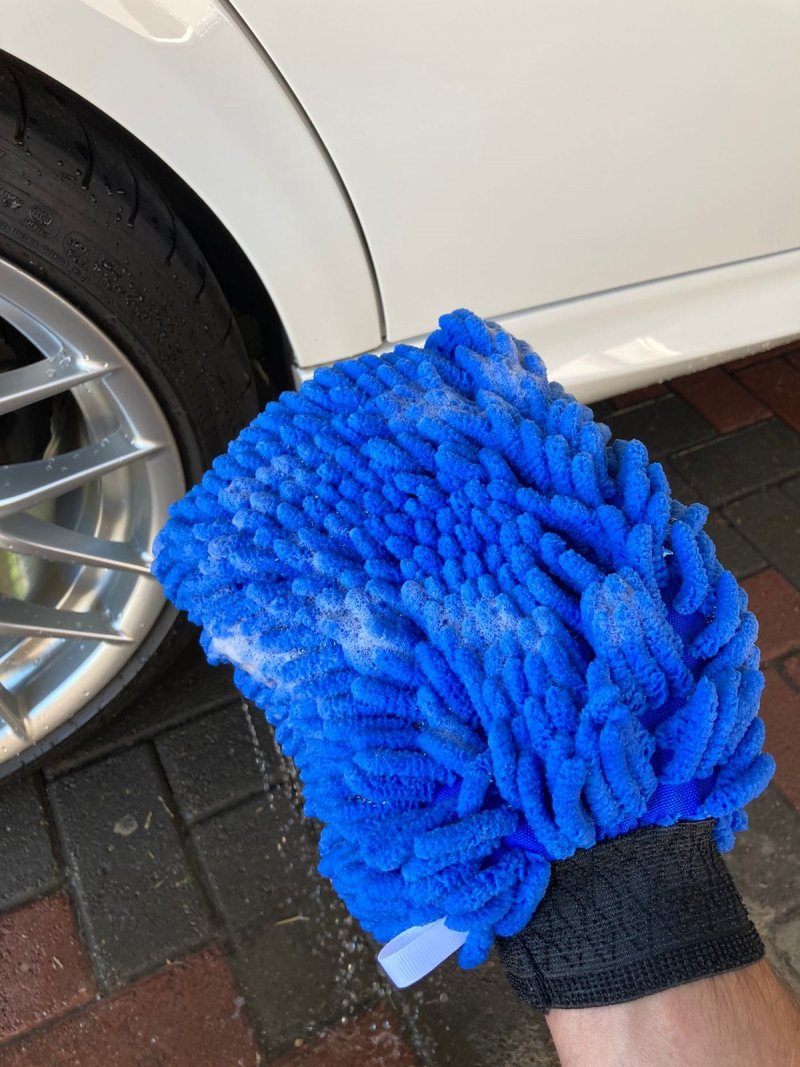

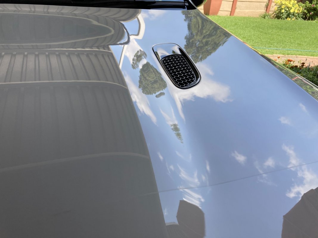

Update: Mar-21:
In line with my other threads, I've been using a couple of new and different Detailing and Auto Care products on the various cars. One of them which I was curious about is the Meguiar's Hybrid Ceramic Wax. I'm pretty happy with there usual Wax products, so was keen to see if the "Ceramic" content makes any difference. (Detailed reviews will be published in seperate threads.
Here's the results after the initial main coat 2 weeks prior, and then the top up coat after a subsequent wash:
Moving along, in one of my early reviews of the car, I likened it to J Lo, sexy with some hips going. I'd like to extend this analogy a little further, in that this car requires as much fuss to keep happy, as the fuss it creates when out and about, lol.

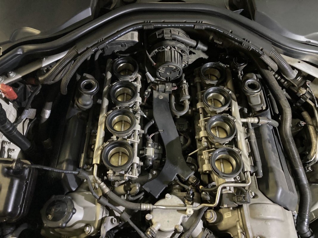

I previously reported about an intermittent miss on cold starts, which went away after about 2mins of idling. Scanning the car pointed to a possible faulty temperature sensor which sits on top of the water pump housing. One day some time was available, so I removed the airbox and intake plenum to get to the said sensor. To my surprise, I found that the harness clip was not securely attached to the sensor. I sprayed some electrical cleaner on both ends, and after securing the plug, started the car and it was sorted. The cold start sequence now is also completely different than before (previously it would start and rev up to 2000rpm, before settling into an idle around 800rpm). Now, the cold start briefly revs to 2000rpm on initial start, then idles at about 1200rpm for about a minute, before slowly decreasing the idle speed as the motor warms up.
While everything was off, I took a pic of the lovely throttle bodies, and took a quick vid of them in action (light load). The car really barks without the filter and intake parts to suppress the noise. (Excuse the cameraman - amateur who also got a bit of a fright at the end of the video, lol):
I'm glad to get this sorted and that it was a simple fix (although irritated as either myself or my brother-in-law didn't secure this properly the last time the plenum was off. Anyway, moving on....
Fast forward a few weeks, and I was making good use of the new microfiber products: the Chenille Wash Mitt and Gauntlet drying towel from The Rag Company. Both awesome products and will post separate, more detailed reviews soon:
So, with the car running well, and nice and clean, what could possibly happen next? Well, in keeping with the celeb maintenance requirements, the next error popped up.
I thought the same issue had re-occured, in that on cold start, the car was idling all rough and would go into limp mode, this happened consistently for about 5 days in a row. Scanning the car, the issue was not an old problem, but rather a new fault: the O2 sensor on bank 1 was not happy.
