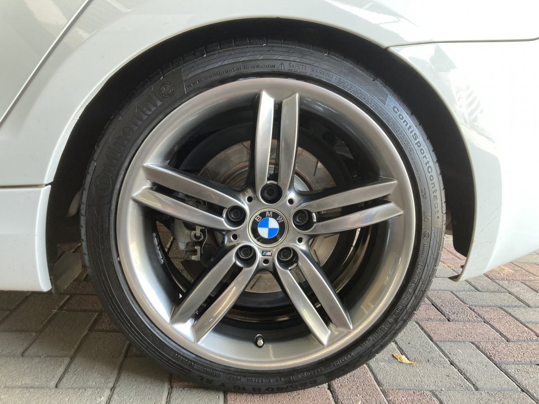

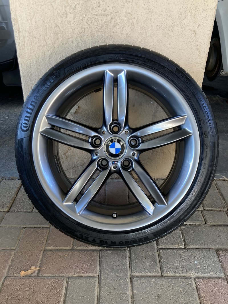

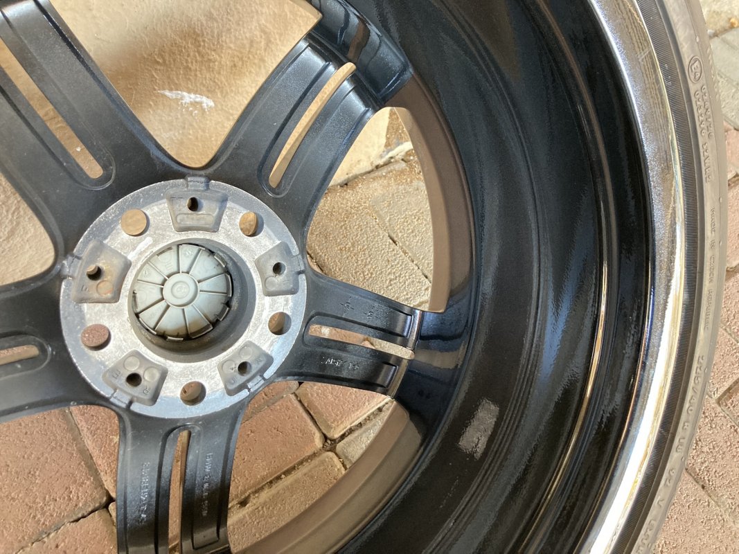

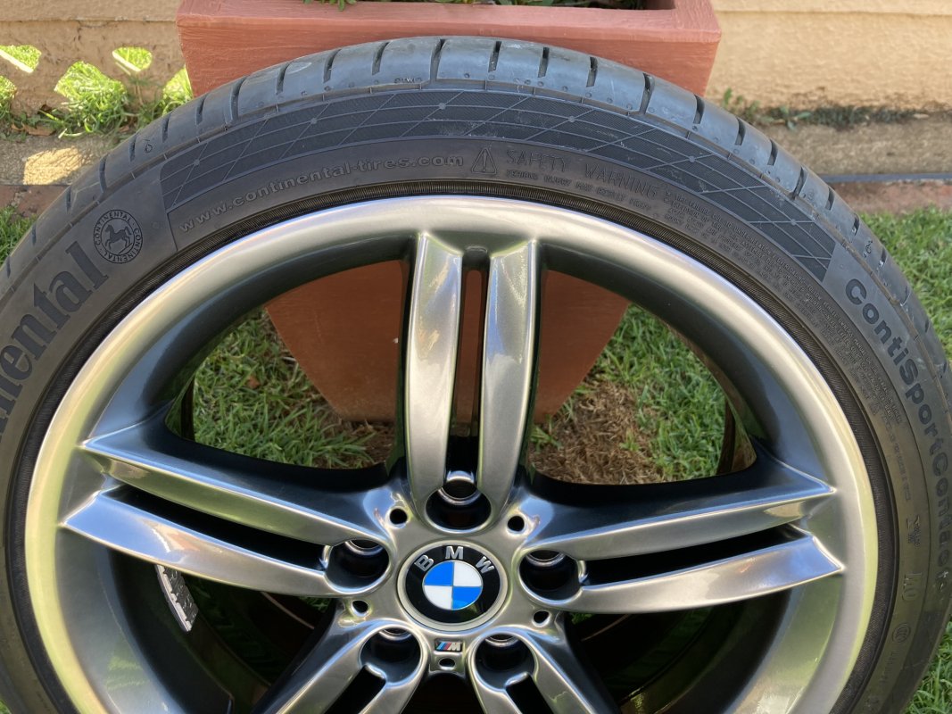

As usual, my repairer of choice was Hi-Tech Mag Repairs. I arranged for them to collect the wheel from me. Due to the black chrome paint job, they require a sample so that they can match the repaired wheel as best as possible to the others (given that black chrome can have any number of permutations). So I took off the right rear wheel as well and sent that off.
About a week later, the repaired wheel was returned to me. The repair was done properly, which included welding of the lip which is then machined down again (no putty or body filler horror stories here).
Spot the difference:
Repairs all done. Note the wheel weights were still silver in this pic. They stood out quite badly, so I had a go at painting over them with some black paint. 1 coat was all that was needed, just enough to dim the silver, but leave enough showing through that it blends in quite nicely when looking at the wheel from the face inwards.
Before refitting, we did a quick clean of the wheel wells. A more detailed clean is on the cards when I replace the shocks later on.

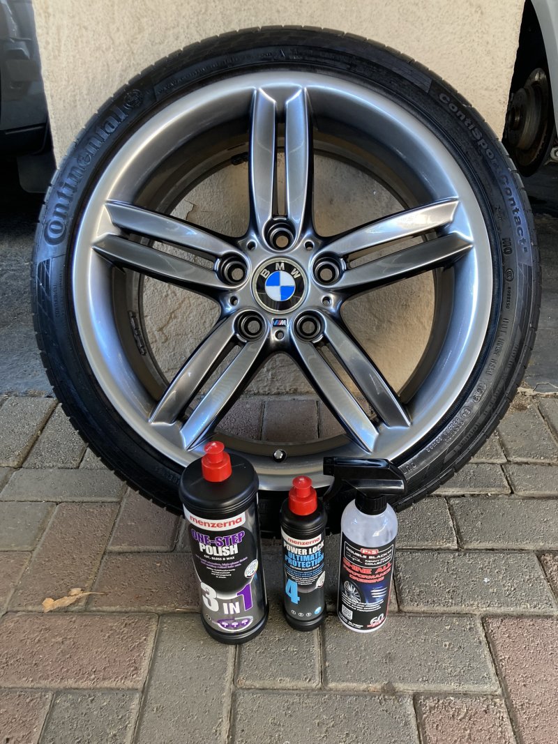

The wheels were also polished and coated, and tyres dressed as well:

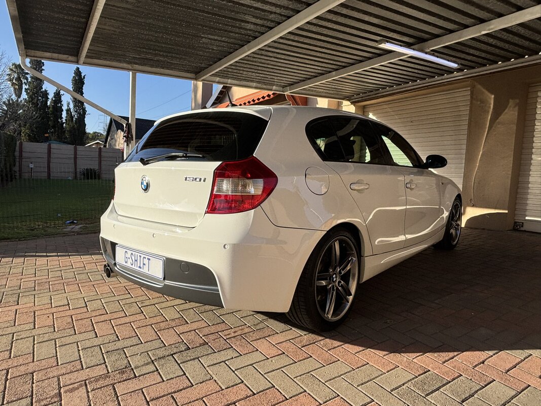

Back on the car, and car pulled out the garage to move some stuff around:
That's all for now. Next update will most likely be a suspension refresh.

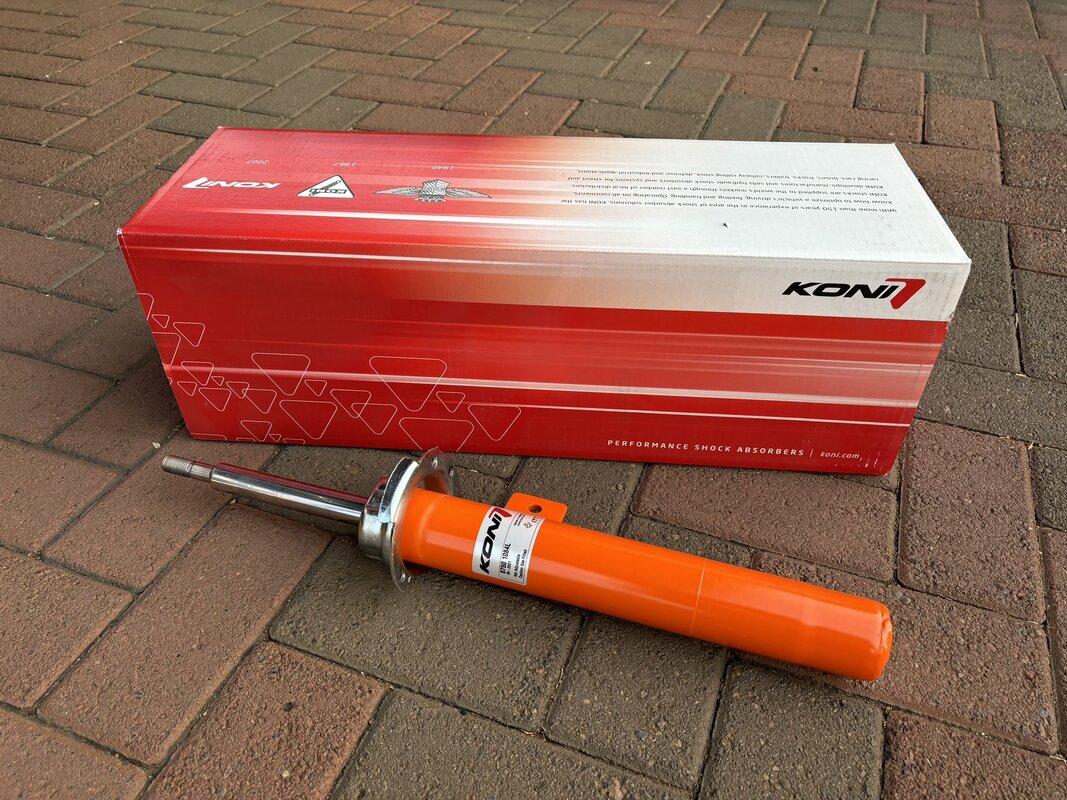

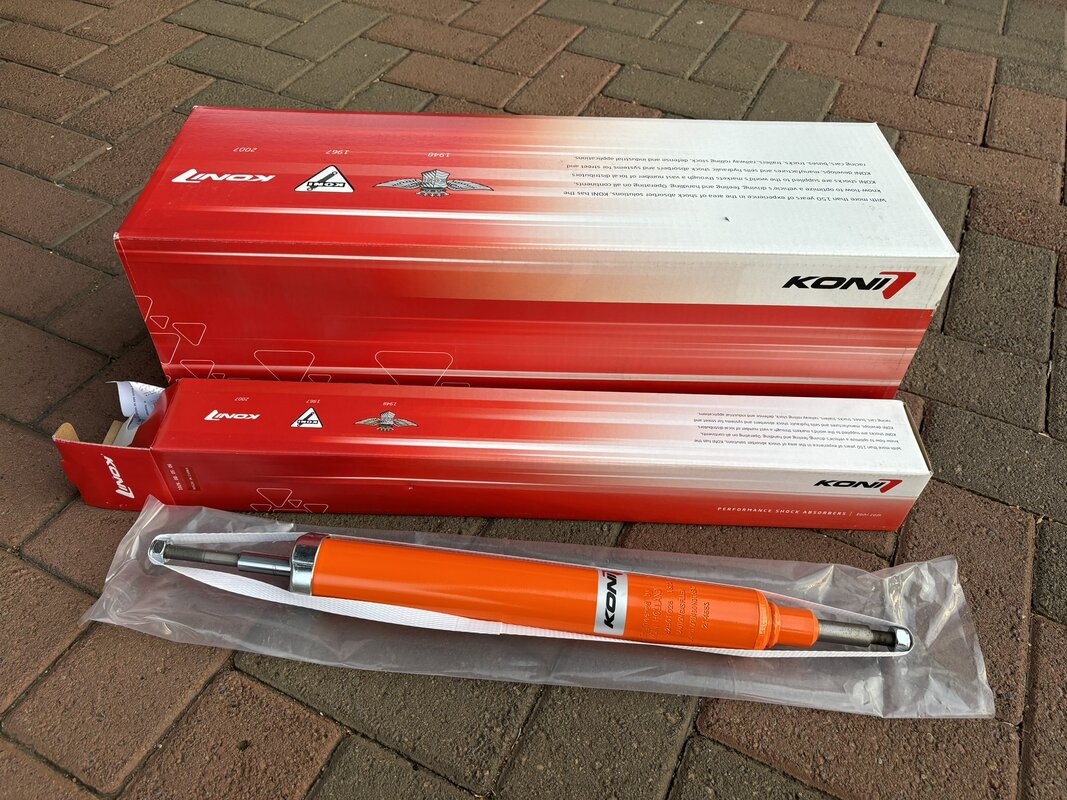

Fast forward to August, and when I wanted to buy the shocks, they were sold out locally. So I placed an order for them to come on the next shipment into SA. These arrived in September. I decided to go with the Koni STR.T shocks, for a few reasons: they are great shocks (I'm on my second set in the Ute), and based on how much I use the 130i, it doesn't really make sense to go to town on fancy suspension for < 1000kms/year.
And here they are:

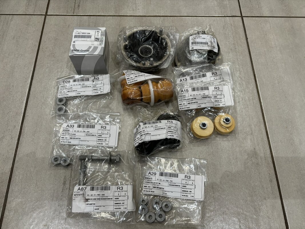

While I was murdering my bank card, I added a few 130i items to the cart before checking out (thanks again to Peter):

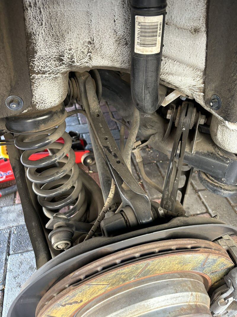

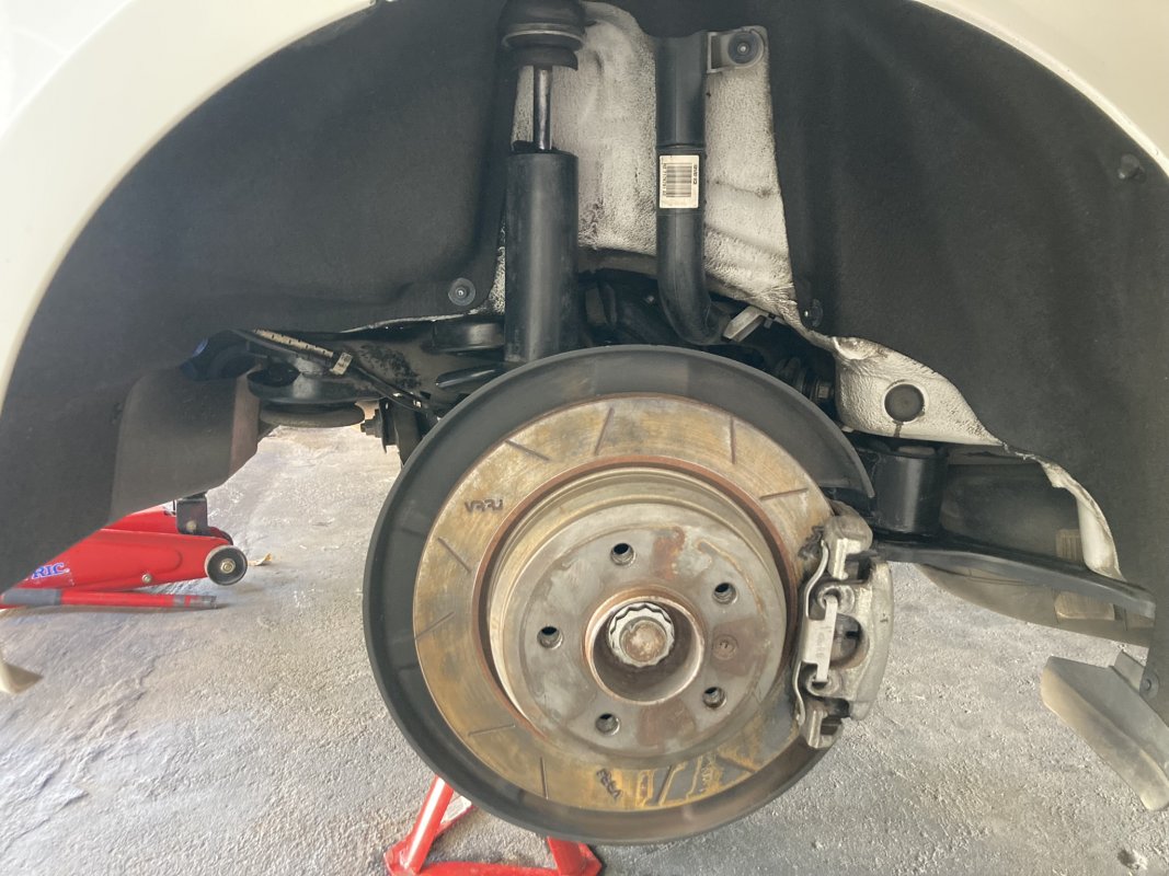

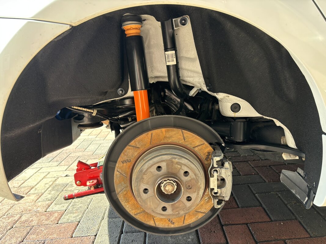

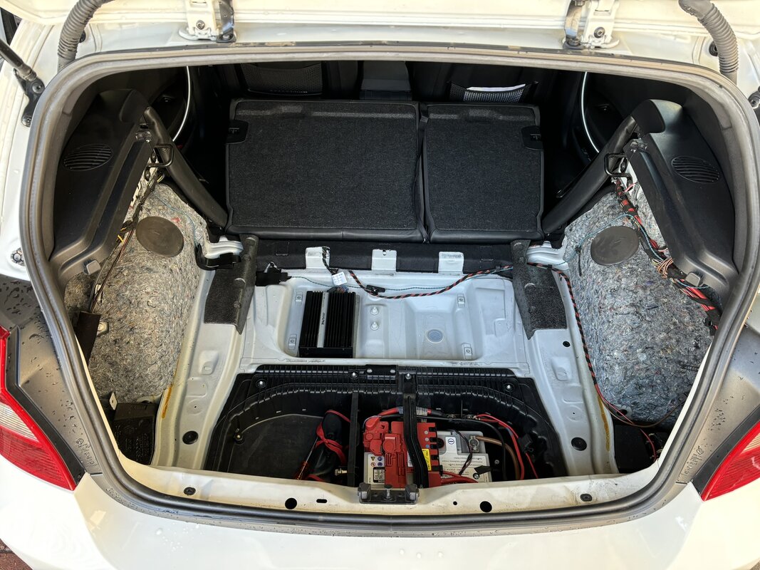

I started off with the rear shocks, this involved stripping out the boot linings in order to get access to the shock mounting points (I also gave everything a clean while I was there):

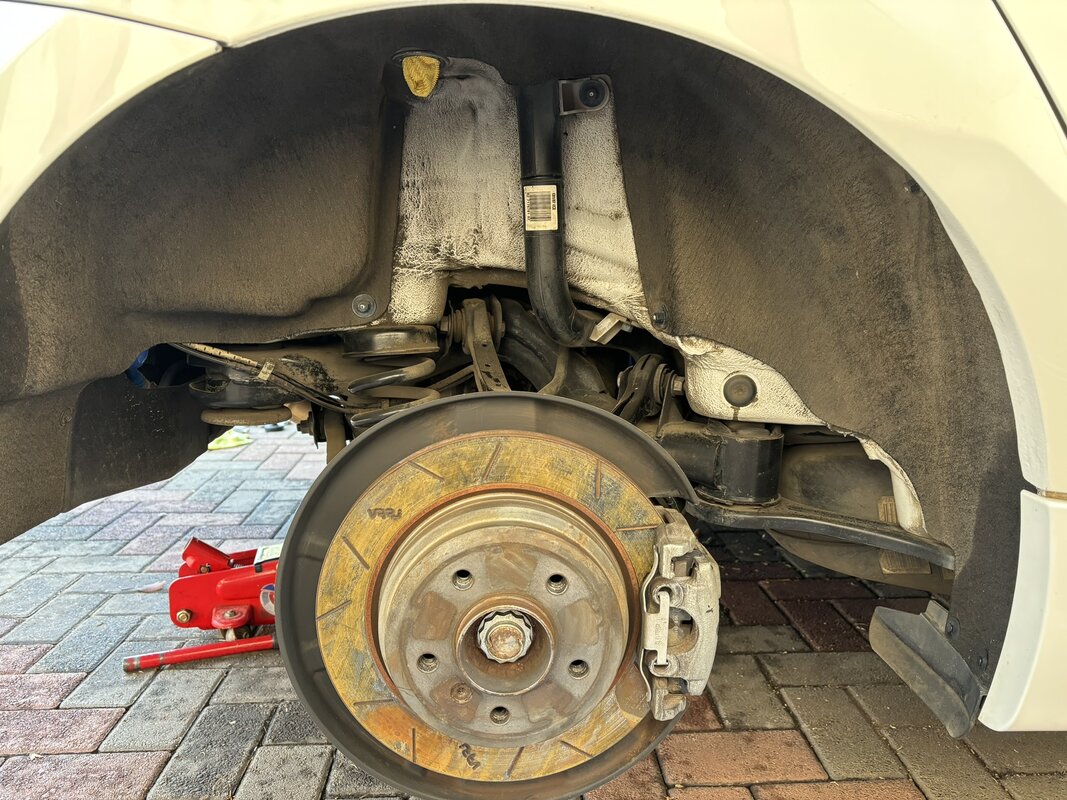

Some pics of the rear wheel wells after the wheels came off. Due for a proper clean again:

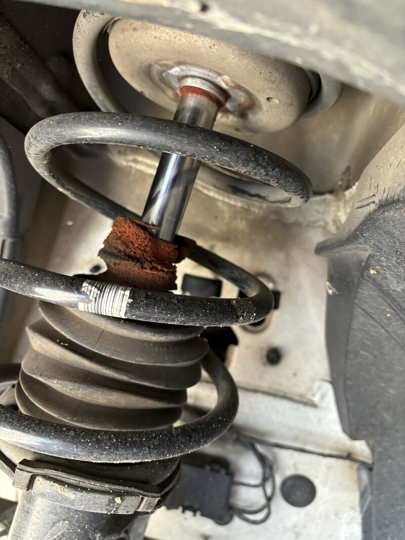

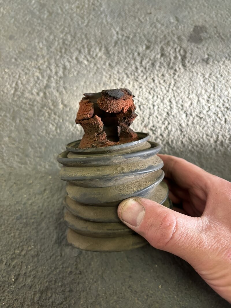

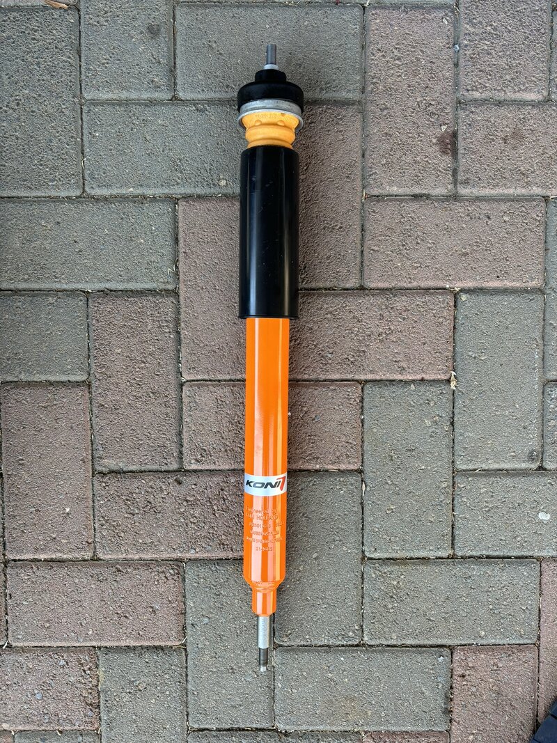

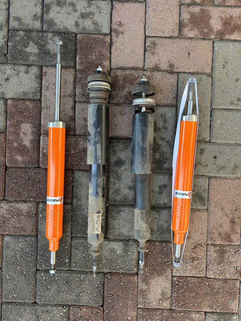

With the rear shocks removed, the extent of the wear and tear could be better evaluated. Like I mentioned, the 1 bump stop looked ok, but the other one was KO:
New shocks lined up next to the old ones:

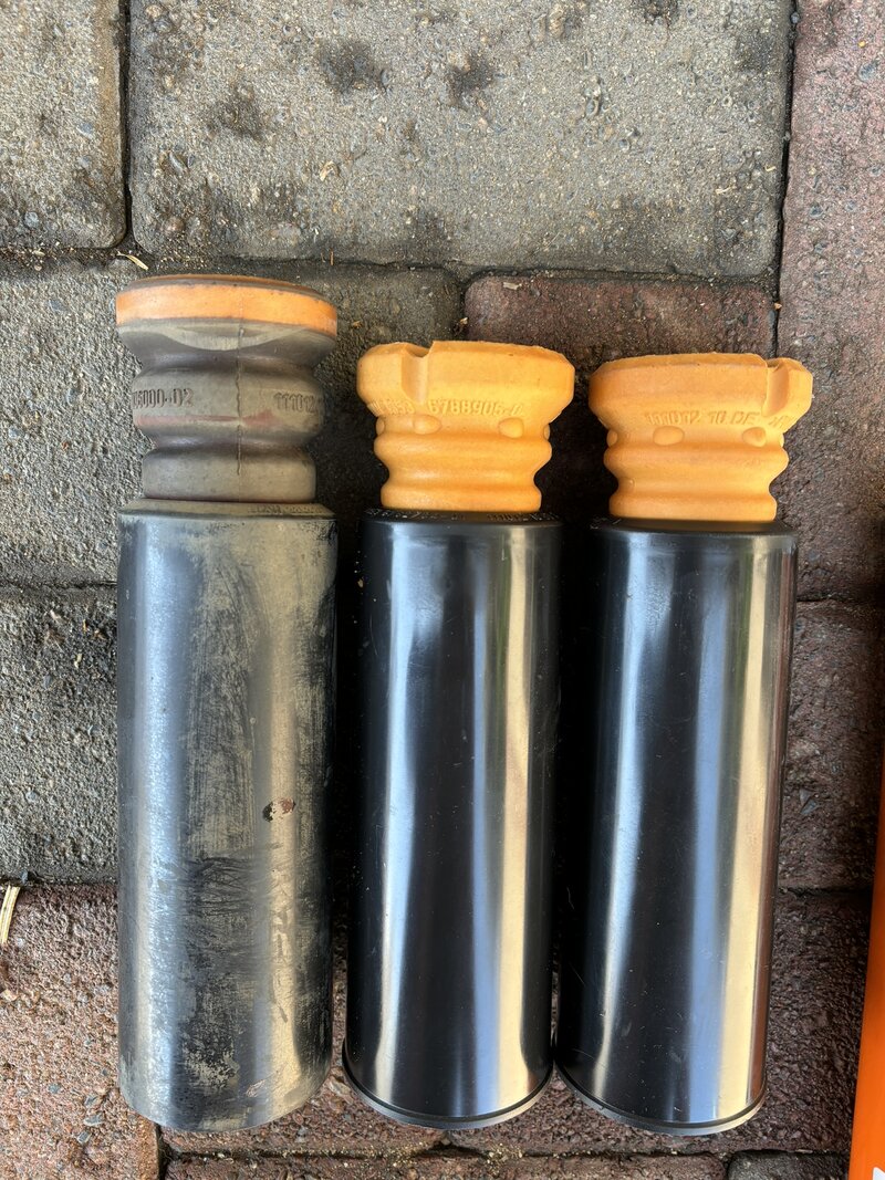

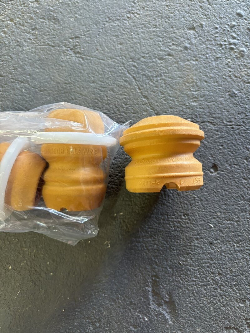

During my prior parts procurement escapades, I got some BMW Performance rear bump stops from @Captain_Stealth (thank you sir). These are 11mm shorter than the stock bump stops. Also, through all my reading and research, it seems the E8x cars seem to ride on the bump stops most of the time, so this explains the harsh bumpy ride from the back. Ask any passenger what it's like sitting in the back and hitting a dip in the road at speed, haha. So with the new bump stops in, it should afford the shock 11mm more room to work and dampen any harsh bumps. Only time will tell I guess.
Rear shock ready to be reinstalled:
And reinstalled:

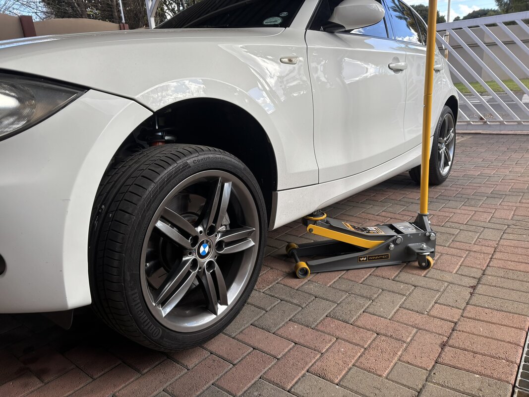

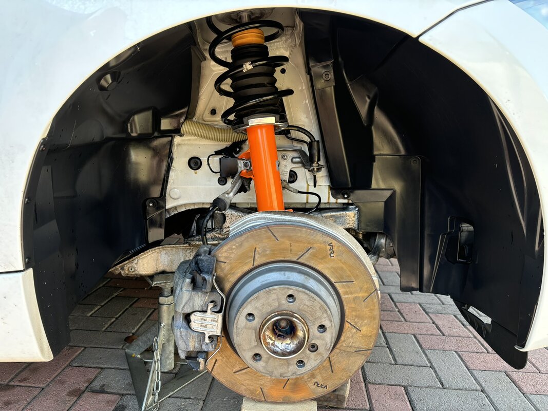

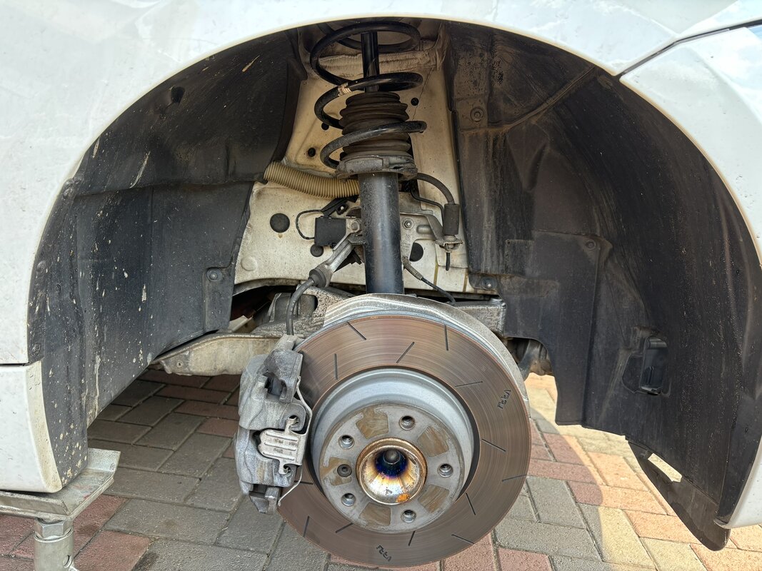

A week later, I tackled the front:

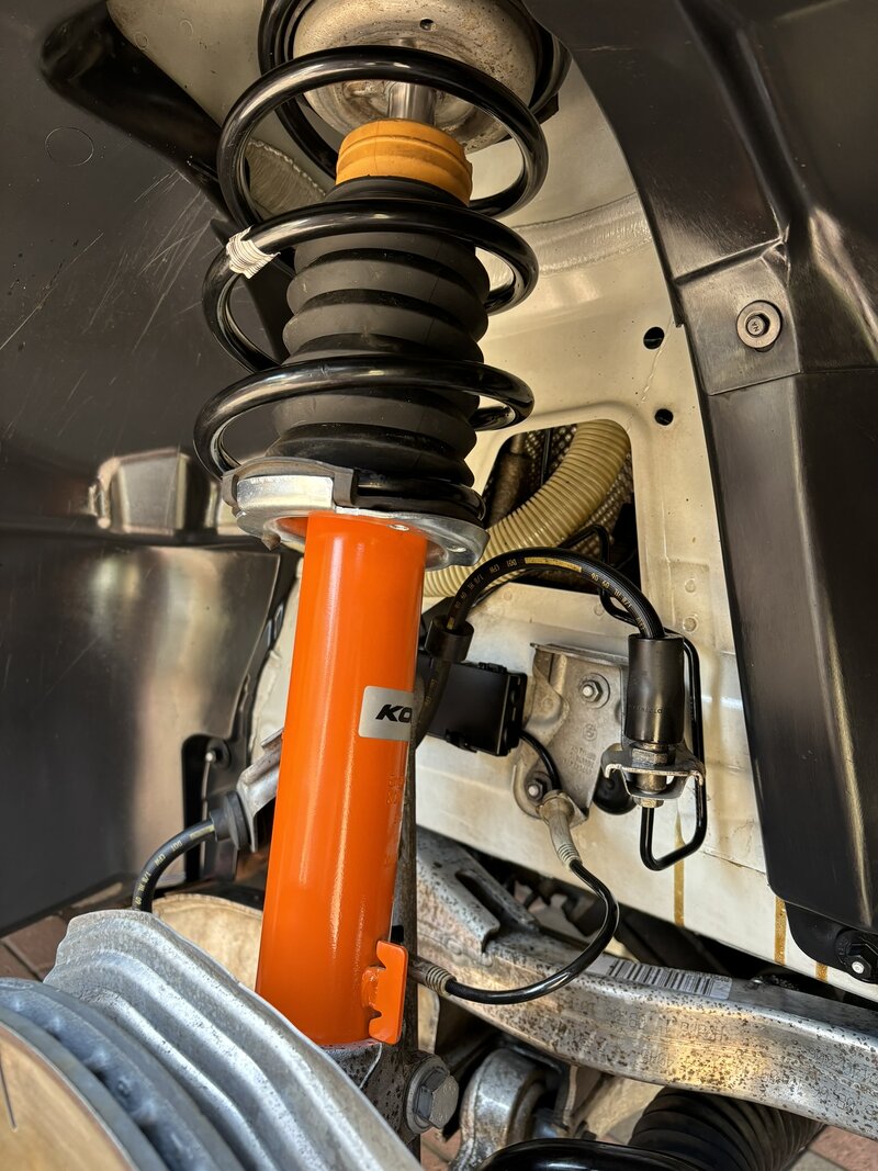

The front bump stops were in even worse condition than the rears (well, one was KO, and the other shocks bump stop was MIA):

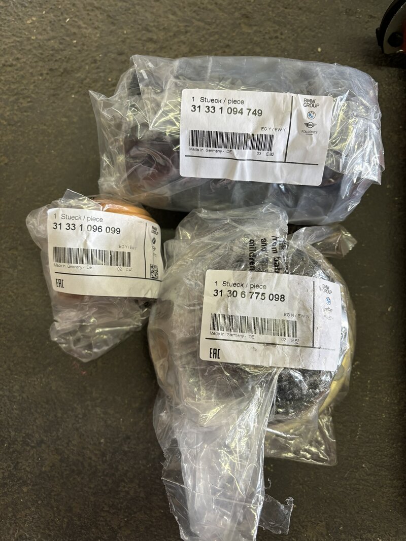

On my initial order, they supplied stock front bump stops, but I needed to get the BMW Performance ones. These are also shorter than stock, as you will see in the pic below. I can't recall exactly, but these are at least 20mm shorter than the stock ones. The same theory applies, there is more room for the shock to work and dampen, before hitting or riding on the bump stops):

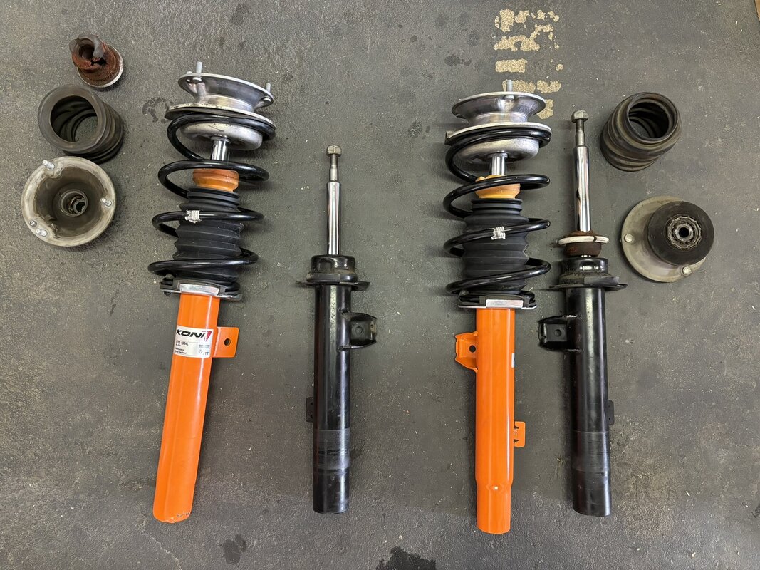

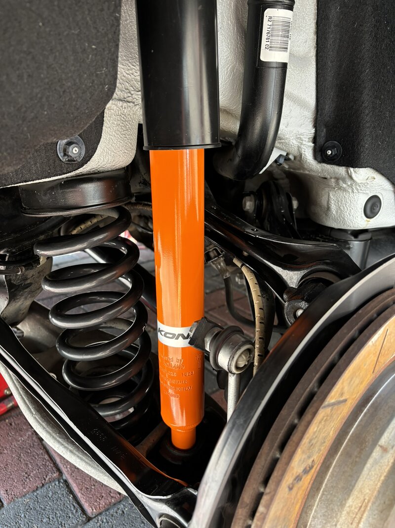

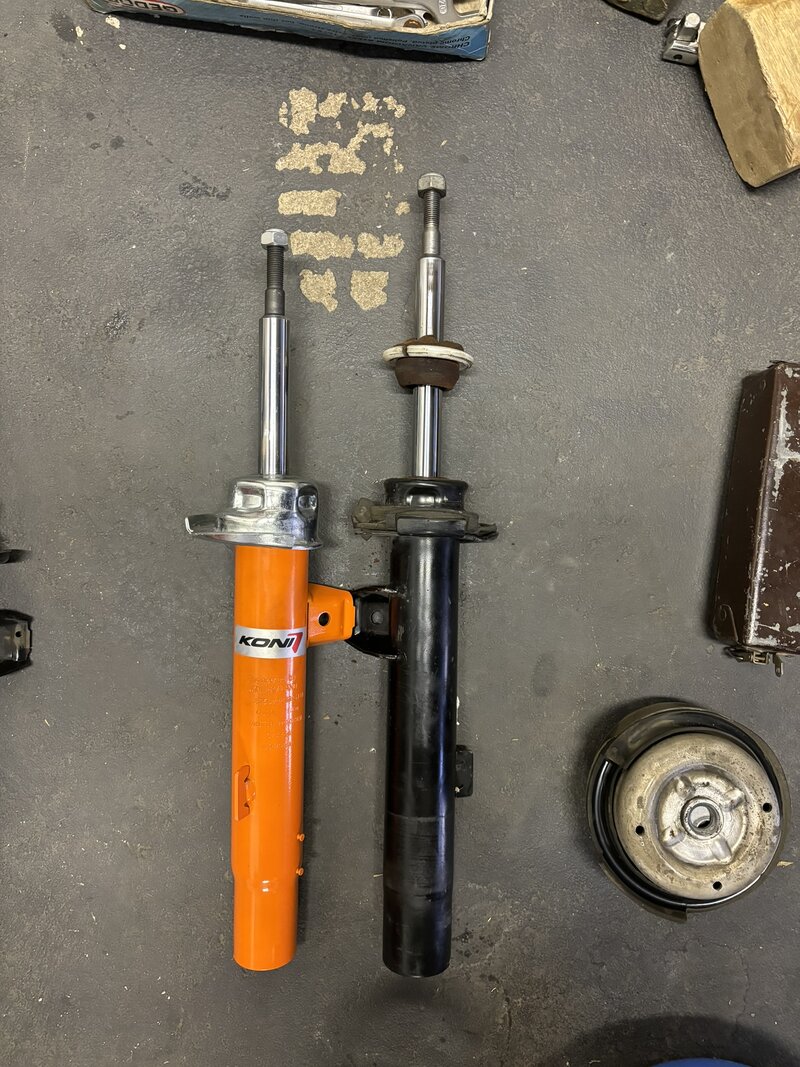

Old vs New, interestingly, the Koni shock shaft is 50mm shorter than the OEM shaft (and yes they are the correct parts):
New shocks, bump stops and shock mounts, ready to be reinstalled:
Reinstalled and sitting pretty:
I also gave the engine bay a clean and quick detail:
Initial driving impressions: the car feels great! No more funny noises, it feels like a new car, quiet and composed. I haven't pushed it by any means, but it was awesome to drive again (the last time I actually drove the car was in January this year). I'm going to actively use it over the next few weeks and enjoy it.

Great update, you spend more time working on this car than driving it :ROFLMAO:
The shorter bump stops are a worthwhile upgrade. BMW did some weird things with the E9x and E8x suspension setup. On my E46, I shortened the rear bump stops slightly and it has made a huge difference in comfort with no noticeable drawback

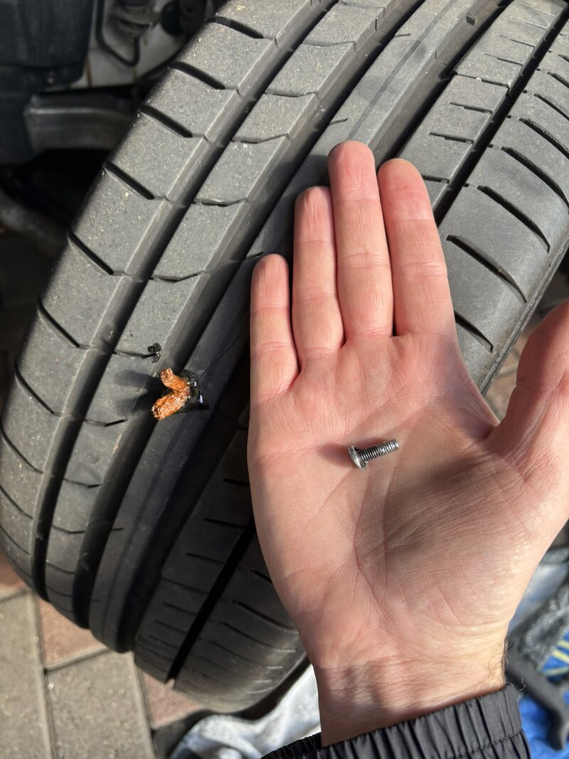

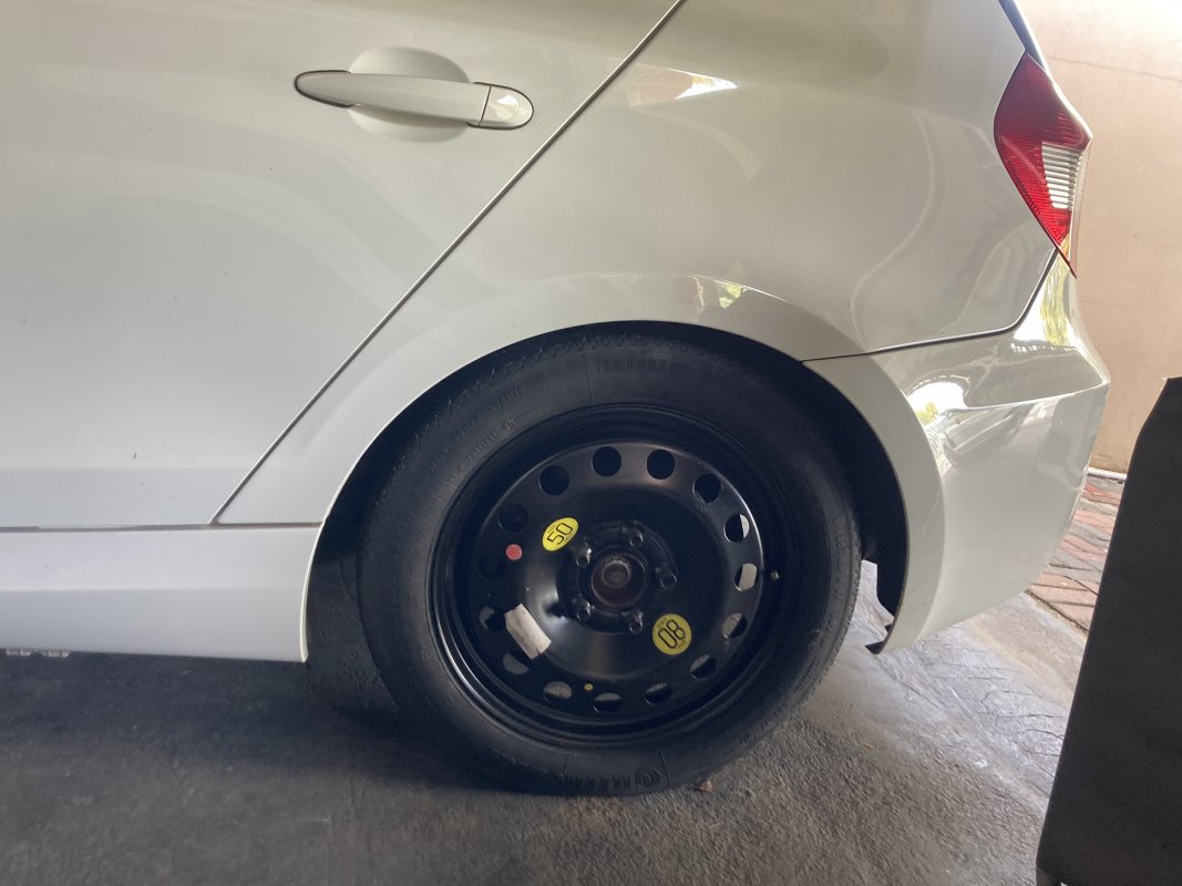

And then (to be expected?), I picked up a puncture in the front left tyre on one of my trips.
