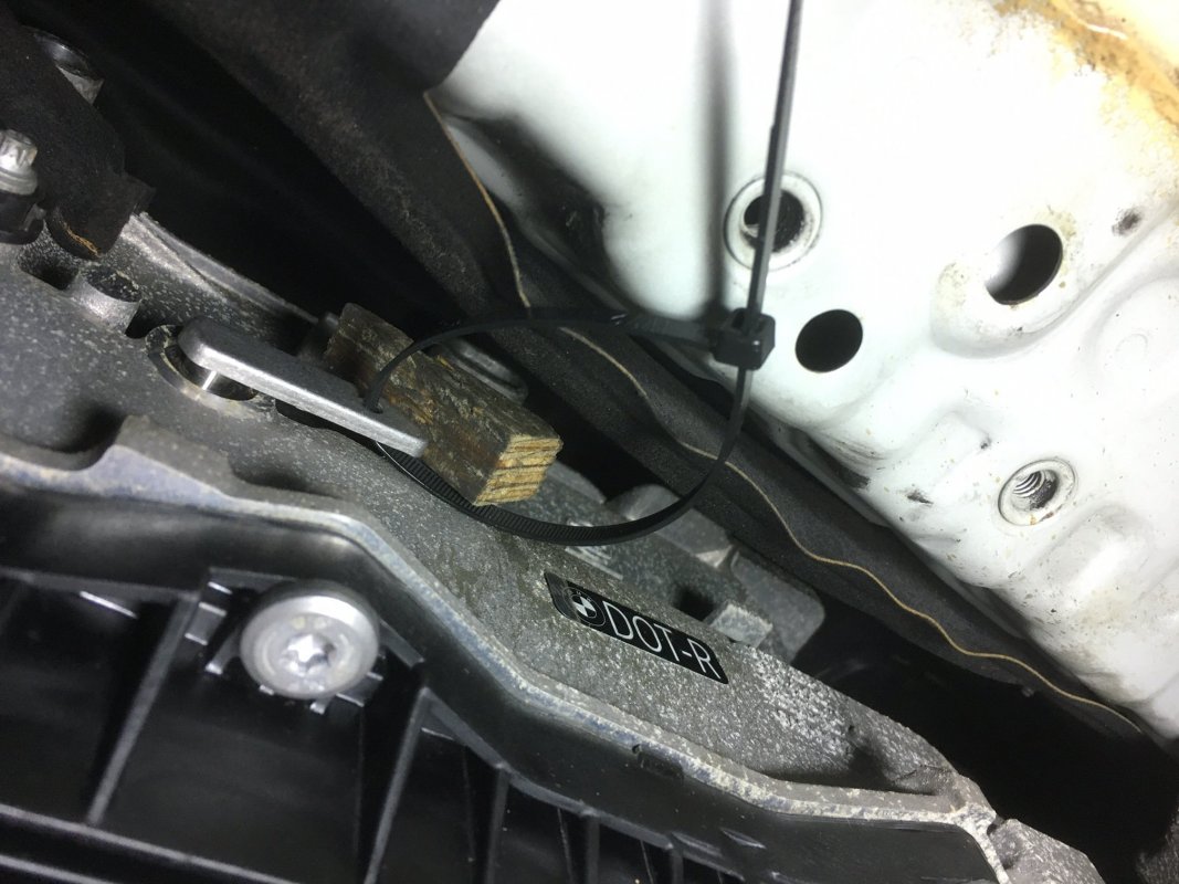

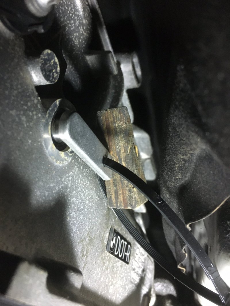

When I go underneath I see a block of wood there , but im not sure exactly whats going on .

Here is a picture of the block of wood that im referring to in my previous post , There seems to be a lever with a hole in it as well .
I cant see anything that it would attach to . Am I supposed to move the lever in a certain direction and attach it to anything?

Went to BMW Smg , spoke to a tech about the block of wood and transmission issue .
He said just to remove it and the lever will go back into place and the car will be in park . If I need to put the car in Neutral again , pull down on the zip tie , and put the block in place .
cant believe it was so simple and I couldn't find anything online about it anywhere lol

This evening , I went under , removed the block , the latch sprung up , the car was out of Neutral . After almost 4 years for the first time , Everything powered up and felt normal ( Bar the errors on the screen ) ( i did not start the engine). I did the low pressure cooling system bleed procedure and that went well . No issues .
View attachment 21108View attachment 21110
I’m guessing the neutral was forced. Remove the cable tie and piece of wood. That lever should then push back in place. Not that I have ever done this, just makes logical sense

Yup , So what the tech said is , you tie a cable tie through the hole , Pull the lever down , that disengages the transmission and puts it into Neutral , and stuff a block of wood in there as when you remove the block , the lever springs back into place engaging the transmission again . I have learnt to be extra cautious these days when working on any of my cars , Car parts are to pricey these days to mess up , Also , that transmission is basically brand new as BMW had Just replaced it on the car Just before its motorplan ended of which then the Turbo went about 2000 kms after and the car was parked up haha So I didnt want to break anything .

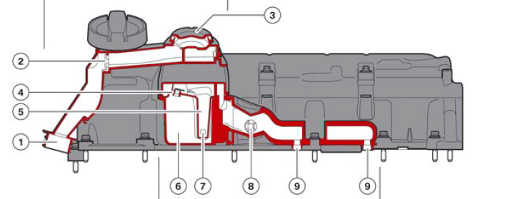

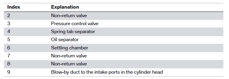

Heres something I found on those Valve covers of turbo Bmws
So when they get junked up ( because of Bmw`s Oil change interval issues ) all the little pieces get messed up .
Just complicates something that shouldnt really be that complicated. I dont understand why the CCV couldnt be separate like that of my N42 engine .

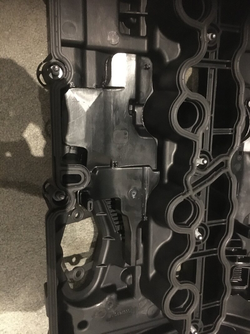

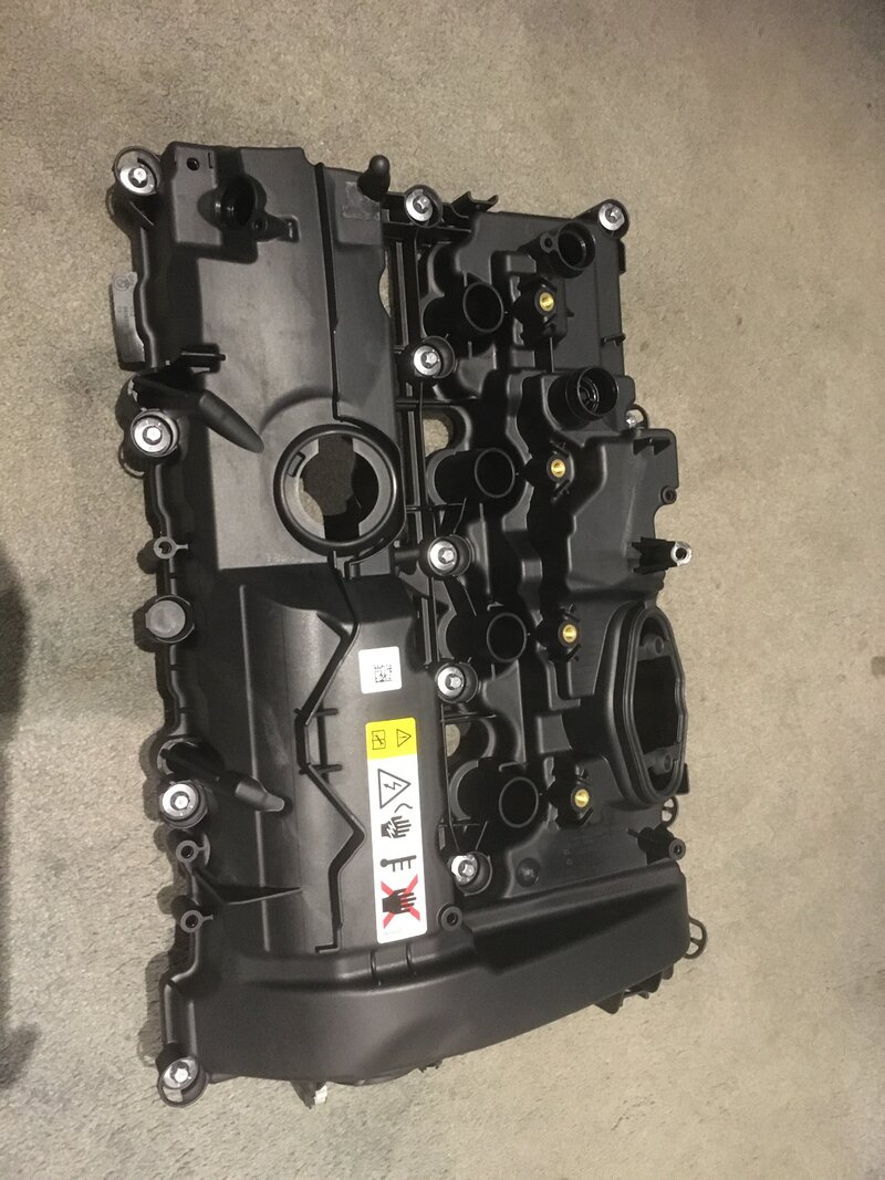

Here is a picture of the new cover , and here is the underside where the PCV Valve is . You have to replace almost all the screws as well for the injectors as they are all stretch bolts So when replacing this you have to buy new bolts .
Heres a fun fact , I watched this Vid on the B48 engine and apparently the casting? is made by Magnetti Marelli Italy , Im not sure if that apply to all B48 engines but in the Vid , this one is . I haven't checked my engine , don't want to remove those covers as it would mean removing the turbo again haha.
