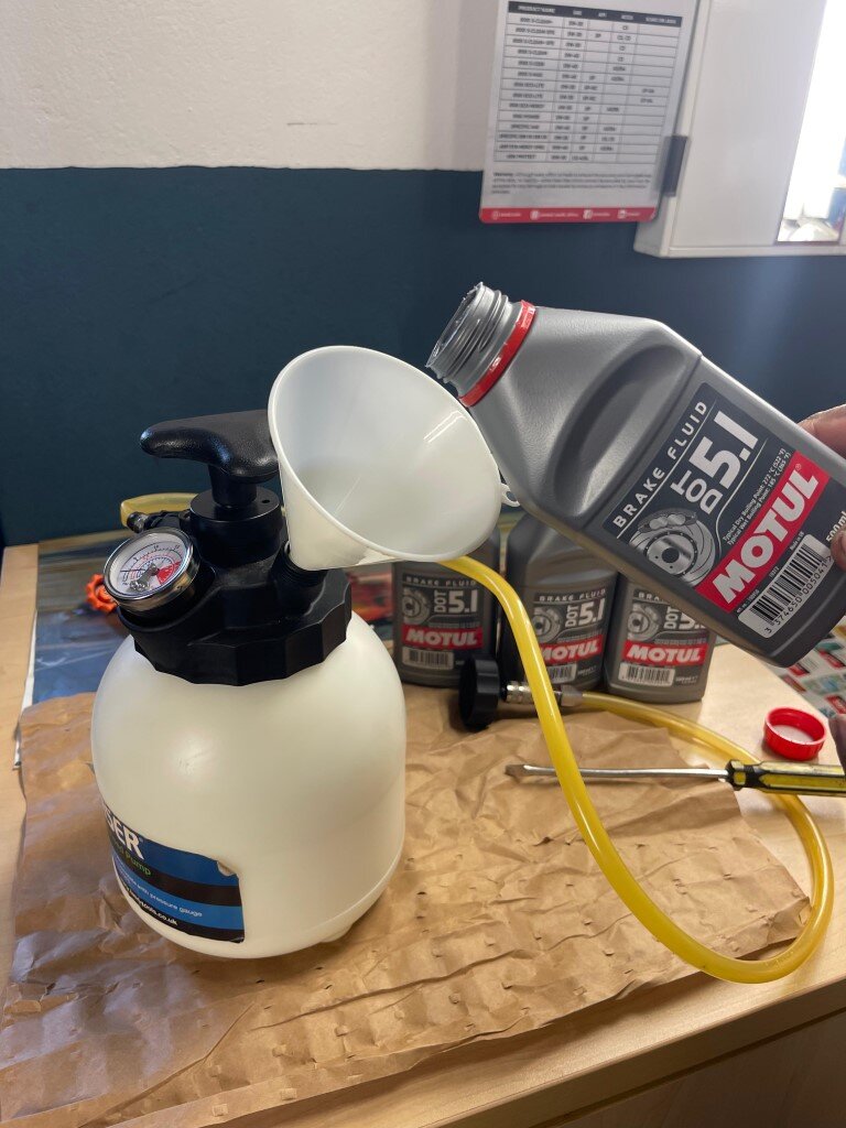

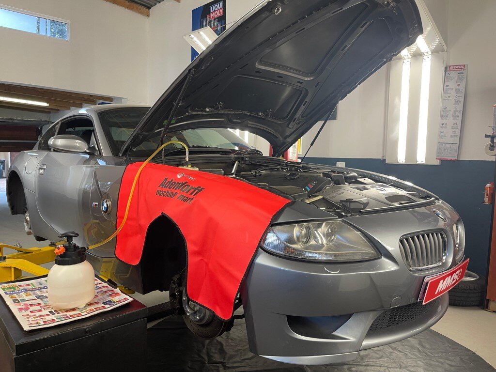

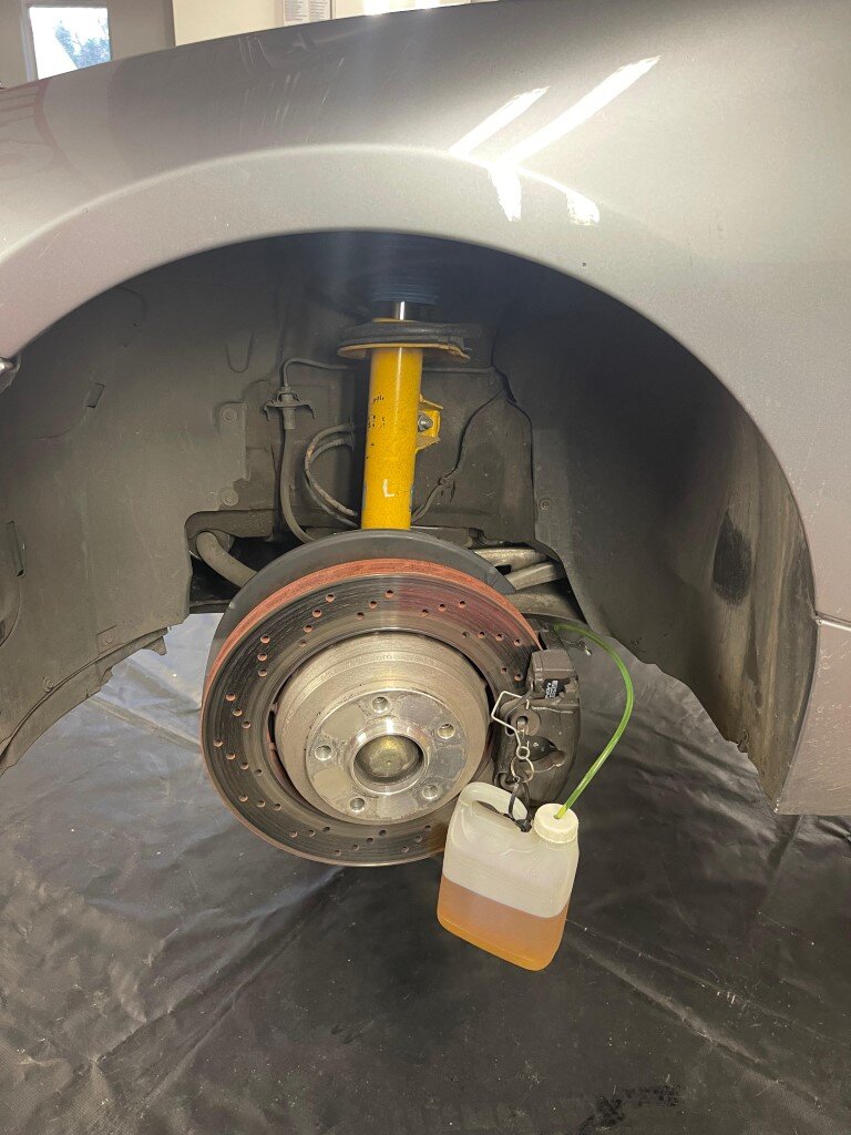

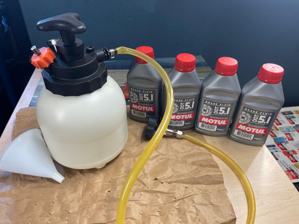

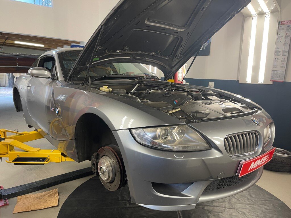

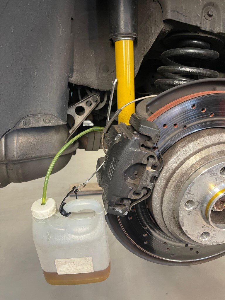

Today he popped in. After catching up for a bit โ, we got straight to work โ car onto the lift, wheels off, and the old pads out ๐ง. In went the Ferodo DS3000 pads. We then filled up the pressure bleeder with Motul DOT 5.1 brake fluid, which has a higher boiling point than standard DOT 4 and is a nice step up for track use without breaking the bank ๐ฅ. All four corners were bled to remove any air and make sure the pedal feel would be spot-on โ .
Once everything was buttoned up and the wheels were back on, we went for a quick shakedown drive (with me behind the wheel) ๐๏ธ. The brakes felt great โ firm pedal, good bite โ and once the pads are fully bedded in, Benjiโs going to have a lot more stopping power and confidence on track ๐.
