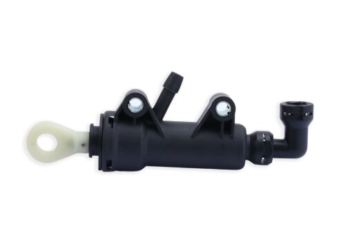

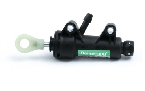

Hey guys I just wanted to update everyone on my findings today. The e90 clutch master cylinder can indeed be used on the e60. All that needs done is the little piece of angle hose transplanted and the mounting holes punched/drilled to the right size then it fits exactly right
